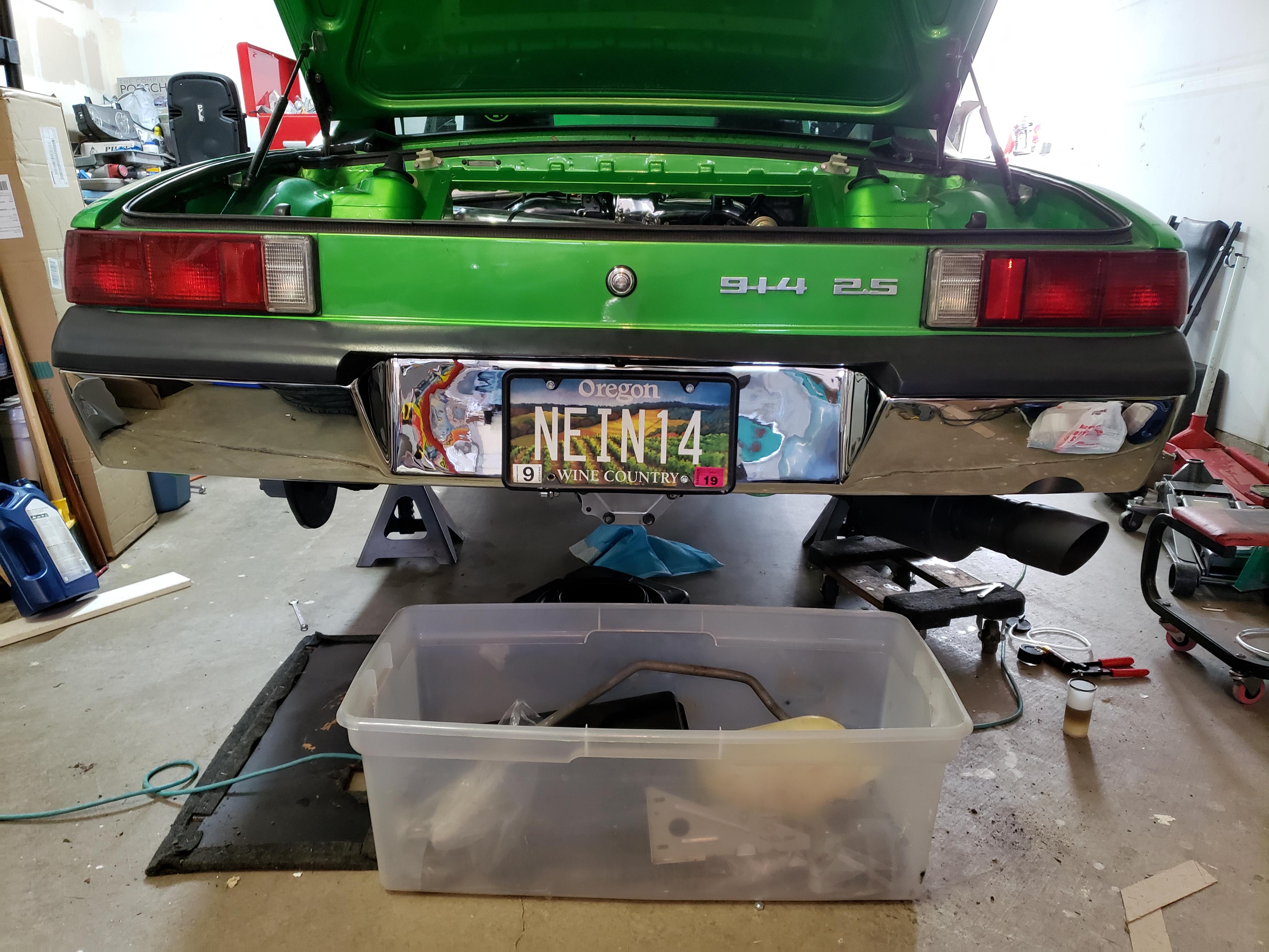

Early rear bumper

All worth the wait. You’ll see when you drive it. It looks great Jamie. Crank that sucker up!
Btw you need to add a “t” to that 2.5 badge.

QUOTE(Chris H. @ Aug 25 2019, 06:53 AM) *
(IMG:style_emoticons/default/agree.gif) I actually need to change it to a 2.0T
