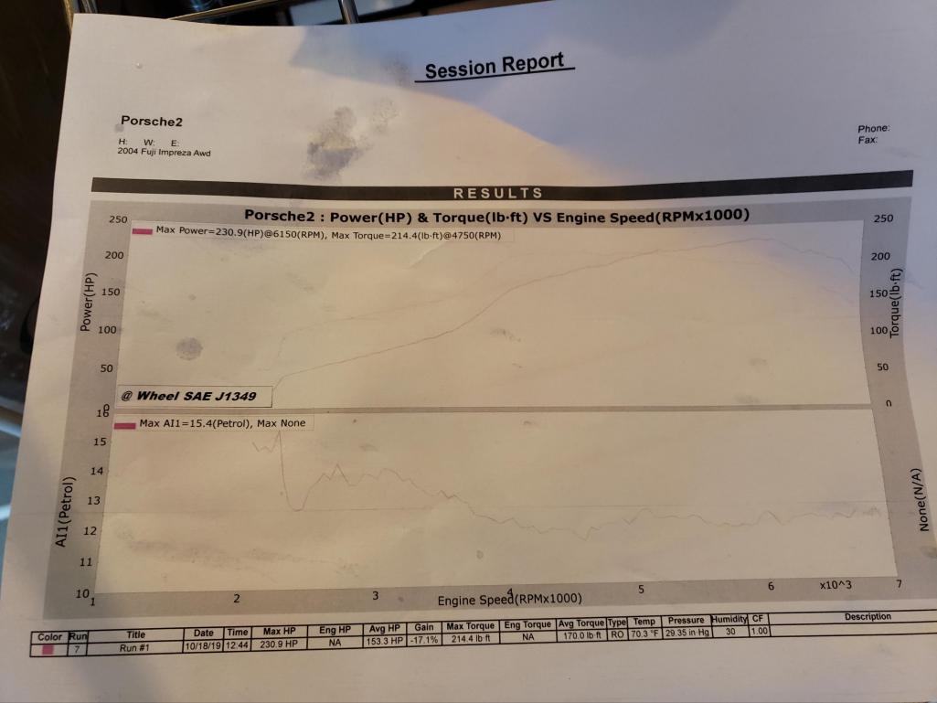

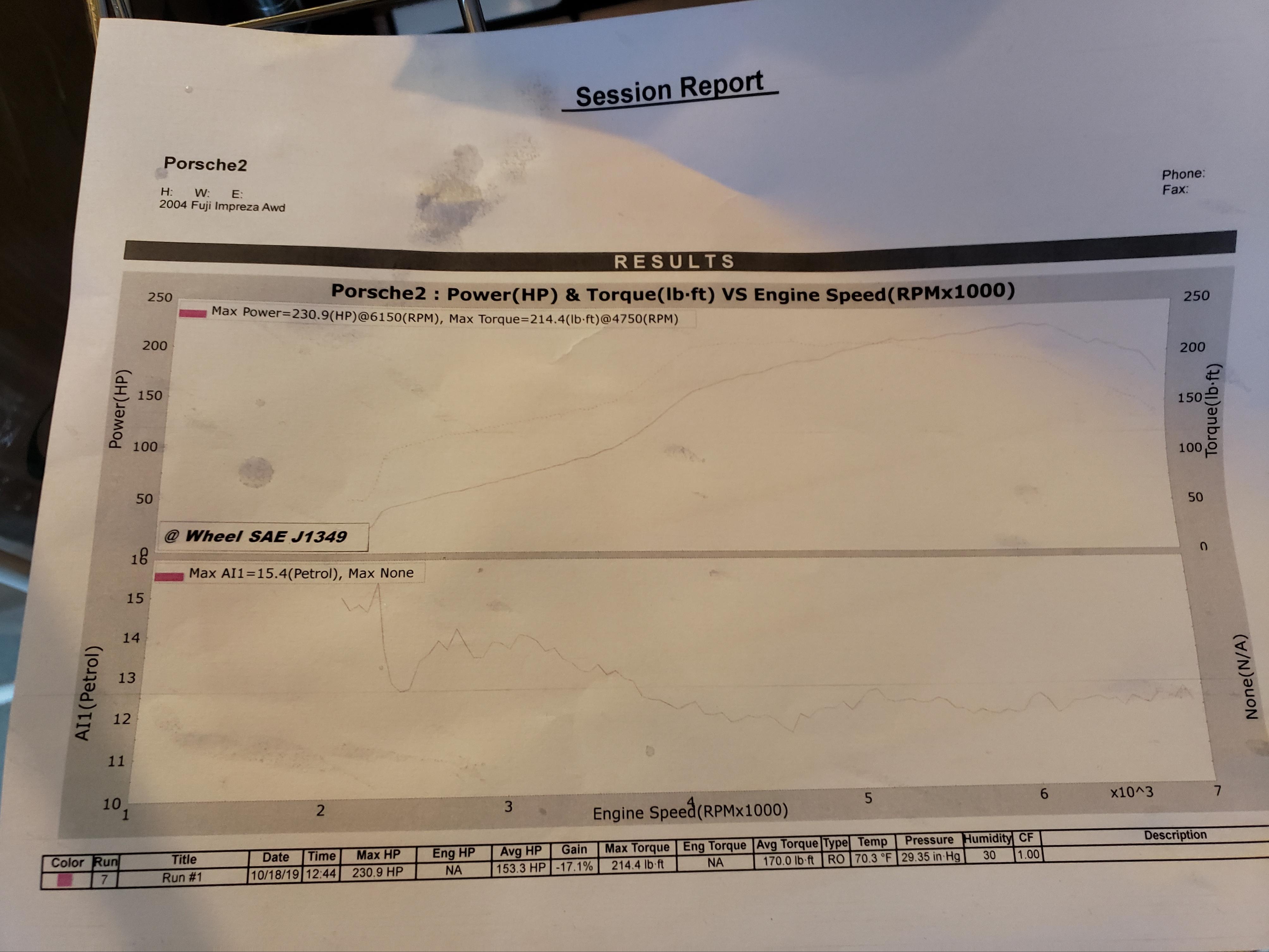

Okay well I did get to drive my car & brought it home. The boost controller wasn't working. They didn't have anymore in stock. So at the moment I am at just 11lbs of boost. I'll go back down next week for the new boost controller & will get my turbo cranked up then. I'll get a much better dyno sheet as well. This one hardly shows the graphs. Sorry the lines are so faint. I'm at 230 hp to the wheels at 6150 rpms & 214lbs of torque at 4750 rpms. Nowhere close to what I expected but my boost is so low.
Having said all that. It has been raining all day & I have done nothing but drive it a few miles. It pulls amazing but I really didn't go all out. To wet outside I just spin the wheels with much pedal. I also ran out of gas about 5 miles from the shop. Forgot with my fuel issues we had to drain the tank. They put in gas to run the dyno but not a lot. I did see the gauge on empty but just thought it wasn't working. LOL! So got to sit on the side of the road for a half hour while I waited for more fuel. Put in close to 5 gallons & fired right up. Drove right to the gas station where it took 12 gallons. Then hooked up to my truck & flat towed it home. MY passenger rear wheel is either bent or out of balance. I saw it on the dyno & didn't feel it so much when I drove it. My day is pretty shot tomorrow unfortunately. So I won't get to do anything with it. Hopefully Sunday afternoon I'll have a little time to play around

Awesome!!!! That looks near identical to my setup up to about 6k when I'm on ~11psi!
Seriously promising stuff there!
Next time if your there on the Dyno and the controller doesn't work just add small "t" valves to the boost line to the wastegate. They'll bump up the pressure so you can at least tune for the bigger boost.
That or a $30 bleed valve.. surprised your tuner didn't just throw one on so you wouldn't have to revisit them...
Congrats on great progress!!
