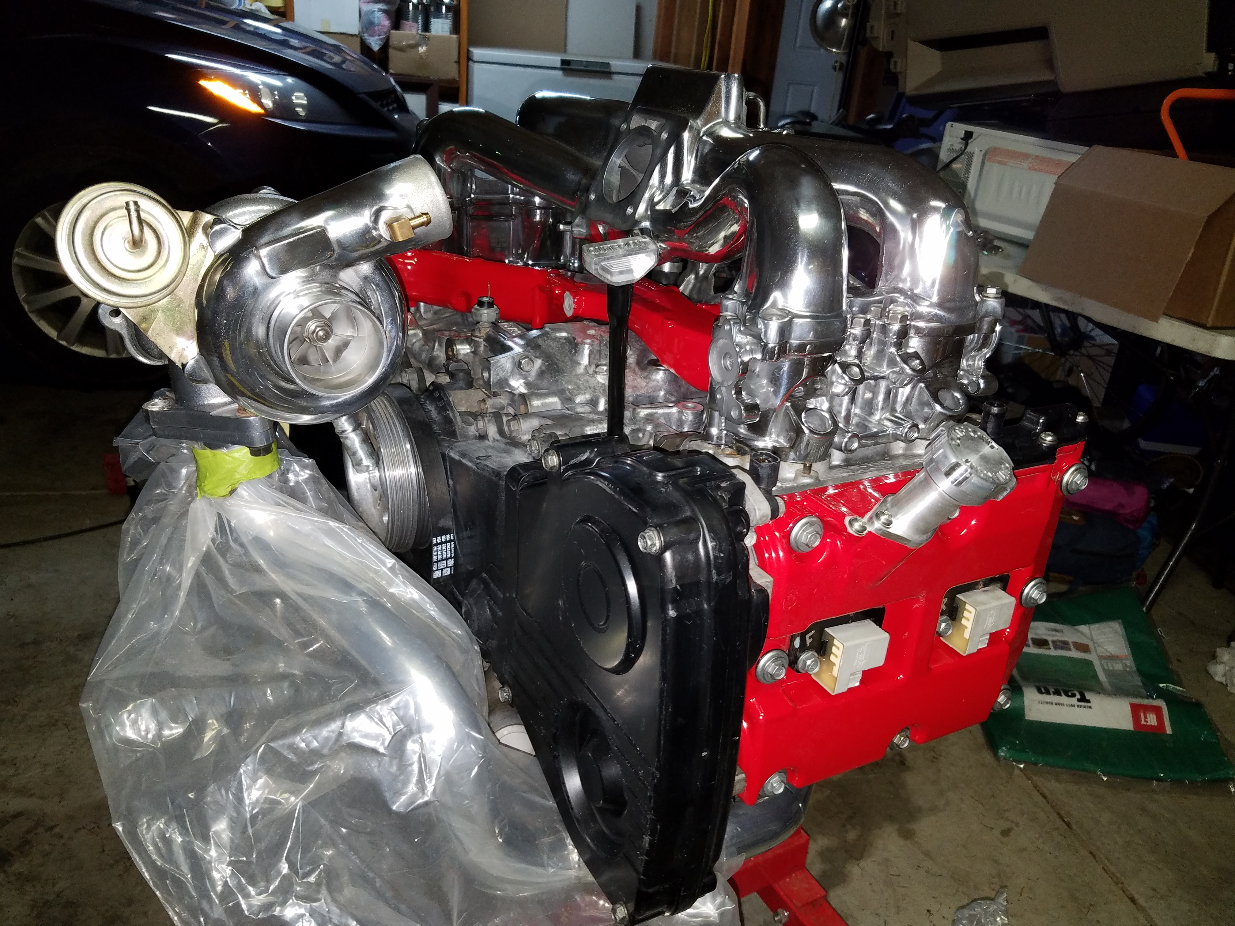

My motor plans are changing. I picked up there 2005 wrx 2.0 motor. I bought this motor originally 3 years ago. Then had the wreck in my car. Ended up selling it to help pay for repairs. Brent was prepping it for his car when his plans changed. So given the opportunity I bought it back. My 09 2.5 will have more power especially low end. So it will go in my car eventually. But for now this motor is just to damned sweet it needs to go in my car. Plus has everything needed to do so. Only thing I am missing is the exhaust from the turbo back. Plus a cradle or firewall mount. Still debating between the 2

Decided on the EJ20 huh? What turbo is that?
JRust
post Feb 6 2017, 12:15 PM
Post #45
Posts: 6,317
Joined: 10-January 03
From: Albany Oregon
Member No.: 129
QUOTE(matthepcat @ Feb 5 2017, 11:36 PM) *
It's the stock turbo just rebuilt & polished by Outfront. I decided on that motor for now. I am going to hang onto my 2.5 motor. Going to get parts to build it into a bit of a monster. I want 400+ HP with that motor. Plus will be a easy swap later as well. I've got everything for this 2.0 motor. Just an easier swap at this point to get it in place.
