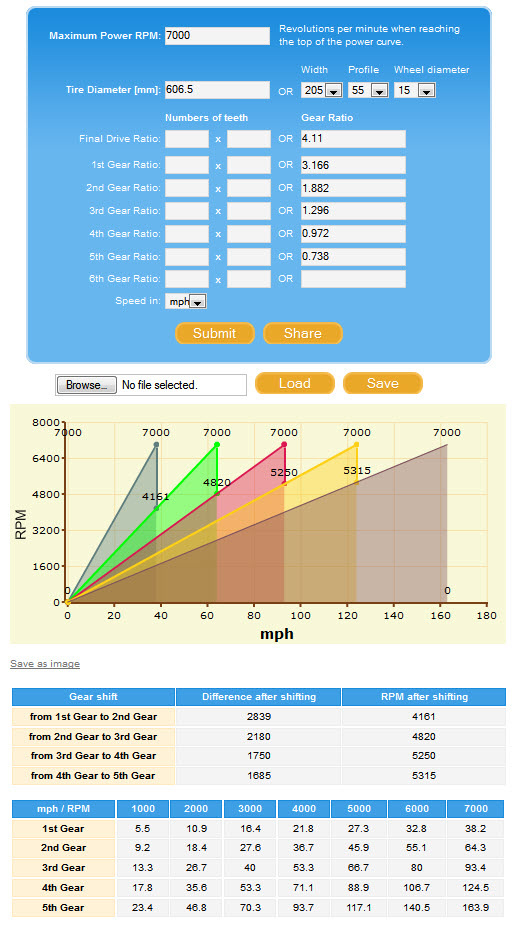

That third is too short IMHO. 20mph in a gear? Way to short.
What gearbox do you have available and what ratios do you have??
You have 3k worth of powerband so you'll want to have some headroom above and below it for shifting.
Link below is what I use for calculating my gears.
https://www.dropbox.com/s/8kikaf08oij9ijx/A...atios.xlsx?dl=0
I would suggest a taller final drive if you can find it. Something that puts first about 35-40, second about 60-70, and third about 100-110.

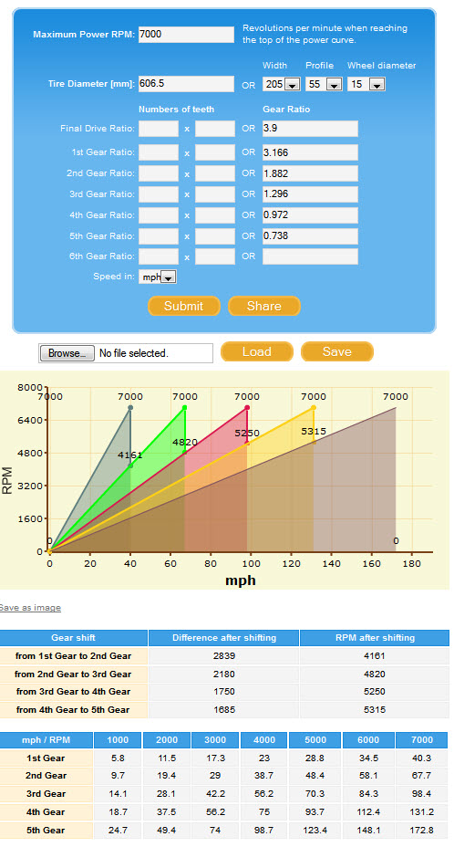

I was digging through some old files looking for data and failed but I did find some ratio calculations I did when I was picking out my trans.
I ended up with a 09 WRX which has different 1st-3rd than the earler stuff.
3.9 3.166 1.882 1.296 0.972 0.738 - '08-up USDM WRX
3.9 Final drive
4.11 Final drive
This is likely what you have.

That 3.9 final drive doesn't look to bad.

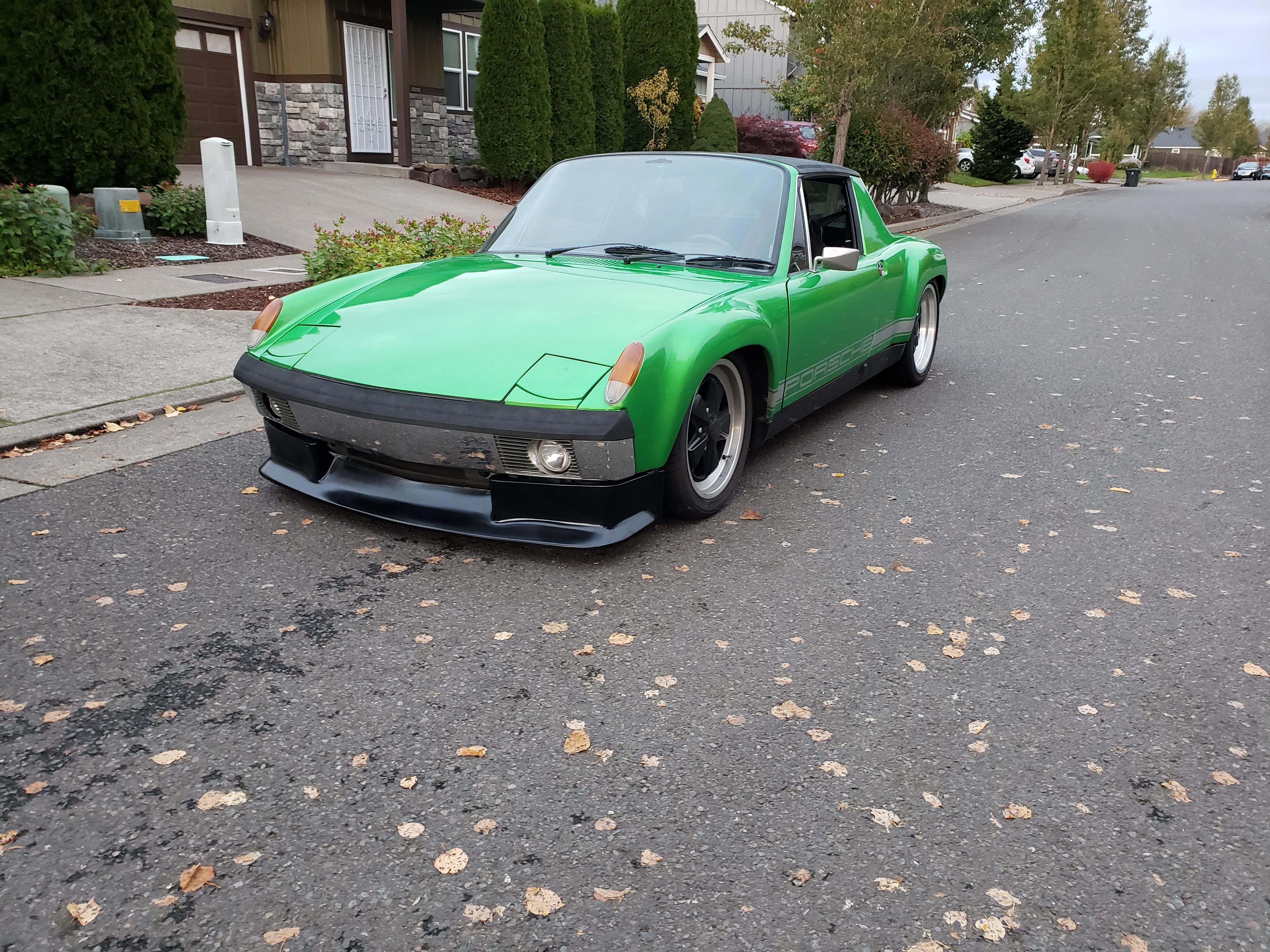

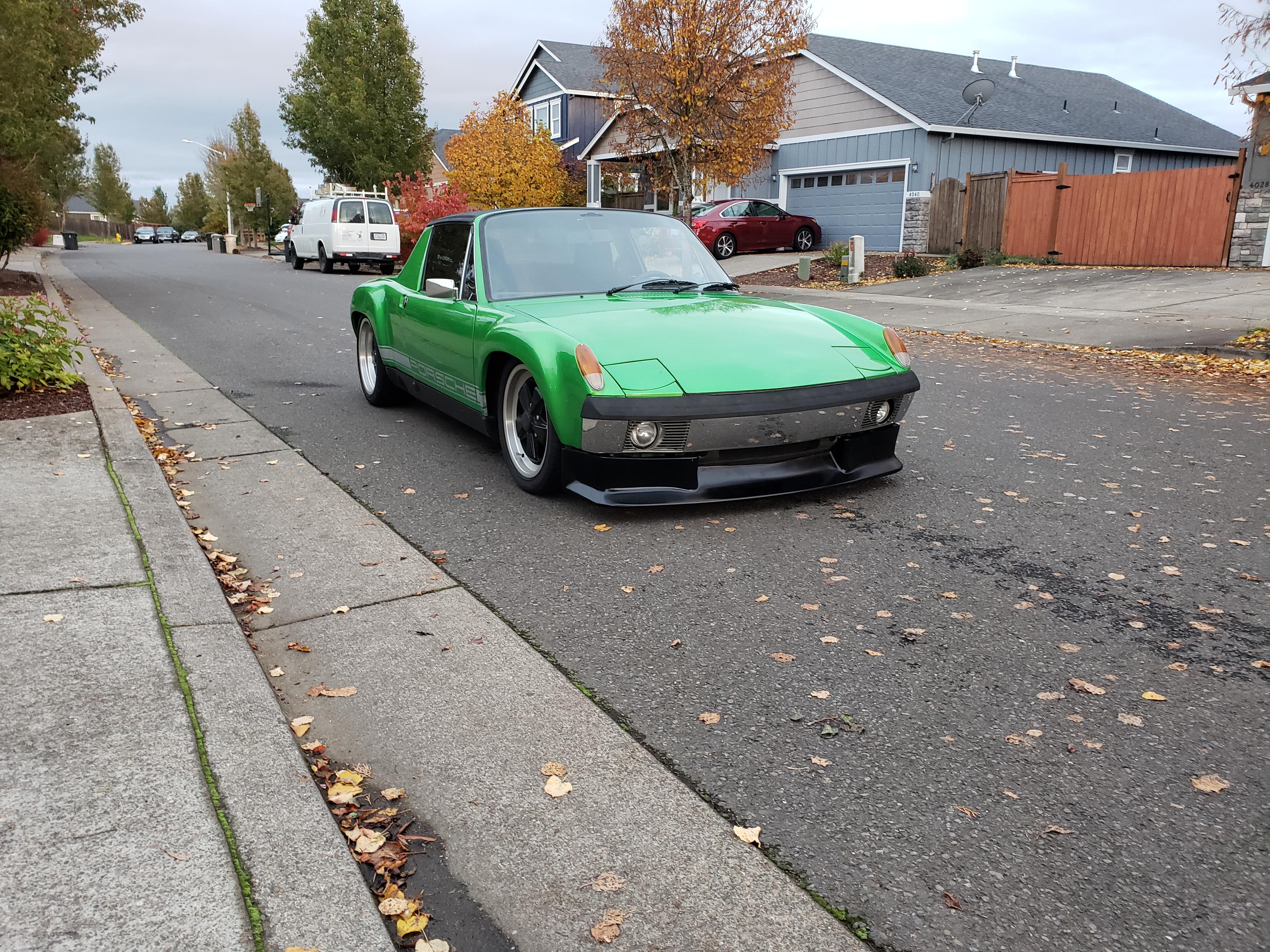

Put on a front spoiler I picked up a while ago. Thanks Don! This thing sits pretty dang low. I scraped going out my driveway & a few other spots as well. I do like the look of it though.
For gearing I was off Andrew. So 2nd I can probably hit 70 before my rev limiter. 3rd I am pushing 100. Still a bit slow telling as my phone GPS was lagging a bit. This will just take some getting used too. I am pretty lightweight in that I have never really run my motor up this high. I always shifted earlier as my old setup power band was really on the lower end. So I am really struggling running it up over 6k. My rev limiter is set at 7. Hoping to have a few decent days without rain so I can put some more miles on it

Love the car. The spoiler not so much - sorry. I'm glad you are back on the road and can start enjoying the car again.

Kevin, Loves that front spoiler...half a block and he managed to to tear it of ..REDRUM, doing a U-turn.... (IMG:style_emoticons/default/hissyfit.gif) (IMG:style_emoticons/default/beerchug.gif) @rhodyguy

I'm a little split on it. I like the overall look & that if fits with the flares on each end. I don't like how low to the ground it goes. Time will tell if i will keep it or not
That's pretty good then, 2nd will be the autox gear and 3rd and second the canyon gear (you have enough power now you can baby the engine a bit and be up a gear on your powerband).
