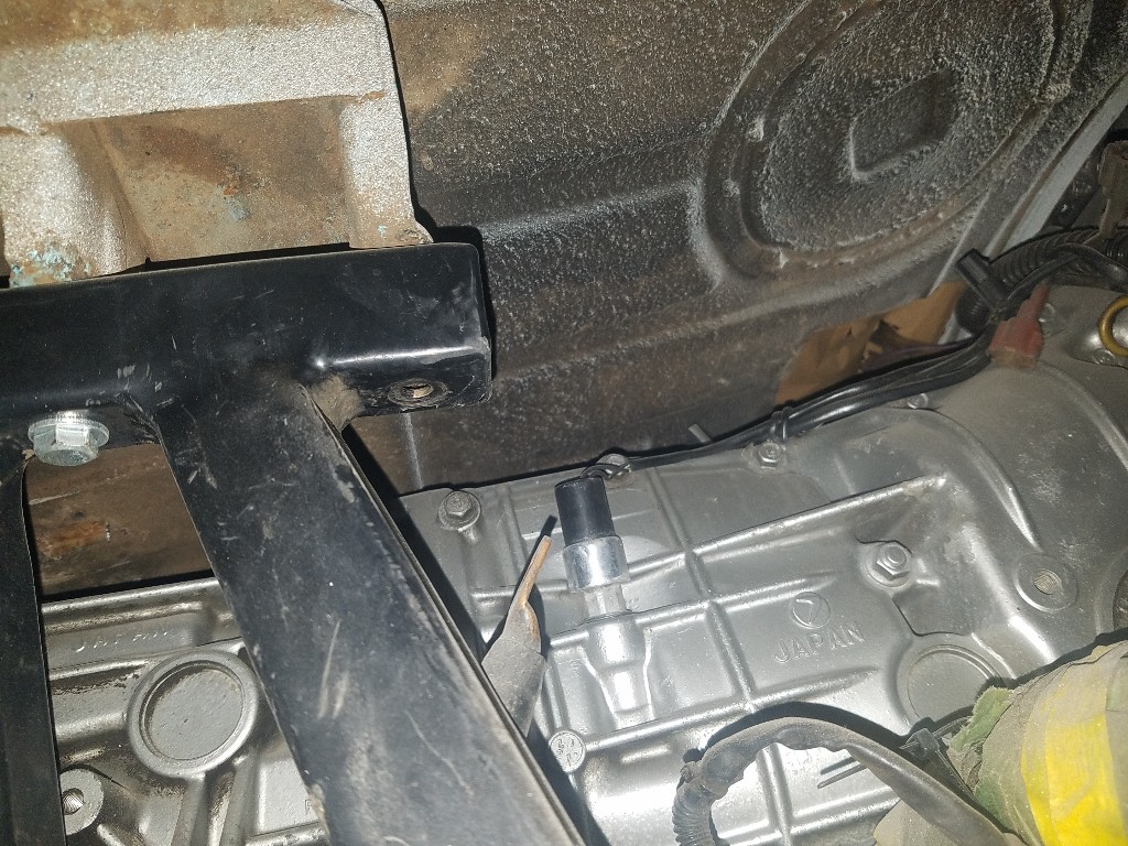

QUOTE(JRust @ Oct 27 2019, 09:01 PM) *
Went back through my paperwork. Looks like my Speedometer is not a GPS unit. It was run off the VSS going by what Dean wrote. Is that on the transmission. I'm going to need to figure out how to wire that back up. I may have sent that off with my old setup. Would that just be a wire coming from the sensor to my speedometer? Is it as simple as that?
Jamie your old setup has a VSS on the transmission. Rt side of transmission. black one in center of photo. Has a plug on the end of a short pigtail. Unfortunately I am planning to use mine or it would be in the mail. Using one you will need to program the speedo to correlate to the VSS revolutions it sees at the tranny. Supposed to be straightforward. I think you can auto program at speed if you have a pace car to follow. Hope this helps. Congrats by the way.

QUOTE(Costa05 @ Oct 27 2019, 07:53 PM) *
Perfect. Thanks bud. Yeah I am sure my tranny has the sensor there with a pigtail. So I just need to wire from that to my speedo. Yeah I have a calibrate deal so as soon as I can get the signal there. I should be golden
