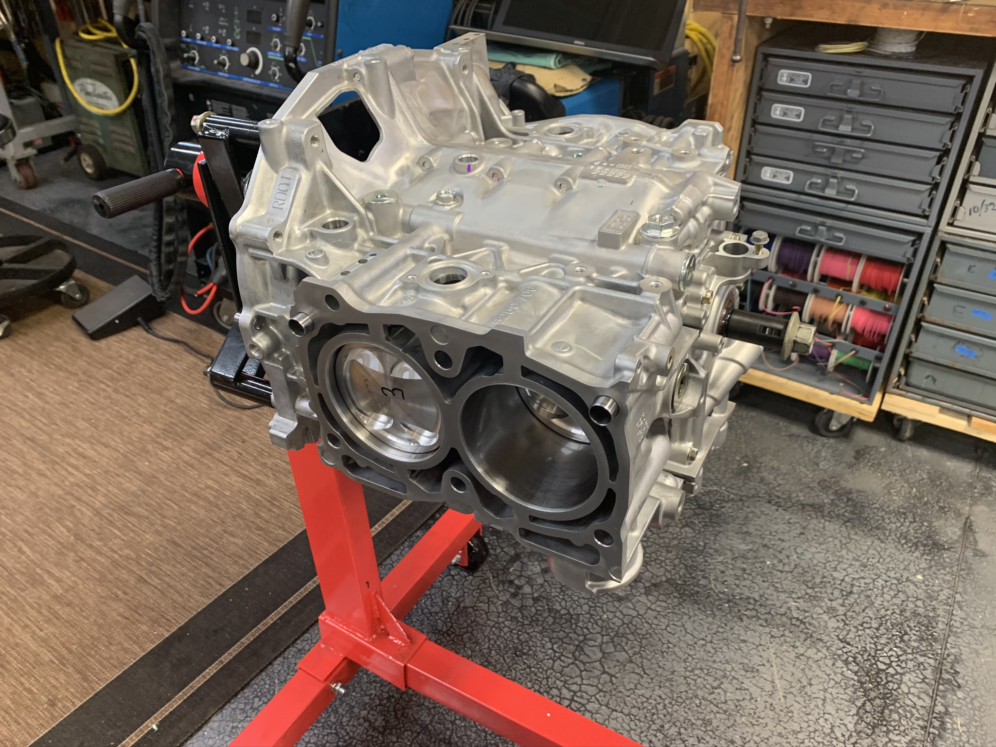

New is good for piece of mind. I was planning to just upgrade the rods pistons but once I got into my engine a crack in cylinder and "while I am at it" ended up in this!
Everything in the picture is new...except the crank bolt. I was just using the old one for assembly. I looked into IAG short blocks but they didn't offer a higher compression piston option and the lower stages used standard size pistons and no other machining, just new case halves. I need to update my build thread with the specs but it should be solid for something over 600 crank hp and I am into it for ~$3k including a complete gasket kit and upgraded springs and Ti retainers, because...8k rpm.
Granted I don't have a warranty and spent 100 hours researching, measuring, and assembling plus I will be a nervous wreck until it is broken in holding all the boosts but I saved a few grand and learned a bunch in the process.
Check with the short block supplier which oil pump to run and consider a cast impeller water pump. Not sure how you are going to source an engine harness/ecu but consider getting a throttle by wire unit and definitely confirm COBB Accessport availability.
Check my thread for ECU position and harness routing. There were only a few wires I had to lengthen to get it there. PM once you get into it and have detailed questions.

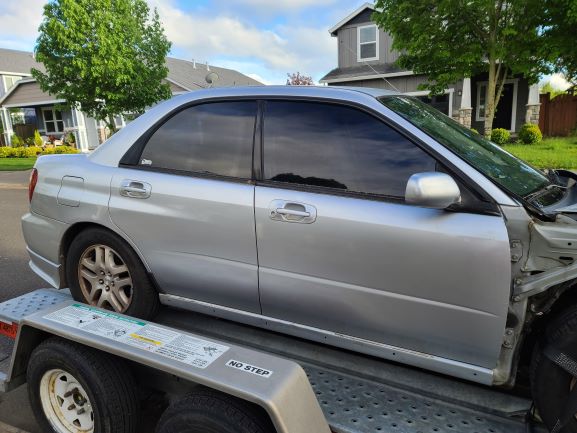

I keep changing. Found a JDM motor a guy wrecked his car. Got to hear it run so going to take the plunge & throw it in. Hopefully I can enjoy it for a while before I need to build a new motor

Okay haven't made any progress. Between buying a used JDM motor which turned out to be crap. Then different builds my shop suggested. Lack of money to really build a nice solid motor. I have been kinda stuck without anything to really get excited about. I've had a run of bad luck with my conversion to say the least. I always keep my eye's out for a deal. I came across a wrecked 2002 wrx. Nothing to special at first glance. Emailed the guy & made a trip up to see him. Turns out the motor has 25k on a full rebuild with a lot of goodies. No oil leaks & runs great. Dyno's at 308hp at 17lbs or boost. I've got a larger turbo but think I am going to run it basically as is. With it dialed in the way it is. I am going to just keep all my newer high priced stuff from my spun bearing motor. Hold onto it for changes down the line. Taking it to my shop tomorrow & will get a more informed opinion. Keep your fingers crossed everyone. I may just get to drive my car again soon
