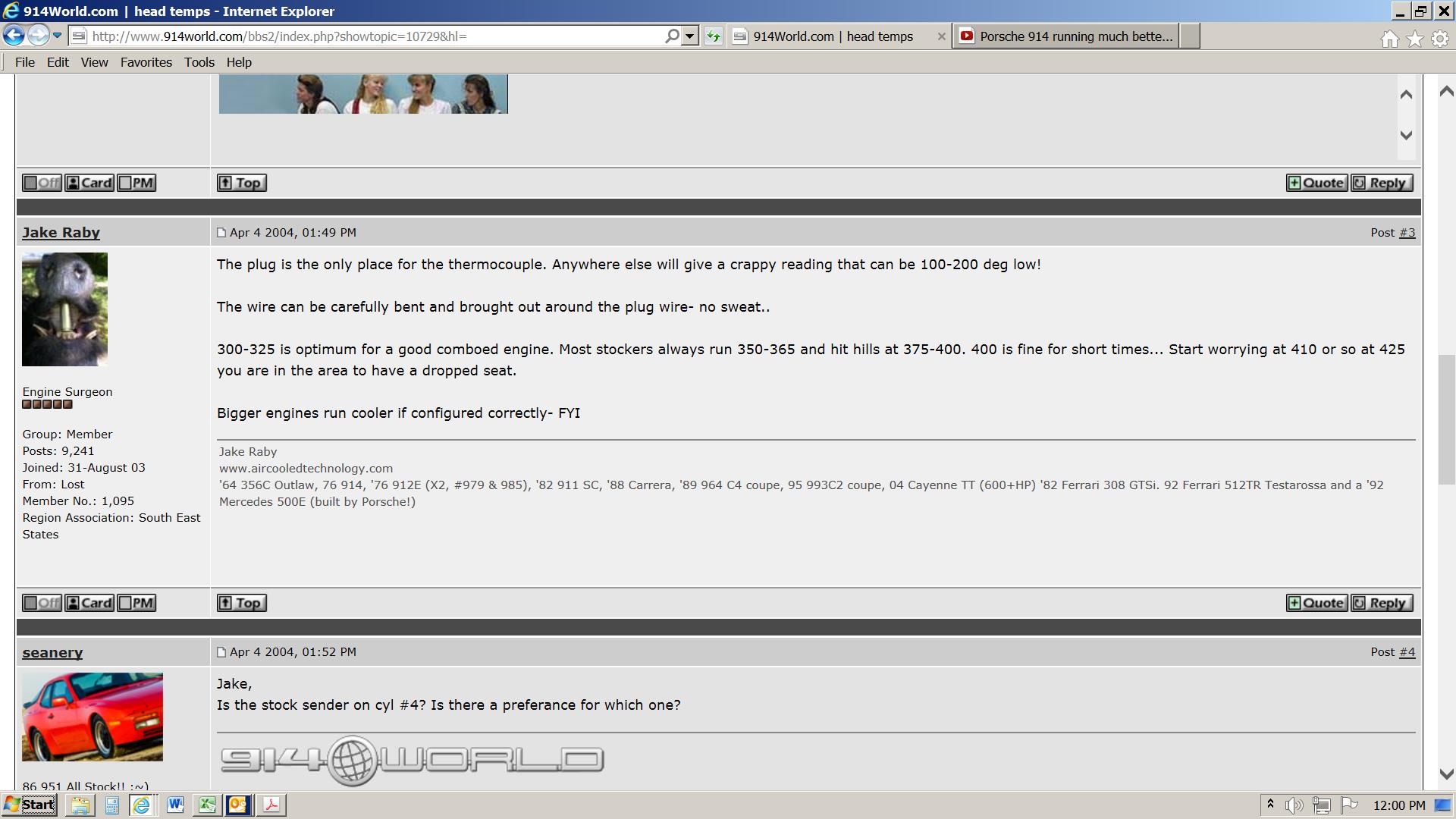

timothy_nd28   350 degrees is not normal, atleast I hope not. Re...   Feb 7 2017, 08:47 PM
malcolm2   350 degrees is not normal, atleast I hope not. R...   Feb 8 2017, 11:32 AM
malcolm2   350 degrees is not normal, atleast I hope not. R...   Feb 8 2017, 12:02 PM
Vacca Rabite   350 degrees is not normal, atleast I hope not. R...   Apr 27 2017, 09:13 AM
malcolm2   I'd love to see 350 at 70MPH running up some ...   Apr 28 2017, 06:29 AM

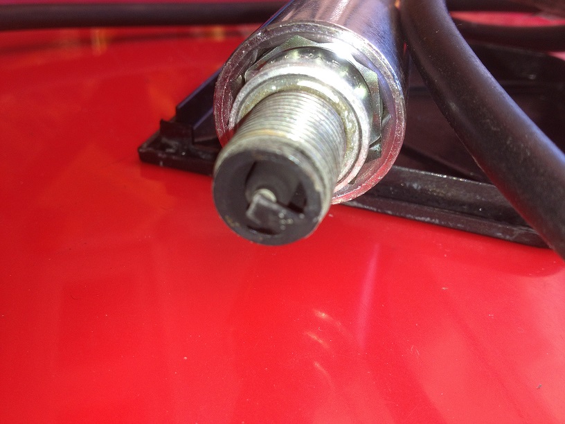

malcolm2   PLX is now installed. The guage is temp'd in w...   Mar 23 2017, 09:55 AM
