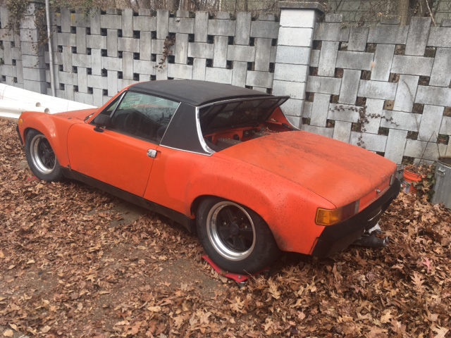

A very good friend on mine scored what I think could be deal of the century. He is a VW collector and has restored/modified many air cooled VW's over the years. He is not that familiar with Porsches and has asked me to give him advise as to what he has purchased and what he should do with it.

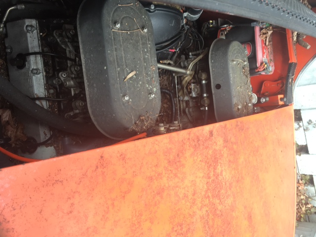

I got a call this past Sunday that he purchased a Porsche 914- 6 from an estate for $1000.00 !!! Of course, the first question I asked was what the serial number was to determine if it was a real "6". Turns out that it was a '74 converted to a "6". From the pictures it looks like it has an early naturally aspired 911 motor. My question is where is the serial number on the motor? We are curious as to how old the motor is and determine what the displacement could be. The motor does turn and there is no outward signs of rust including the Hell Hole.
Tomorrow I will accompany him to inspect further and take some more pictures. I would like to find the engine number at that time.

QUOTE(dcheek @ Feb 6 2017, 10:31 AM) *
Will I have to remove the right air cleaner?
Nope. Stick your camera in there and take some pics. You'll find it.

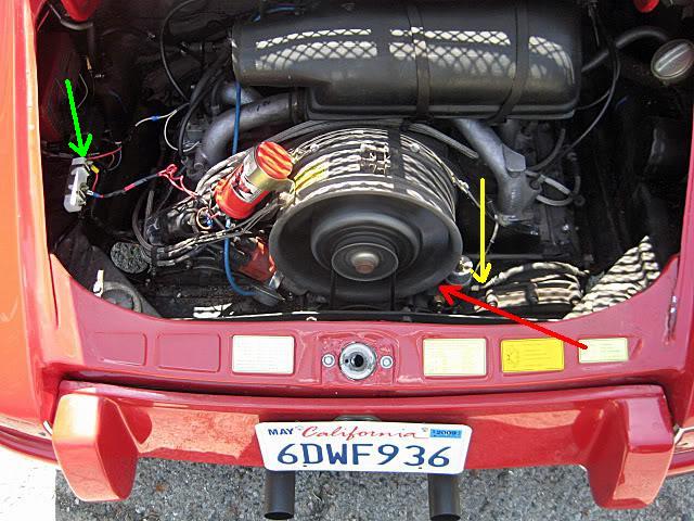

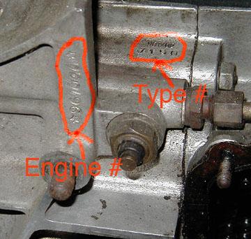

Google it.... "911 engine number location"
This is from Pelican. I guess it is gonna be tuff to see with all the leaves in there and with the engine turned around.
Post says RED arrow in the S#, yellow arrow is the type.
I also found this info for figuring out what the # means in the same thread:
6202183
This decodes as:
6 = Engine designation, 6-cylinder unit.
2 = 911E (Type 911/01 if manual transmission, type 911/04 if Sportomatic.)
0 = Model year 1970 (basically same as ’71).
2183 = Sequential number (Sportomatic would be 8xxx).
timothy_nd28
post Feb 6 2017, 03:32 PM
Posts: 2,299
Joined: 25-September 07
From: IN
Member No.: 8,154
What does the green arrow mean? (IMG:style_emoticons/default/confused24.gif)
malcolm2
post Feb 6 2017, 03:39 PM
Posts: 2,752
Joined: 31-May 11
From: Nashville
Member No.: 13,139
QUOTE(timothy_nd28 @ Feb 6 2017, 03:32 PM) *
I closed the page... but I think it was some kind of resistor.
