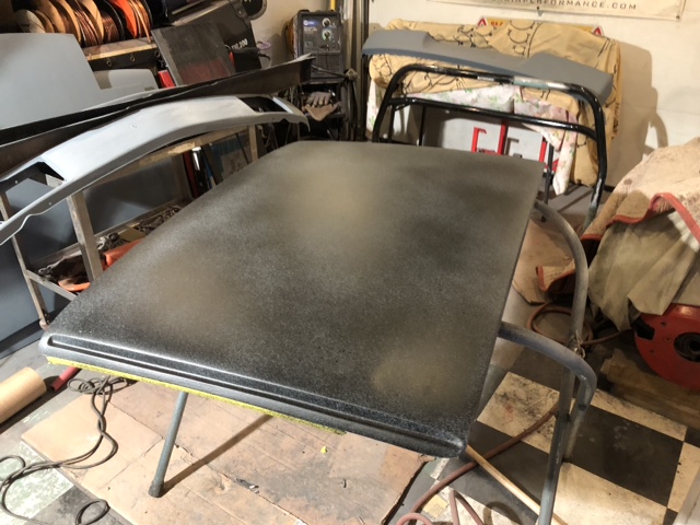

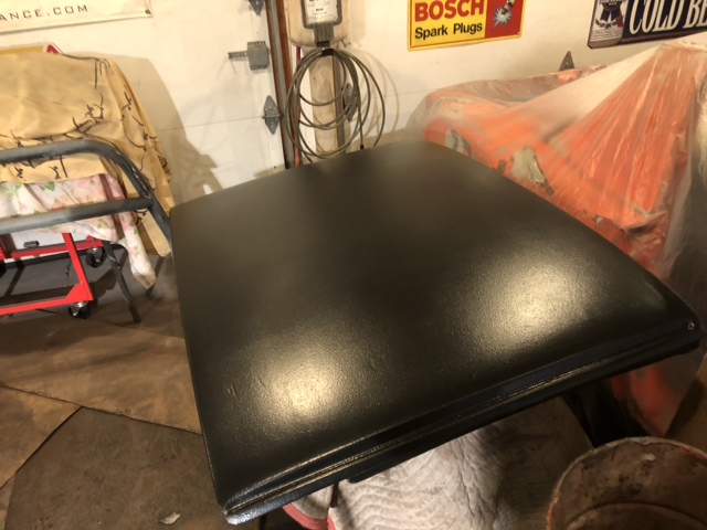

Refinished roof:

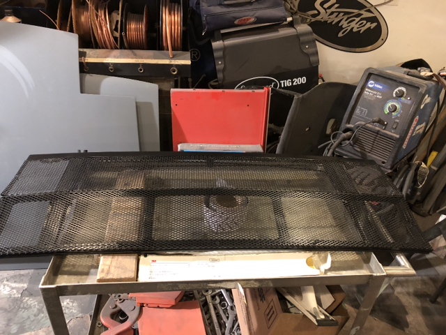

At the request of World members, warts removed:
KELTY360
post Feb 7 2018, 09:53 AM
Post #205
914 Neferati
Posts: 5,192
Joined: 31-December 05
From: Pt. Townsend, WA
Member No.: 5,344
QUOTE(dcheek @ Feb 7 2018, 07:51 AM) *
dcheek

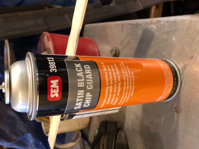

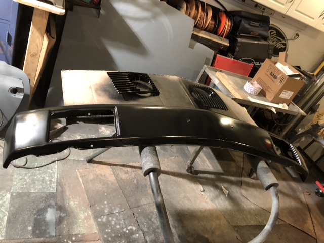

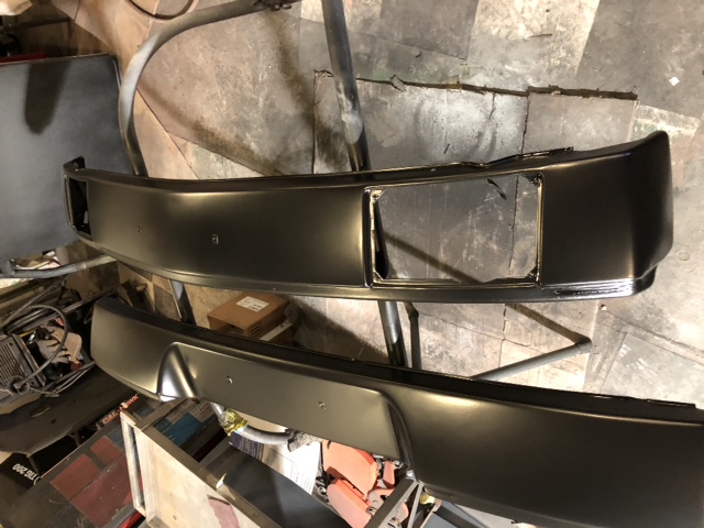

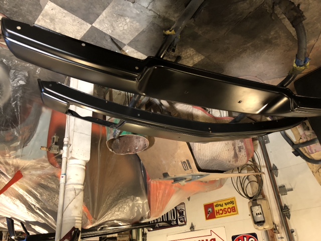

After applying the chip guard the satin black paint was shot on the roof.
I think the gloss is just about right. Don't you think?

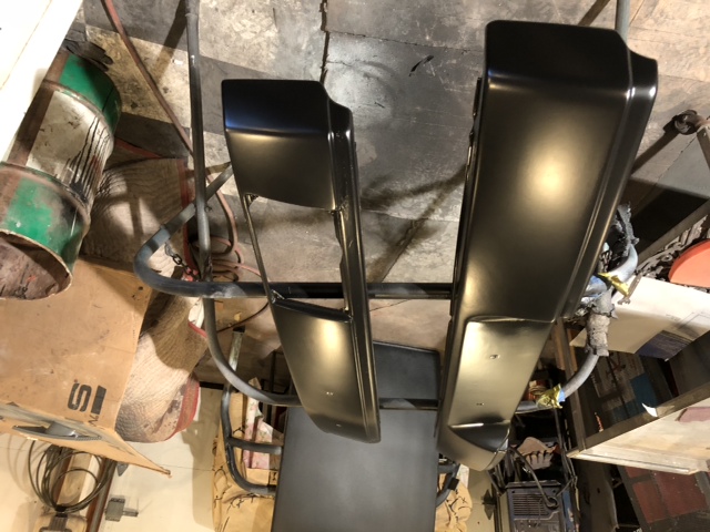

Proceeded to Satin Black paint the bumpers, grills etc.

QUOTE(dcheek @ Feb 8 2018, 03:08 PM) *
Looks great. I like the satin black. I've been using the VHT epoxy - chassis paint rattle cans in satin black. Used on bumpers, targa top, for sail panels, rockers, and front and rear lower valences, as well as the black chassis and suspension parts. It sprays really well when at normal room temperature.

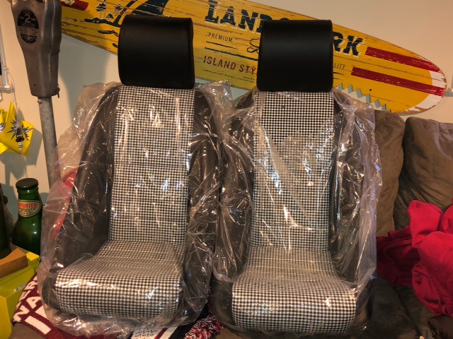

Chucked the racing seats and went with these.
post Feb 10 2018, 07:42 PM
Post #210
914-6 GT in waiting
Posts: 20,900
Joined: 19-September 09
Member No.: 10,825
QUOTE(dcheek @ Feb 10 2018, 08:17 PM) *
They look great. What brand and model are they?

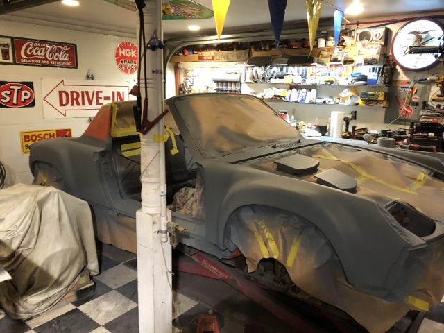

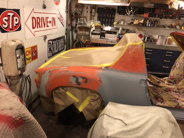

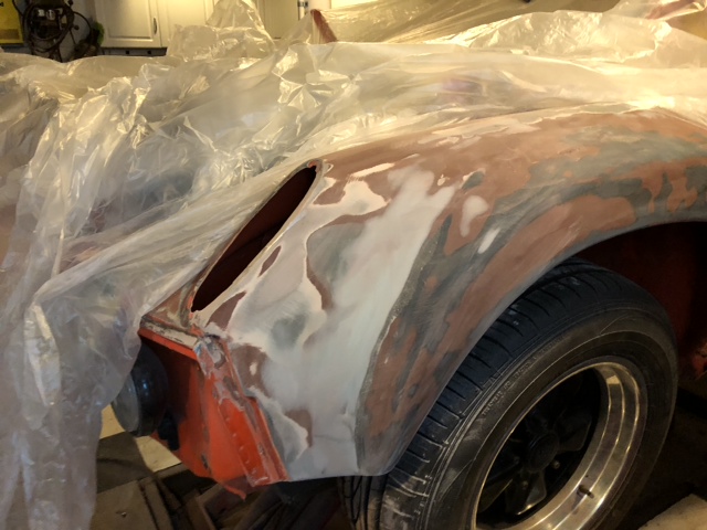

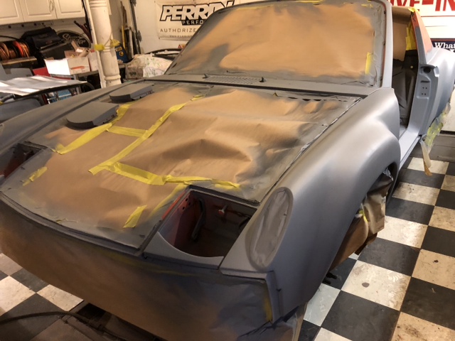

Primer sprayed and may the wet sanding begin.....

looking good! mine is about this same stage right now- finally sourced the chrome bumpers for front, should be coming from So Cal this week- i couldnt decide if i should do chrome or black- so i went with what i found first- will se how the chrome looks when i get it on- i like those black ones ans the top looks great too- i am wondering how the top looked before you re did it? did you sand down the original texture?

QUOTE(Philip W. @ Feb 11 2018, 06:58 AM) *
The original had scratches and chips and an uneven color so it had to be redone.
Here is the procedure my buddy did:
Sanded it smooth
Applied sealer primer
Applied chip guard
Painted Satin Black
Clear coated.
Dave

QUOTE(mepstein @ Feb 10 2018, 05:42 PM) *
Seats came from Classic Touring
Leatherette with houndstooth inserts
Made specifically for a 914.

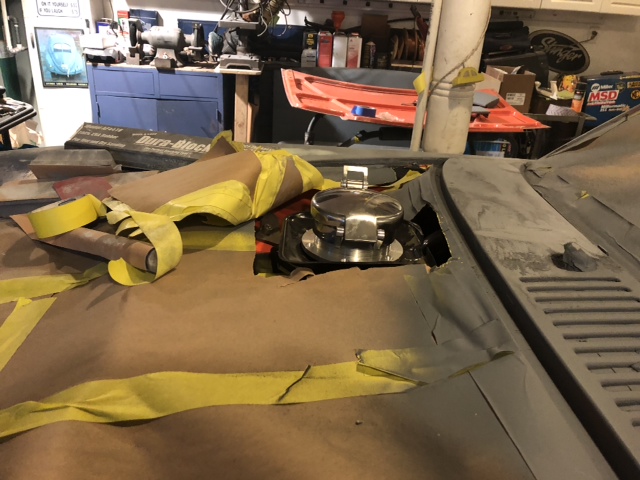

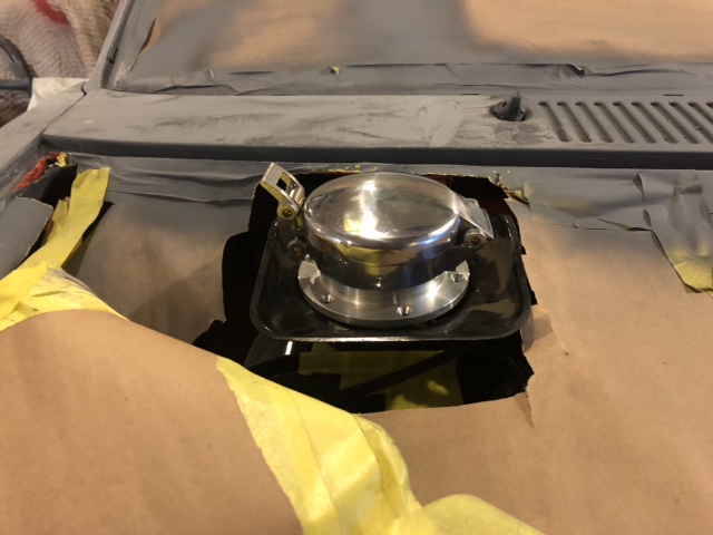

In the "As long as I'm in there category" the decision was made to add a through the hood fuel filler.
Dave
jmitro
post Feb 18 2018, 10:00 AM
Post #217
Posts: 713
Joined: 23-July 15
From: Oklahoma
Member No.: 18,986
that is awesome!
where did you get it?
thieuster

QUOTE(jmitro @ Feb 18 2018, 08:00 AM) *
that is awesome!
LeMans Cobra Porsche Outlaw gas cap from Ebay.

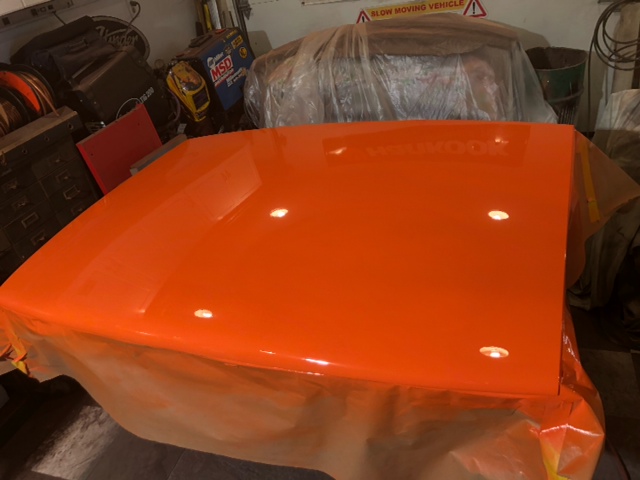

The weather in New Jersey has not be conducive to painting so, progress has been slow. We are expecting yet another Nor'easter with 6-12" of wet snow and high winds. What a way to usher in the first day of spring!
Tested paint on trunk lid. Sprayed 4 coats of single stage and it came out fine. When the weather breaks the car will be trailered to a body shop with state of the art spray booth. Then it's on to wet sanding. Love the color!! Can't wait to see the whole car painted.
