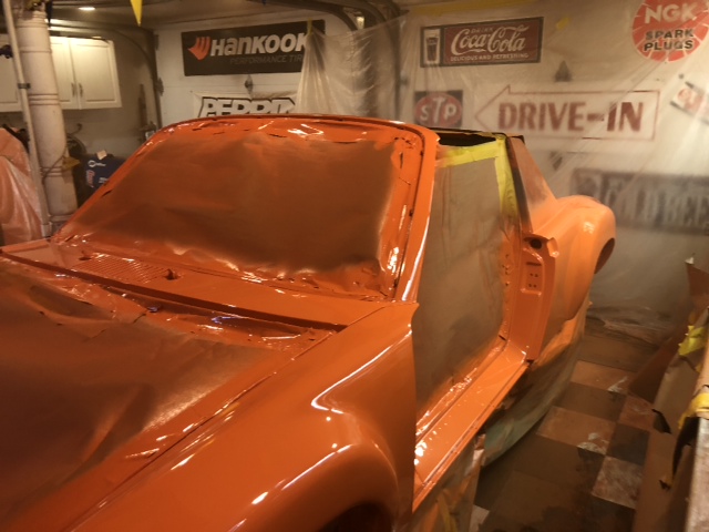

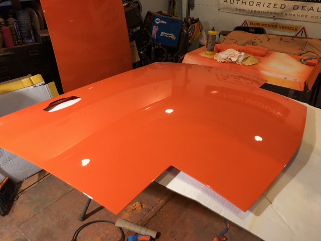

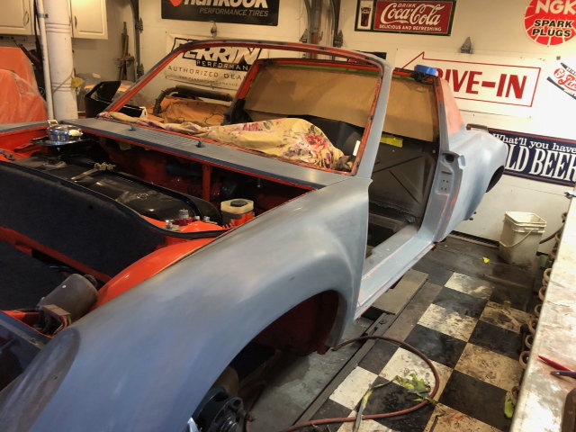

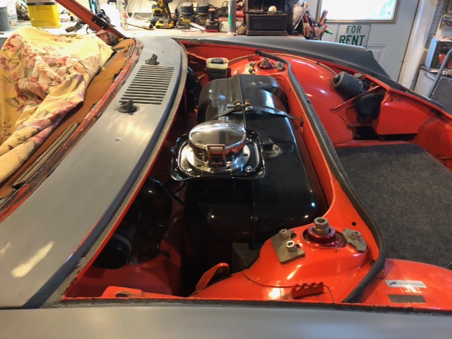

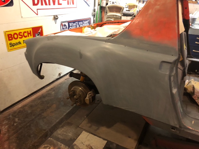

One week before going into the paint booth. Yes, a downdraft booth for a defect free finish on the body shell. Getting to use the paint booth for free.
Fronk painted and external fuel filler done.
Hood painted and polished - Note cutout for fuel filler.
Body shell all primed and wet sanded - ready for the booth
It won't be long before the Phoenix (red) will rise again!
Dave

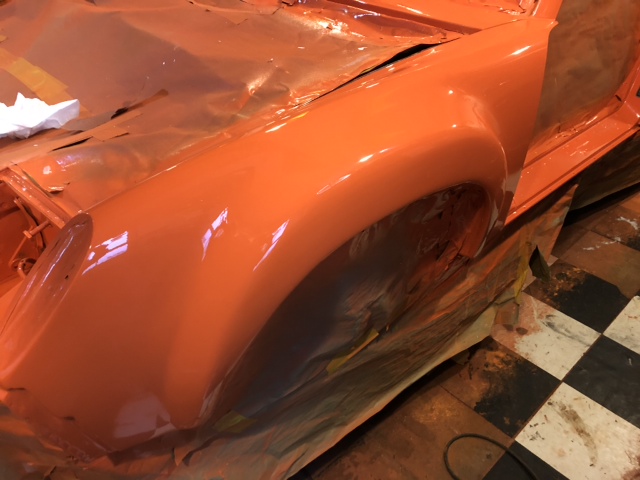

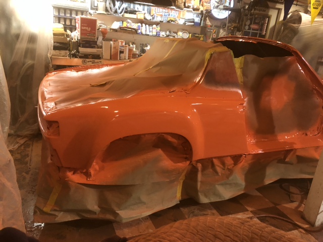

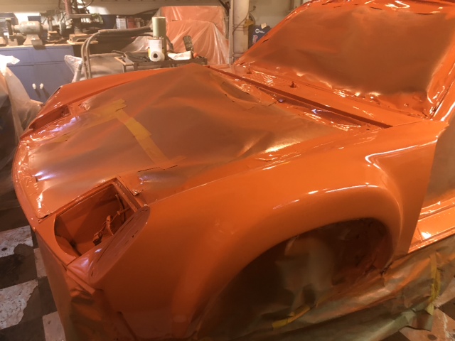

Couldn't wait for spray booth time so car was painted in the garage. There are a few minor blemishes that can be wet sanded out (single stage paint).
Can't wait to start re-assembly.
Dave

What was the reason for using single stage? More original look, or something else? I'm asking because I have no painting experience, but contemplating doing my own paint when the time comes. It seems like most are going with basecoat/clearcoat these days.

IMHO single stage is more forgiving, or easier to fix blems, not to mention less work. My buddy who is doing this car, worked for a body shop for many years. Given the option for an older car, he chooses single stage every time. Plus, that's what they used in the day.
Dave

The Phoenix Red looks pretty orange in the most recent pictures you posted. Is it really that orange? I like the color a lot.

The pictures are a little off but, Phoenix Red is more orange than red.

Phoenix Red is actually an orange color, not a red. It's partway between Signal Orange and Tangerine.

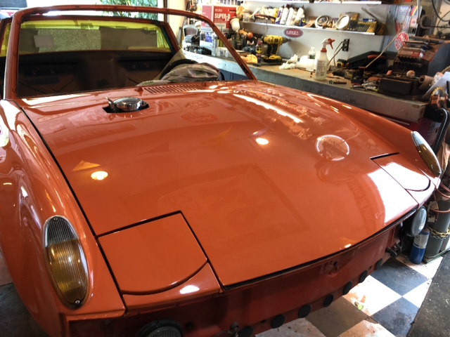

May the assembly begin.
All painted surfaces wet sanded and buffed out.

Looks great! Nothing better than a freshly painted 914. You probably know this but the front turn signal lenses are upside down.

Um : your lenses are upside down!

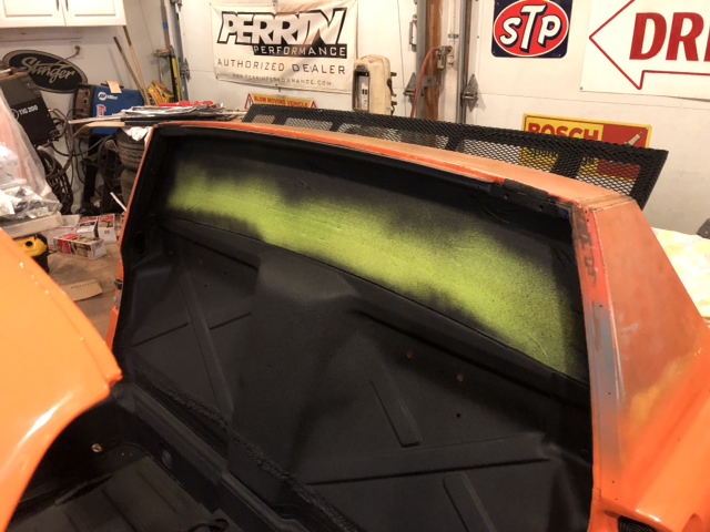

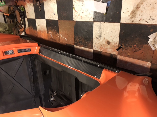

Rainy day in the Northeast so there is time to continue the the reassembly process.
Painted the interior black.
Riveted in new threshold plates. Now its time for carpet. I posted a thread in the Garage to see if anyone has the installation/gluing sequence.

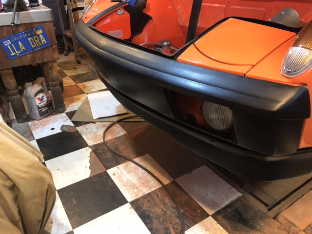

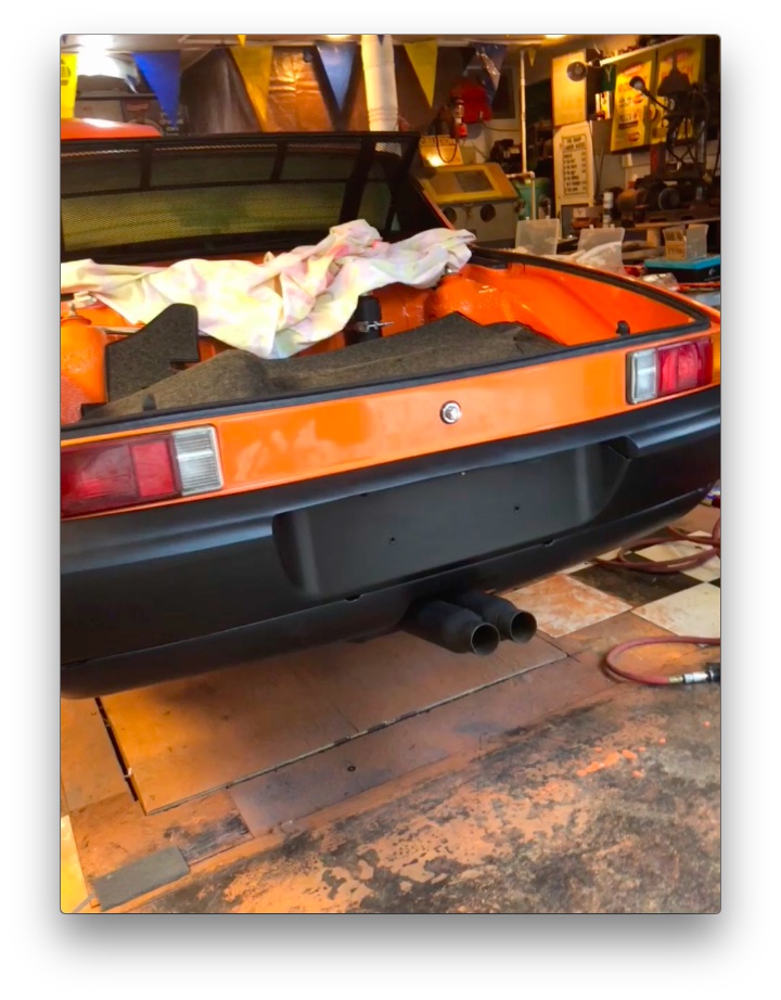

Rear bumper with new rubber top. Expensive but looks great.
Note rear valance was modified to fit center exit of exhaust.
Front bumper installed with AA "plastic" bumper top. While it's a fraction of the cost of the correct rubber part, it doesn't look as good as the rear. This will be replaced.
