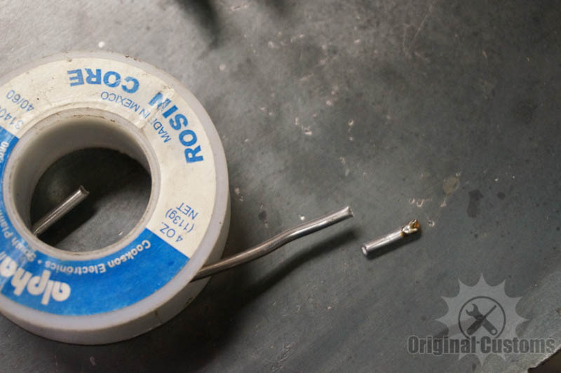

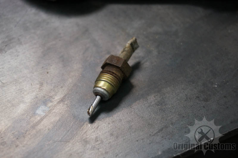

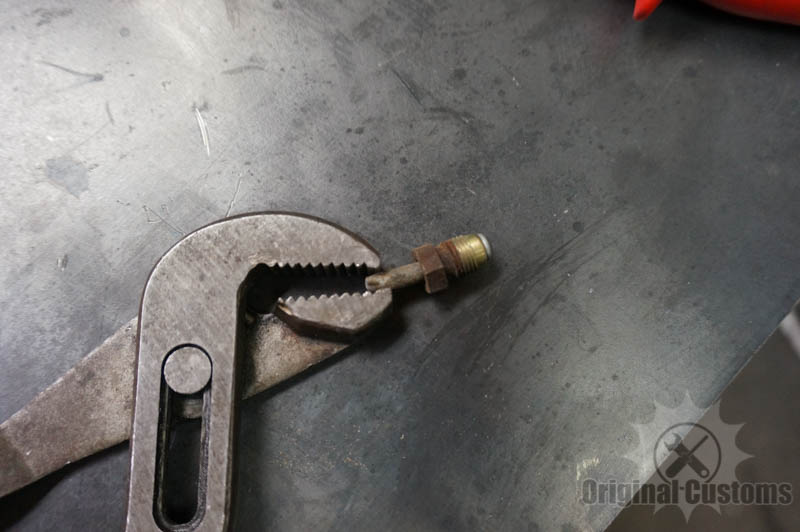

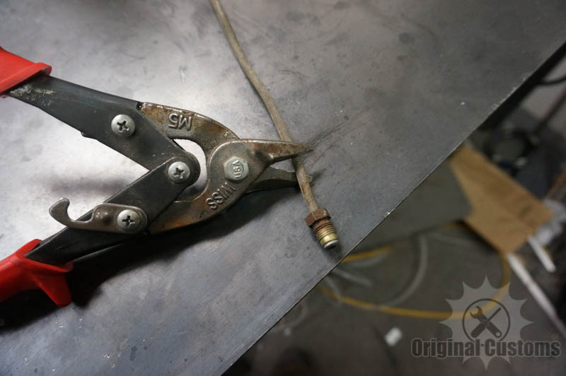

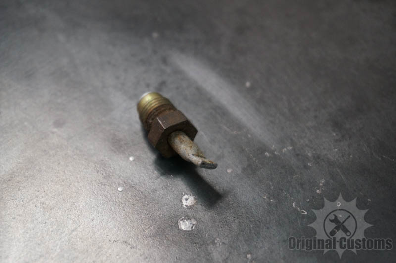

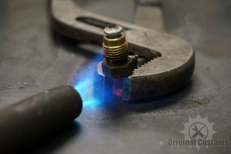

I don't think I ever posted this tutorial with pictures, but I've mentioned it a few times.
These plugs are useful for anytime you're working on your brakes and are really easy to make. If you're pulling your calipers you can install these in the ends of the soft lines to keep them from dripping. If you're replacing your master cylinder these will let you bleed the MC. Keep them handy. You can use a similar process with the female fittings on an old rubber line to make female plugs. Here we go! First snip a section off of an old brake line, or a universal bubble-flare line from the parts store. Crimp the end shut, to keep the solder from running out when it's liquid as well as to keep the nut from sliding off the end when not in use. This is plenty of crimp. Cut a small piece of thick solder that will slip inside the tube. Slide the solder into the tube, and let it drop down to the crimped end. Using a pair of pliers or a vice or any other suitable device, hold the brake plug upright as pictured and heat sufficiently to melt the solder. In this case the crimp was glowing slightly red hot. Let cool or spritz with water. And make as many as you need. ![]() |
