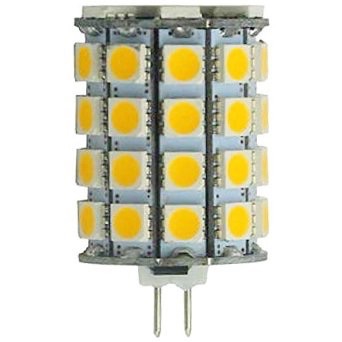

George (OP),
I wanted my freshly restored fog lights to remain stock, but take advantage of modern LED technology. I looked for a warm color temperature LED bulb that fit the original socket but could not locate anything so I made my own.
It wasn't that hard and I'm really happy with the results.
I unfortunately took no assembly pics but I'll do my best to describe the project.
Found these LED bulbs on Amazon 2 yrs ago - 6 watts, 550 lumens, 3000 K color temp. and 12 volts. All I had to do was mount them on my old stock bulb bases.
https://www.1000bulbs.com/product/113698/PLT-300221.html
I took the stock bulbs and used a heat gun to separate the glass bulb from its base. Once you get the base hot you can carefully twist the glass element back and forth(with gloves) to loosen it from its base. Then disconnect its leads by melting the solder on the bottom contact points of the base to completely remove the bulb leaving an empty base.
It would be easier If you could source the correct blank base as a starting point - but these are an old, unusual base type and I could not find them.
I cleaned out the remaining adhesive from the base (a powdery residue) and soldered thin insulated wires to the new LED leads to extend them about 1/2" longer than the length of the empty base. You want the stripped ends of your new leads to pass through the electrical contact points on the bottom of the old base so you may need to drill a small hole through any remaining solder. IIRC polarity did not matter with these LED units.
Leave yourself about 1/4" of space between the top of the metal base and the bottom plate of the LED assembly once the new leads are soldered to the bottom of the base. That will leave you just enough room to inject clear epoxy into the base before seating the LED assembly on top of it.
When the epoxy dries you have a solid, complete LED bulb assembly that fits perfectly in the stock foglight sockets! These bulbs are equivalent in brightness to a 50 watt halogen lamp and have a warm vintage glow like stock bulbs.
With respect to mounting a brighter LED bulb in an "incandescent" housing, keep in mind that the stock foglight retains an upper beam cutoff guard and these bulbs project a 360 + degree pattern which hits the stock reflector in similar fashion to a stock bulb. Theoretically they should not blind oncoming drivers and provide a very similar beam pattern as the stock bulbs.
I am very happy with the results. My objectives were achieved: stock appearance and fit, brighter more effective light output, warm vintage color temperature (not white or bluish light), less drain on the electrical system and longer life.
Hope this inspires others to try it.

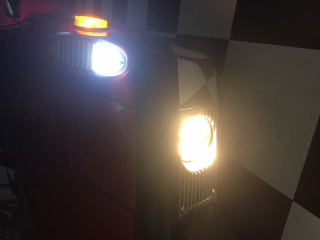

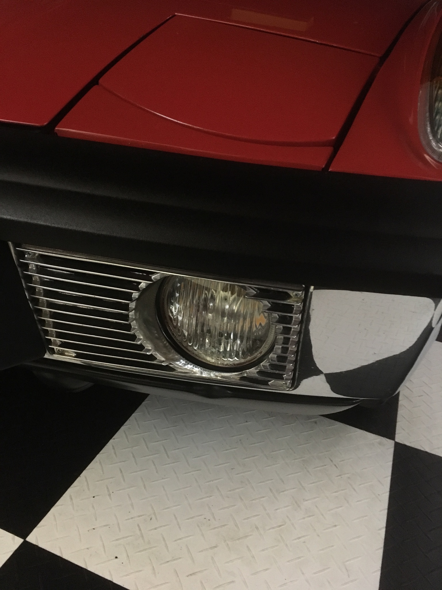

Here's a shot with the lamps off. You can just make out the reflection of the individual LED devices in a close up mirrored in the fog's reflector.
And here os with the fog lamps on. Notice the color vs the LEDs in Spokes turnsignal conversion, which are a more common LED color.
BTW, I use the euro version with the LEDs as my Day Time Running lights. If traffic is really crazy, I put the fogs on as well!

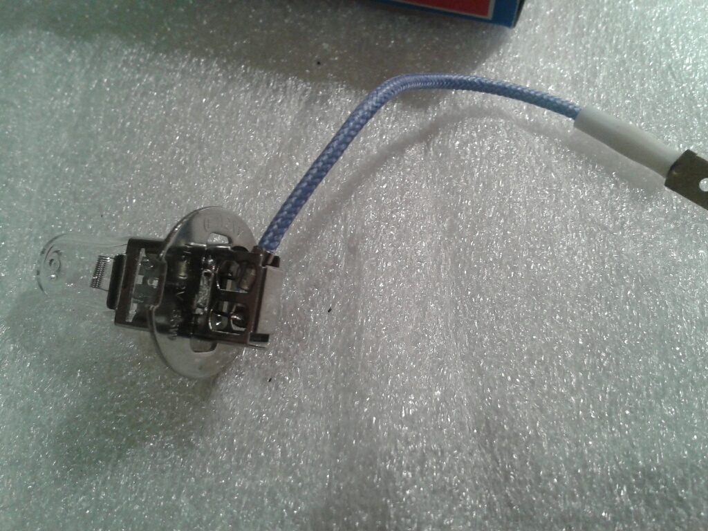

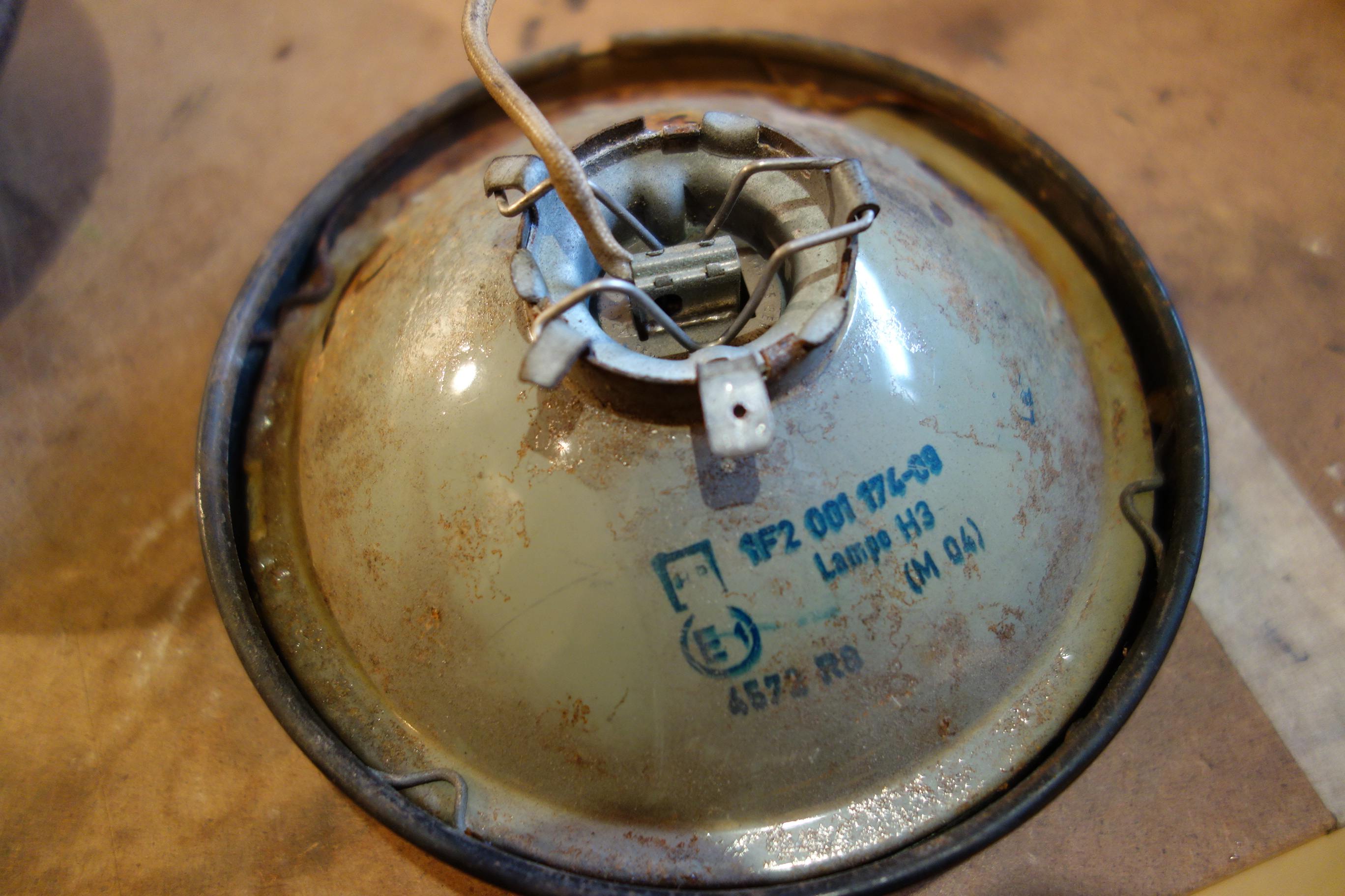

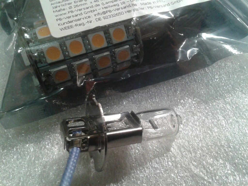

Scott /Anyone !
do you have a picture of a typical bulb that would go in the fog lights?
I read this thread and bought similar LED bulbs and looked at it tonight and it wont fit into the square central hole ! So i'm wondering how this as done?
Chris.

Firstcar
post May 11 2017, 05:10 PM
Obsessive amateur mechanic
Posts: 99
Joined: 17-March 11
From: MA -South Shore
Member No.: 12,831

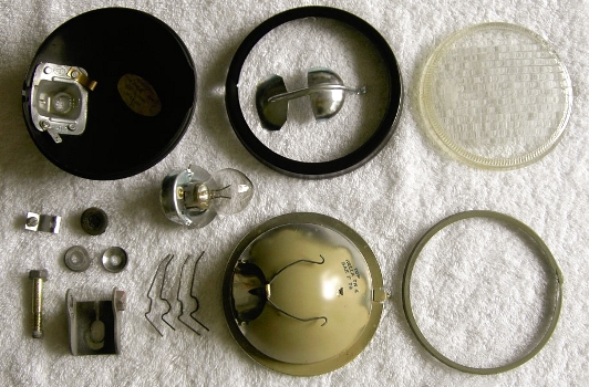

Chris,
I think you have a different foglight than what came with my car. Here is what I have and the incandescent bulb that came with it. Perhaps you have an aftermarket light. I don't think the US makes cars had halogen foglight bulbs.
-Scott

Chris,
Your light might be a slightly different version of the Hella 118 light. It looks like it uses an H3 bulb (~55 watts). This lamp was often found on European cars. The US version of the Hella 118 used a 35 watt incandescent bulb--which also required a different reflector assembly (larger hole). If you have a picture of the lens/back of the lamp body we can tell for sure. FWIW, I've got part numbers somewhere if you're interested . . . .
Hope this helps!

Steve/Scott
Thanks for your replies. That makes total sense now. I didn't realise it was so different from the Euro spec lights.youre right, they are 55W. Back to the drawing board....
Do we know if you can get an LED replacement for a 55W type bulb then?
