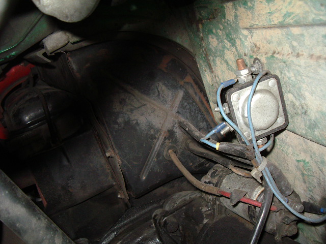

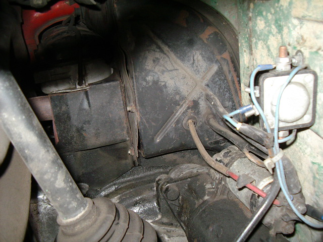

Ok, I got under there, every connectionseems clean and tight, I went to cross the terminals with the screwdriver and wtf, no big yellow wire terminal, mine looks different. See pic, what in hell is the little square box? Is it a "hot start fix"? And if so, is that where I try to make it crank? Oh, and last of all, do I need to have the key on while doing this? Thanks guys, not so bright when it comes to auto electrics, sorry. Sorry to keep pounding away on this but I'm driving to San Diego on Friday 5/13 to have Dr Evil help me get the car GUSSIED UP...DO YOU BELIEVE IT??? Thanks. Jim

Jim? Were you going to post a pic so we know what you've got? (IMG:http://www.914world.com/bbs2/html/emoticons/wink.gif)

I'm trying to resize the photo so it will load properly, this sucks, Im a poor mech and not too good with the computer either...

one more

Looks like you've got the "ford soleniod hot start problem fix". Same one I have, works perfect. My guess would be a bad sarter/solenoid. Get a new bosch unit & call it done.

Looks like yer band aid has done it's job.....get a Bosch SR 68X and move along.

The previous owner had installed a hot start relay in mine as well. It was the first thing I ripped out. Fixing the connections and ignition switch made everything work like new without the band aid.

The PO installed one of those in my 912 and it had a 15a fuse in there somewhere. I blew a fuse and thought I fried the starter, so I got ready to replace the starter, got under there and found the fuse... it took about 2 minutes. so check for fuses.
