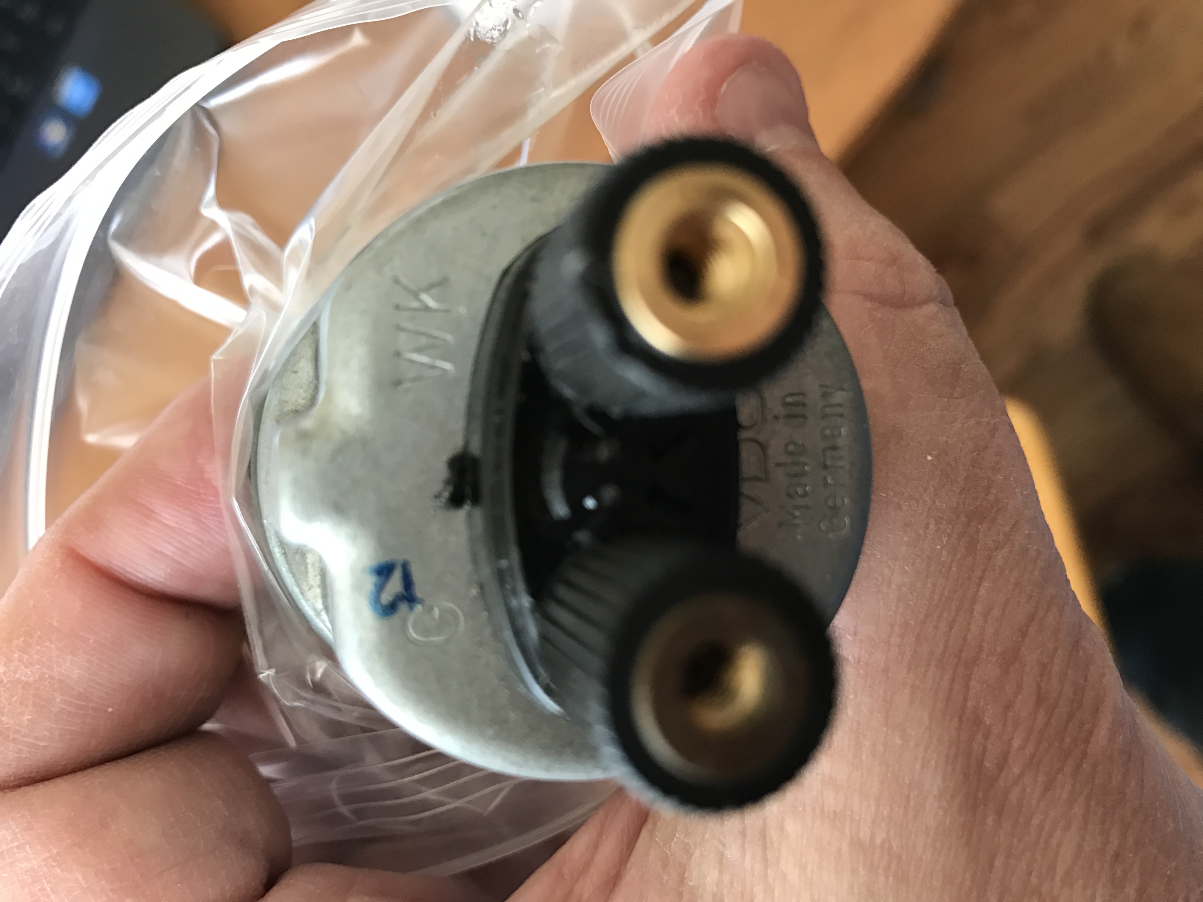

I sent my gauges and senders out to Palo Alto to have them calibrated. When I removed my oil pressure sending unit I failed to keep track of where the wires go. One is labeled "G" and the other is "WK". One of these goes to the gauge and the other goes to the engine wiring harness.

Usually they both go to the gauge, but IIRC G is just a direct ground.
Are you sure it's just one wire to the gauge?
Likely one wire was already there through the harness and only one extra wire was needed to be run.
edit: brain fart moment and now the pic came up for me, that's a aftermarket VDO combo sender.
G is the idiot light, WK is the gauge.

Yep, that's a 2 in 1 deal. This sender has both, a 7psi oil idiot light terminal and a oil pressure terminal for the gauge.

Yea, I ran a dedicated wire up to the gauge. The other wire was from the factory sending unit.

QUOTE(Mark Henry @ Mar 22 2017, 09:29 AM) *
Wrong way around. G is the gauge, WK is the warning light.

I always remember it G stands for Gauge.
