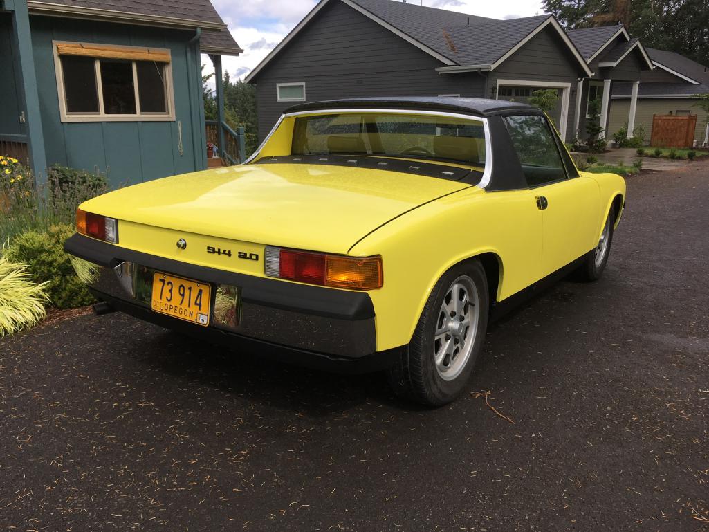

Realized I hadn't posted the most recent pictures here yet. Still plenty of small items left on the punch list (link in my signature), but getting close now.
(IMG:http://www.914world.com/bbs2/uploads/post-20799-1505963452_thumb.jpg)
(IMG:http://www.914world.com/bbs2/uploads/post-20799-1505963471_thumb.jpg)
