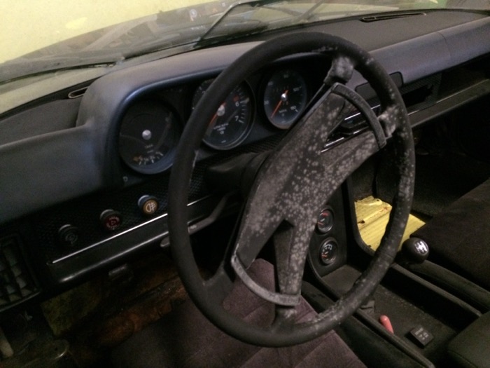

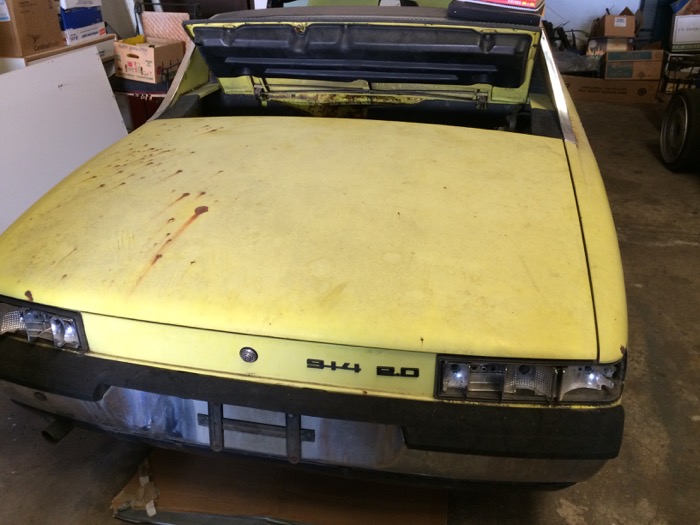

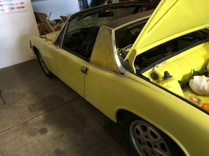

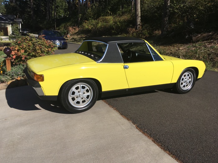

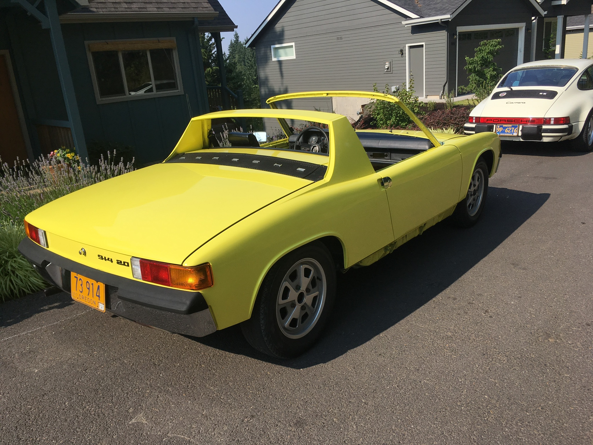

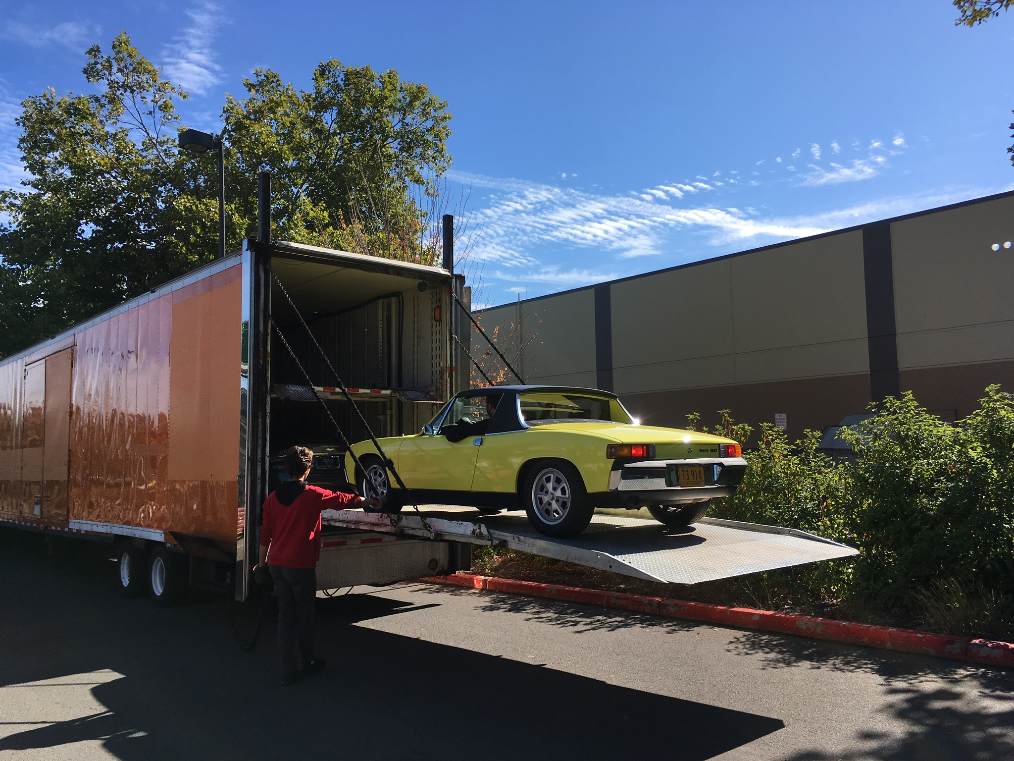

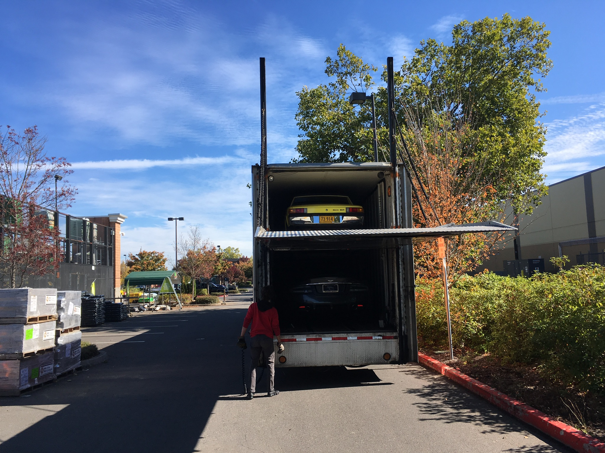

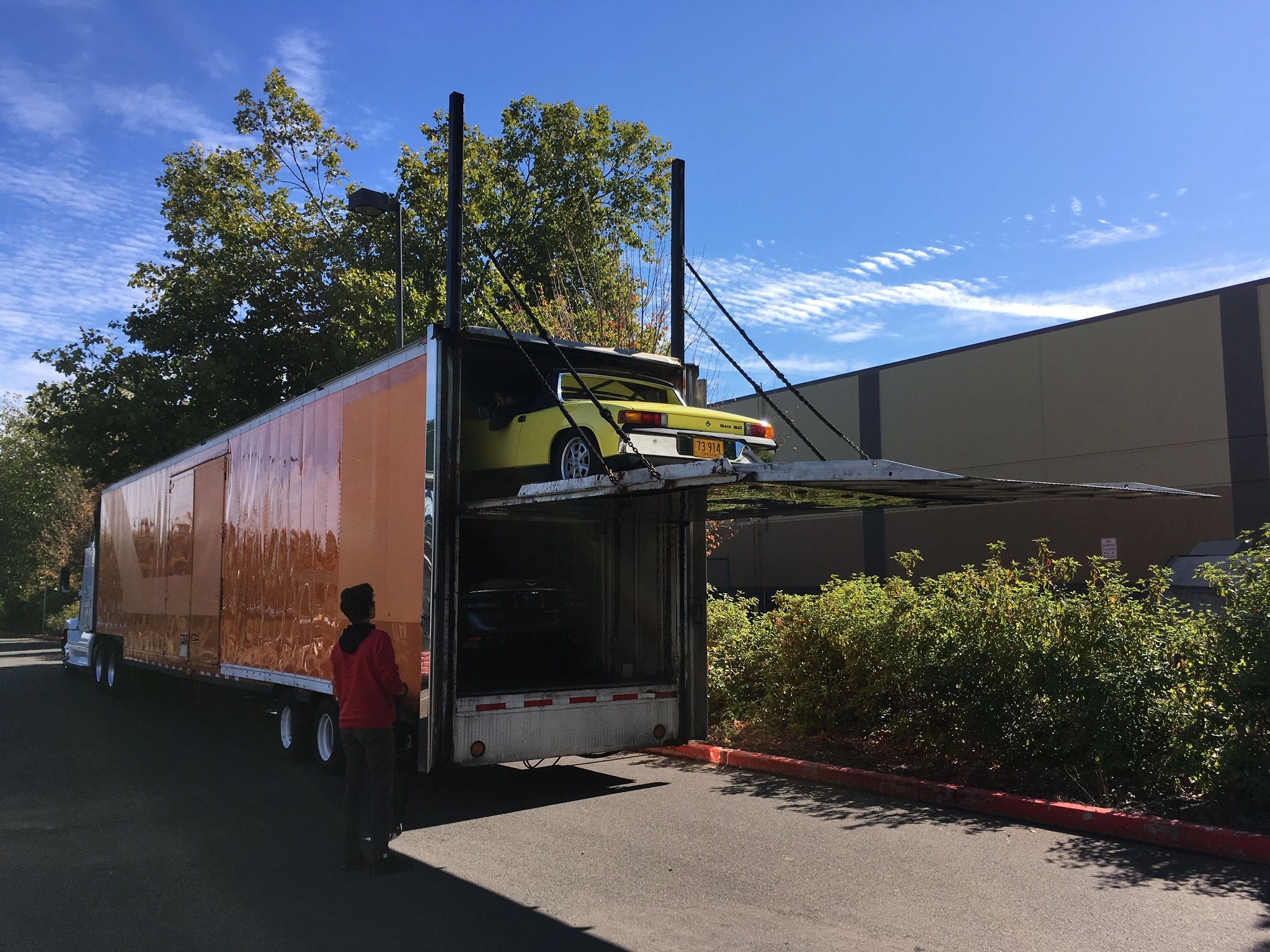

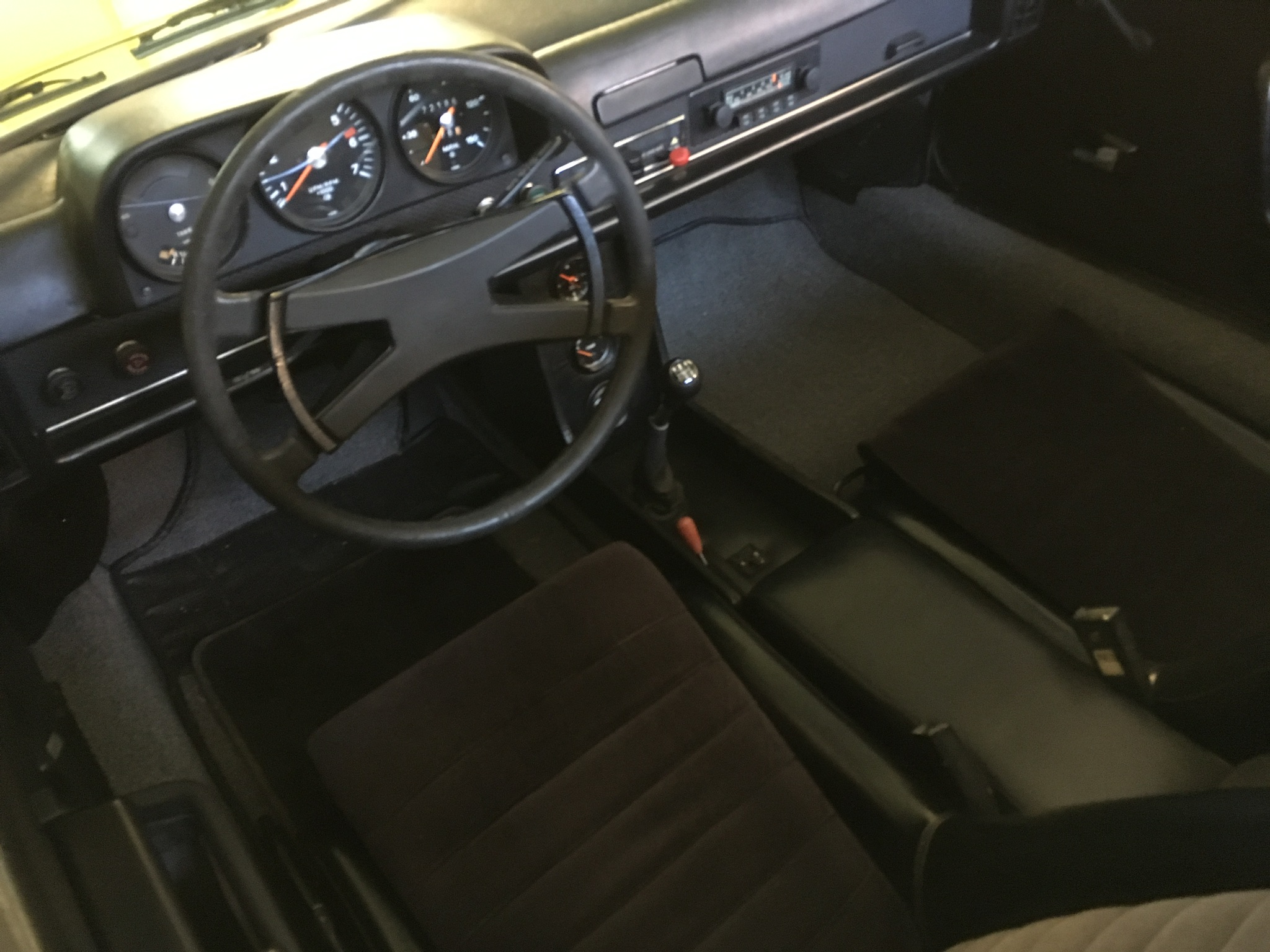

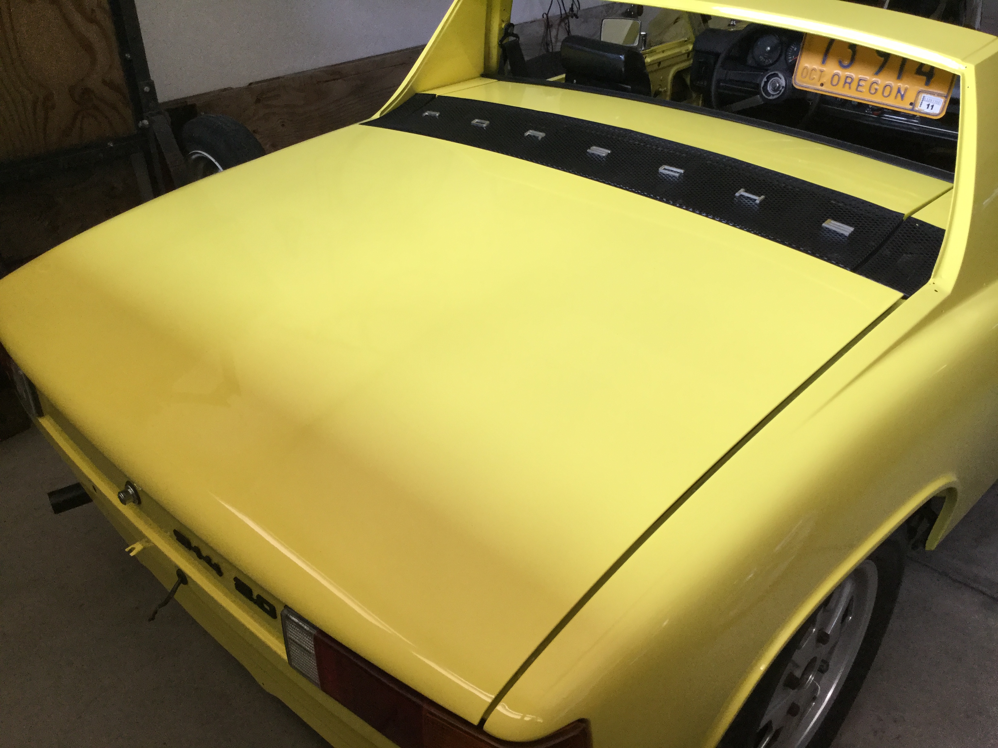

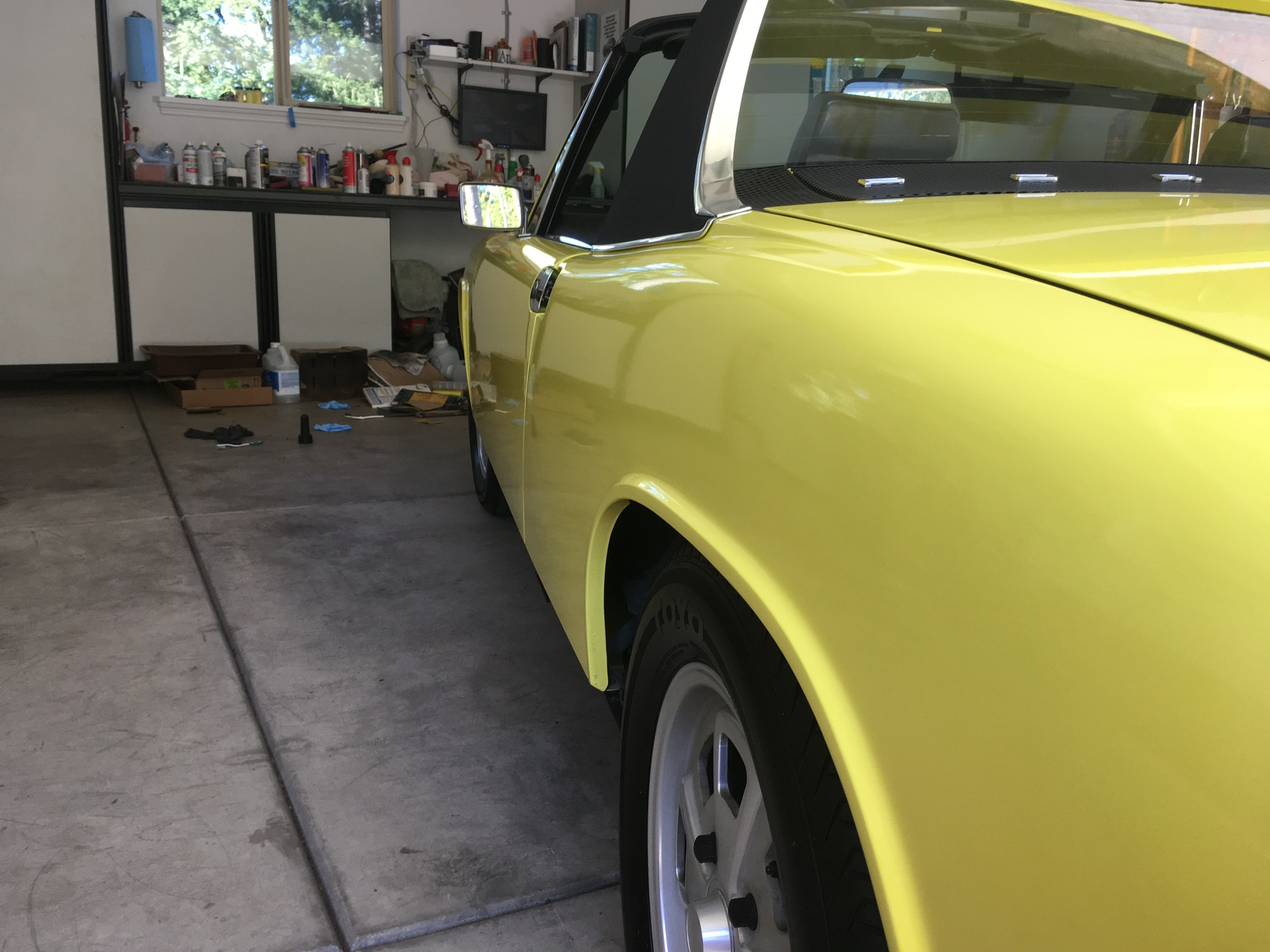

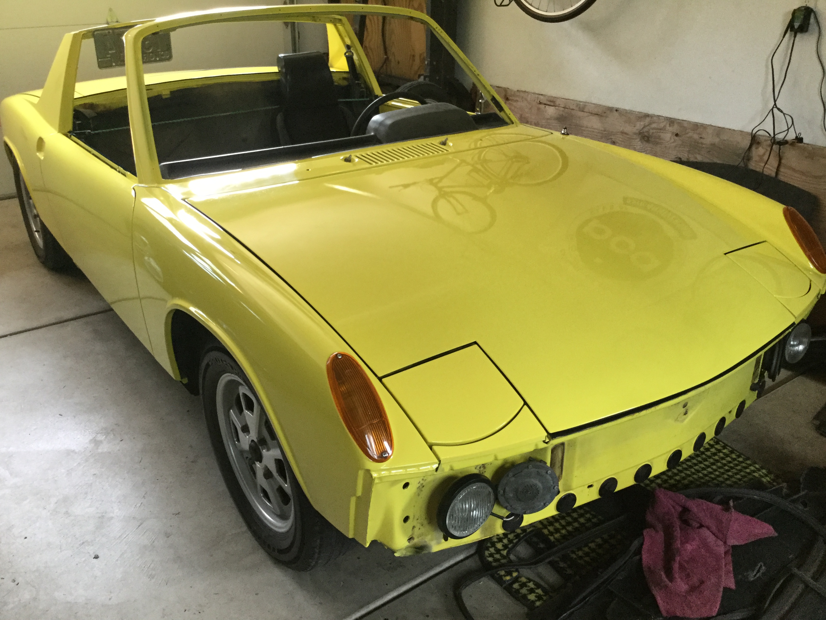

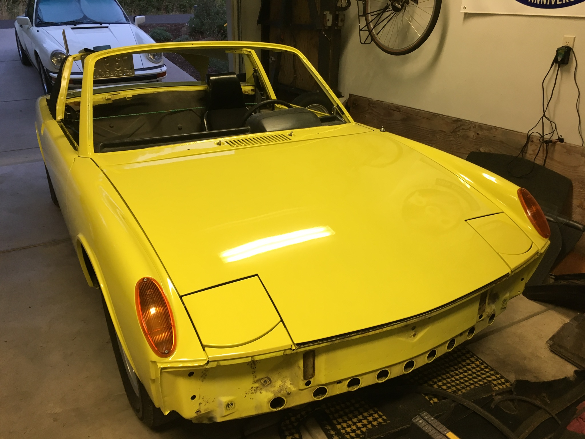

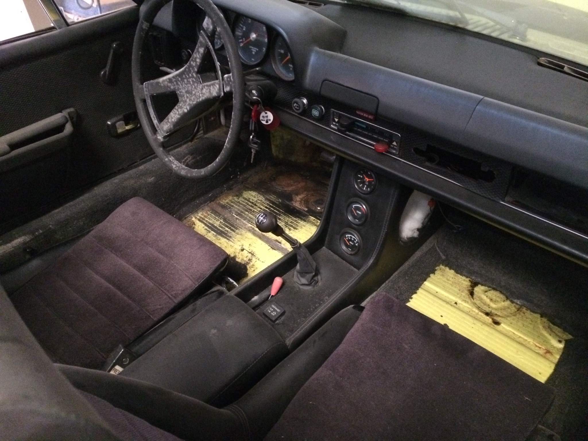

Well, as I posted at the end of my intro thread ( http://www.914world.com/bbs2/index.php?sho...=303932&hl= ), I bought my 914 over the weekend. We've all heard of barn and garage finds, this car was found in a large storage unit.

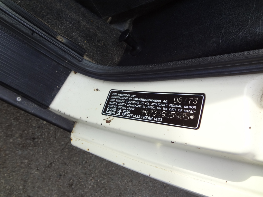

Details - '73 2.0, 4732924138, yellow. Appears to me to be Saturn or Chrome yellow, but I never looked at the paint plate to say for sure. Will confirm that and correct later. Confirmed, L13M, Saturn or Chrome Yellow. Odometer shows just over 72k miles, seller claims that is correct, but I haven't gone through the paper trail to verify. The car does look like that could be accurate. I am the fourth owner.

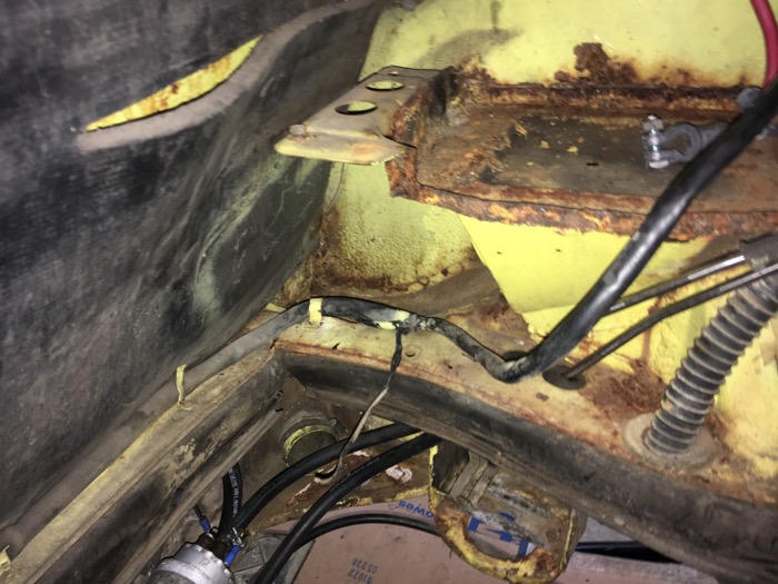

Rust seems limited to the battery tray, passenger floor and right sail panel (where water obviously got trapped behind the vinyl). The hell hole looks solid at this point. None of the rust appears to be holes yet. Definitely some work to do there.
The car was said to run when it was parked in the unit, other people not involved in the sale confirmed that it drove in under its own power. Been sitting for 6 years or so. After it got in, the seller began very rudimentary prep for restoring it, but life got in the way. So about all that was done was to pull all the lenses off.
I'm waiting for a flatbed to gather it up now, should have it in my garage later today. Here are a couple of pictures to show the beginning.

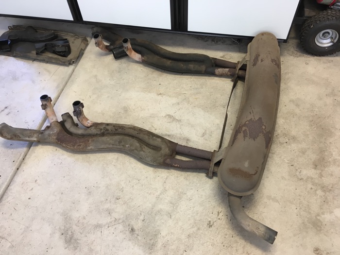

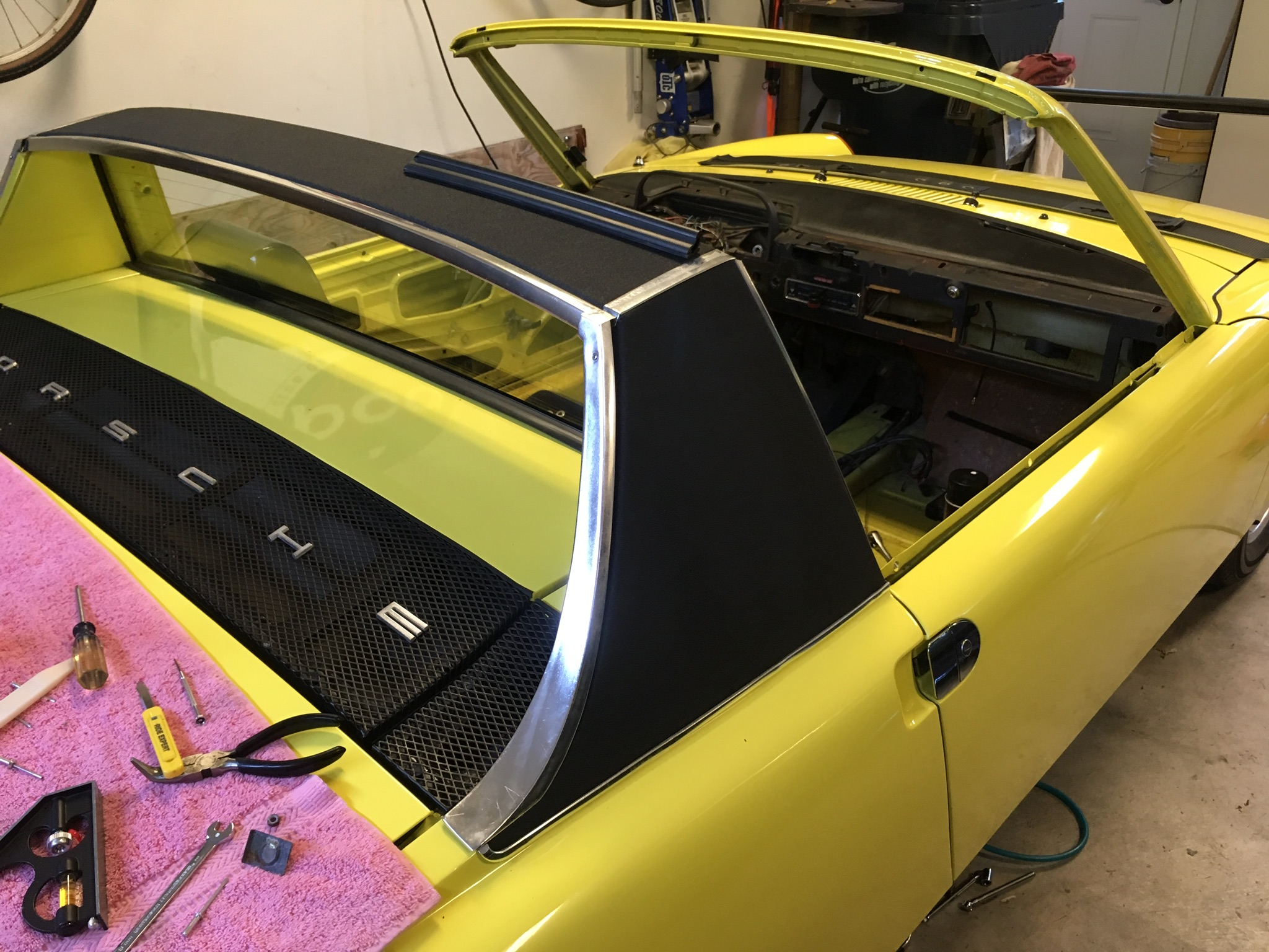

arne   A few initial finds. The rear euro lenses and fron...   Mar 27 2017, 04:03 PM
N_Jay   . . . .The spare tire is the original Continenta...   Apr 3 2017, 07:24 AM

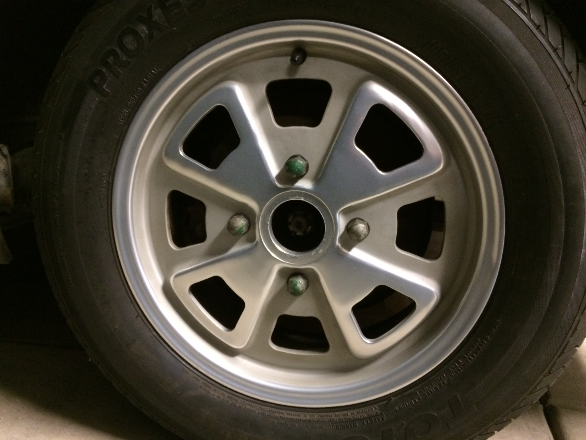

arne   Pulled one of the wheels off today to see how it w...   Apr 6 2017, 09:10 PM
JRust   Congrats on the find Arne. I'll have to make a...   Apr 6 2017, 09:41 PM
arne   Congrats on the find Arne. I'll have to make ...   Apr 7 2017, 08:55 AM

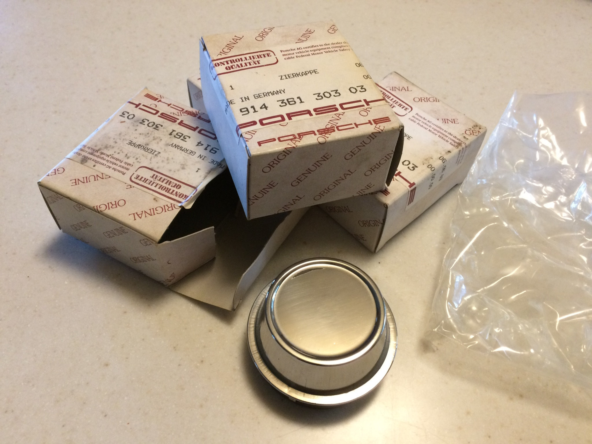

arne   One of my local PCA buddies saw the post with the ...   Apr 7 2017, 09:45 AM
mepstein   One of my local PCA buddies saw the post with the...   Apr 7 2017, 02:41 PM

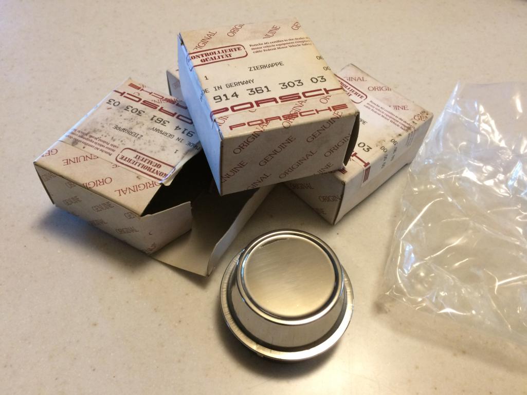

arne   Very hard to find nos. congrats. True. Since my ...   Apr 7 2017, 06:44 PM
Minerva's 914   Very hard to find nos. congrats. True. Since my...   Apr 7 2017, 06:51 PM
arne   (Center cap envy) Trade ya and throw in $...   Apr 7 2017, 10:50 PM
rgalla9146   The lugs still have the green goop. Great find.   Apr 8 2017, 05:25 AM

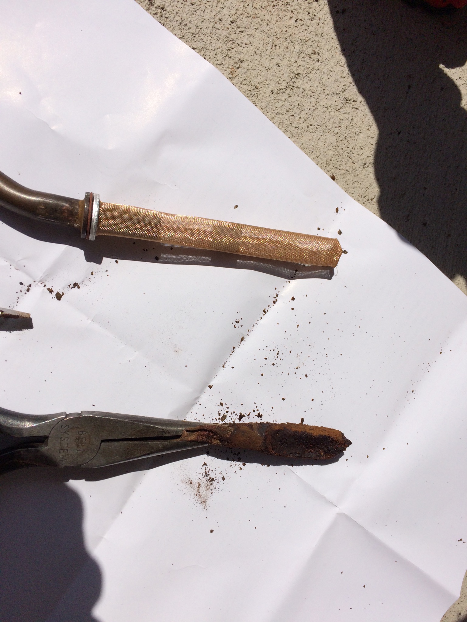

arne   Attempted to drain the fuel tank today in preparat...   Apr 11 2017, 04:50 PM

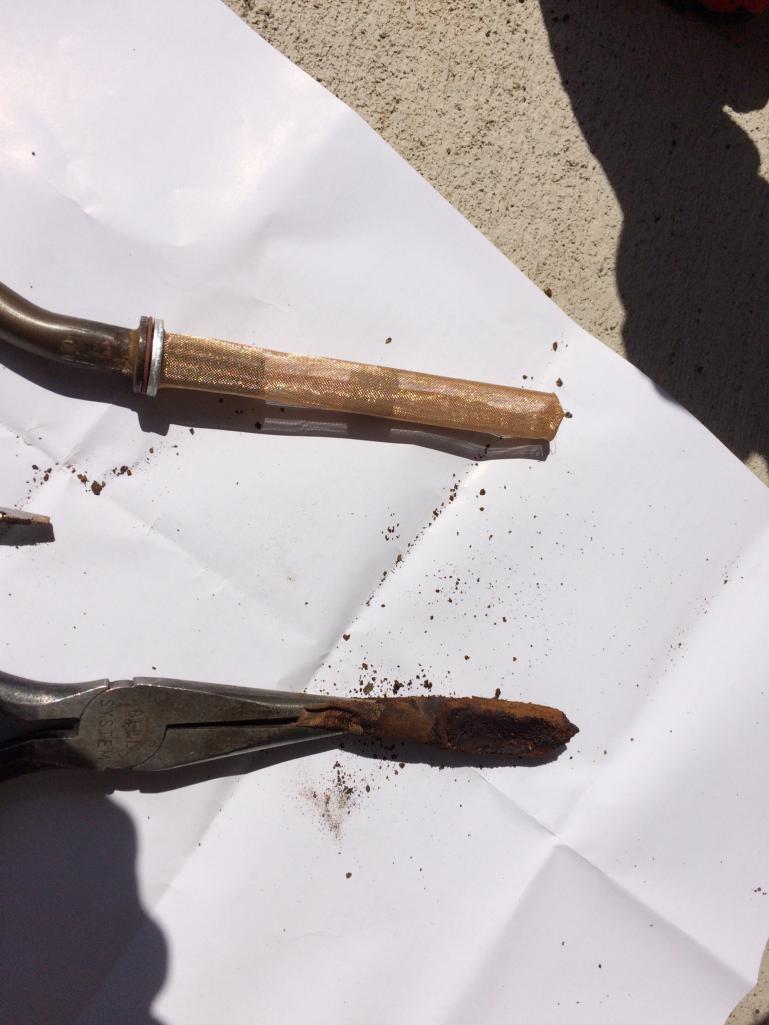

arne   Spent a good part of the day yesterday with the ca...   Apr 16 2017, 10:10 AM
Calvinator2016   Wow! Mystery Solved.   Apr 16 2017, 10:35 AM
rhodyguy   Possibly the worst tank sock I've ever seen. H...   Apr 16 2017, 10:42 AM
arne   How bad is the tank interior rust? Amazingly clea...   Apr 16 2017, 10:53 AM

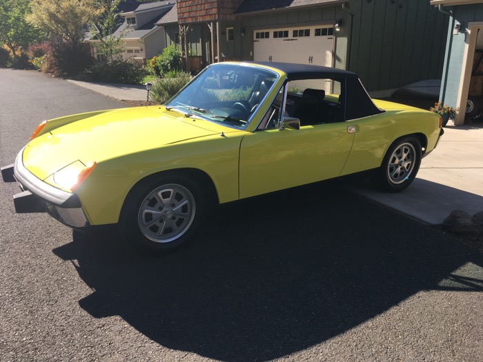

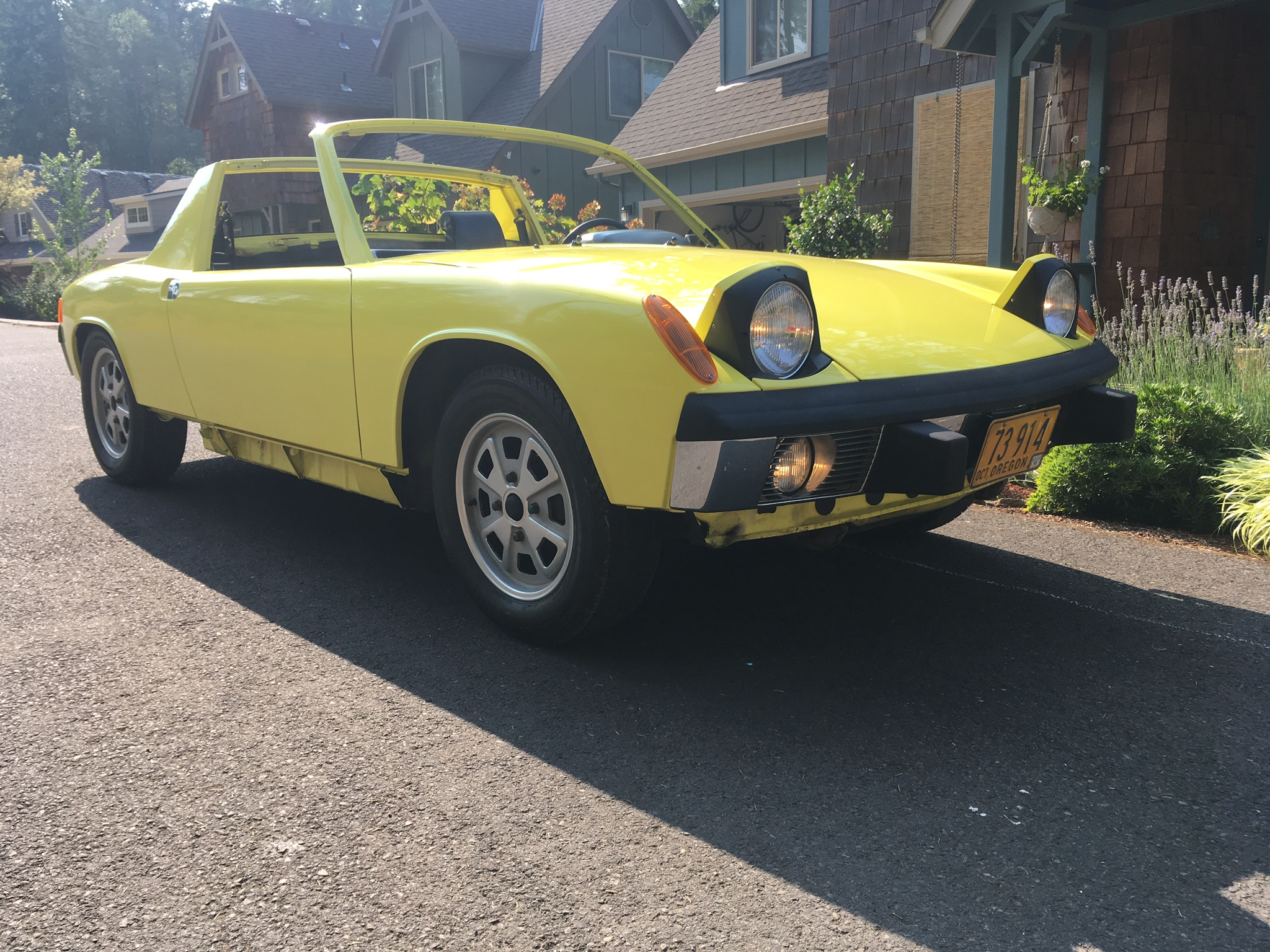

arne   Progress continues. After further review, I decide...   May 5 2017, 08:41 PM
arne   Drove it to the local PCA monthly coffee gathering...   May 6 2017, 12:57 PM

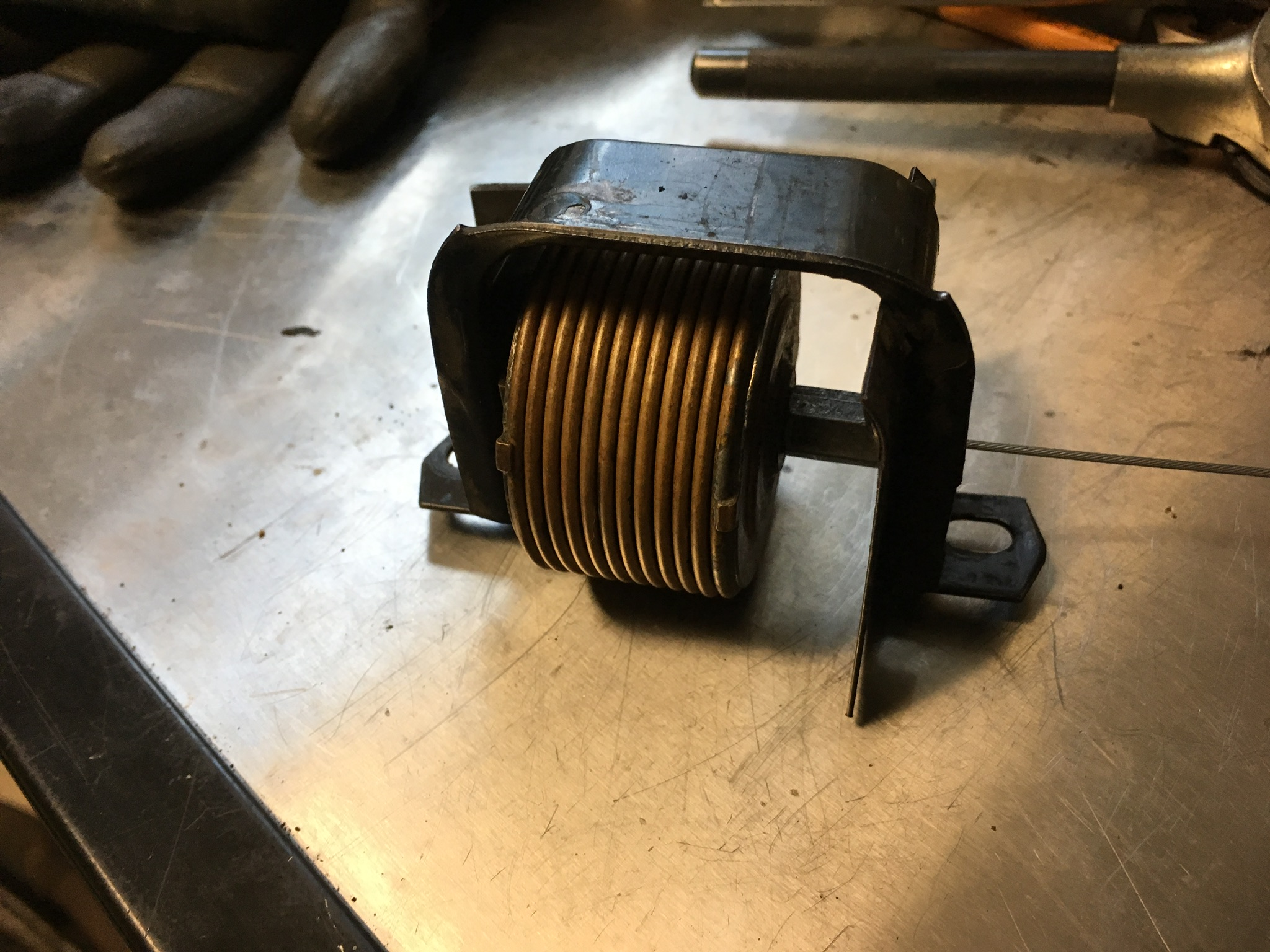

arne   Am I correct in thinking the oil pressure sender i...   May 13 2017, 11:01 AM
914_teener   Am I correct in thinking the oil pressure sender ...   May 13 2017, 11:08 AM
arne   Yes, the breather is connected. I've already g...   May 13 2017, 12:17 PM
rhodyguy   Check the top side of the oil filter. If there is ...   May 13 2017, 01:51 PM
arne   Check the top side of the oil filter. If there is...   May 13 2017, 02:10 PM

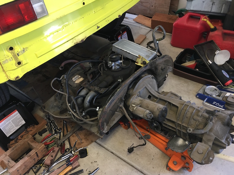

arne   Pretty sure I don't need to remind anyone here...   May 18 2017, 10:41 AM
euro911   I think you'd be better off dropping the drive...   May 18 2017, 11:30 AM
arne   Yeah, I'm sure you are right, Mark. I've b...   May 18 2017, 11:52 AM
mepstein   I've done it with the rear wheels on wheel ram...   May 18 2017, 12:16 PM
euro911   I whole-heartedly agree with Mark Epstein ... it...   May 18 2017, 12:41 PM
arne   Mr. Epstein's ramps must be taller than mine. ...   May 18 2017, 12:57 PM
mepstein   Mr. Epstein's ramps must be taller than mine....   May 18 2017, 01:46 PM
arne   OK, I'll give it a shot. I guess worse case is...   May 18 2017, 02:08 PM
mepstein   OK, I'll give it a shot. I guess worse case i...   May 18 2017, 03:14 PM
euro911   It's always nice to have some help doing this,...   May 18 2017, 03:00 PM
arne   I have access to a pair of ramps that will give me...   May 18 2017, 03:33 PM
arne   Now thinking about the "while I'm in ther...   May 18 2017, 08:23 PM

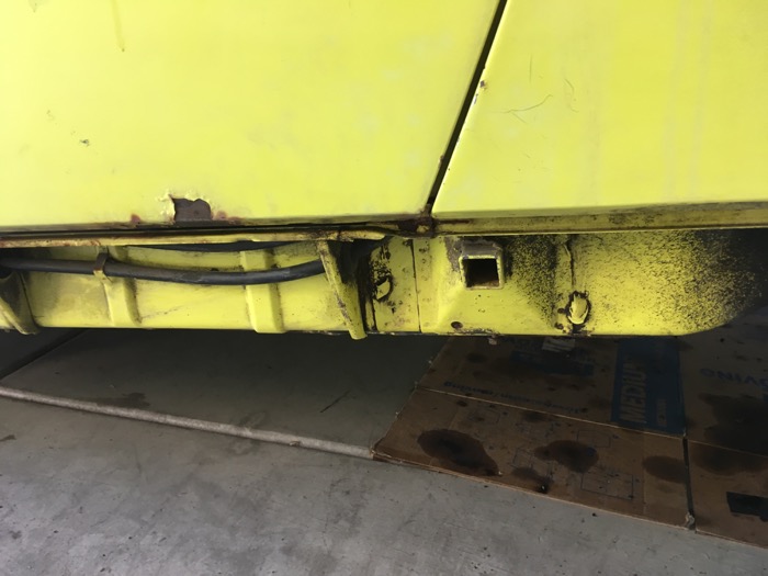

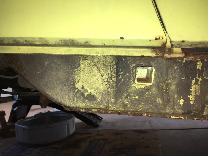

arne   Left long and jack point exposed today.   May 20 2017, 05:32 PM
Calvinator2016   Left long and jack point exposed today. Looks...   May 20 2017, 05:41 PM
