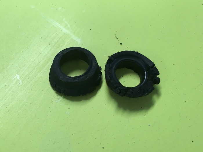

Injector seals... (IMG:style_emoticons/default/icon8.gif)

Wow. I think those are spent. Cheap fix tho.

QUOTE(rhodyguy @ Apr 17 2017, 06:32 AM) *
Spent is probably a good description. Or perhaps, as Edd China would say, "Perished."

Picked up new injector seals from a local shop who specializes in busses and Vanagons. All of 50ยข each. Have all the hoses under the hood done now, will probably crawl under the car to relocate pump and start pulling lines tomorrow afternoon. Hoping to finish and attempt to start it over the weekend.

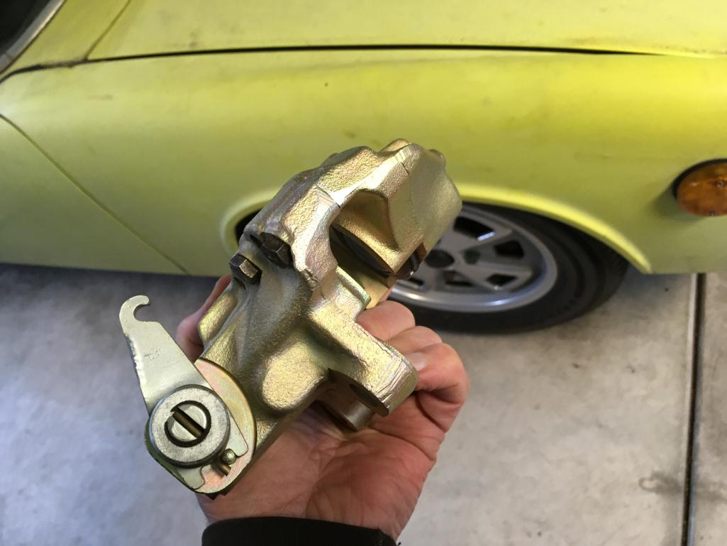

Some gratuitous 914 brake p0rn.

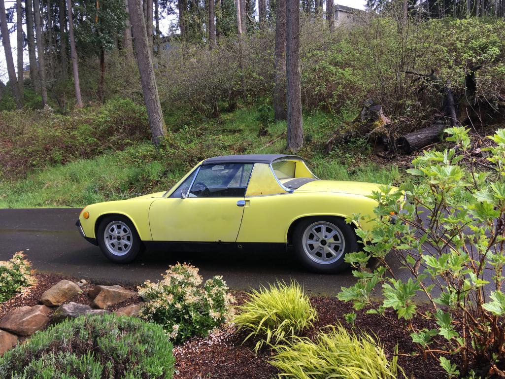

As you may have guessed from my previous post, I've been going through the brakes this week. I disassembled and cleaned out the front calipers myself, and replaced the rears with a fresh pair from PMB. The master cylinder seems ok so far, and all the flex hoses are braided stainless installed by the PO. I figured I'd try to reuse the existing pads and rotors if I could get good pedal feel.
Today, I took the car for its first real test drive. And the brakes aren't going to cut it this way. The pedal is soft and has a lot of travel. I believe this is because whoever worked on the front calipers last didn't pay any attention to the piston orientation, which caused uneven wear on the pads. Now that I have the pistons oriented properly, the pads aren't contacting the rotor surface properly, and there is a lot of flex in the pads and rotors. No way to fix that without new pads and rotors, at least up front. Which also means new bearings and races. I'd hoped not to have to go this far, this early. But the brakes have to be right, no shortcuts.
Beyond the brakes, the car ran quite well. A bit smelly, I'm going to have to address the oil leaks soon after I get the brakes handled. The transmission shifts well, but seems a bit on the noisy side. The odometer doesn't work, I suspect the little plastic gear has broken. The suspension seemed very harsh and bouncy. I now think that all four dampers are seized, no real suspension travel is happening. That will also need to be addressed sooner than later.
But for now, real progress has been made.
