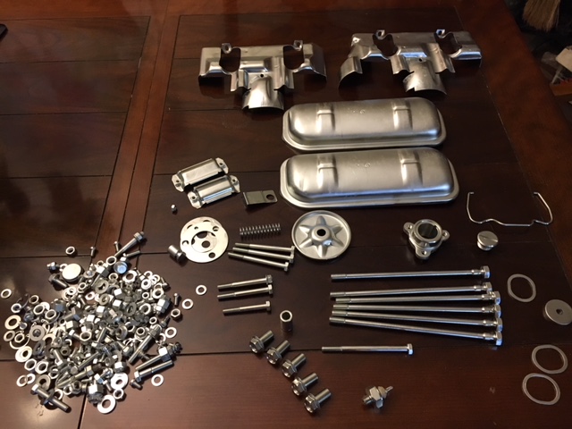

It's only fitting that this PITA job culminates with that sickening feeling of dragging that clamping bail across the fresh paint of a painstakingly restored valve cover. (IMG:style_emoticons/default/icon8.gif) (IMG:style_emoticons/default/barf.gif)
Glad you stuck with it, bummer on the bad can of paint! Looking great, keep up the good work. (IMG:style_emoticons/default/beerchug.gif)

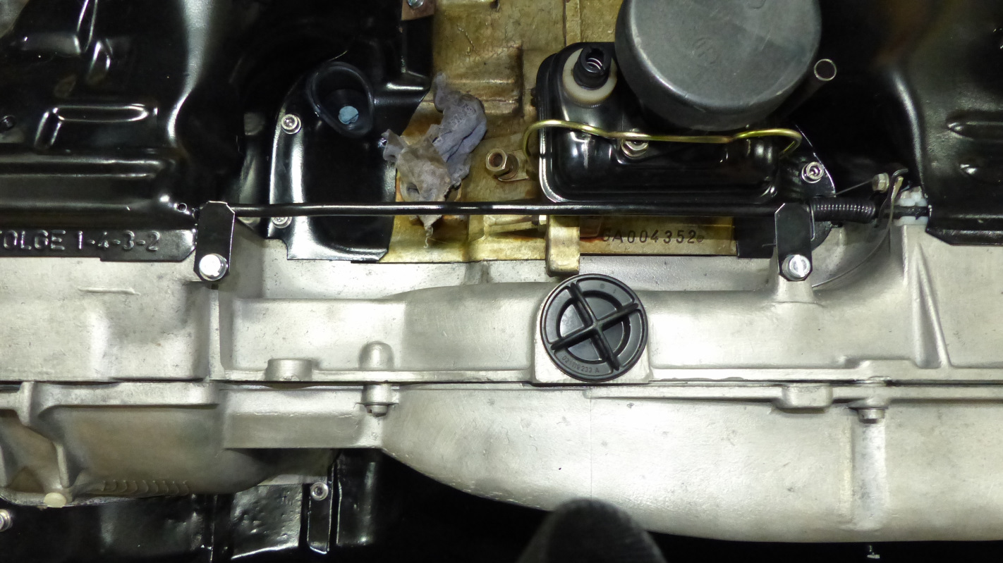

I haven't had much to report but not because I haven't been busy. There is no picture for my biggest accomplishment but my brake calipers and hardware are now in Wisconsin for plating. I got fed up with the lack of response and high price quote from the place in Salt Lake City I was originally hoping to send part. Shout out to @mb911 for the tip on his plater. Great customer service so far.

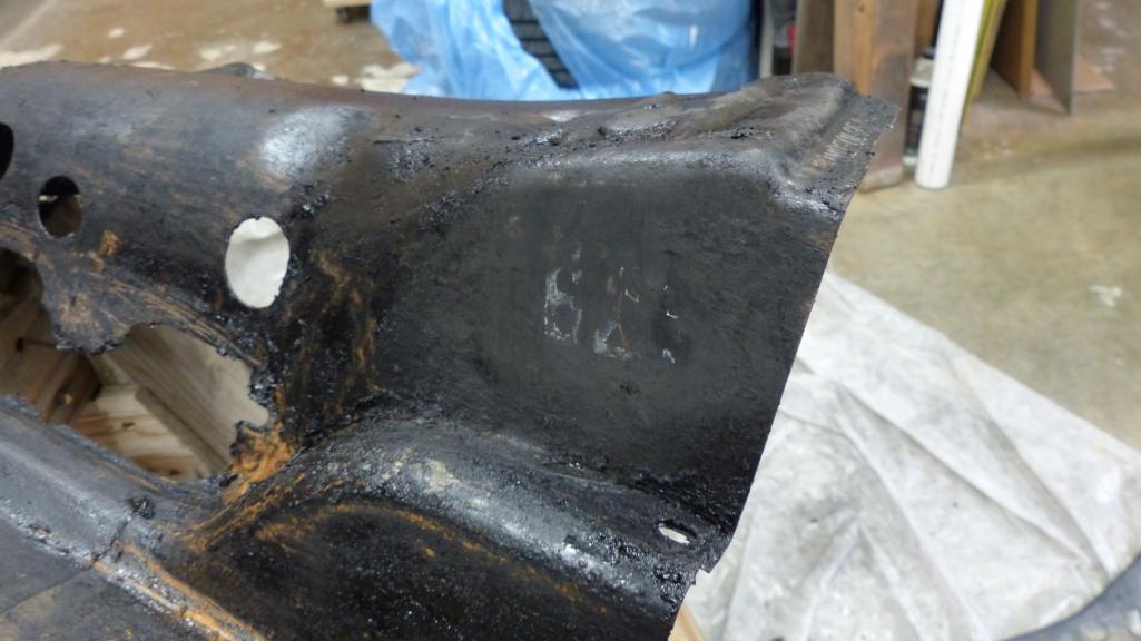

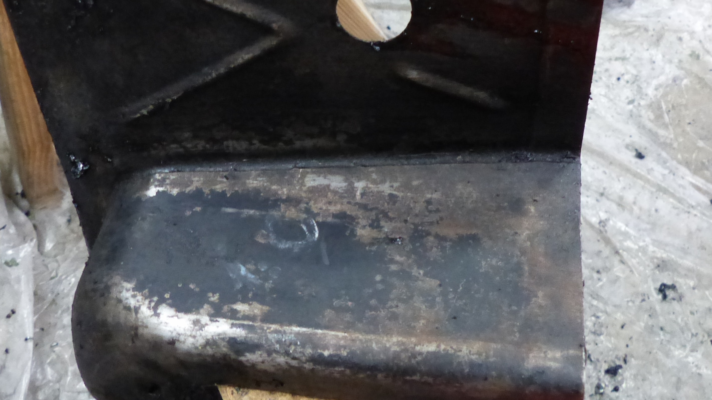

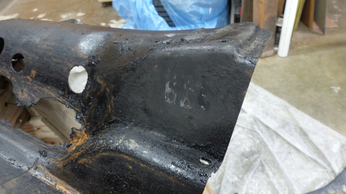

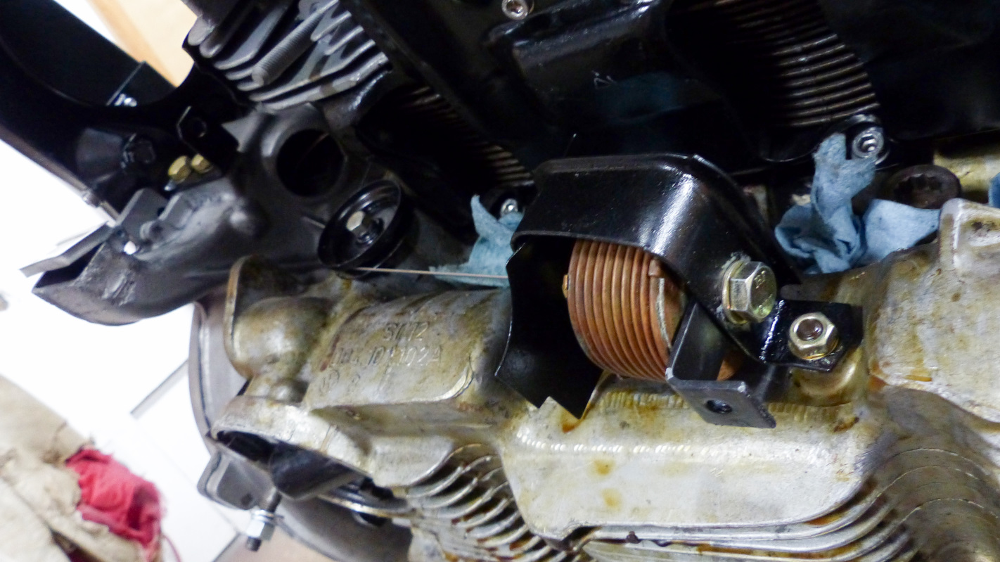

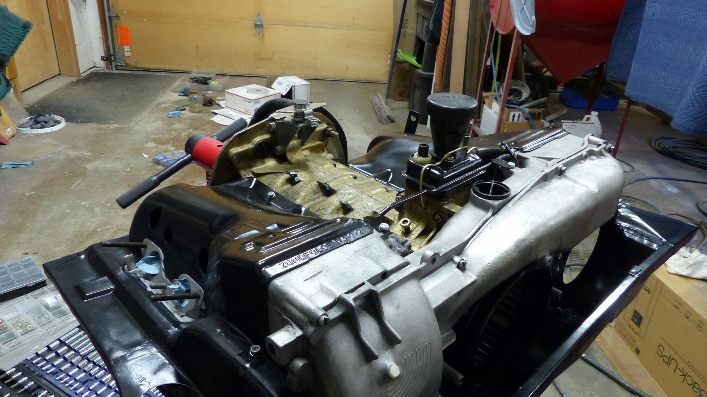

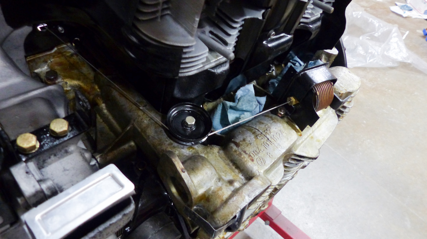

The rest of my time has been spent stripping and repainting engine tin. I used paint stripper on the upper tins to make media blasting after easier. I was hoping to get lucky and reveal some secrets in the tin and was rewarded.

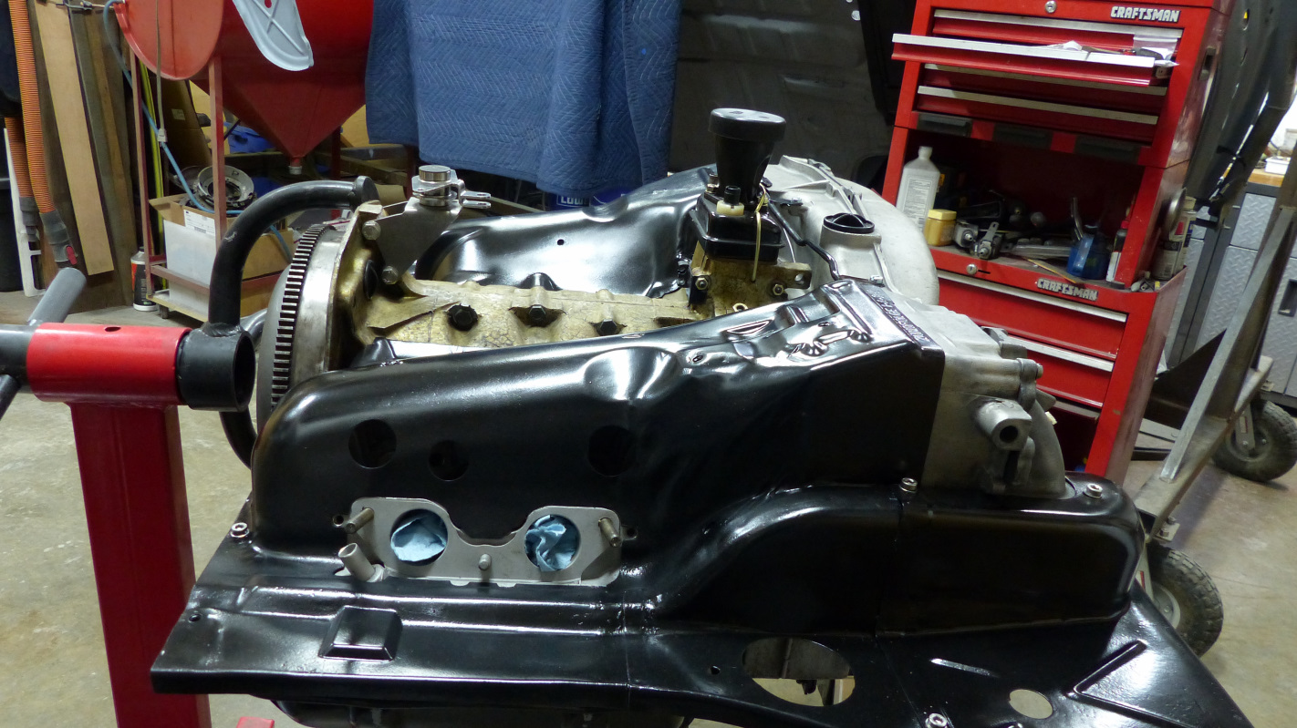

That VHT Satin Black engine paint is a PITA to work with. It's nearly impossible to maintain a wet line on these complicated shapes so you wind up with dry overspray in areas. It also has a tendency to crinkle if you apply a coat too thick. I never had these issues with any of their other colors or paints. Enough complaining, I'll just skip to the end result.

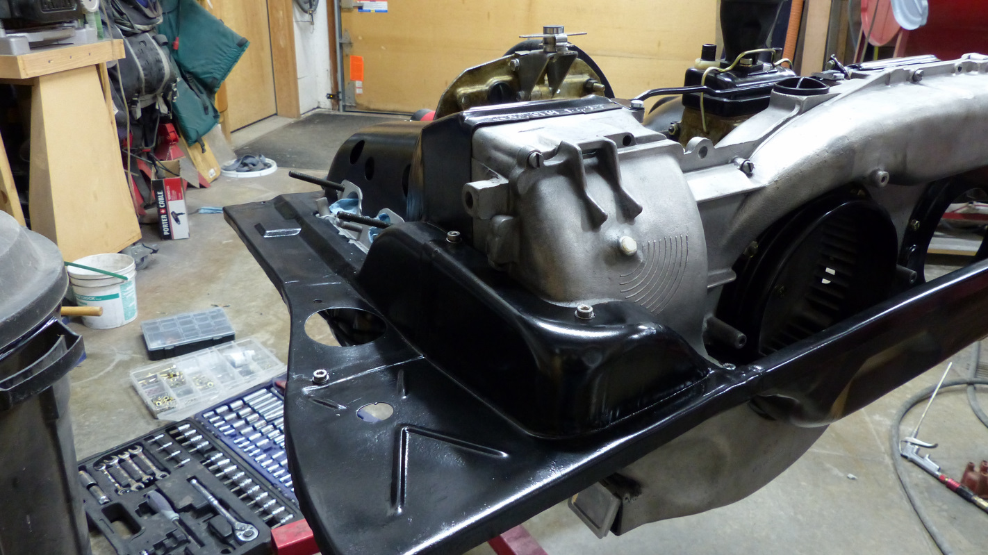

I only had one metal spring tab to hold down the flapper assembly. Thanks to a tip from Bruce Stone, I made another from a piece of metal shipping banding. Hint: metal banding has gotten harder to find. I found it in the fencing section of my local ranch supply. Can you tell which is the repro?
I have a NOS thermostat I bought when they were still about $10 and had Awesome Powdercoat make me a cable retaining nut and new cable for dirt cheap.

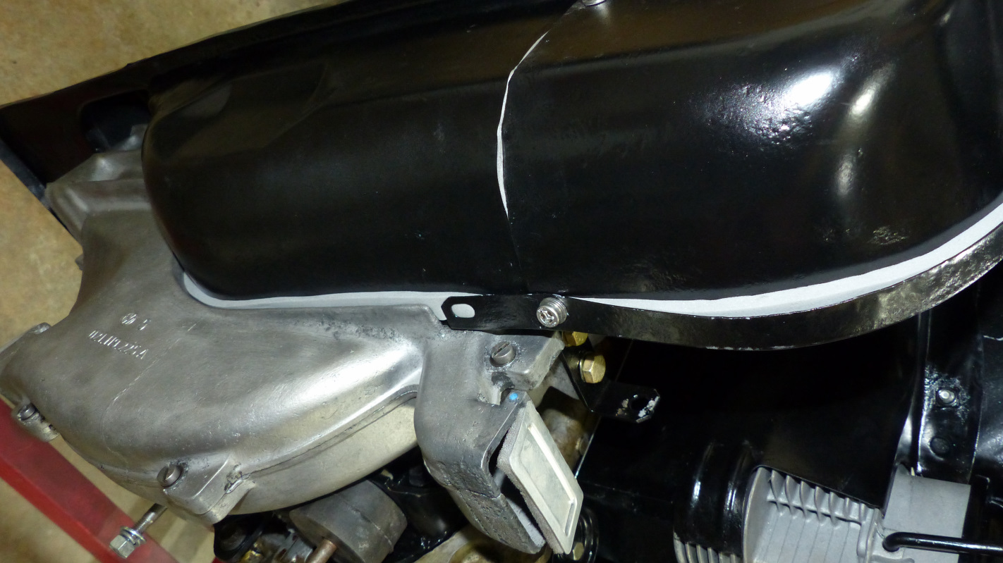

One more detail before getting to the good stuff. The tin for the fan shroud originally had some gasket material to seal the joints. I used some 1/2" x 1/4" window closed cell foam weatherstrip I picked up at Lowe's (gray stuff oozing out here).

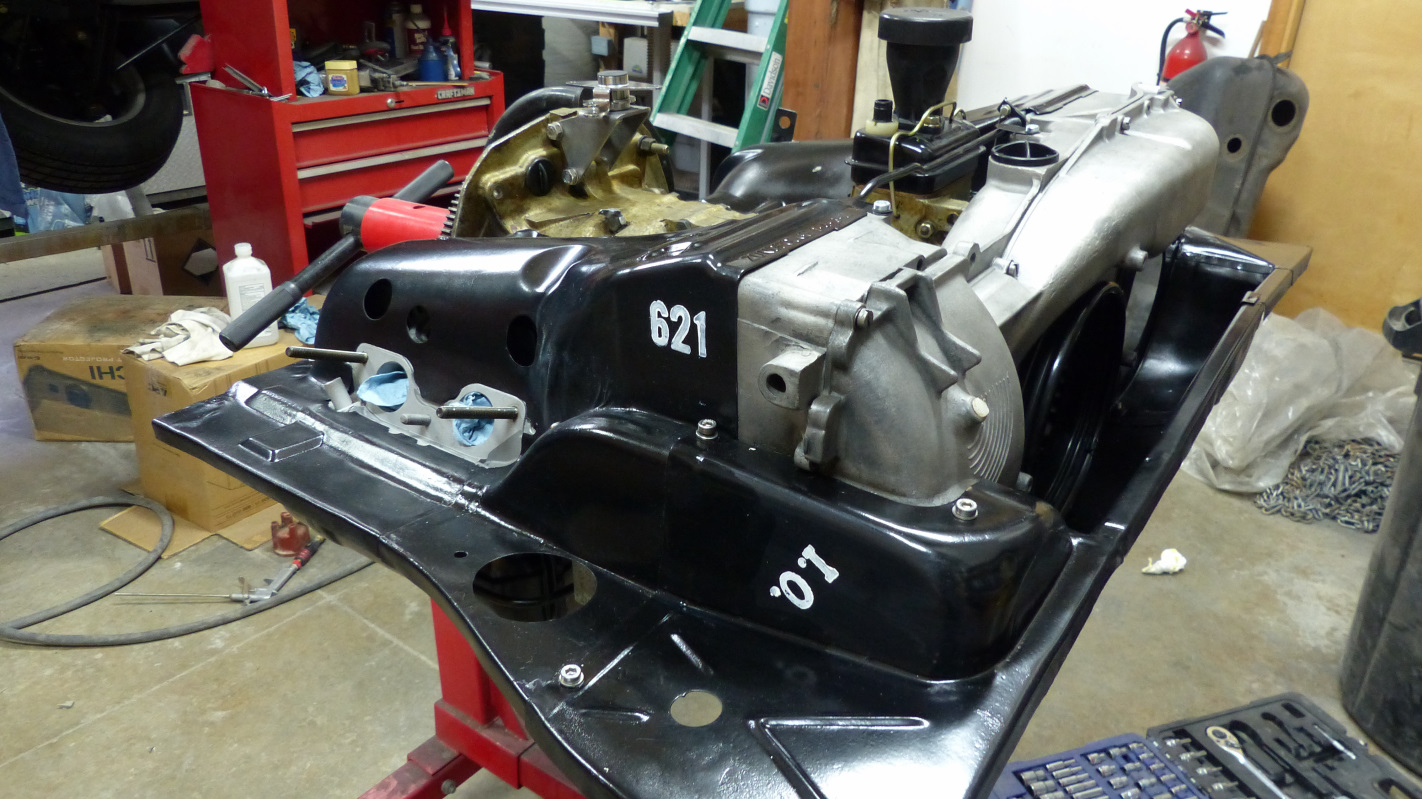

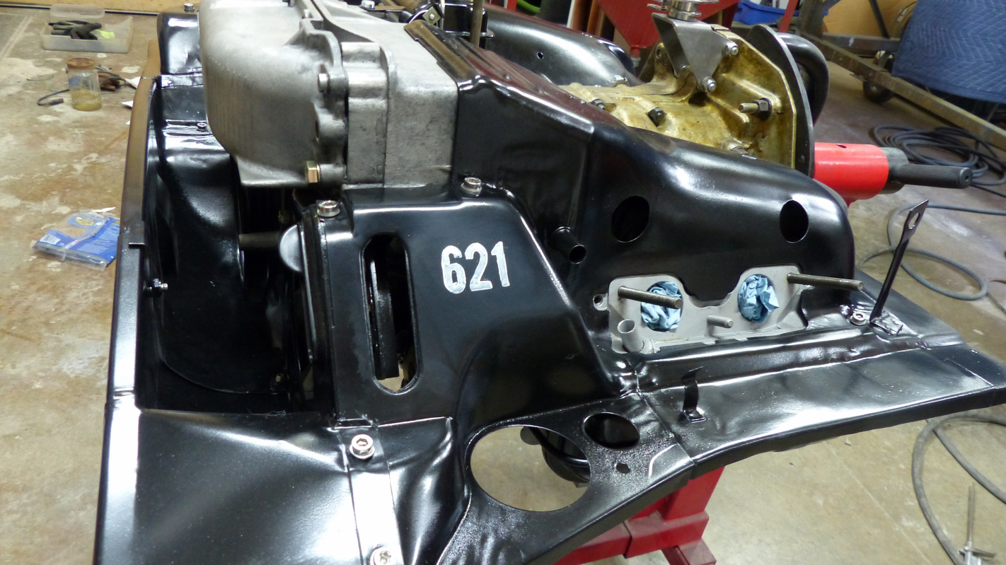

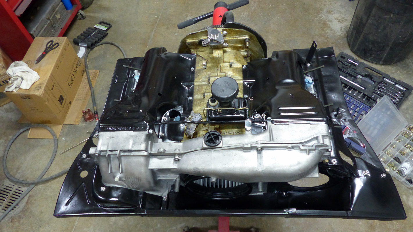

Now the good stuff.
Wait a minute... That doesn't look quite right... Oh yeah, here we go.
Oh yeah! That's better. (IMG:style_emoticons/default/dancinnanner.gif)(IMG:style_emoticons/default/dancinnanner.gif)(IMG:style_emoticons/default/dancinnanner.gif)
Now before you rush to judge this as silly, let's consider that I.O. stamp. According to Jeff Bowlsby's site, that stands for "In Order." I'm not sure what that means but I think "in order" seems like a good thing, and without that stamp, how do you know if it is "in order""? (IMG:style_emoticons/default/confused24.gif) (IMG:style_emoticons/default/bye1.gif)

“”Now before you rush to judge this as silly, let's consider that I.O. stamp. According to Jeff Bowlsby's site, that stands for "In Order." I'm not sure what that means but I think "in order" seems like a good thing, and without that stamp, how do you know if it is "in order""? confused24.gif bye1.gif “”
(IMG:style_emoticons/default/lol-2.gif) (IMG:style_emoticons/default/beerchug.gif) (IMG:style_emoticons/default/smilie_pokal.gif)

I'm going to assume you used a German potato to make the the stamps for the letters and numbers. Or is it you have it upside down and it's actually "OI", an abbreviation for "Ore-Ida"? (IMG:style_emoticons/default/shades.gif)
In any case, and in all seriousness, you're going to have one of the most accurately detailed restos out there. Your attention to these details, as others have already pointed out, is really wonderful to see. Great job, sir!
