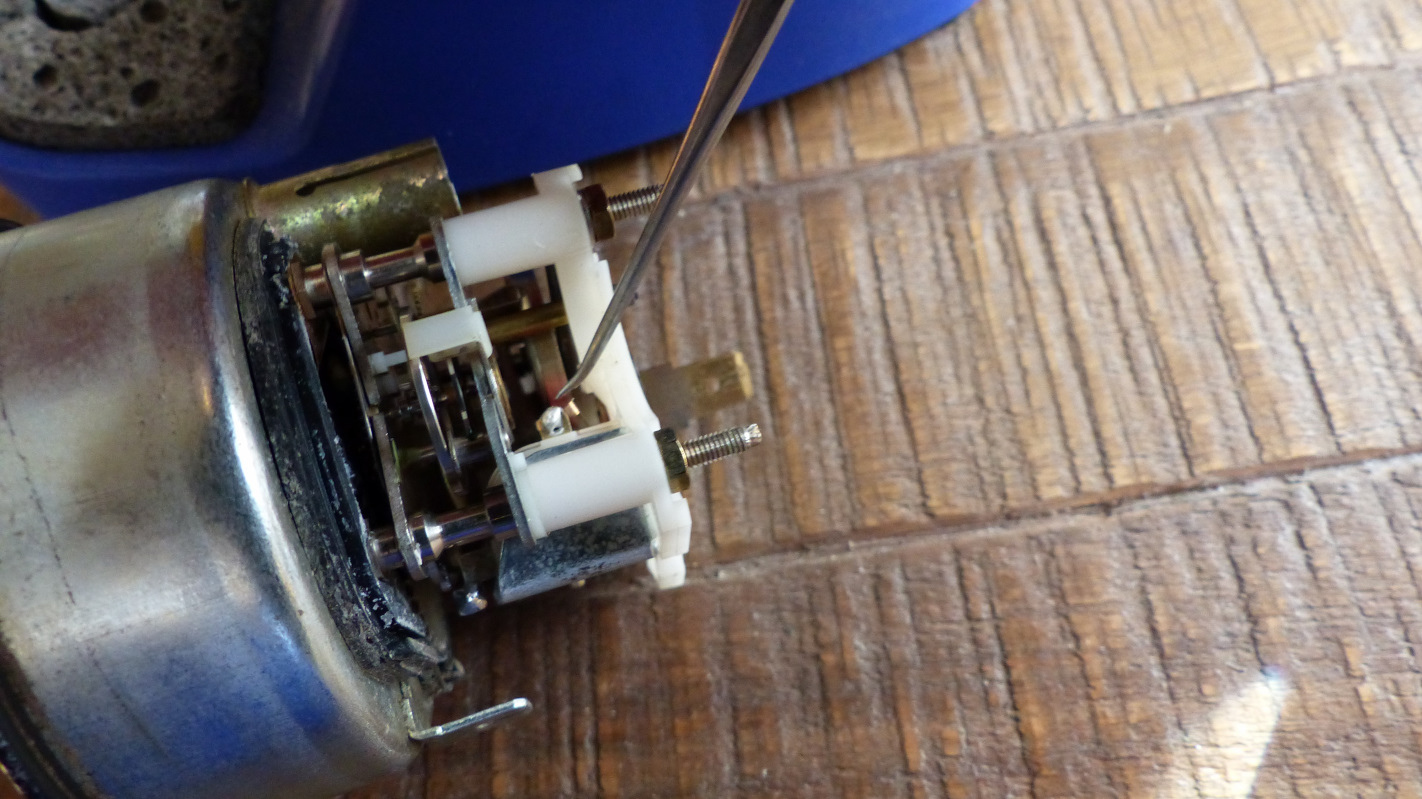

I fixed the clock. It was the standard problem of the thermal fuse opening which is well documented so I want go into much detail. Like @Superhawk996 I could only find 138C low temp solder for sale and not 120C as speced on the clock. I'm sure that would be okay, but I noticed I still had pretty good blobs of solder on both sides of the thermal fuse so I decided to try just remelting the existing solder. It worked and the repair cost me only whatever electricity I bought to heat the soldering iron. Also like Phil, I found the old lubricant had gummed into a waxy substance which no doubt is why the fuse blew. After a bit of fishing in the Internets, I found a couple clock makers recommending brake cleaner as a suitable quick clean. It isn't the "right" way which is to completely disassemble the clock and soak in cleaner, but it should do. The only problem was that some of the cleaner seeped inside the clock face and I was worried it would mar the face or lens. Luckily, it evaporated without leaving more that a barely detectable trace. I may replace all the console gauge lenses with glass though because the plastic is yellowed and fogged.
The clock has been running a bit slow so needs adjusted, but I'll wait until the clock oil I ordered arrives so it is properly re-lubricated before any adjustments.

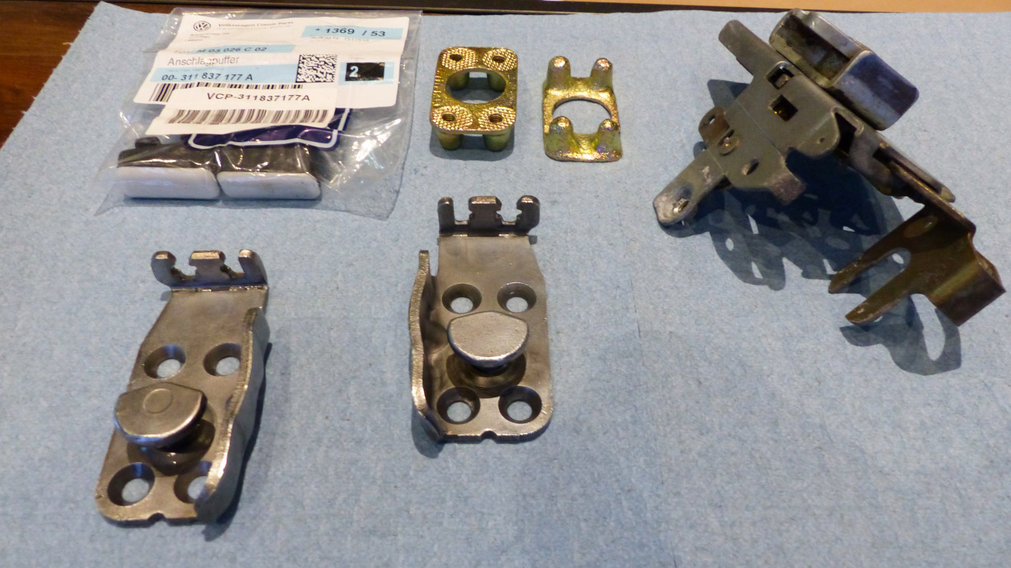

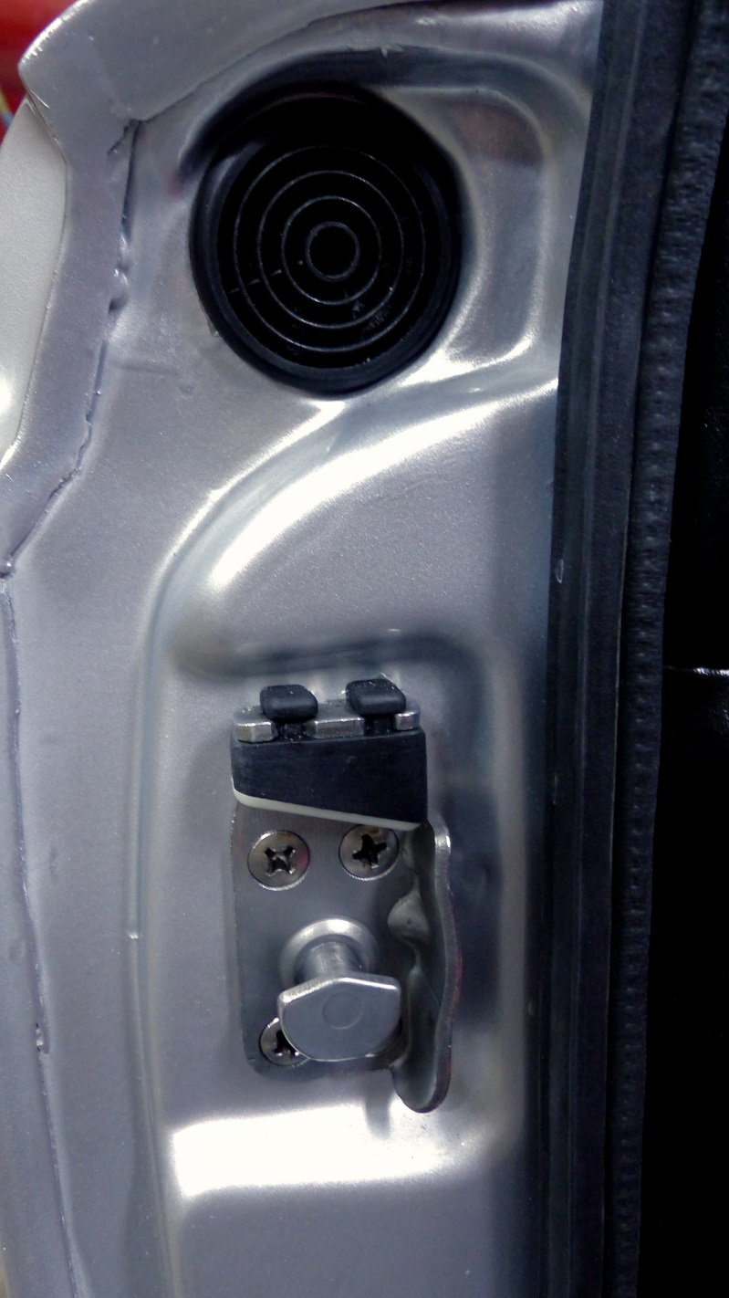

The other accomplishment was to get the door latches installed. I decided to just clean up the latch mechanisms and relubricate. I would like to replate them but they are a complex combination of bright cad and yellow cad pieces riveted together and I decided the chance of screwing them up was greater than the benefit. They cleaned up well. I did replate the catch posts and installed NOS rubber bumpers. here are almost all the parts cleaned and plated, ready to reassemble. One latch had already been installed at this point.
The door posts installed. That vent cover is another story I'll tell later.

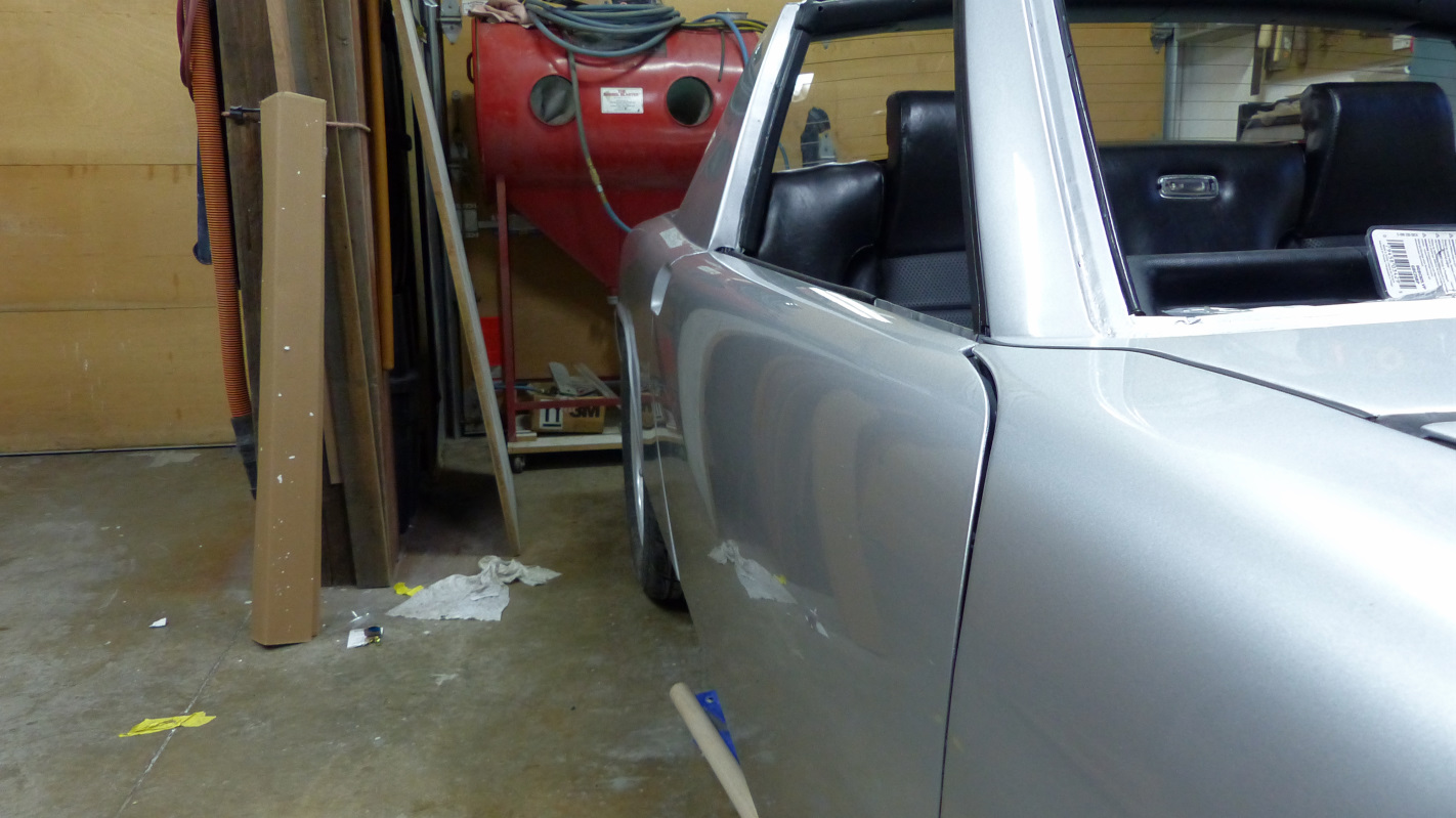

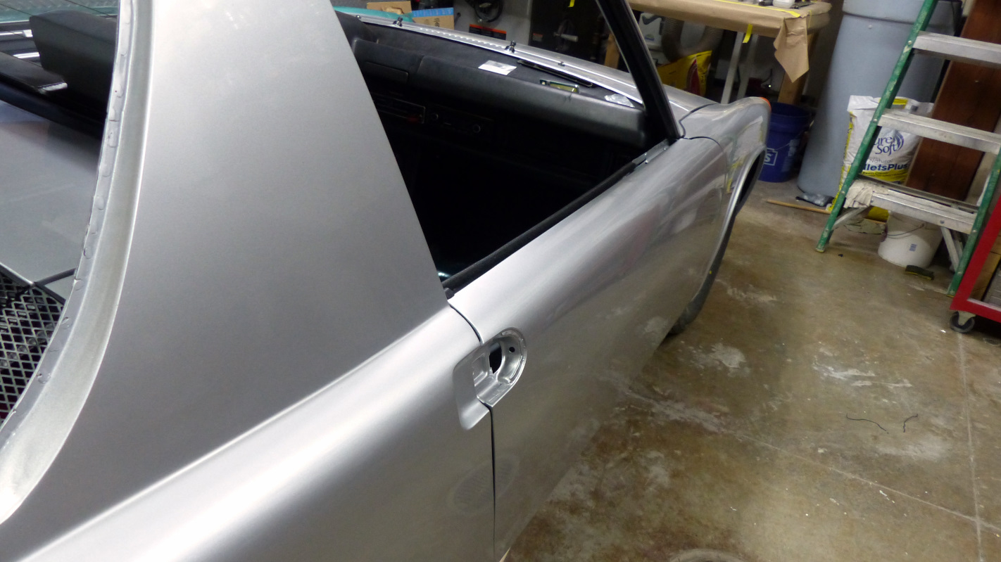

Had a little scare when I couldn't get the pass door to shut flush even with the post adjusted all the way inward. I finally realized it was only closing to the first safety catch and the post actually needed to be adjusted outward. Once I did that, the door closed nice and flush with solid clunk that only German cars seem to have. I need to get the handles and other hardware sent to the chrome platers I guess.

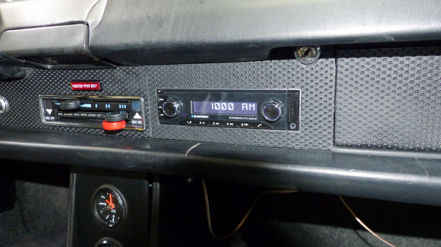

As usual I've been juggling several projects on the car with plenty of progress but few at an interesting stage to share - except one. It was time to add some tunes to this tub.
I spent a LOT of time trying to figure out a head unit that suited me. For months I had a search alert for vintage Blaupunkt and Becker radios to see if I could snag a bargain. No luck. As everyone knows, those radios have become quite spendy and in the end, I simply couldn't justify if for 1970s electronics and, at best, a clunky interface for incorporating bluetooth and digital streaming capabilities. Next up was looking at the retro style modern radios. The best seem to be from Woody's Custom Radio. Still, they are not cheap and specifics on what you are getting are kind of vague. So what about a modern head unit? Well - they are almost all ugly as shit. The look like the spawn of hip hop and disco on crack. Things were looking bleak.
What about the Blue Dot? I'm not sure how many know that Blaupunkt really no longer exists. It is now owned by an investment conglomerate that simply licenses use of the name and logo. Still, I was curious so checked out their offerings. Nope, I found some of the most hideous looking POS radios yet. Then somehow I discovered the "International" region website for Blaupunkt and finally found head units with much more subdued styling and a bonus of the blue dot logo that looks at home in our cars. They are still made in China radios but I found one that had the features I wanted and styling that didn't make me want to hurl. It isn't going to pass as period correct by any stretch, but it looked like it would fit into the interior without being a glaring eyesore.
(IMG:http://www.914world.com/bbs2/uploads_offsite/www.blaupunkt.com-20845-1581109456.1.jpg)
I'm not crazy about the blue ring lights on the knobs when the power it on, but otherwise like the style. I didn't, however, like the stock mounting which leaves the nose sticking too far out of the dash with a bulbous plastic bezel.

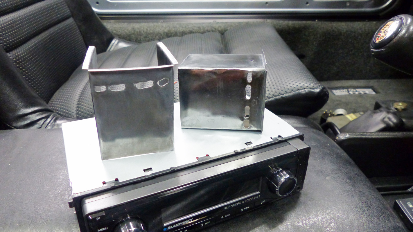

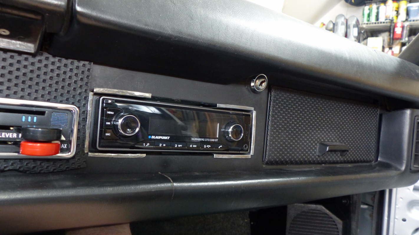

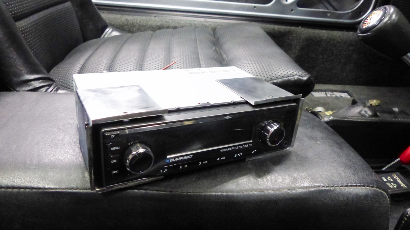

Something had to be done about that so I fabricated a pair of custom brackets that nestle the unit deeper into the dash. I don't have good tools for cutting clean slots in sheet metal so they look pretty amateur, but nobody will see that when installed.
I planned to screw the brackets to the chassis but they snap so tightly onto some lugs I decided they weren't needed.
Mission accomplished. With the unit mounted just a few mm proud of the dash face, it blends in much better.

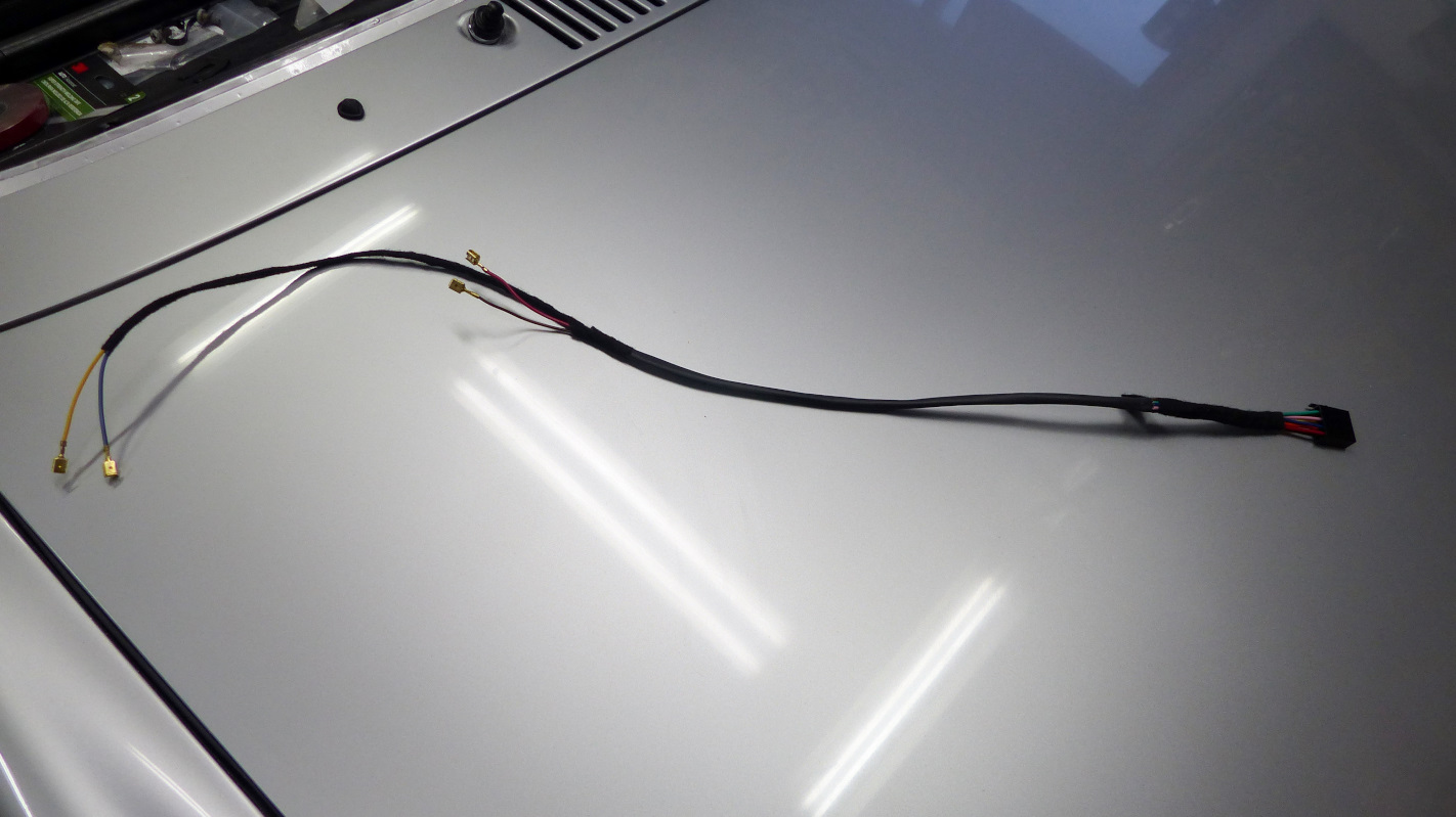

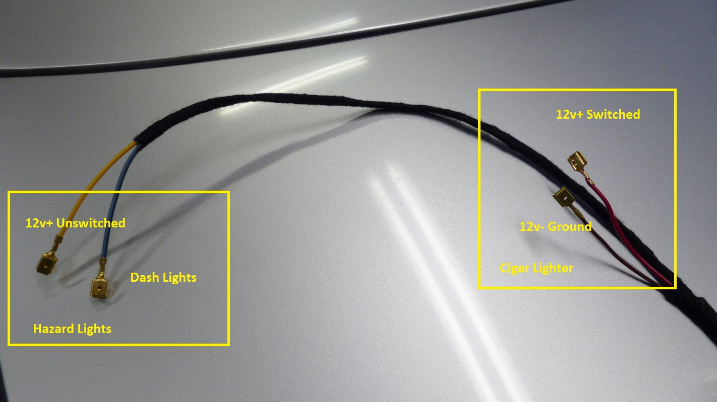

Next, I built a wire harness to hook it up. I bundled the unused wires near the radio plug outside the main harness so I can access them later if needed. The power antenna wire in that bundle will be tapped for an amplifier turn on wire but I'll wait until I'm certain where the amp will be mounted before adding that.
Staying true to the factory radio harnesses, I used AMP dual gender spade connectors so I can plug this harness into appropriate switch terminals on the dash, and plug the original switch wires into the male piggy back spades. Works pretty slick.

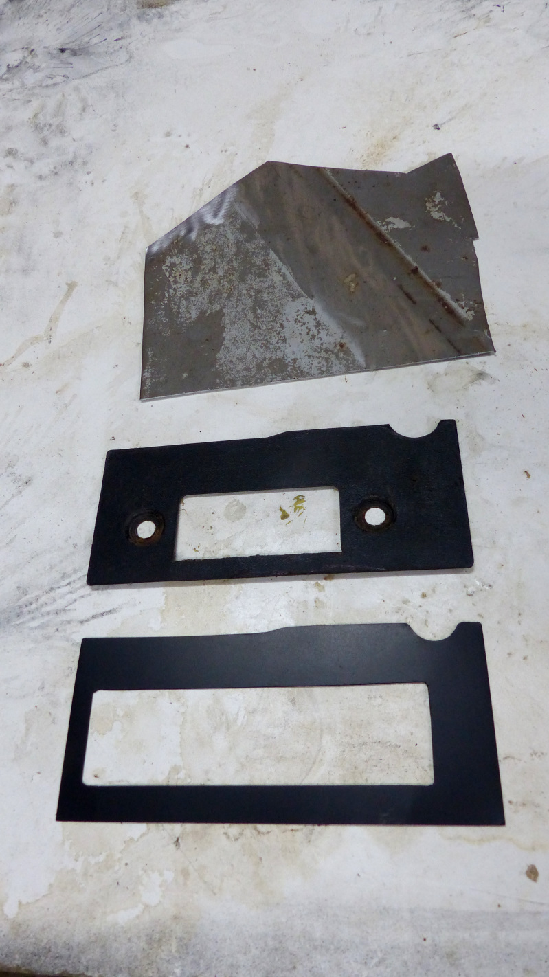

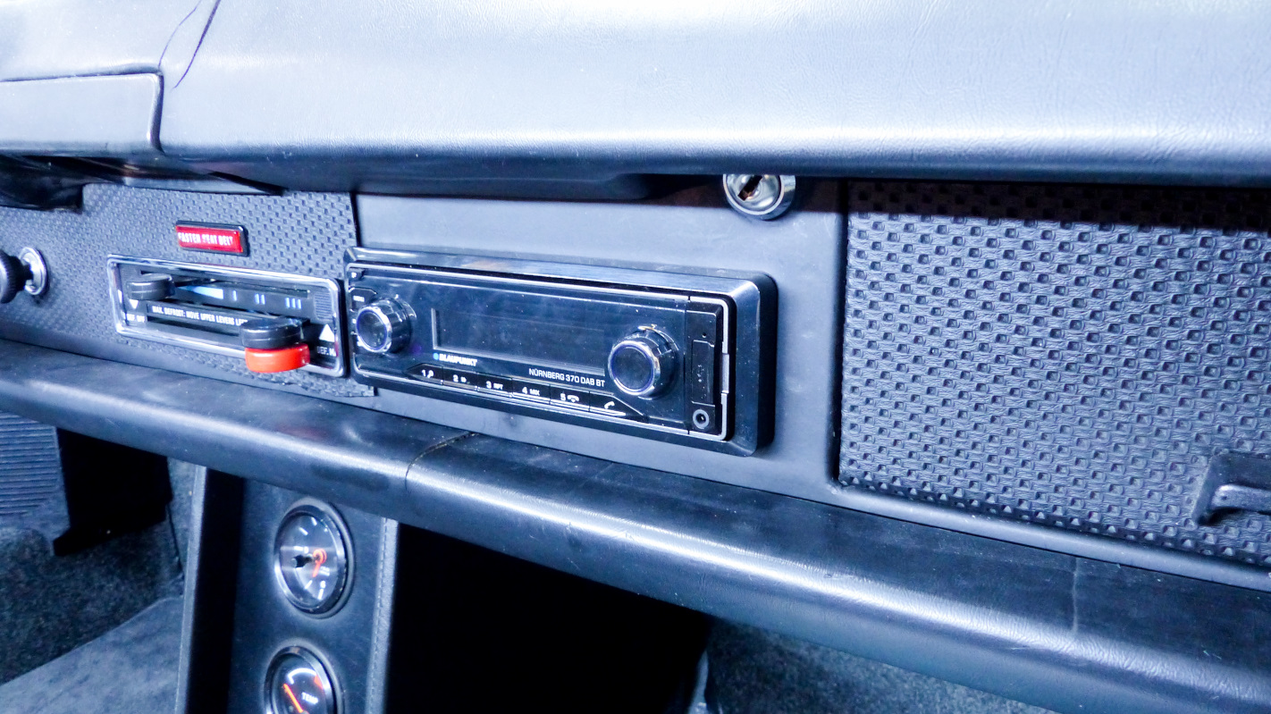

Finally, I fabricated a custom dash plate using my original as a template. I still had a scrap of the original trunk lid left which is the unobtainable exact gauge as the dash plates. I sure was jealous of @tygaboy 's plasma table while cutting this. I had to do it the hard way with snips, a jig saw, and files. Here's the original plate in the middle, with new plate below and all that remains of the original trunk lid above.
Covered in basket weave and installed, I don't think it is too bad. I have one more detail I'll probably add and will update on that later.

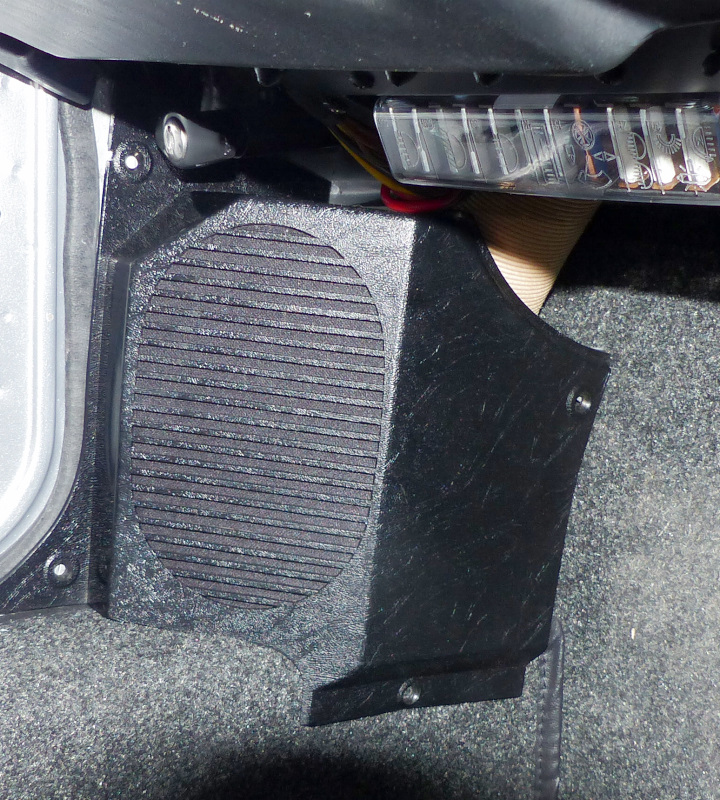

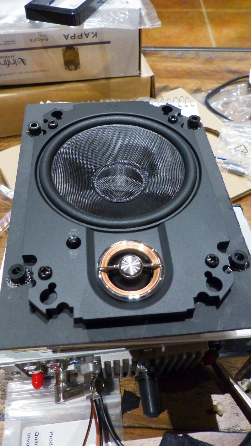

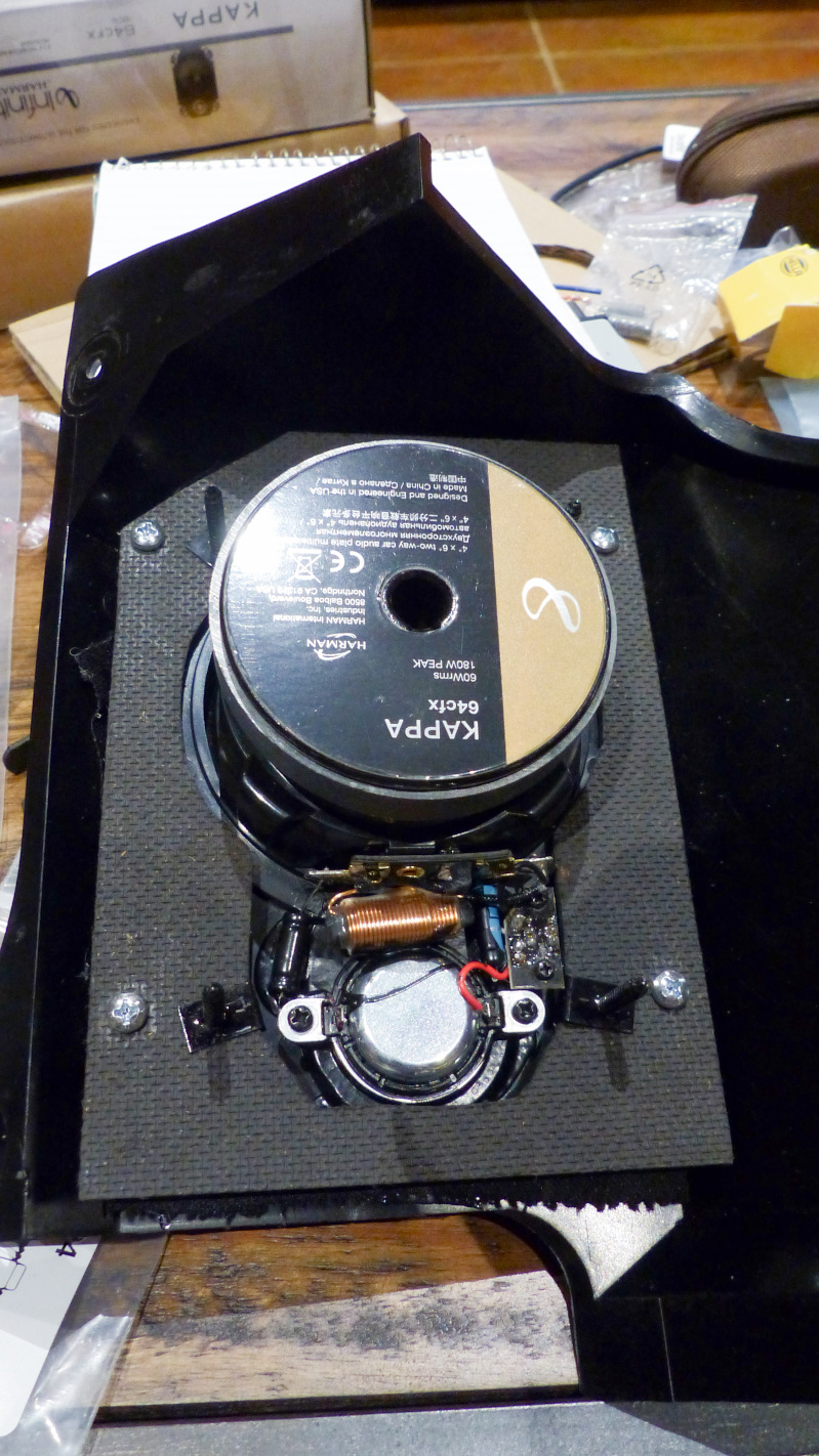

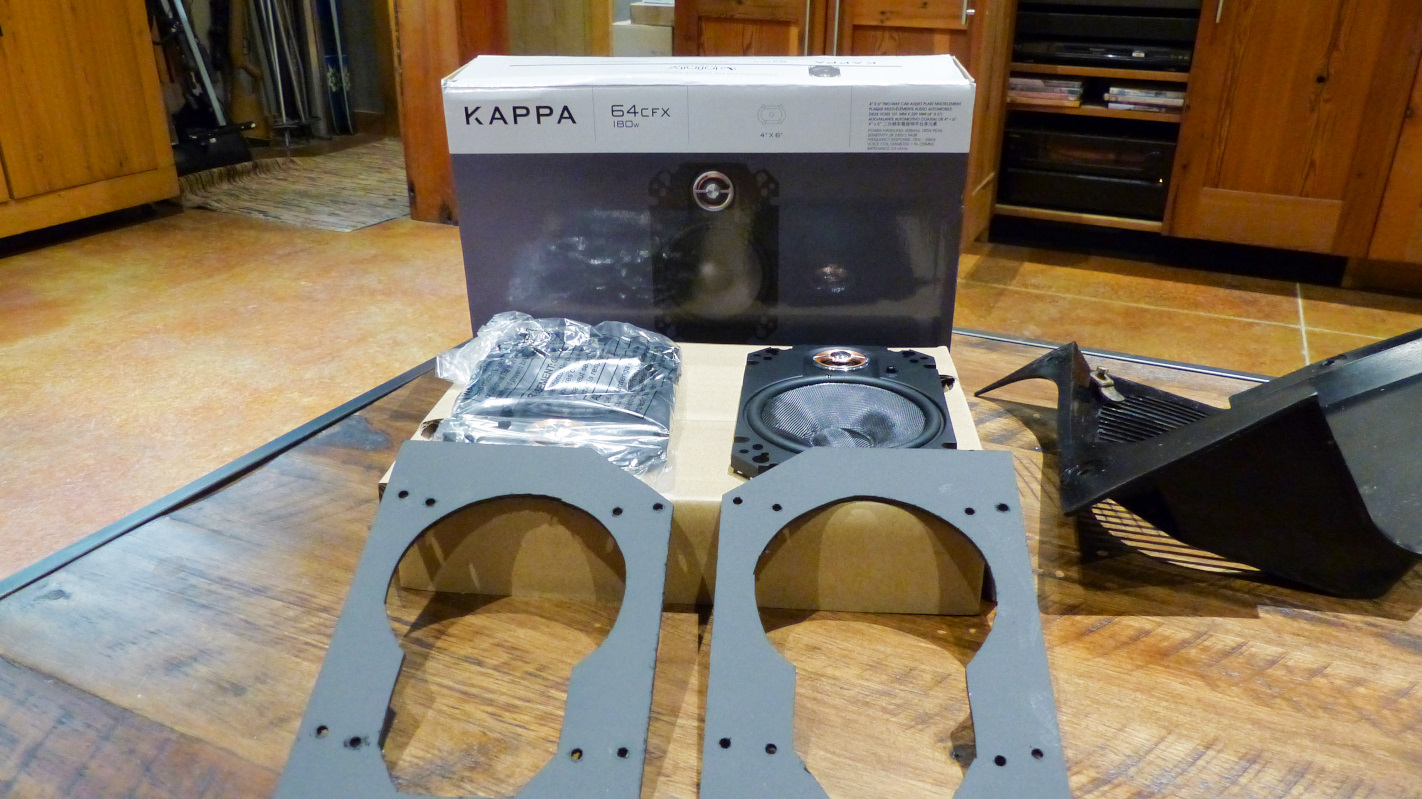

Of course, the radio needs some place to send its signal so I bought a pair of 4x6 Infinity Kappa speakers and cut adapter plates out of some scrap hardboard I had on hand.
I had to glue nylon spacers over the screw holes to provide clearance for the speaker inside the factory grills.
Here they are mounted in the pods. I decided to mount them upside down to put the magnets up high where the heater hose is most flexible in case they needed to be push back a little.
With new speaker cloth in the grills, it all looks stock.
I'll have to say I'm pretty impressed with this system as it is. At first the speakers were really tight and didn't sound very good. But after they loosened up and I streamed some high quality lossless files to the head unit, they actually sound quite good and with decent volume. Of course, these little speakers can't produce respectable bass but the mids and highs are impressively crisp. After adding a subwoofer and amp, this should be a fairly respectable system for crusing. Y'all can say what you want about your engine note being your stereo. We'll just have to agree to disagree about that. (IMG:style_emoticons/default/bye1.gif)
