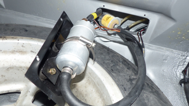

I'm going to skip details to get caught up. There's been a flurry of activity and I haven't done a great job taking pics.
Issues with the 914Rubber roll bar pads have been documented in a couple other threads and they are working on a fix. I couldn't wait so did a bit of carving and got it to work. It isn't perfect, but still a big improvement over my original cracked pad.
Last weekend I hooked up the little ground wire trick to fire up the fuel pump.
Turned on the key and nothing happened. I was getting 12 volts at the pump, but the original 3-port pump that I had bench tested a couple months ago is locked up for some reason. No sense fiddling with a sketchy pump, so I ordered a new Bosch pump which arrived on Friday. Of course the new pump is a 2-port inline, so I got to crawl under the car for some re-plumbing. Cramped quarters but not too hard. The return line and Y- fitting came out and the return hard line was routed straight to the tank.

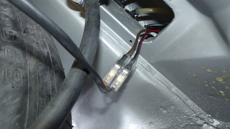

Then the pump was plumbed and wired. The cool little hard to find original pump plug came off along with the NOS boot I had shipped all the way from Latvia. I made up a little jumper harness with period correct connectors.
And the new pump is installed. Now turning the key gives the most satisfying little whir. I realize I have a crappy hose clamp on the pump inlet. That inlet is a weird size that a 3/8" hose will barely stretch over and this was the only clamp I had on hand that was large enough. It will do for testing but will get replaced.
First drink in 35 years.

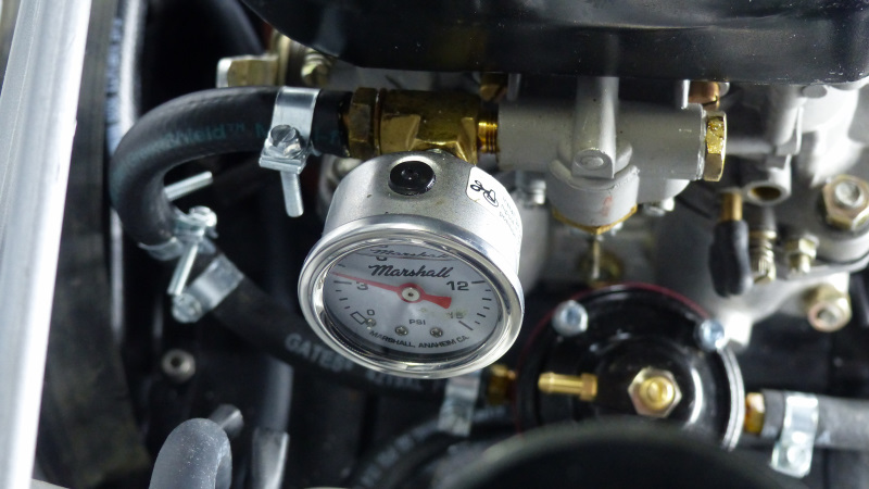

Moving to the rear, I had to re-fabricate the bracket for the pressure regulator to drop it to a lower position so it didn't interfere with vacuum lines. No pics. I also connected all the fuel hose in the rear and fired up the pump. No leaks up front but there were a few drips in the rear, mostly from not tightening the hose clamps far enough. The plugs on the carb fuel inlet filters were also leaking, so I dabbed them with some aeronautic sealant and re-tightened. With the leaks plugged, I adjusted the fuel pressure to 3.5 psi.
Then a bunch of futzing around. Checking fittings. Setting static timing. The Pertronix III was hard to static time because it didn't zero out my DMM like regular points do when they make contact. I could hear it spark when it went past the trigger point though so set it there. I wound up pulling the carbs off for a final clean just to make sure no crap found its way into the combustion chambers. A whole bunch of other stuff done just checking and double checking. Finally, I was out of excuses so this happened.
https://www.youtube.com/watch?v=jFkiGmbiPCE
It runs like crap. The timing is clearly off, but I managed to run the cam break-in sequence. Then I adjusted the timing a little by ear and got it to run somewhat more smoothly and even idle (roughly) without backfiring. I didn't want to run it too much more before changing the oil and filter so will do that before putting a timing light on to set the timing and then tuning the carbs. There is still that air cleaner to deal with and I have a plan. Of course, I do have an oil leak. The #3 exhaust push rod tube is leaking at the head. I used 914Rubber's viton seals and the fancy O-ring grease. All the others are dry as a bone, but there had to be that one. At least it is one that can come out without dropping the engine. Anyway, just 13 days past her 48th birthday, she has a heartbeat again! (IMG:style_emoticons/default/dance.gif)

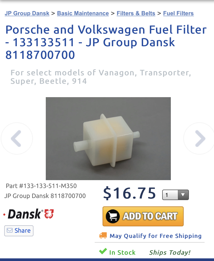

I think this kind of filter you need.

Thanks. I looked into that but that filter won't work well with the new pump because the outlet on the filter is smaller than the inlet on the pump. The original pump had a 8mm (~5/16") inlet so the filter doubled as reducer to adapt the larger 9.5mm (~3/8") supply line from the tank to the pump. The filter I have (NAPA Gold) has 3/8" nipples on both sides which fits better. It is rated for FI although I don't really need an FI filter since I'm running carbs at 3.5 psi, but NAPA does make this same filter with a metal canister for a dollar more. If I ever go back to FI, I will run that for extra measure. I opted for the plastic version for now so I could monitor how well the fuel is flowing (as a check for hose kinks etc. ) and see what is coming out of the tank for the first few hundred miles.
I have a second filter in the engine bay in the original stock location that I will eventually swap out for the stock filter you posted because I do have an adapter fitting to reduce the 3/8" supply line coming out of the tunnel to 5/16" to connect to the hard lines running up through the engine shelf. Switching to the stock filter will let me eliminate the adapter and reduce the number of connections that could fail.
