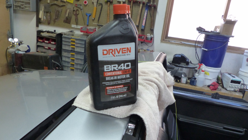

I readied the white flag of surrender again tonight. Last night I drained the oil and changed the filter. I was really surprised how thick and slimy the oil was from the assembly lube in it. It was probably because I filled the oil pump with thick assembly lube to help with building oil pressure before first start. I had planned to throw a fistful of bolts and metal scraps into the oil pan and take a picture as a joke, but decided I didn't want to mess with that slimy stuff.
Tonight I refilled the crankcase. I ordered 20w50 break-in oil from some guy on Amazon, but what I received was some kind of motorcycle racing oil. He was nice enough about exchanging the oil but dumb as a stump. After 3 weeks of messing around trying to get an exchanged, this arrived. Fuch it. It's ZDDP enriched break-in oil and the break-in is going to happen during cool weather so this will do.

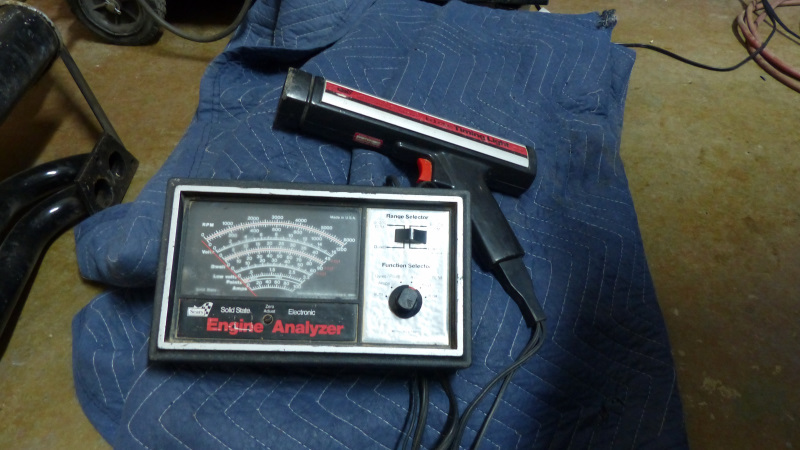

With oil in the car, time to see it I could get some of the crap out of its get along. A vintage car should be tuned with a vintage kit. I've had these bits since buying my first car (a 914 of course) in the early 80s.
It was a bit of a trick juggling between revving an engine that runs like shit while reading the tach on the meter, and point the timing light down the hole, but I think I managed to get it darn close and the engine did smooth out noticeably when I was finished - but still ran like crap.
Next I balanced the carbs with a snail. Why didn't I take a pic? They were wildlife out of synch because I tried to crank one of the carbs up before cam break-in. I think I'll wind up pulling the fuel pressure gauge off because it is in the way of adjusting the right carb. I shouldn't really need it now anyway. Once the carbs were balanced, they smoothed out a lot. I think tried adjusting the idle mixture screws by ear by screwing on in until the cylinder starts to miss. Backing it out until it stops missing, then out another 1/2 turn. My ear sucks and I don't know what I'm doing, so not sure how well I did on that. Anyway, the engine now idles with a little bit of hunting between about 500-800 rpm. Still more work to do, but at least it isn't spitting fire.

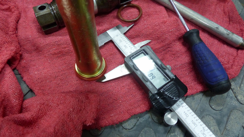

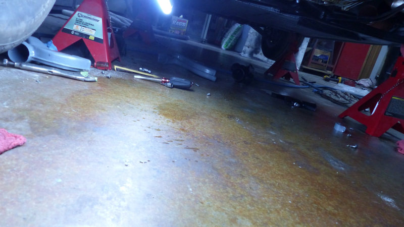

I had to make some repairs on our clothes dryer this morning so didn't get out to the garage until after lunch. Probably better that way because I'll admit it was a frustrating day. First order of business was fixing the oil leak which required dropping the heat exchanger, which meant pulling of the air guide and heater duct. A note for others: DO NOT install heater parts until you a sure your engine is running well and oil drip free.
Once all the crap was out of the way, pulling the leaking push rod tube was simple enough. The viton o-ring seals are from 914Rubber and I've had enough issues with several of their parts, I thought it wise to check dimensions against my copious stash of rubber seals that I'll never use, but for some reason won't throw away either. The viton seal checked out. Same OD when installed as the Ehlring seals.
The viton seals on both ends of the push rod looked in perfect condition (not pinched or nicked at all), but the tube end was a little dinged. I transferred the seals over to another push rod and reassembled. Then I checked valve clearances on #3 and #4. One valve had barely loosened up. I tightened it just a tiny bit. Then I swapped out the valve cover gasket for the 914Rubber thick version. What a pain in the ass. The thickness isn't a problem, but they made the gaskets just a tiny bit oversized so they bow about a quarter inch when fit in the cover. I can only guess they thought that would help compress the gasket when installed, or maybe compensate for any shrinkage from heat cycling. Whatever the reason, it makes them a pain in the ass to install because the fuching things try to pop our of the cover flanges. I managed to wrestle it on and snap down the bail.
Then to the other side to check clearances. Same deal as the other side. A couple valves had barely, barley, loosened. After readjusting I had the gasket to deal with only this time with the heat exhanger still on, it was a triple pain in the ass to wrestle that little bastard in. Finally, I got the bail snapped in place. Then I fired up the engine and inspected the push rod that was replaced. No leaks! (IMG:style_emoticons/default/piratenanner.gif) A little oil was baking out of the exchanger from the leak from before, but the head stayed dry with no drips.
