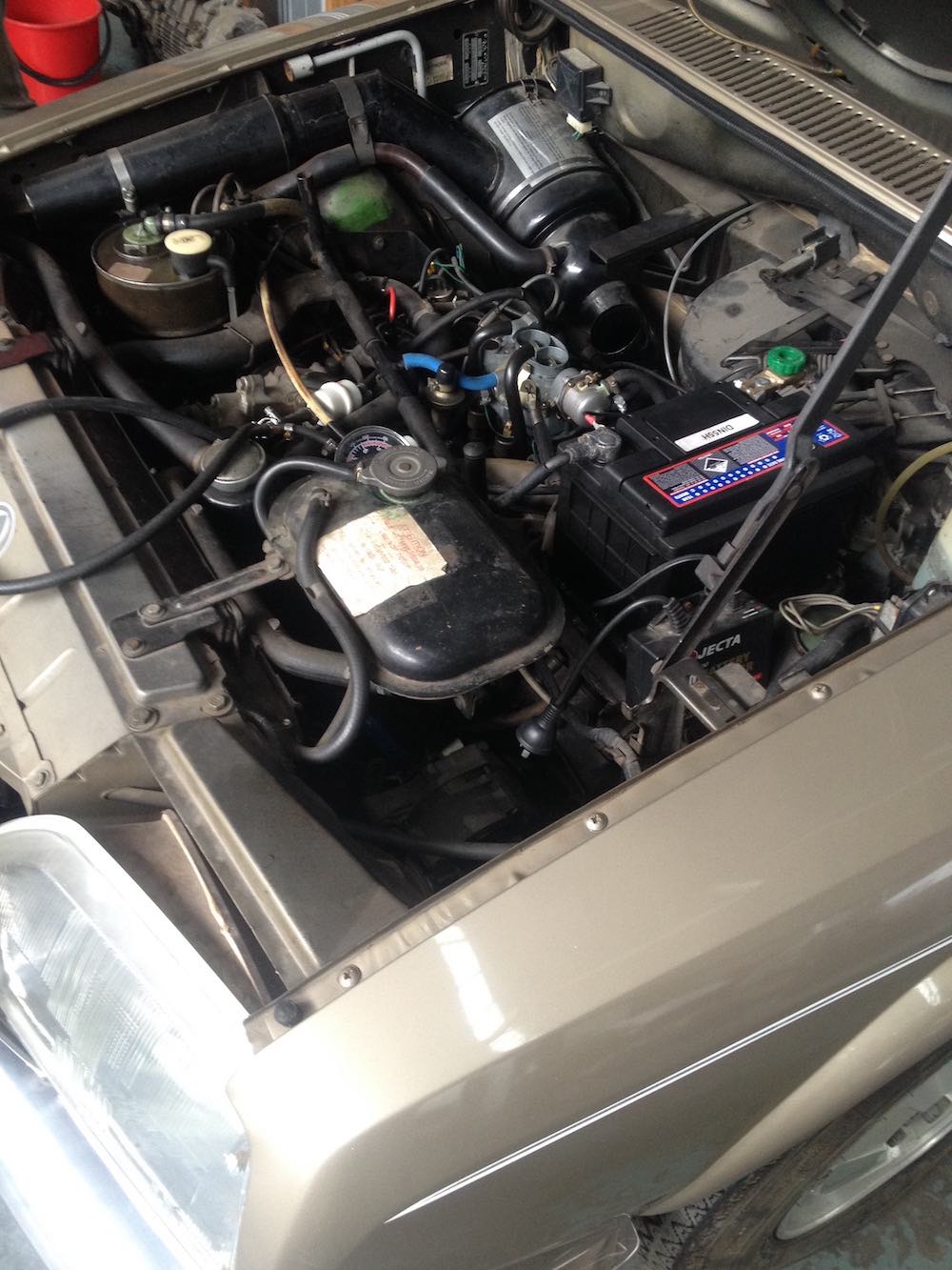

i have a bit of stuff on file re factory vw mufflers i found when i was modifying mine to fit properly. back then i was trying to figure out if there was any real difference between 1.8 mufflers and kombi mufflers. i ended up figuring there was none apart from exhaust inlet mounting plates orientation.
there are some german test figures for the standard kombi muffler that jp group make.
test = 91db at 3,450 revs stationary. 79db on the move. i think measured at 1.5m from the exhaust outlet for the stationary one. the bursch is probably not far off that.
i did not want a loud 914 either. i think part of its original design ethos was to be relaxed at high speed on the autobahn.
thinking about it, the shape of the snorkel is a sound suppression resonator of sorts anyway - tapering down tube.
attached a picture of the fairly extreme snorkel/silencer on the wankel in a citroen birotor. NSUs had all the same components but arrayed a differently in the engine bay.

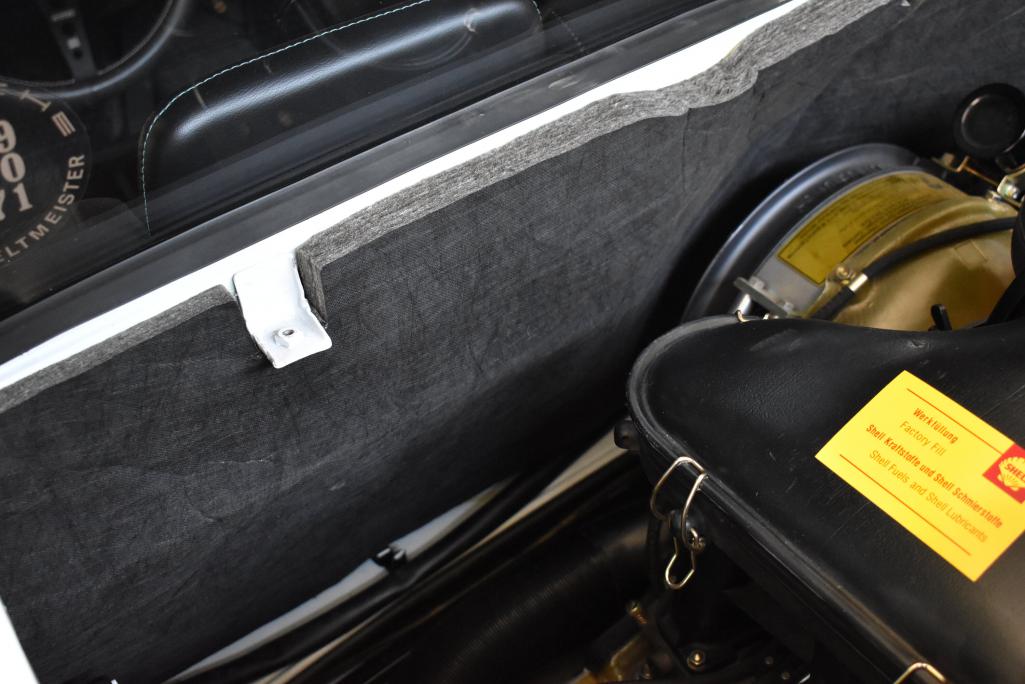

QUOTE(bbrock @ Jul 15 2021, 07:43 PM) *
mad scientist would love to know how it compares with the heavy oem slab. Unfortunately mine has lost most of the probably asbestos fiber so wouldn't be a good test.
As a generalized statement about NVH, sound transmission loss effectiveness increases with increasing mass. That is why OEM mats (internal & external) are so heavy.
If you don’t mind the weight there were advantages to the heavy OEM barriers.
Generally speaking the light weight, fibrous, or foam barriers are only going to serve to absorb mid to high frequency. For low frequency and structural boominess, you want mass and constrained layer solutions.
FYI - Dynamat (and Noico) are a mixed mass & constrained layer solution. You can add double or triple layers of Dynamat to build mass. Check the specs on Dynamat vs Noico. My recollection is that Noico had less mass per square foot but don’t flame me if I’m wrong. Don’t have numbers in front of me. (IMG:style_emoticons/default/happy11.gif)
Nope, you are correct about Dynamat vs. Noico. I also don't have the numbers but remember that Dynamat is slight thicker/more mass. There was also a sound attenuation test I ran across that showed Dynamat outperforming the competitors, but the difference was small compared to the triple price of Dynamat.

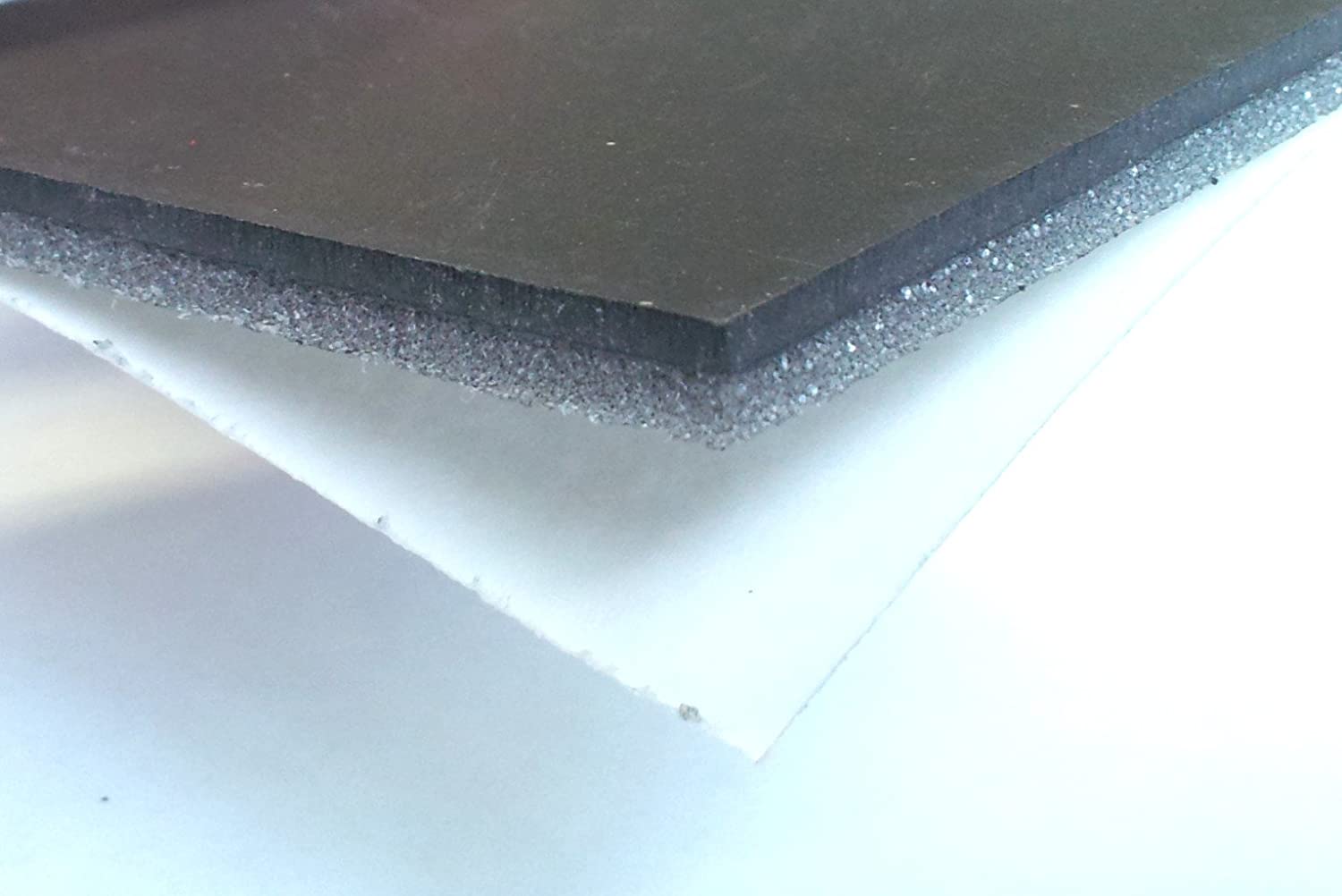

What's interesting about the OE mat is that not only does it have the heavy tar-like coating, but the fiber portion is also dense and heavy. I would have reused mine except for the fact that it is shot. I contemplated spraying this new mat with several coats of rubberized undercoating to create a bit of a mass layer on the engine side. I did that with the uxel foil faced foam. Does the relative location of the mass vs fiber matter? Effectively, I now have the reverse of the factory mat with thick fiber on the engine side and then Noico butyl mass stuck to the firewall. The total weight savings over the OE mat is still substantial. I'm too lazy to look up the numbers I posted before to update with the new mat number.
I'm also wondering about something like this to either replace or add to the rubber sheet on the interior side of the firewall. https://www.amazon.com/Self-Adhesive-Automo...;language=en_US
(IMG:http://www.914world.com/bbs2/uploads_offsite/m.media-amazon.com-20845-1626461395.1.jpg)
Yup something like that on interior over the top of the Noico.
Seems pretty similar to DynaPad 4 layer urethane pad coming in around 1lb/sf. That is still probably less mass/sf than OEM interior pad but is a good mass add in addition to the Noico.
https://www.dynamat.com/wp-content/uploads/...l-Sheet_Web.pdf

QUOTE(Superhawk996 @ Jul 16 2021, 09:14 PM) *
QUOTE(bbrock @ Jul 16 2021, 02:49 PM) *
l
Looks like the Dynapad is thicker @ 3/8" vs 1/4" I have Noico on the engine side of the firewall, not on the interior. Right now on the inside, I just have the factory rubber pad that goes behind the backpad. I have enough Noico to do the inside too but trying not to get too crazy with weight unless I have to.
I still need to work on reducing the sound being produced first. I'm thinking reduce exhaust as much as possible first as that is still the main culprit and makes the car obnoxious outside as much as inside. Then dial in the intake although I really don't think that is a major source. I don't think I can do much about the mechanical noise. Then work on sound dampener. Once I have the better sound meter in hand, I might throw the ratty original firewall mat in and see how it compares just for grins.

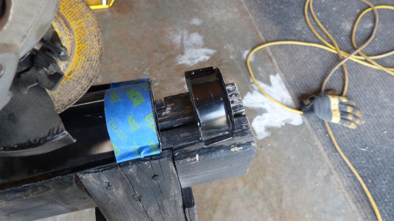

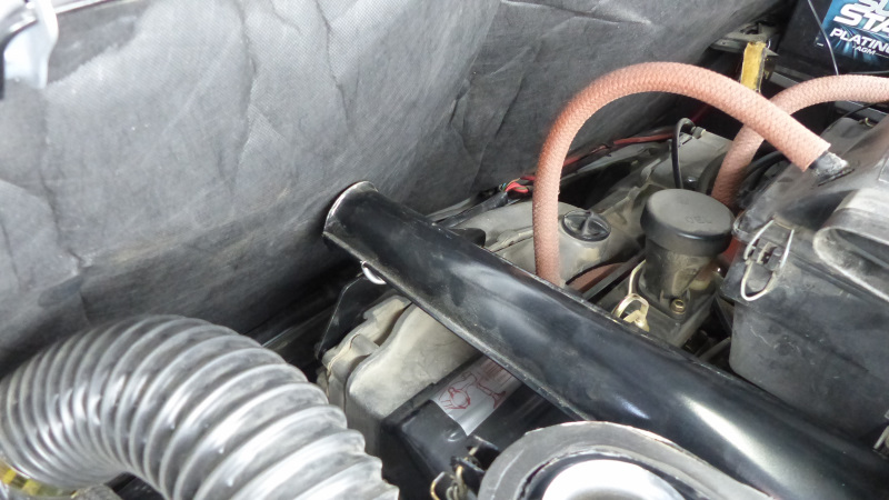

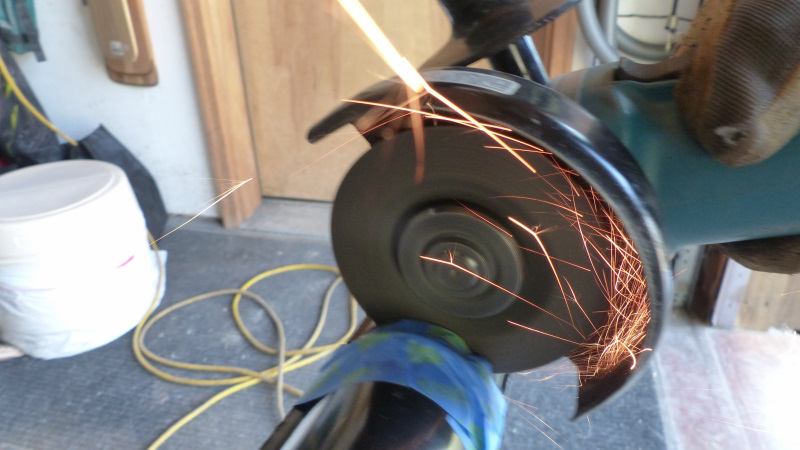

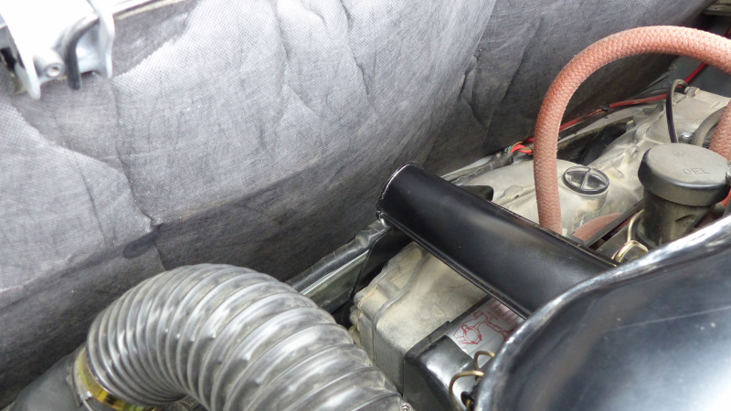

Had some errands to run in town today so decided to finally get the snorkel installed on the lowered air cleaner properly. Two adjustments needed to be made. One was to lower the support bracket to match the new, lower height of the plenum box. The other was to shorten the snorkel itself because I did not account for the backward "lean" of the firewall in front of the engine, or the thickness of the sound pad. The snorkel barely fit.
I lopped off more than an inch off the tip. Ooh, that doesn't sound good (IMG:style_emoticons/default/pinch.gif) (IMG:style_emoticons/default/blink.gif) Well, I did it anyway.
After a bit of reshaping the bugle flare on the end, here is "Shortie" snapped onto the lowered bracket.
Then I hit the open road to further check out sound levels. With the top off and windows up, I hit the Interstate at 75-80mph. The first thing I noticed was that the engine noise has completely disappeared and it is all wind noise at that speed. That is a switch because before, the exhaust note was very noticeable at any speed as you could hear in the previous driving video. Today I couldn't hear the engine at all at highway speed and I really tried. The next indicator was being able to order lunch at a drive-thru window while the car was idling. Before I had to shut the engine off to be able to hear. Then I found a shady spot to park to eat my lunch and got pretty good evidence the sound levels I'm getting on my phone are not reliable. With the engine off on a very quiet back road and the radio playing at a relatively low volume, the Decibel X app read an average of 100 db! I'm confident I was not anywhere near ear damaging sound levels. It will be interesting to see how the sound meter I ordered compares. I do think the app is decent at reading relative loudness even if the actual numbers are off.
It runs like shit
