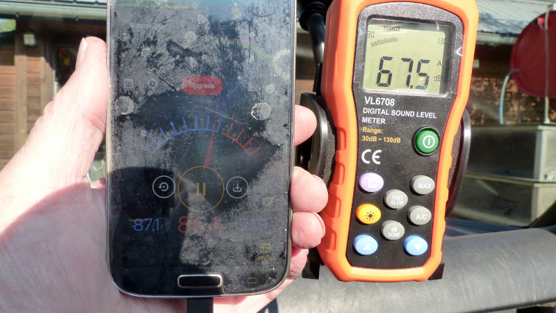

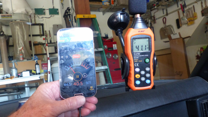

Got a couple things to catch up on but tonight I will just update that I have confirmed that phone apps are not worth dog (IMG:style_emoticons/default/stromberg.gif) for measuring sound levels - at least not on my phone anyway. Got the new sound level meter that is factory calibrated and did some side by side comparisons. With the car sitting in the garage with ignition off and the roof off, the quiet reading on the phone runs within 2 db of the meter which seems like a good start.
However, as suspected the phone is hyper sensitive to transient sounds. For example, the click of the shutter when I snapped this picture caused the meter to spike momentarily to 80 db. Give me a break. (IMG:style_emoticons/default/screwy.gif)
Now look what happens when I back the car into the driveway and measure the sound inside while the car is idling at 800 rpm (I really do need to change out that nasty screen protector on my phone).
I don't know how well you can read the phone, but it is measuring 86.6 db at the moment the picture was taken and an average of 87.1 db. Almost 20 db higher than the meter. That is HUGE! I couldn't get a pic but when I revved the engine to 3500 rpm, the disparity shrank some but was still significant. The meter read 79 db which fits with what my ears were telling me while the phone read 95 db so still a 15 db. difference. Let's just flush those numbers taken with the phone and start over.
When I get a chance, I'll repeat the 5 ft. behind the car measurements for both the Bursch and Ben's muffler to get a more accurate baseline.
