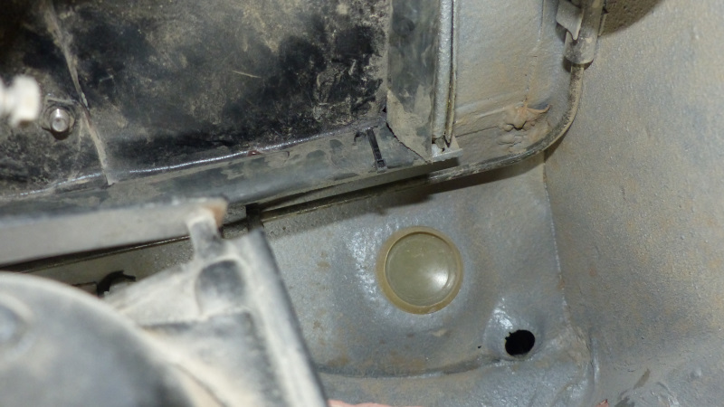

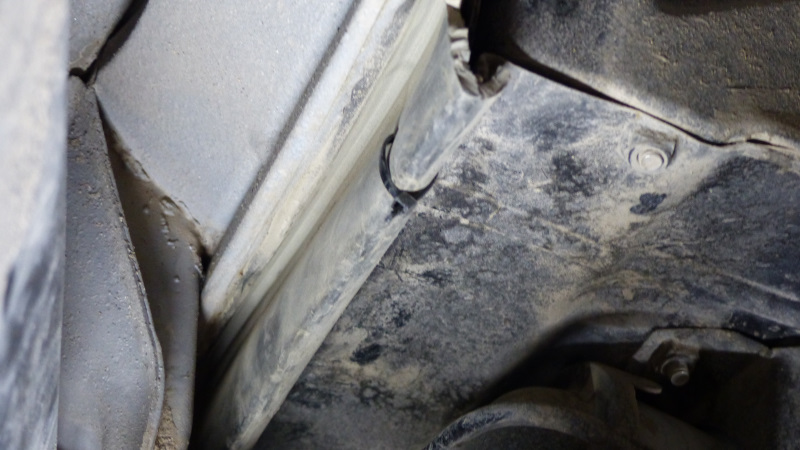

While I was under the car today, I attempted to fix a problem that plagued me all last summer. I could not keep the engine tin seals from pulling away and leaving gaps. That played hell on the 3 miles of gravel road I drive since one trip out would fill the engine bay with dust. Not good. I've read hog rings were used in some way to help keep those seals in place, but I wanted to just get something done so I drilled through the engine tin flange at the corners and through the outer side of the seal. Then I ran zip ties through to pull everything tight to the tin. It was a pain and I could only get the drill in the corners, otherwise I would have added zip ties halfway between too. Not exactly elegant, but I hope it helps.

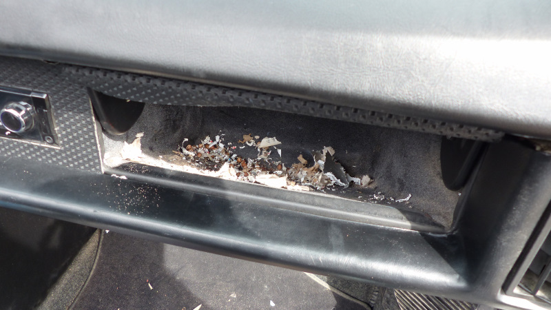

Later I opened the glove box and found that even with the car stored inside a well sealed garage, a @$%^ing mouse had been in there chewing the shit out of things. (IMG:style_emoticons/default/headbang.gif) I also found a wire on the console harness with insulation chewed. I was able to "fix" that with liquid electrical tape (I love that stuff) but it still pisses me off after all the work restoring all the harnesses.
bkrantz
post Apr 30 2022, 08:02 PM
Post #2127
Posts: 8,710
Joined: 3-August 19
From: SW Colorado
Member No.: 23,343
I HATE MICE!
Besides the damage and waste they left in my car before I bought it, I have been battling mice in and around my house for 5 years. The longest fight has been in the crawlspace. Last year, they opened a new front on my elevated deck, setting up home on my outdoor sofa, under a rain cover.
Superhawk996
post May 1 2022, 08:22 AM
Post #2128
Posts: 7,846
Joined: 25-August 18
From: Woods of N. Idaho
Member No.: 22,428
You're probably not going to like my solutions - neither of which are ecologically friendly.
1) Get some outdoor / barn cats. They kill lots of mice - but birds too.
2) Mouse poison in the little paper pouch /packets. I used to put three of these in the Miata when it was left in the Idaho field between trips. One packet in engine compartment where you can easily remove it. One inside the interior. One in the trunk. In all honesty, over the course of about 8 years, I only saw the packets in the trunk and the engine compartment chewed once each. They tend to love to chew the packet paper and the of course the bait which keeps them away from the rest of the car. I know these packets can have negative implications for birds of prey that can potentially ingest 1/2 dead poisoned mouse. Given the average frequency of attack (average one chewing / 4 years) I can't see that much risk but would feel very differently if I were burning though lots of chewed packets.
I'd be interested in other more environmentally friendly solutions but these are the two proven strategies I'm aware of.
The main strategy that has worked with the Idaho house (which had mice when purchased) was to remove all shelter and food sources from the crawlspace. Original owner had all sorts of crap (old windows, old wood remnants, etc) down there that was a prime breeding ground. I also tried to remove any tall grass from a 5' perimeter of the house. One the shelter and food sources were gone, the mice disappeared too.

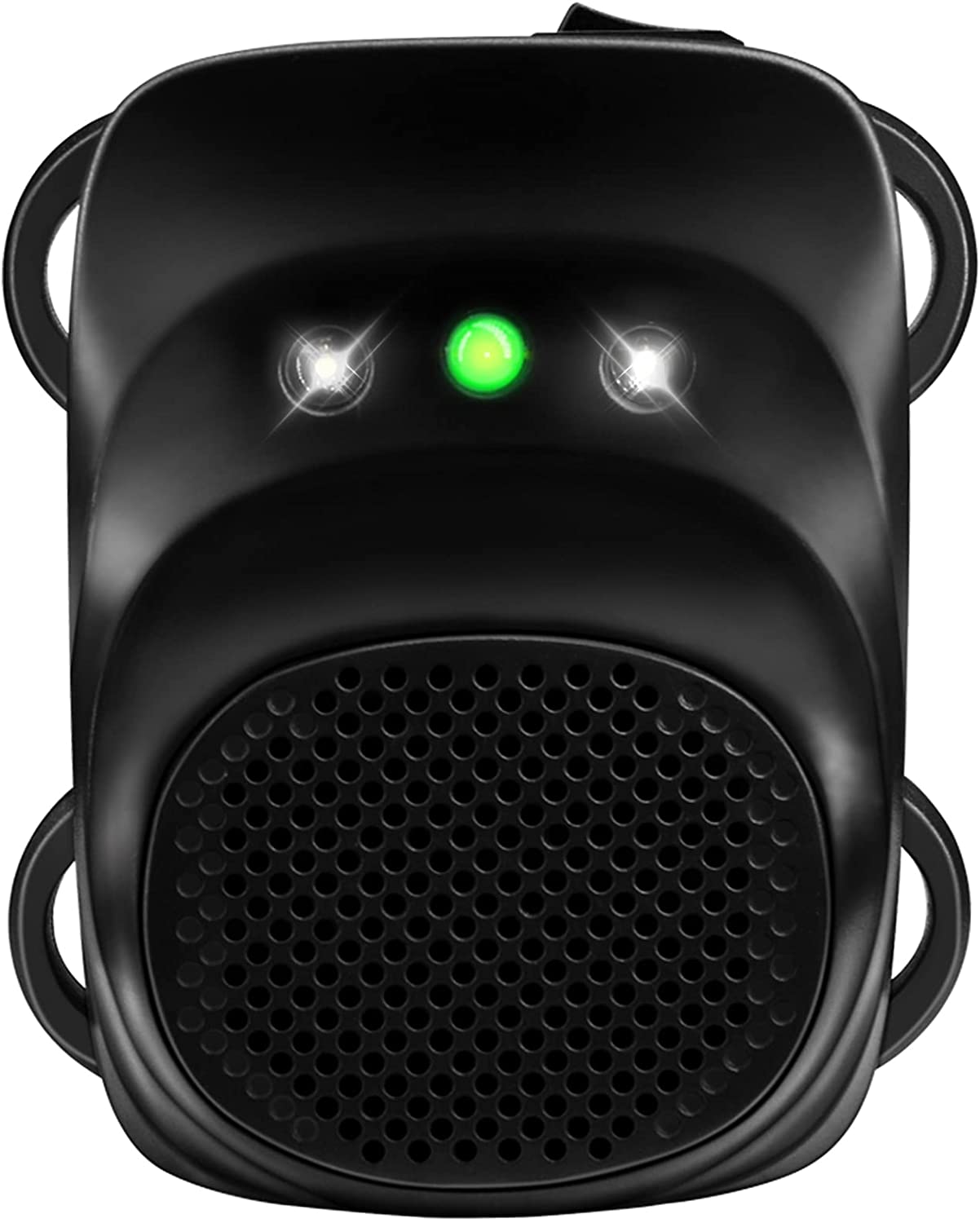

Have you looked at something like this for your rodent problem?
Loraffe Under Hood Animal Repeller Rodent Repellent Ultrasonic Rat Deterrent LED Strobe Lights Keep Mice Away from Car Pest Control for 12V 24V Automobile...on Amazon.

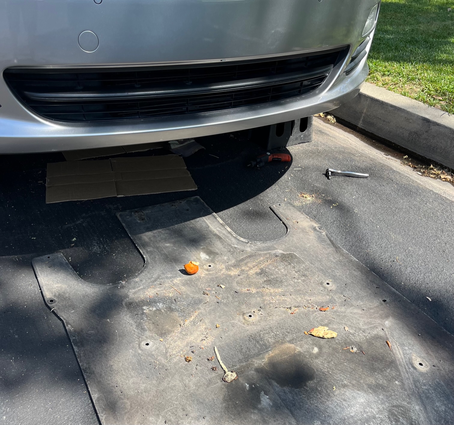

I might give it a try. When I dropped the stone guard to change the oil on the sedan last Saturday, it was apparent that I have critters taking advantage of the engine heat down there. Luckily, no nests or chewed wiring.....
