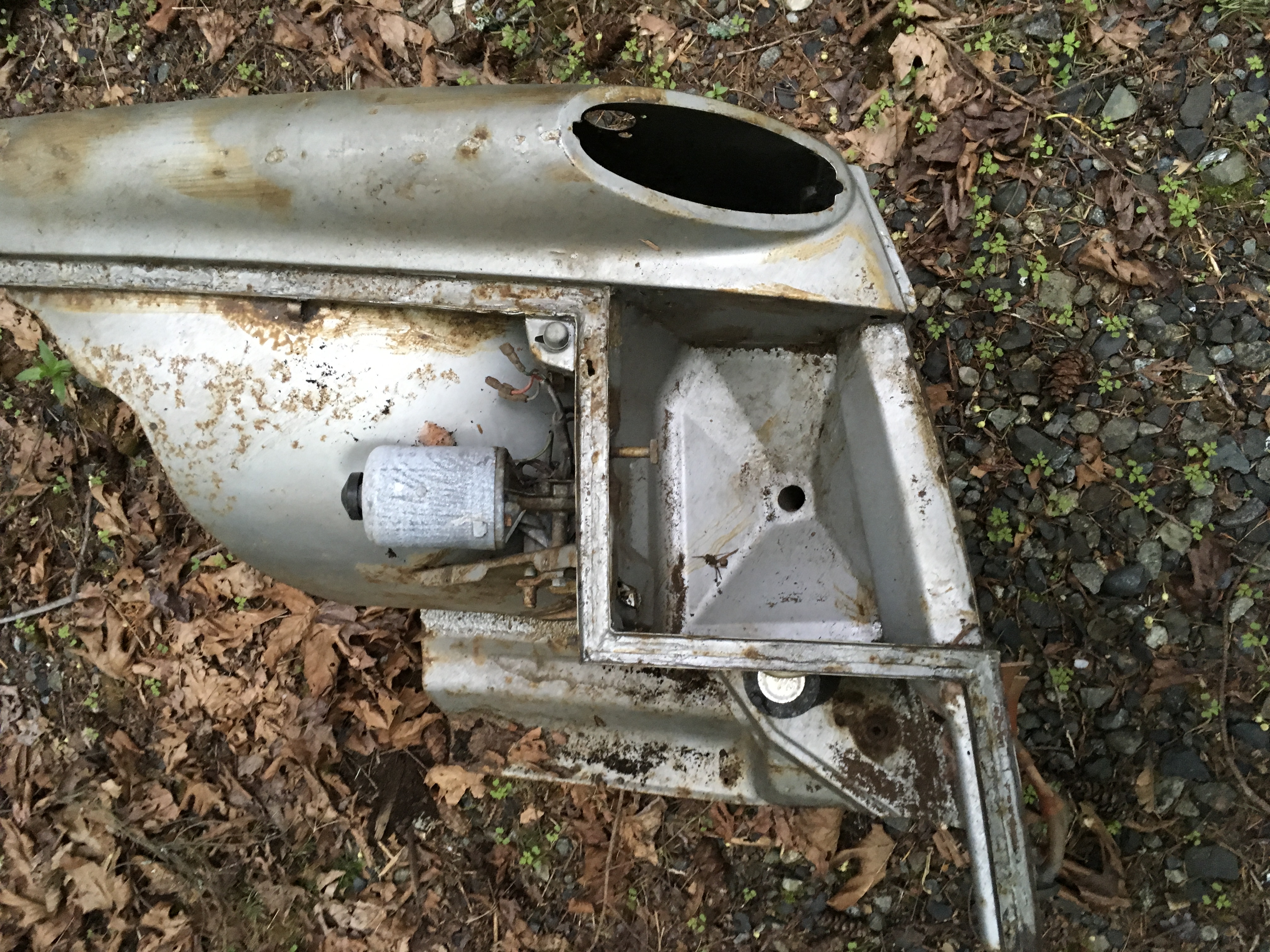

Hey Brent, would you like me to bring you a driver's front 1/4 piece with headlight bucket and fender back to halfway thru the wheel well? This is a pay it forward part that I got years ago and need to pass on to someone else. It's not pristine but I think there's some usable segments.
Hey Marc, You are turning out to be the savior of this project! Yeah, if that bucket section is intact, that will be just the ticket. I wish I'd found this before the car was on the rotisserie though. It's going to be interesting to say the least. Looking forward to your visit!
This is what I have. Yours if you want it....including the ride. (IMG:style_emoticons/default/biggrin.gif) Attached Image

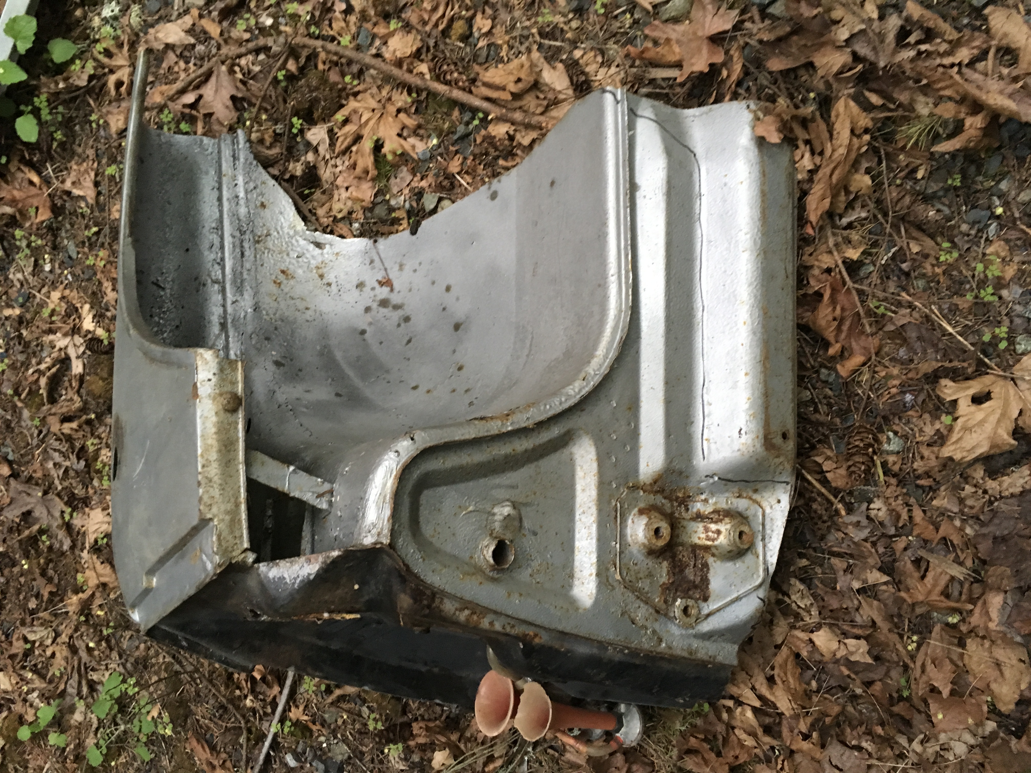

Back side

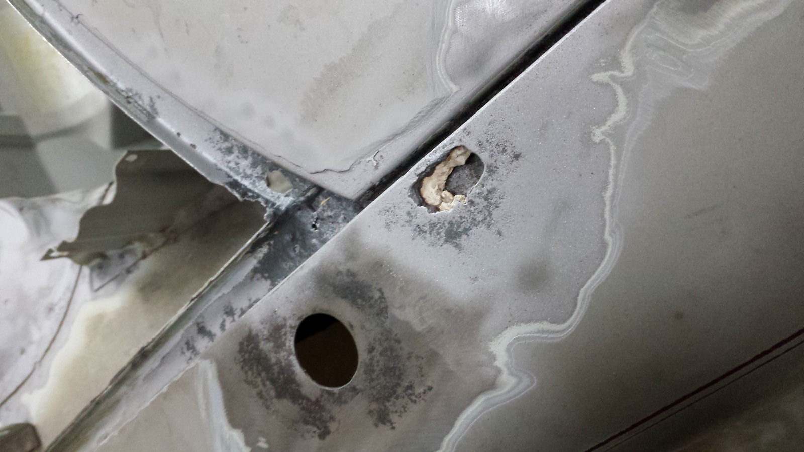

Thanks Ben, that's very generous. I think I need to get back in with the blaster and clean the area up nice before deciding how to tackle it. The issue is access. It is the little bulge in the outer wall of the headlight bucket/inner fender that is tucked up under the funnel for the headlight and is where the bumper bracket welds on from the outside. It's really hard to see or I would have found it and addressed it before putting the car on the rotisserie. The rust is clearly cosmetic at this point since that bracket is what a corner of the car has been hanging from for months and nothing has bent, torn, or cracked. It would be easy to bend up a patch from sheet but I don't know if I can get the welder in there to tack it in place from the inside. If I can, this will turn out to be minor, if I can't, going from the outside seems the only other option and that is a can of worms. That will require either pulling the car off the rotisserie, or rigging an alternative support that will let me pull the bumper bracket out. I'm looking at the bolt for the fog light mount as an option. Looks pretty beefy.
The fender piece could open 3 options:
1. A new trunk "ear" that would let me cut out the one I just repaired that might open some access from the inside.
2. Provide a replacement bumper bracket in case the old one can't be removed in reusable condition.
3. Provide a preformed donor patch.
Truth be told, I could probably clean this spot out, treat it with rust converter, protect it with paint, and forget about it. Somehow I don't see that happening... we'll see what I think after blasting.
Anyone have some welder nanobots they could loan me? (IMG:style_emoticons/default/rolleyes.gif)

Finally got that area blasted tonight. I won't be needing that part but thanks for the offer. I think I can patch this in place. Not worth shipping and tearing up a fender chunk for. It ain't gonna be fun though. I thought that little hump where the hood release attaches was a giant B, this might be worse. (IMG:style_emoticons/default/pinch.gif)

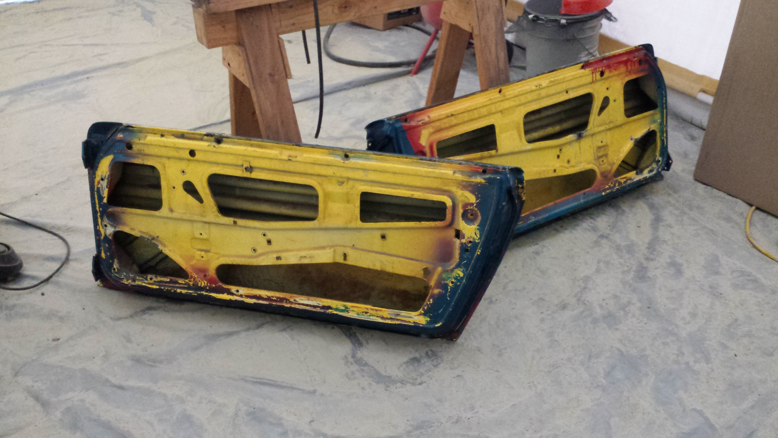

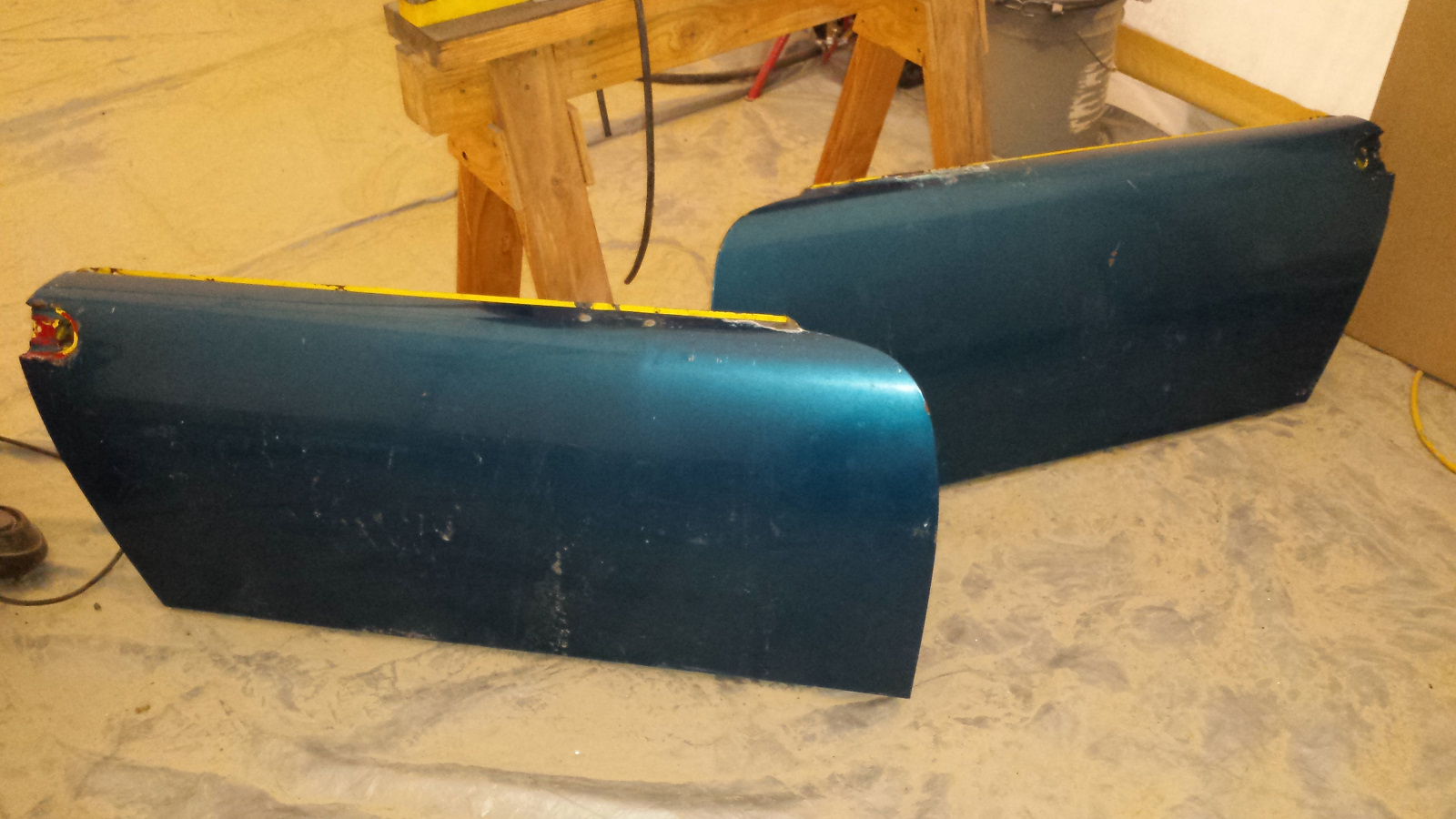

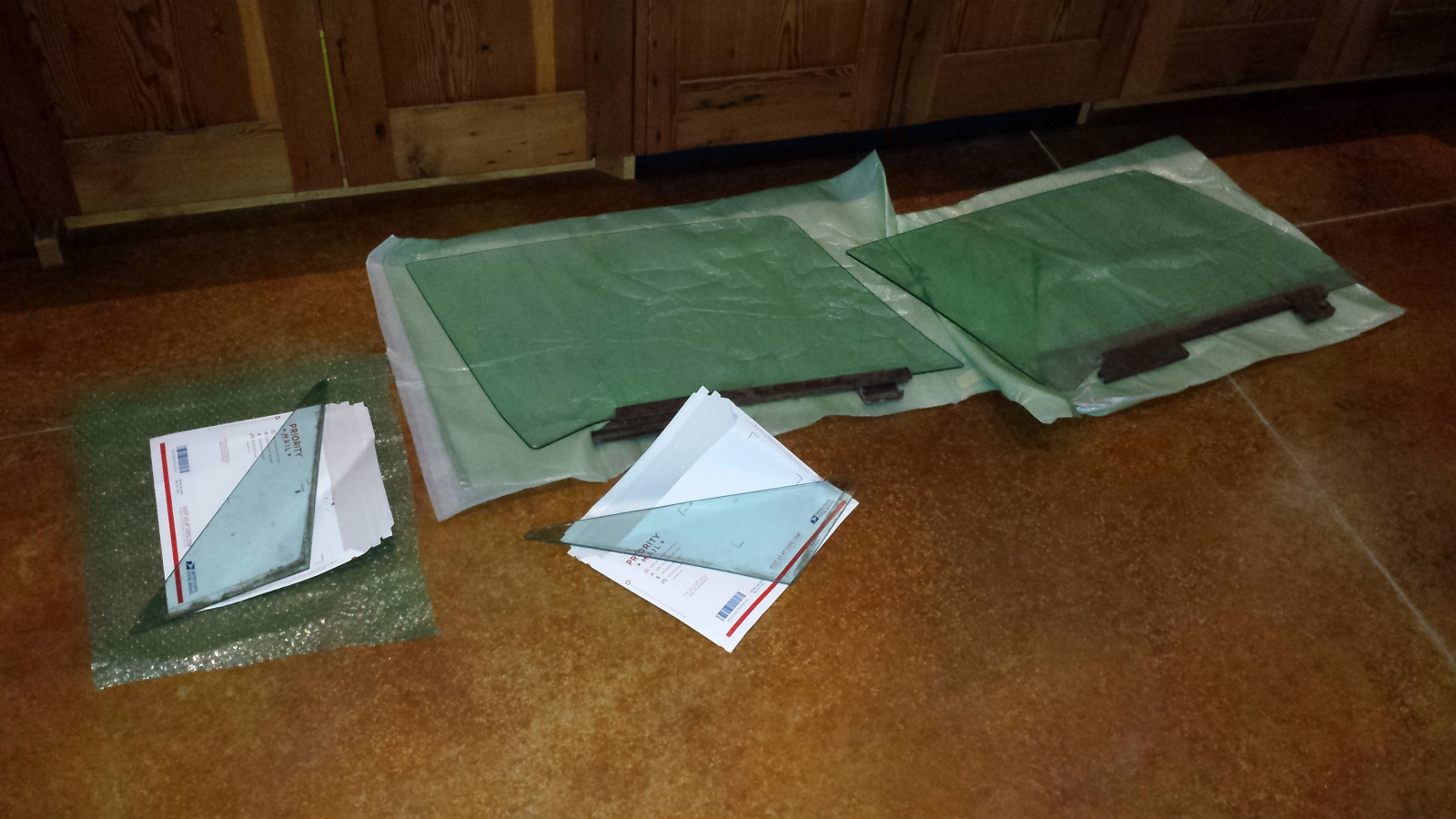

Wednesday was a fun day. Marc (Kelty360) arrived early afternoon hauling some special cargo for my project. We quickly discovered we have a lot more interests in common than just our obsession with Porsche's red-headed step child. I have serious Westy envy and since Marc parked his camp on wheels at our house for the night, it allowed us to talk all afternoon and into the night.
Stowed away in the Westy were a pair of doors from Rich at 914Werke, and a complete set of tinted side glass. The doors need some work to fill holes from aftermarket side mirrors and screw holes from door mounted speakers (luckily they did not cut the structure), and a small repair on one of the seal channels. My original doors would take about 2 weeks to repair with uncertain results, these reduce that work to 2 days. (IMG:style_emoticons/default/cheer.gif) But look at these beauties. They have me rethinking paint and maybe I'll just match these doors. That way, whenever anyone asks the question about what color I'm going to paint it, I could just reply, "All of them." (IMG:style_emoticons/default/av-943.gif)
The other goodies tucked away in Marc's Westy was a full set of tinted side glass, also from 914Werke. I didn't really need these, but my original clear glass has some deep scratches that would have needed replacing eventually and I've always wanted tinted glass. I need to clean these up but they mostly look great. I am concerned about a portion of the passenger window because there appears to be grinding slag embedded int he glass. On my quick inspection, I was able to pop some of it out with a thumbnail so hopefull the rest will do the same and I can polish it out. I've never polished glass before, anyone have suggestions?
This is just another example of how great and supportive this 914 community is. Marc generously offered to haul any parts from Seattle I might need. I immediately thought of Chris's suggestion to see if someone passing through might be willing to haul doors. I posted a WTB and withint 15 minutes, Rich had stepped up with what I needed. If I'd listened to Rich, Marc would have been hauling a full windshield in that Westy too! But I didn't want to push my luck. And I could have really pushed it by having him haul a rear trunk lid from Rhodyguy who generously offered to send one along after catching wind that Marc was headed this way. It's just an amazing community and I thank all of you for supporting this crazy project. (IMG:style_emoticons/default/smiley_notworthy.gif)

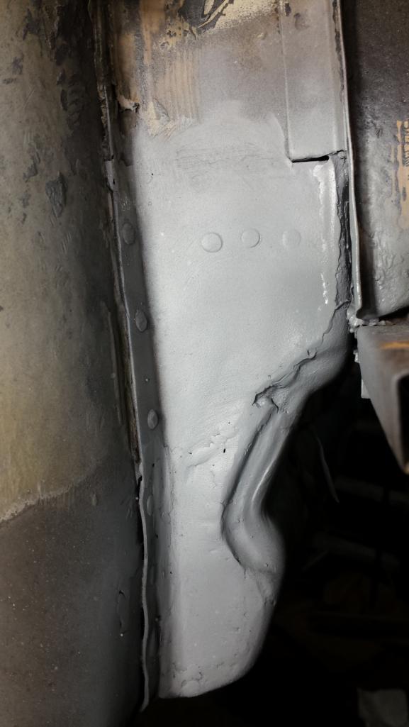

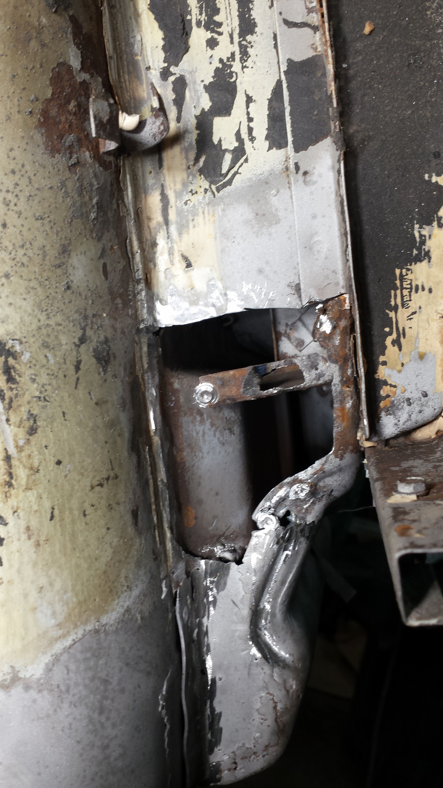

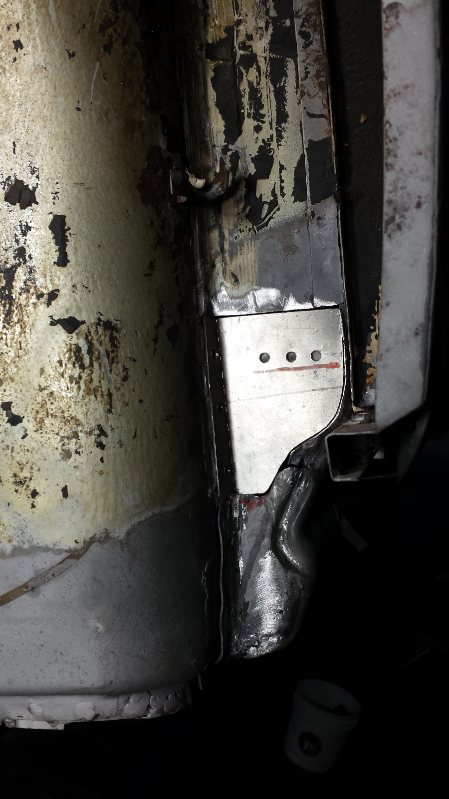

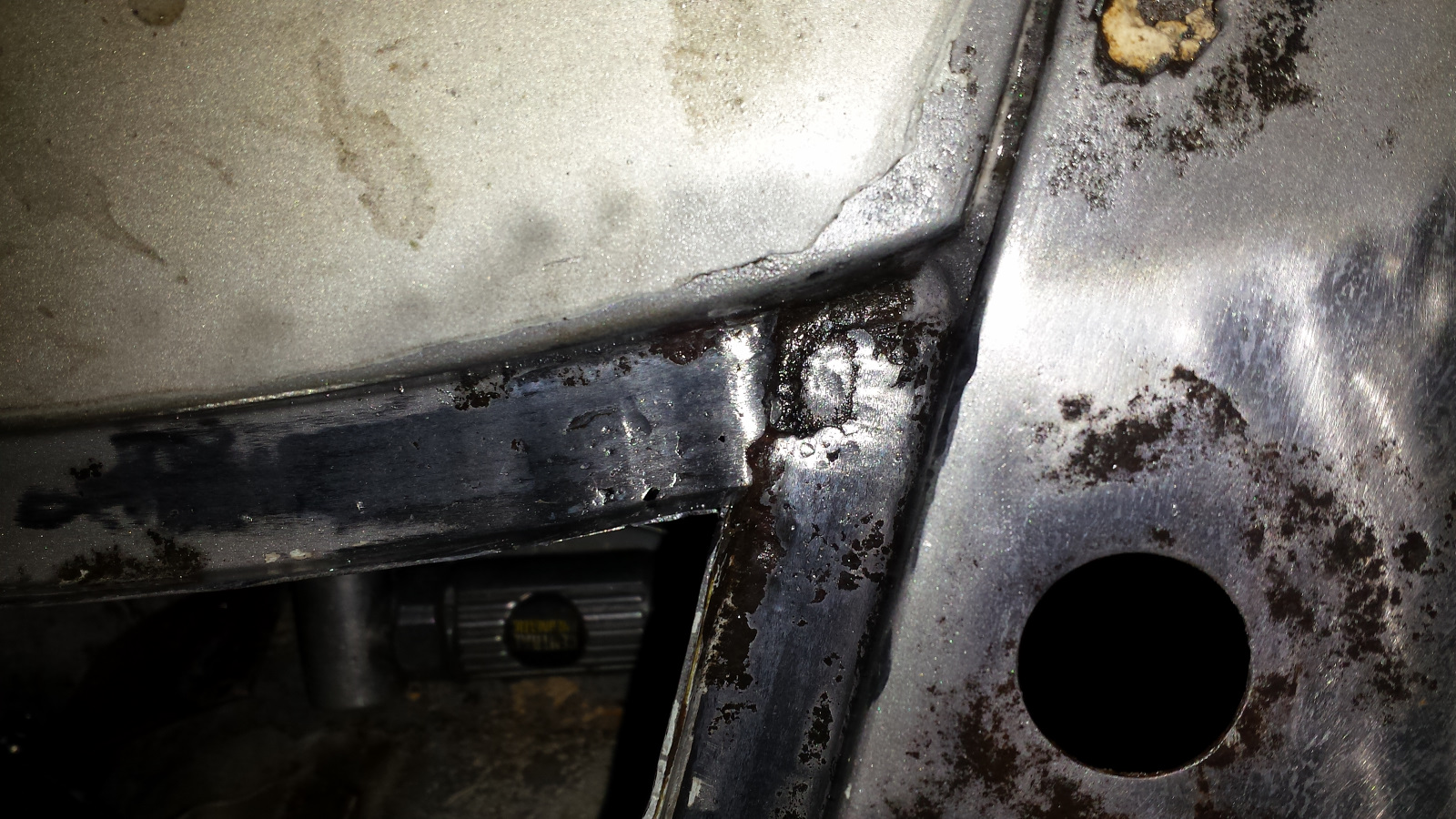

Then yesterday I slipped out to the garage for a couple hours. I set the cancer under the bumper bracket aside for now and wanted to tackle something that was an easy win to boost my psyche. I have one last bit of channel to repair at the upper left corner of the frunk, and there is a hole in the fender behind the antenna mount that needs patched.
I started with the channel. It was a pretty small area with some deep pitting, a 10mm hole, and a small nipple of channel wall next to the hole that was eroded away. I decided to try just zapping everything back into shape with the MIG. That actually worked well. It isn't quite finished but close, and that's as far as I've gotten.

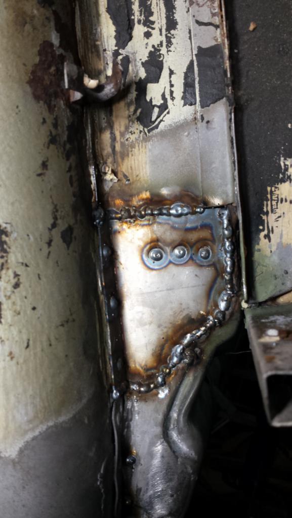

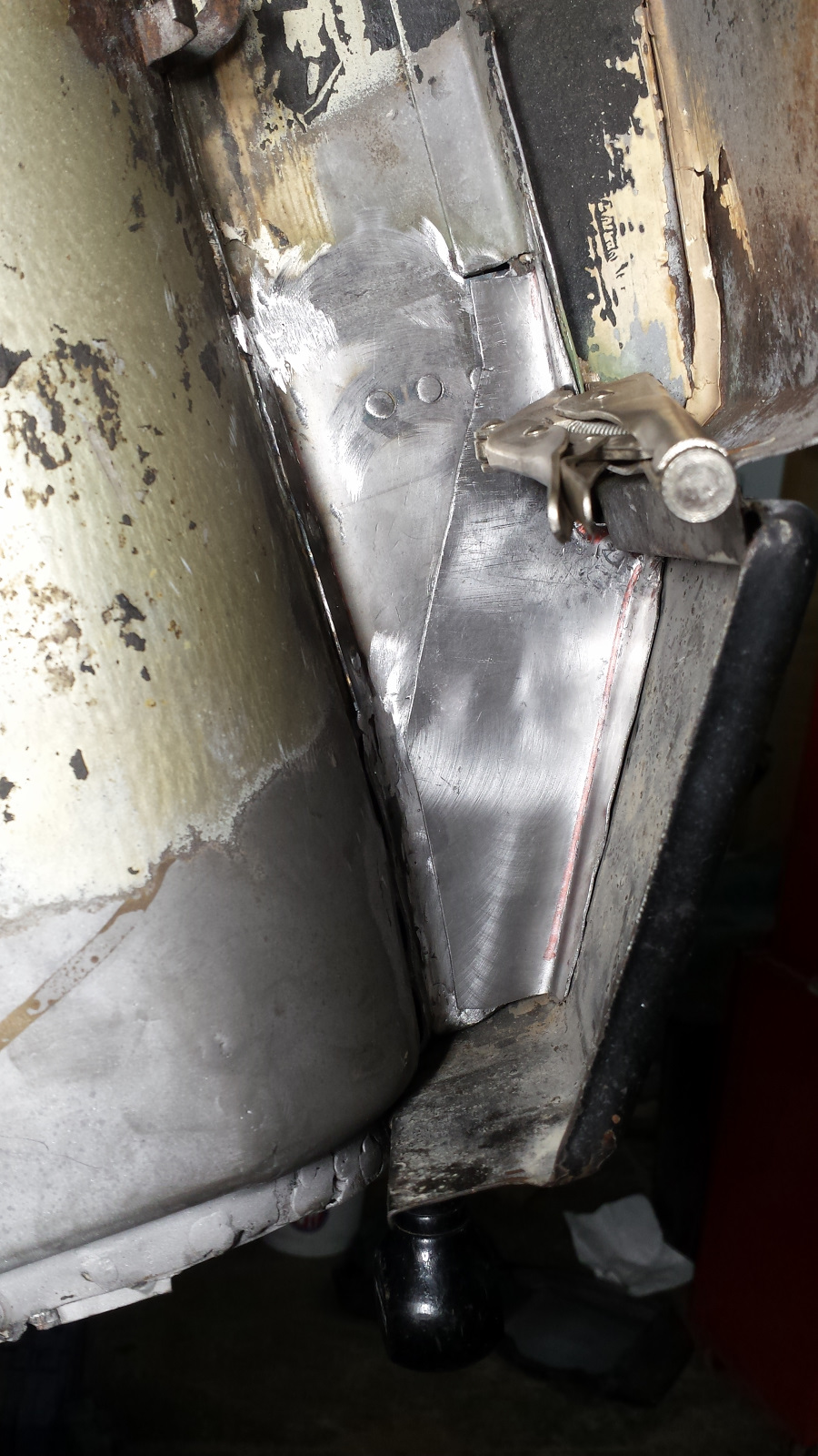

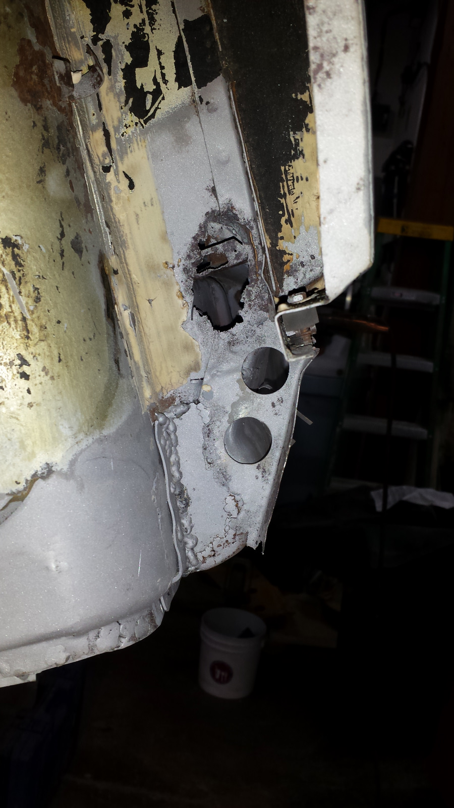

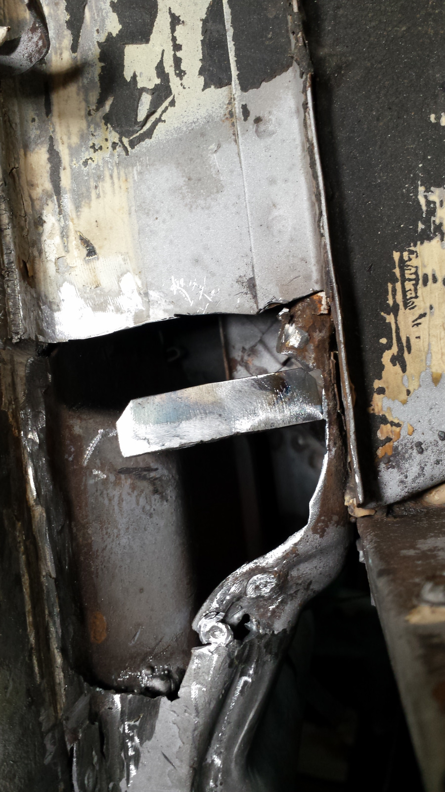

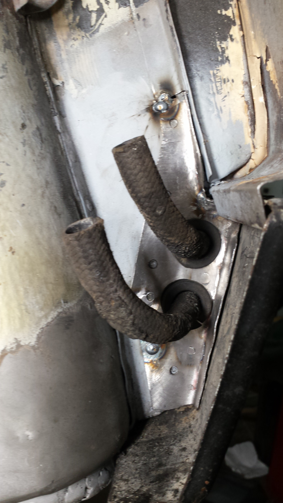

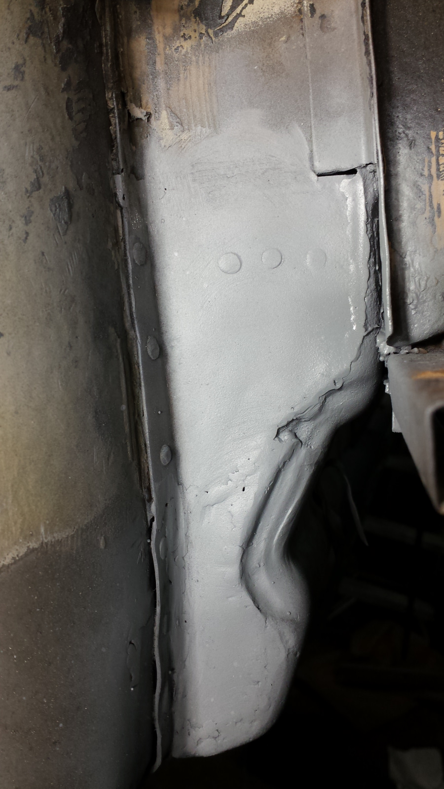

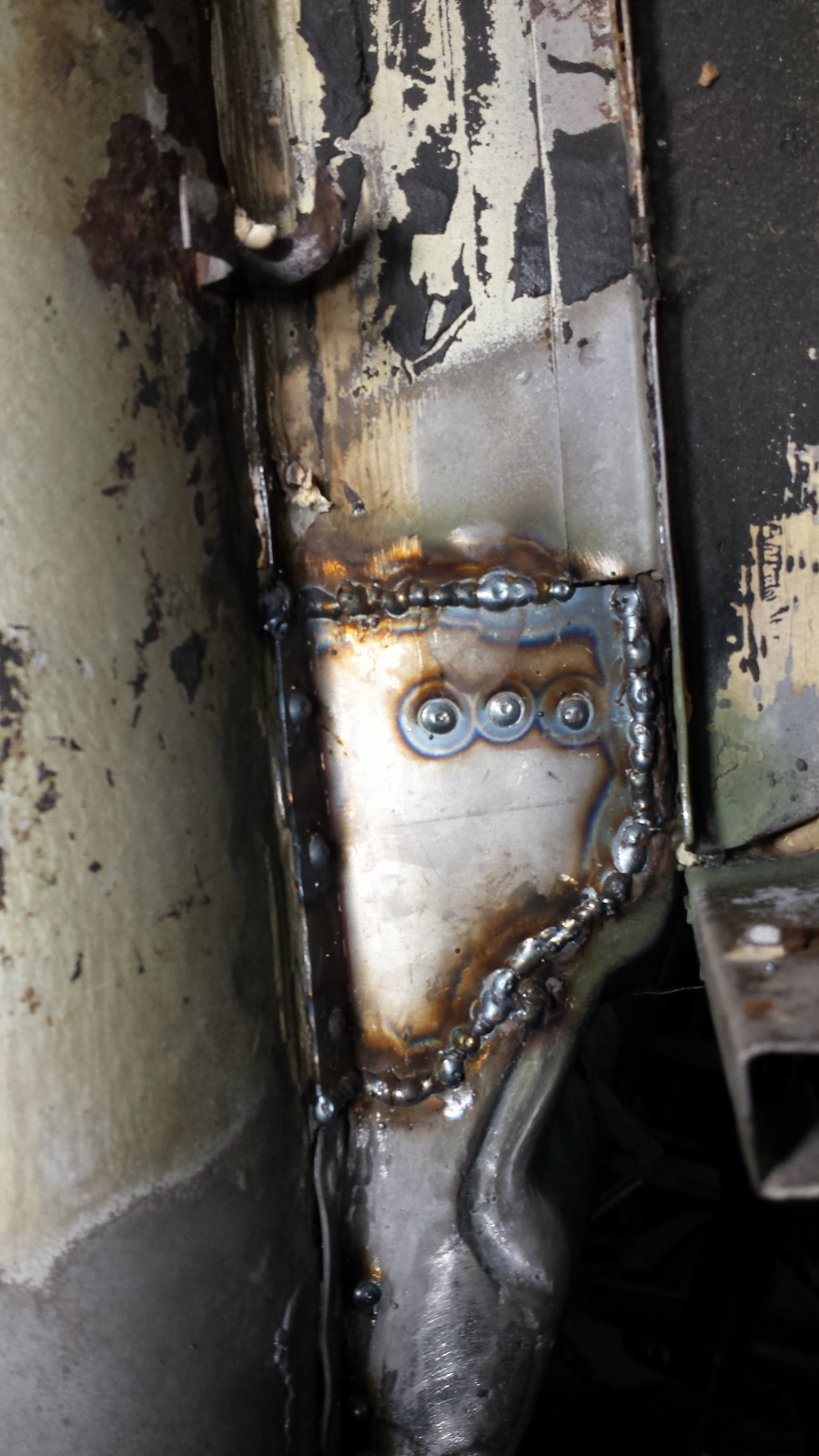

Tackled this nasty spot today.
First, cut out the rotten parts, but save what's left of the rocker cover bracket to fab a new one.
Then replace the rusted weld flange inside the support.
Fabricate a patch.
Weld it in.
Clean it up and give it a coat of weld-thru primer.

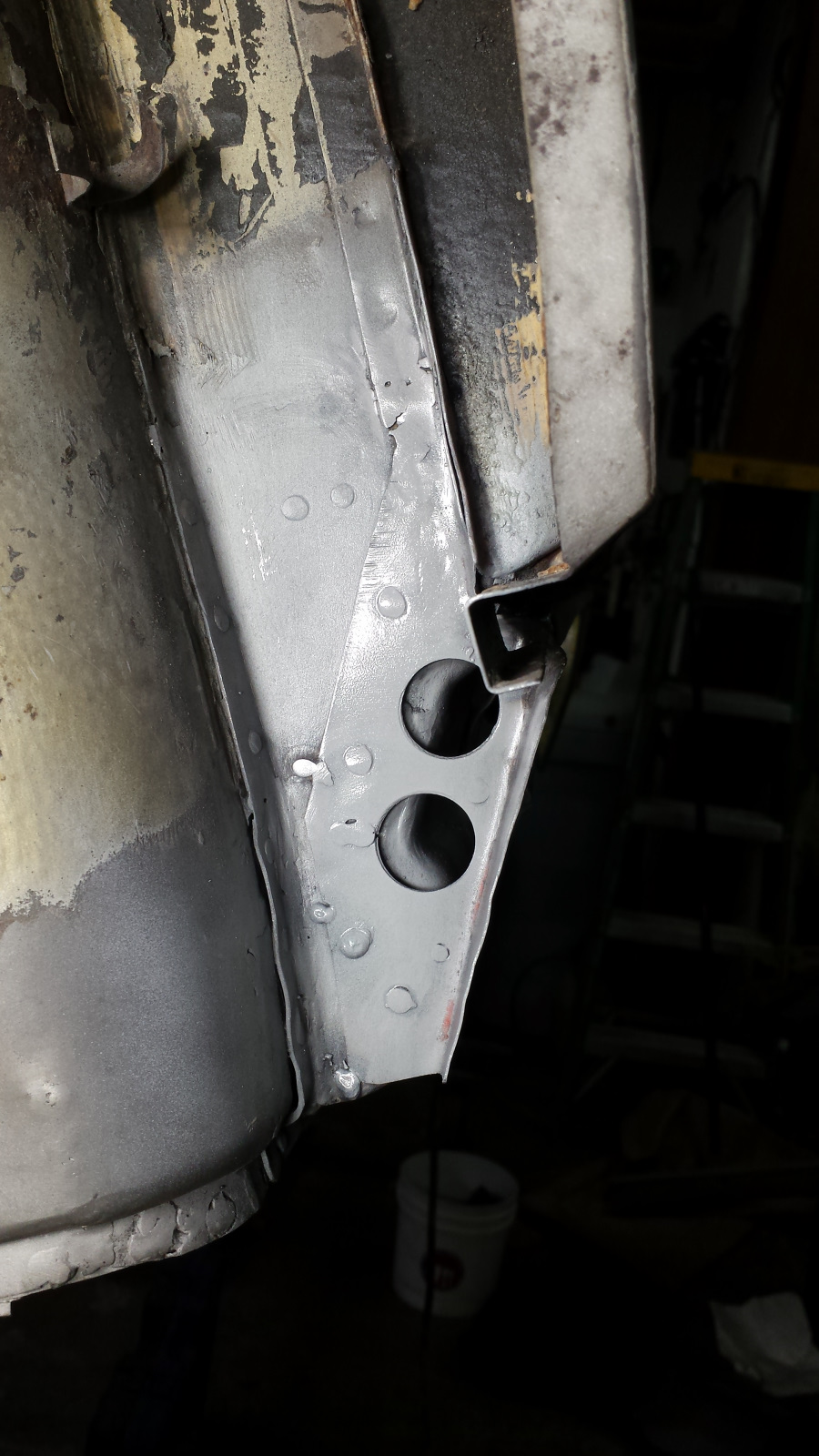

Now fabricate a new rocker cover bracket to patch in. That piece was a PITA, but I finally got a good dry fit.
I need to cut the holes for the fuel vapor lines before welding it in, but I was getting tired and was afraid I'd F it up. So, I quit for the day and will start fresh tomorrow.

I finished up yesterday's project this morning. Just to make sure everything is in the right place, I put in the plumbing and clamped up the rocker cover before tacking the bracket in. It was a PITA, but everything seems to work. A shout out to BPic for quickly posting a pic for me yesterday so I could fill in the blanks on my rusty bracket. I think I got it right.
The rest was easy enough.
Nice to have that chore out of the way. Now I can load up my spool of Easy Grind wire and patch some body panels. (IMG:style_emoticons/default/welder.gif)
