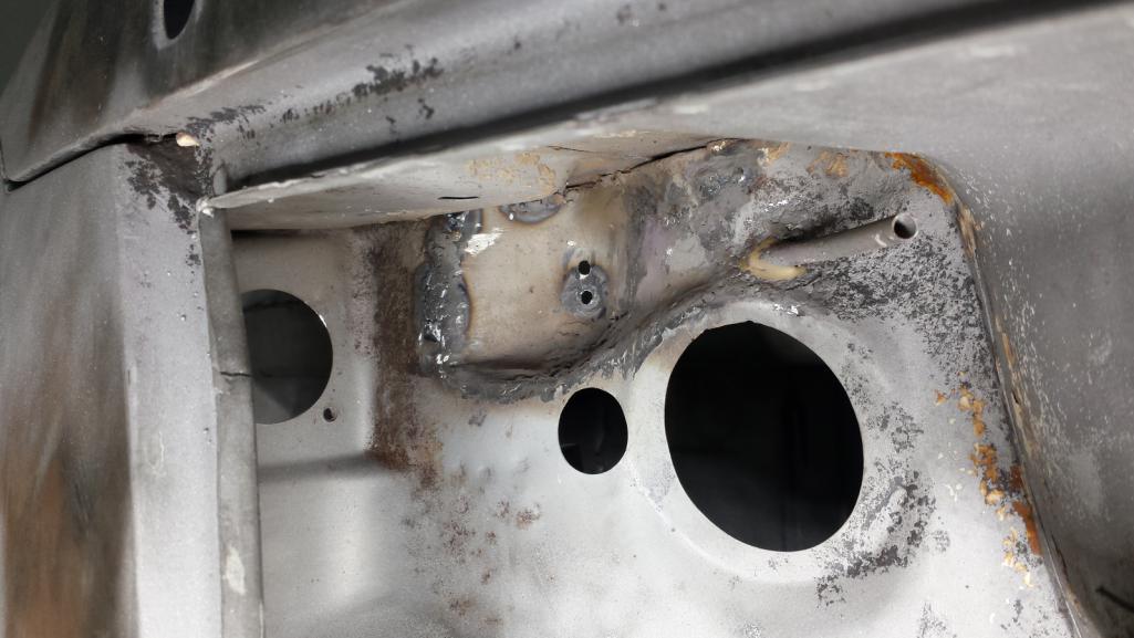

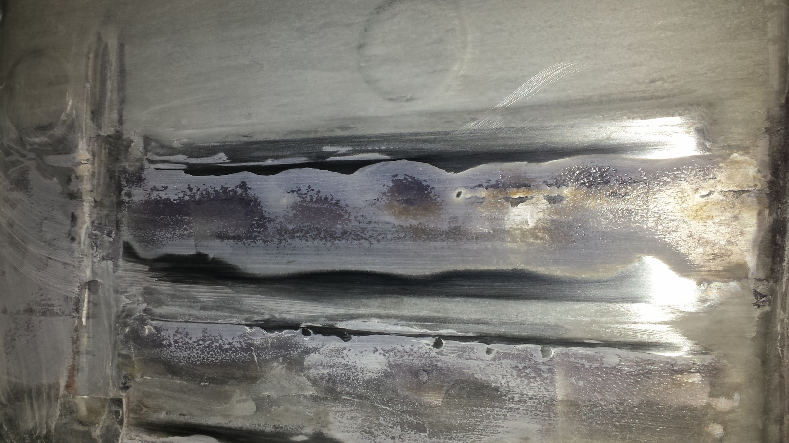

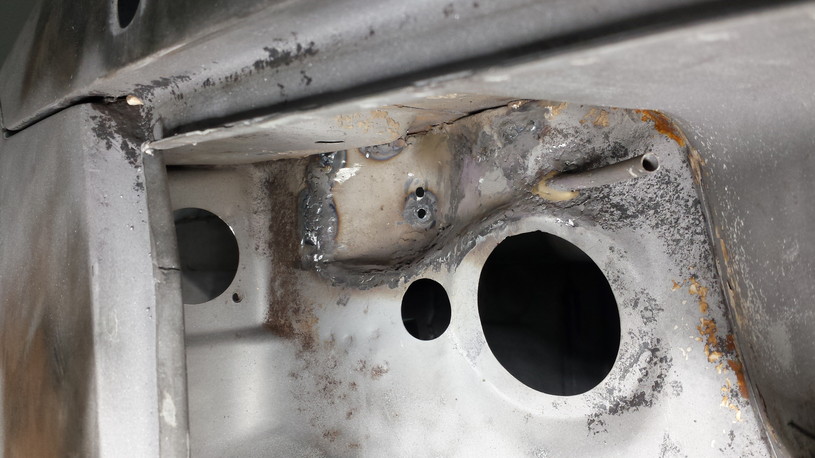

One Last Thing

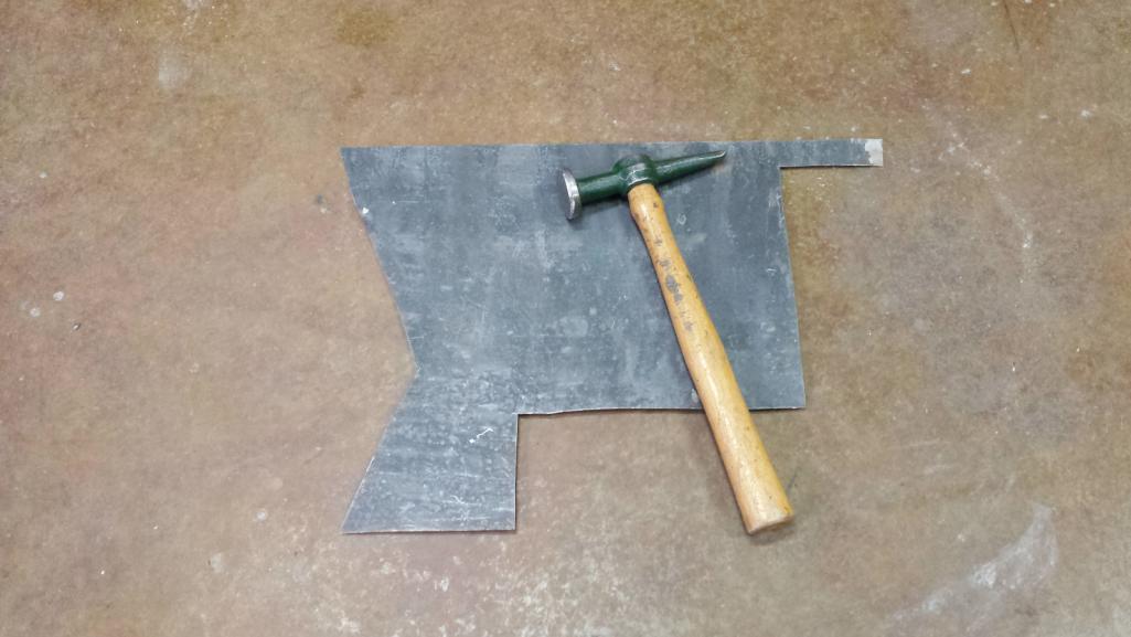

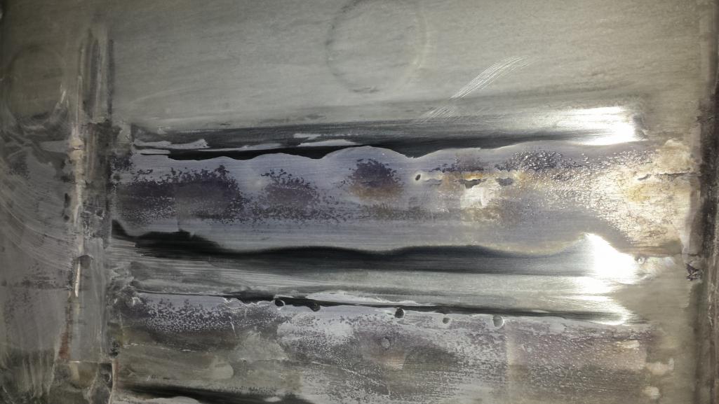

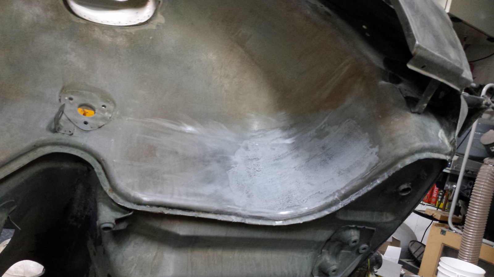

Was getting ready to wheel the tub out for a full Ospho treatment but I was never happy with my repair of the tricky area where the frunk cable pull attaches to the bulkhead. The butt welds were Swiss cheese and rough.
I close up all the welds, did a better job of grinding, and welded and redrilled one of the screw holes. This is yet another bag of buttholes looking photo, but the repair looks much better. Still not great, but they best I can expect working in an inaccessible place with surface pitted metal that wants to blow out, and a welder with mediocre skills at best... but it's strong.

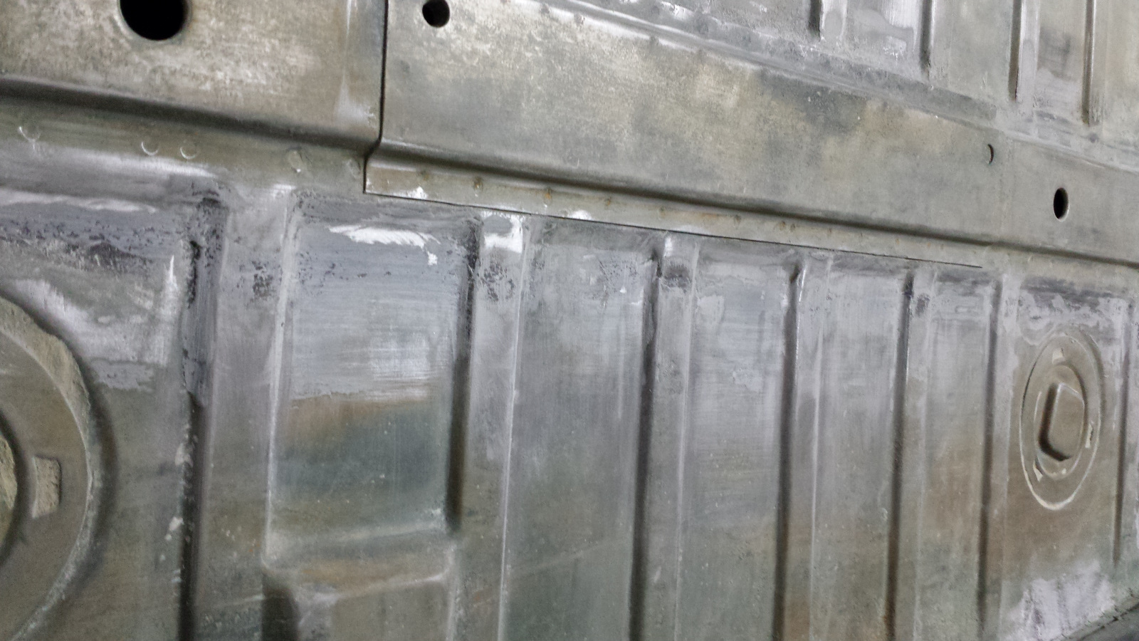

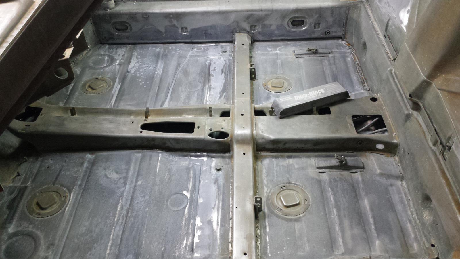

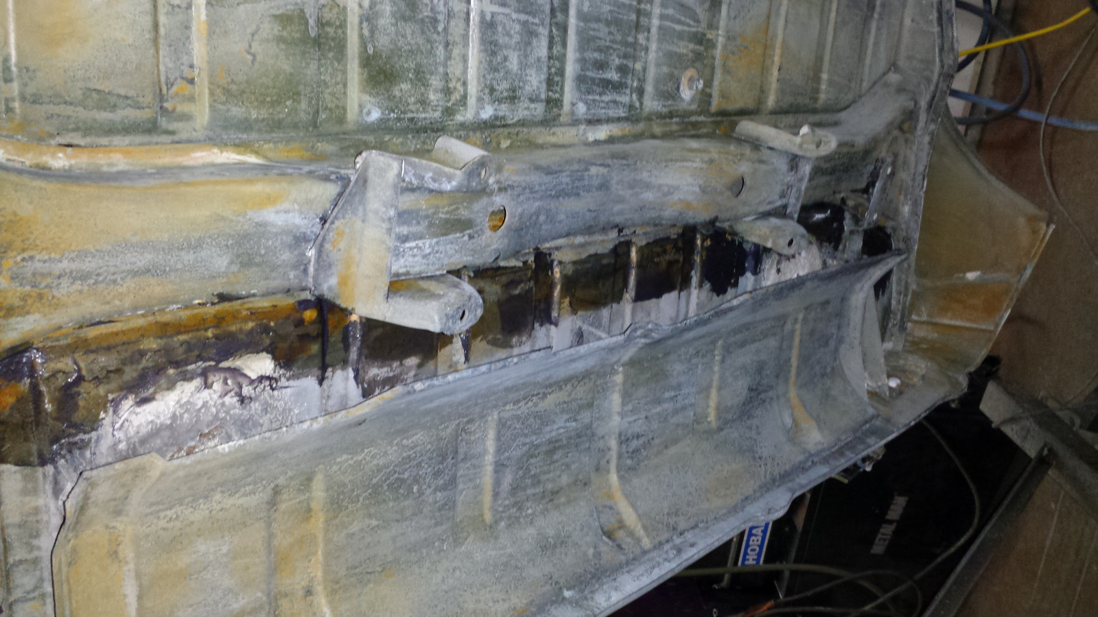

Let's Drop Some Acid

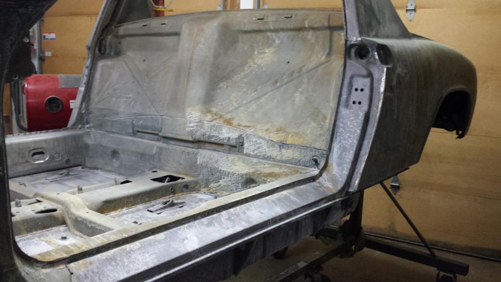

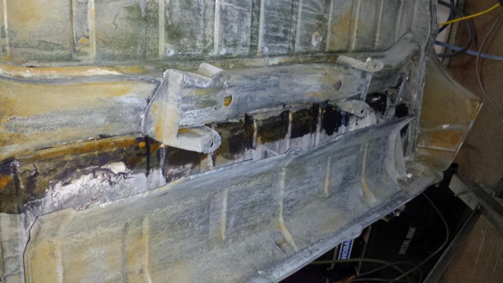

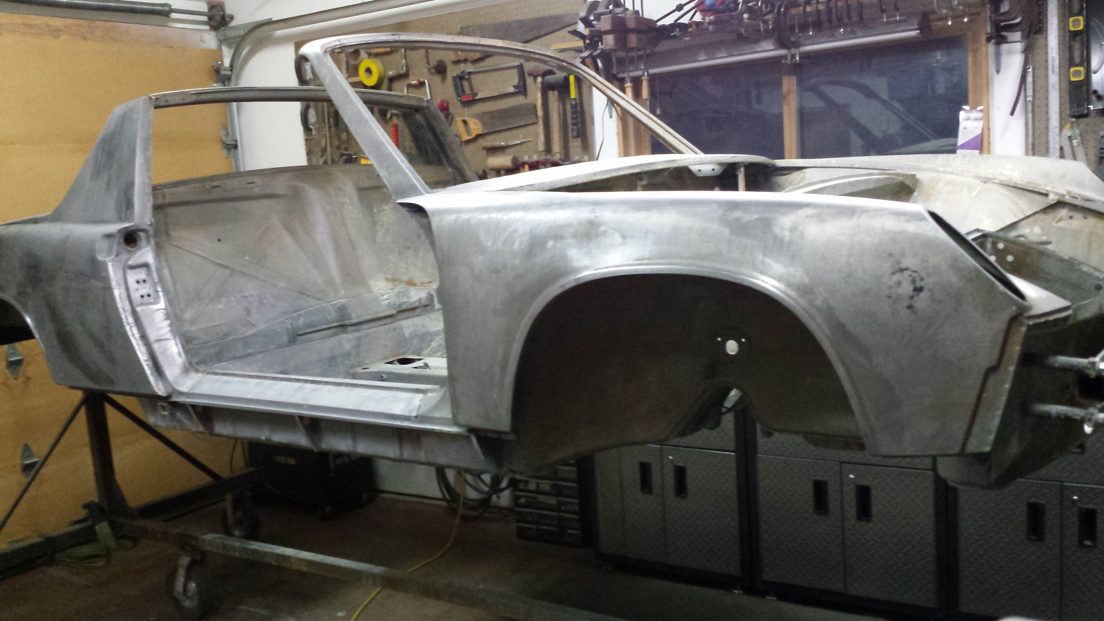

Timothy Leary had his preference, but I went with phosphoric to turn on, tune in, and drop out. Started Friday afternoon by spraying the insides of all boxed frame members that weren't opened up and sprayed with epoxy during the few minor rust repairs I've done on the chassis. I left those to steep overnight to give plenty of time to convert any rust lingering in there. I may repeat that treatment depending on what a boroscope inspection shows.
Saturday morning I sprayed the rest of the chassis with a 25% solution of acid according to label directions for etching metal. I'm not convinced that's better than full strength. I let that sit for about an hour because it was chilly in the tent so I allowed more time. Then the whole tub got rinsed with water inside and out. I left it in the tent for a few hours to drip while I did some cleaning and reorganizing in the shop.

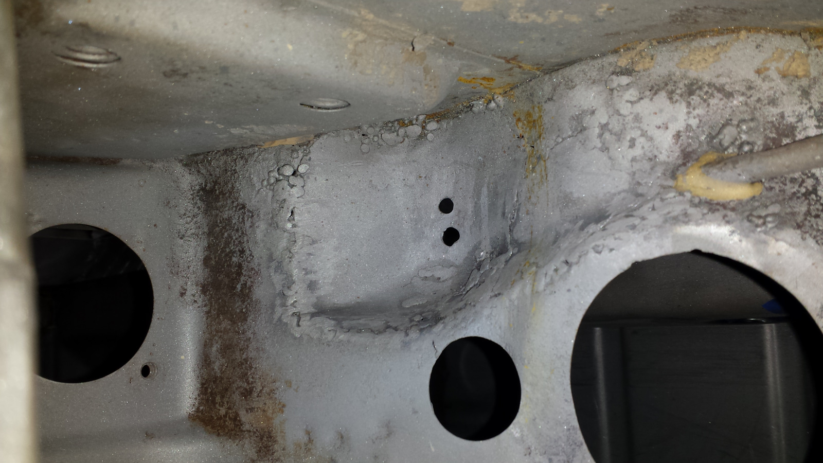

After rolling the tub into the shop, I went over every seam or area with overlapping metal with a heat gun to bake any moisture out. Same for enclosed frame members. I also left cranked the thermostat up on the garage just to make sure the car is completely dry. After it was dry, it left an ugly scene.
Next I set about scuffing all the loose coating left behind with red Scotch Brite pads. It's hard work and the hot garage makes it more so. Here's a comparison shot. Drivers side untouched, passengers side scuffed, vacuumed, and wiped down with wax and grease remover.
Here's a look at a full side done.

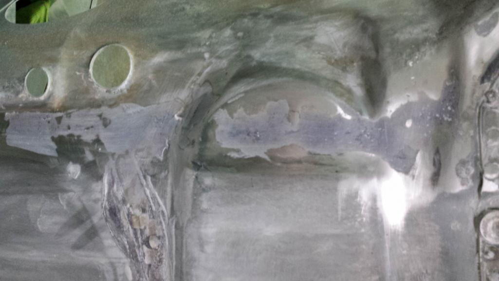

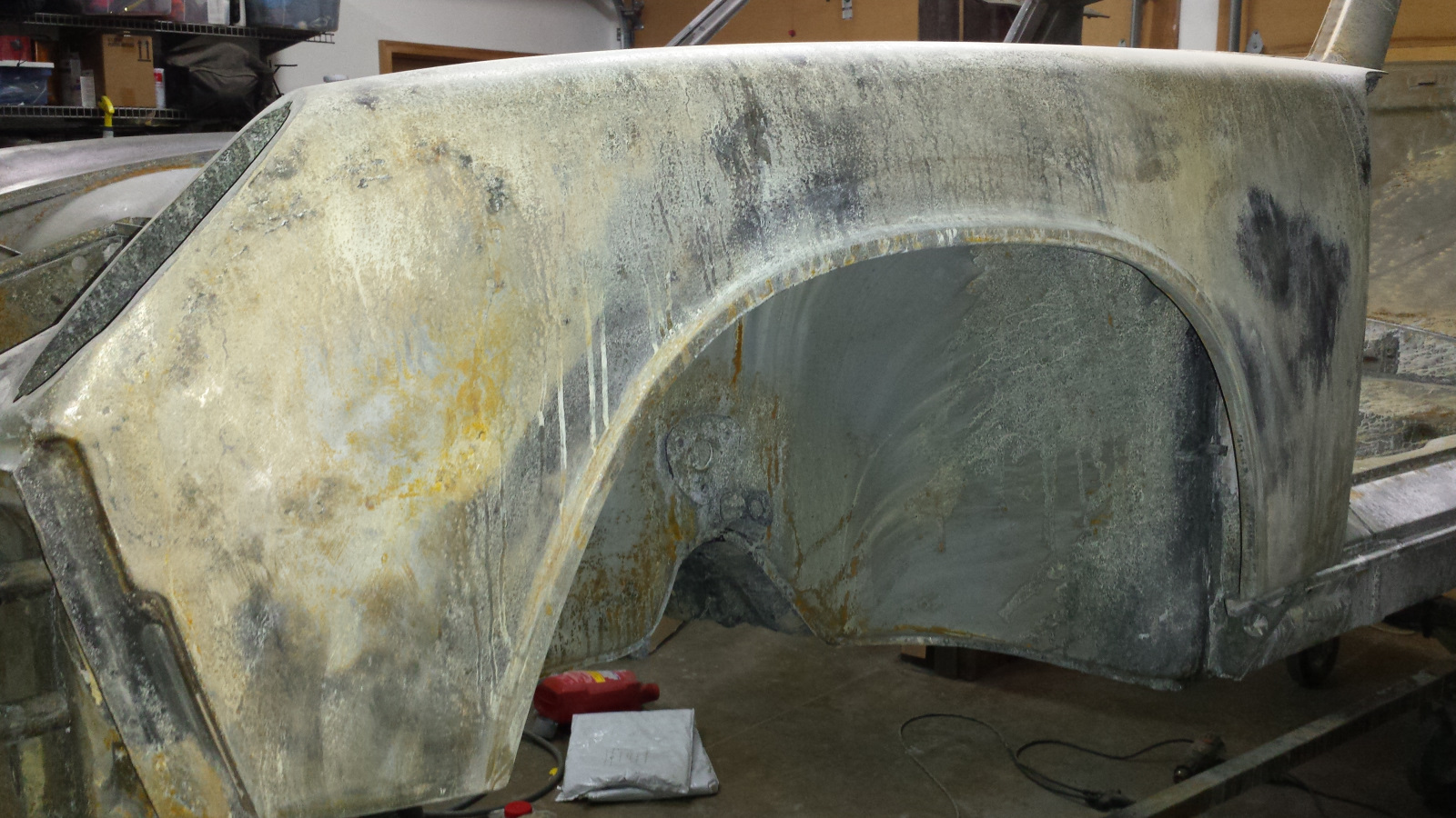

I'm working up quite a sweat today working over the rest of the tub. So those minor rust repairs? Here's a pic of whats left of the original rear deck lid on my car. Most of it is back in the car in various places, and that only counts for the patches in non-structural areas!

Looking great Brent. I read on the label of my metal prep and it stated not to let it dry. I did the same as you in some spots, spray on and come back to it later.
bbrock
post Sep 30 2018, 08:40 PM
Post #552
Posts: 5,269
Joined: 17-February 17
From: Montana
Member No.: 20,845
QUOTE(TravisNeff @ Sep 30 2018, 07:47 PM) *
I've used two brands of this stuff now and each had slight different instructions despite being basically the same chemical. JASCO said if it dried before you neutralized it, to respray with the acid to reactivate before neutralizing. Both said to let it sit overnight to convert rust but this Klean-Strip brand says nothing about reactivating. I do anyway. I'm going to have to retreat the trunk. Not sure what happened but about half of it is mostly flash rust with little to no sign the acid did anything. Don't think I'll be diluting per directions on the next round.

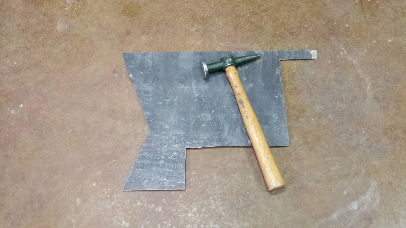

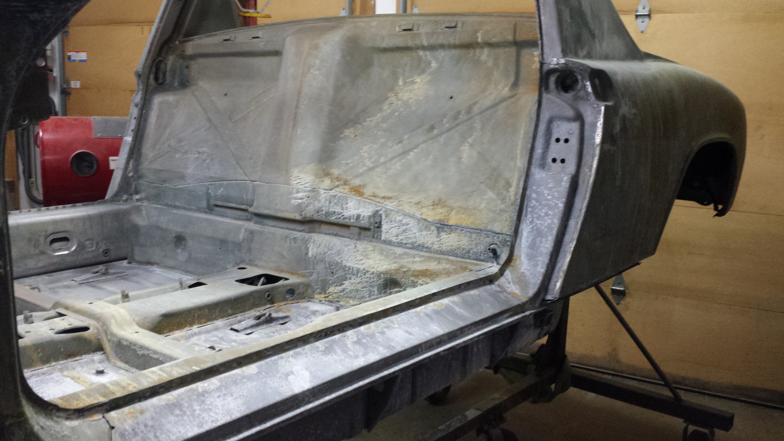

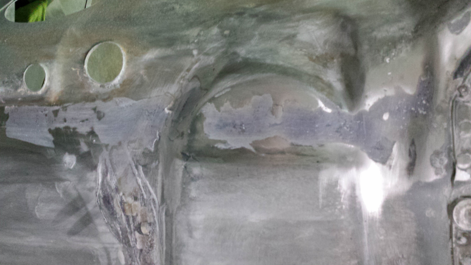

Sheldon Cooper presents: FUN with FILLER

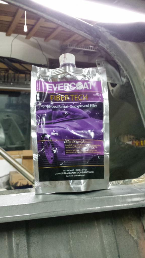

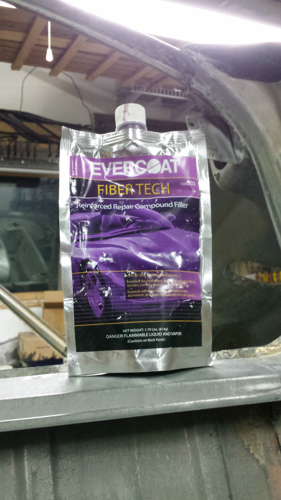

Spent time this week filling my butt welds with the same reinforced filler Ben used. I like it. Applies easy enough and seems really strong.
I'm applying it to butt weld seams and then block sanding it flat with 80 grit. Right now the goal is to get all the seams coated and sanded but I'm not getting carried away with getting the surfaces perfect. If I have filler remaining after going over all the seams, then I'll go back around and fill any low spots and block to perfection. Otherwise, I'll wait until after primer is on and fill with more basic (and less expensive) filler. It's nice to see those welds finally disappearing and I'm happy that it isn't taking very much filler to make that happen. Some welds taking less than others of course, and my latest welds definitely require less filler than the early ones.
On the seams that will be covered with Raptor, I'm mainly concentrating on feathering the edges and sanding them smoother than the under coating texture will be. Doesn't seem to be much point in spending the time to make them perfectly smooth.

Brent, I found that I was better of using a DA with 40 grit for that stuff. It cuts it much faster and blends quicker..
It's a great product for sure.
bbrock
post Oct 6 2018, 08:26 AM
Post #560
Posts: 5,269
From: Montana
Member No.: 20,845
QUOTE(mb911 @ Oct 6 2018, 06:03 AM) *
Thanks Ben. I'll break out the DA when I do the fenders. Most of the areas I'v done so far have been in recesses where a DA won't help. I could have used it on the interior floor but found knocking the filler down with 36 grit on a block when it was a little green and then blocking with 80 grit didn't take too long and kicks up less dust. I've been a little stingy with the filler this round just because I want to make sure I get all my butt welds covered. This has left a few shallw low spots that I'll catch with regular filler on top of the primer if I don't have enough of this stuff to do it all. Looks like I'll have plenty but being cautious.
