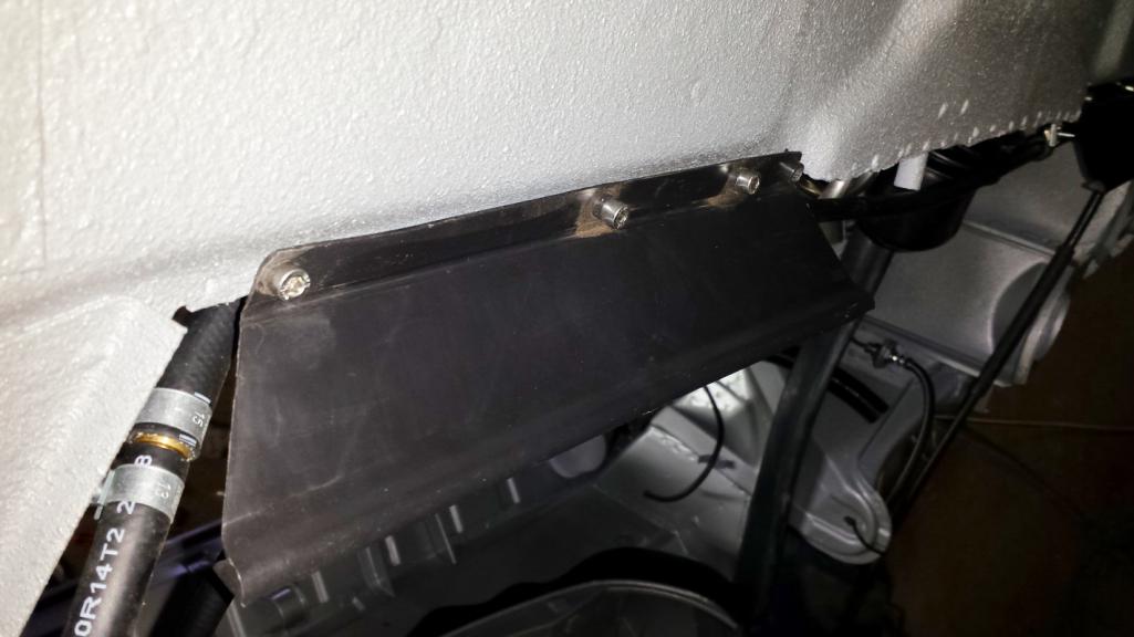

QUOTE(bbrock @ Feb 8 2019, 10:26 AM) *
Then this.
I couldn't resist seeing it in place. It will have to come out to adjust the spring pressure.
Pressure should be set to 525 PSi as per @Eric_Shea

QUOTE(914_7T3 @ Feb 18 2019, 10:56 AM) *
Then this.
http://www.pmbperformance.com/914-brakes/L..._Regulator.html
Do you know how that gets done? I had a separate thread asking about this but no answers other than to send it to Eric. The factory manual has a procedure for setting it with the whole system hooked up, but requires two high pressure gauges. It would be cheaper to send it to Eric than to buy those.

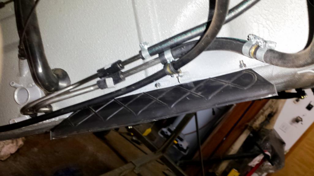

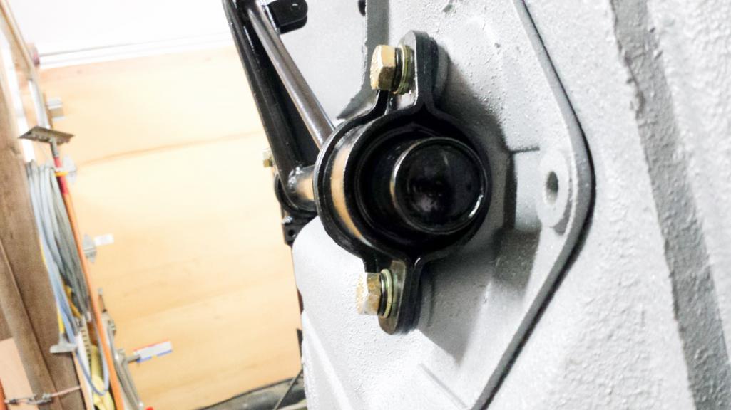

A quick deflection from the main event. Finally got around to installing this dudes with the fancy 914Rubber "vortex generators." The hardware that shipped with this were not self-tapping screws as I believe were original to screw into those plastic nubs. I think Porsche was being too cheap there anyway and suspect that is why so many cars are missing one or both deflectors. Instead, I drilled out the mounting nubs and inserted stainless steel cap screws with SS nylock nuts on the back side. I think this will work much better. If I were OCD... and luckily I am not (IMG:style_emoticons/default/biggrin.gif) , I would cut off the nubs and plate these cap screws with black chromate to hide my fastener indiscretion.

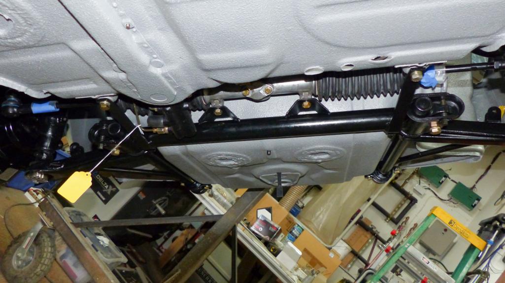

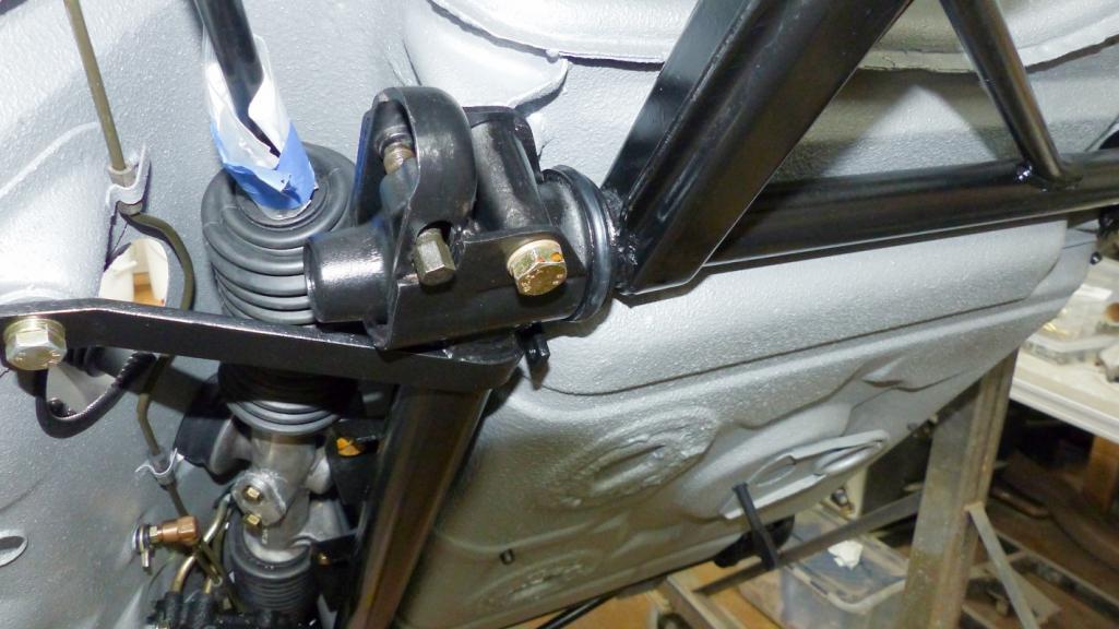

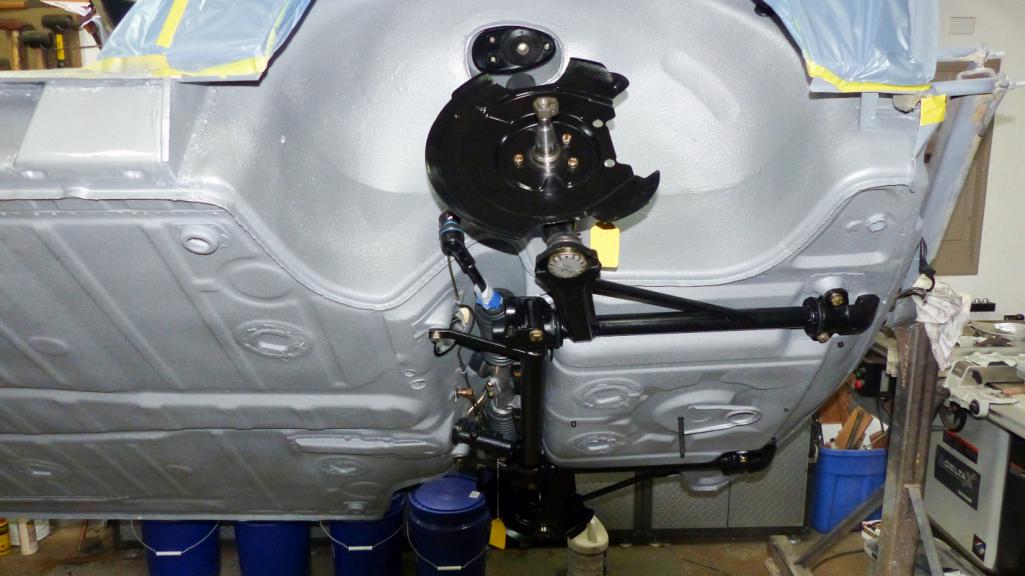

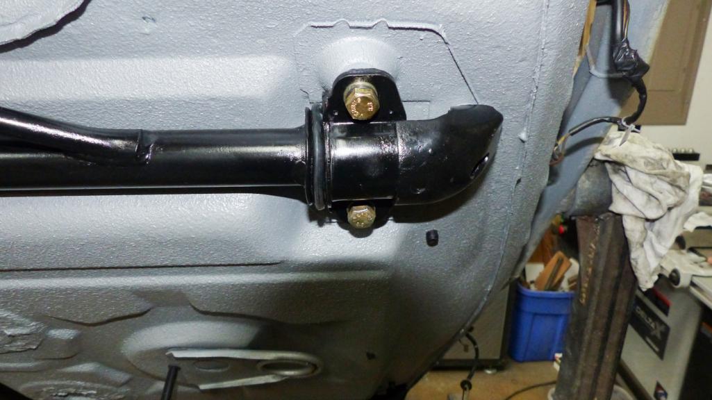

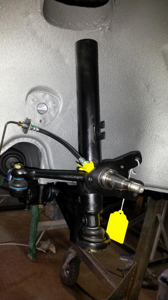

Okay, now for the main event. Saturday I installed a new set of rubber bushings from 914Rubber in the front control arms. I like the look of clean control arms with just a little bushing showing.
You don't get any pics of the install. That job is a bitch and I was plenty busy trying not to screw it up. Thanks to @cuddy_k for his great video! I shared a couple tips I learned on his video thread.
I'll share one more tip here. Don't be an idiot like me and make sure to test install your torsion bar BEFORE tapping these end covers back in place.
I thought I had cleaned out the splines pretty well but NO. I wound up having to knock both end caps out, cleaning the splines with a dental pick and wire brush until the torsion rod could slide all the way through, then reinstalling and repainting the caps. It is surprising what a small amount of rust or debris will keep those rods from sliding in.
The control arms got new ball joints and the strut housings installed. This is all just finger tight so I can install the inserts later. I noticed that an oil stain formed on the floor anyplace I laid one of my original Boge inserts so I have a new set of Bilsteins on order and am waiting for them to arrive. The yellow tag has all the torque values for final install. This shot was taken just before I discovered I had switched the front and rear brake soft lines. If this one looks short, that's because it is.
And here's just a bunch of eye candy of where I am with the front suspension.

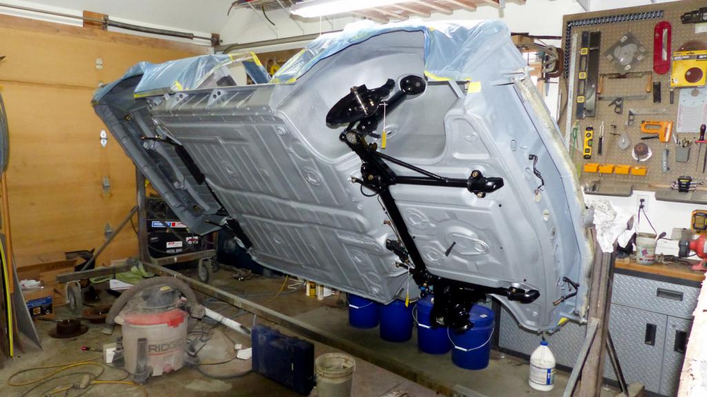

And then that other thing... Yeah, I find myself staring at that rotisserie more and more and pondering the sheer terror of getting that car down. (IMG:style_emoticons/default/blink.gif)

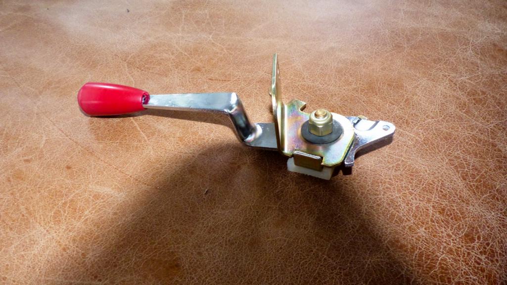

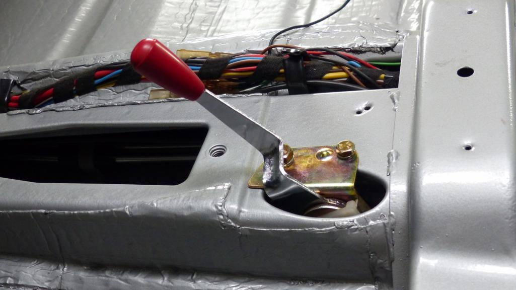

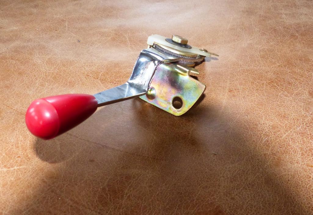

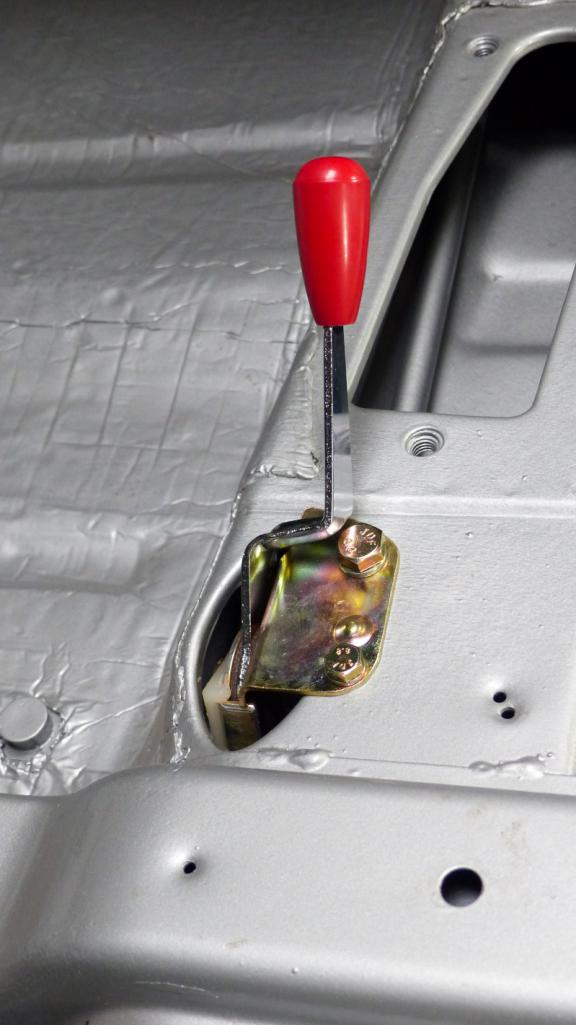

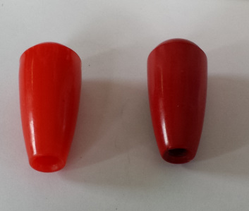

My lunch break task was putting my heater lever back together. I had the lever in the box schedule to go for chrome plating but got inspired by @mepstein and broke out the Mother's instead. It polished up nice so after replating the other parts, I put it together and installed it. I probably should have wiped the greasy finger prints off before photographing though.
It's the little things what makes me happy (IMG:style_emoticons/default/tooth.gif)
BTW, I didn't use the new knob that came with my 914Rubber kit because it looks too bright and looks like the cherry on a sundae. I decided to just polish up my original with Novus plastic polish. I've only polished it by hand at this point. It looks pretty good but should look perfect after I use a buffing wheel on it.
