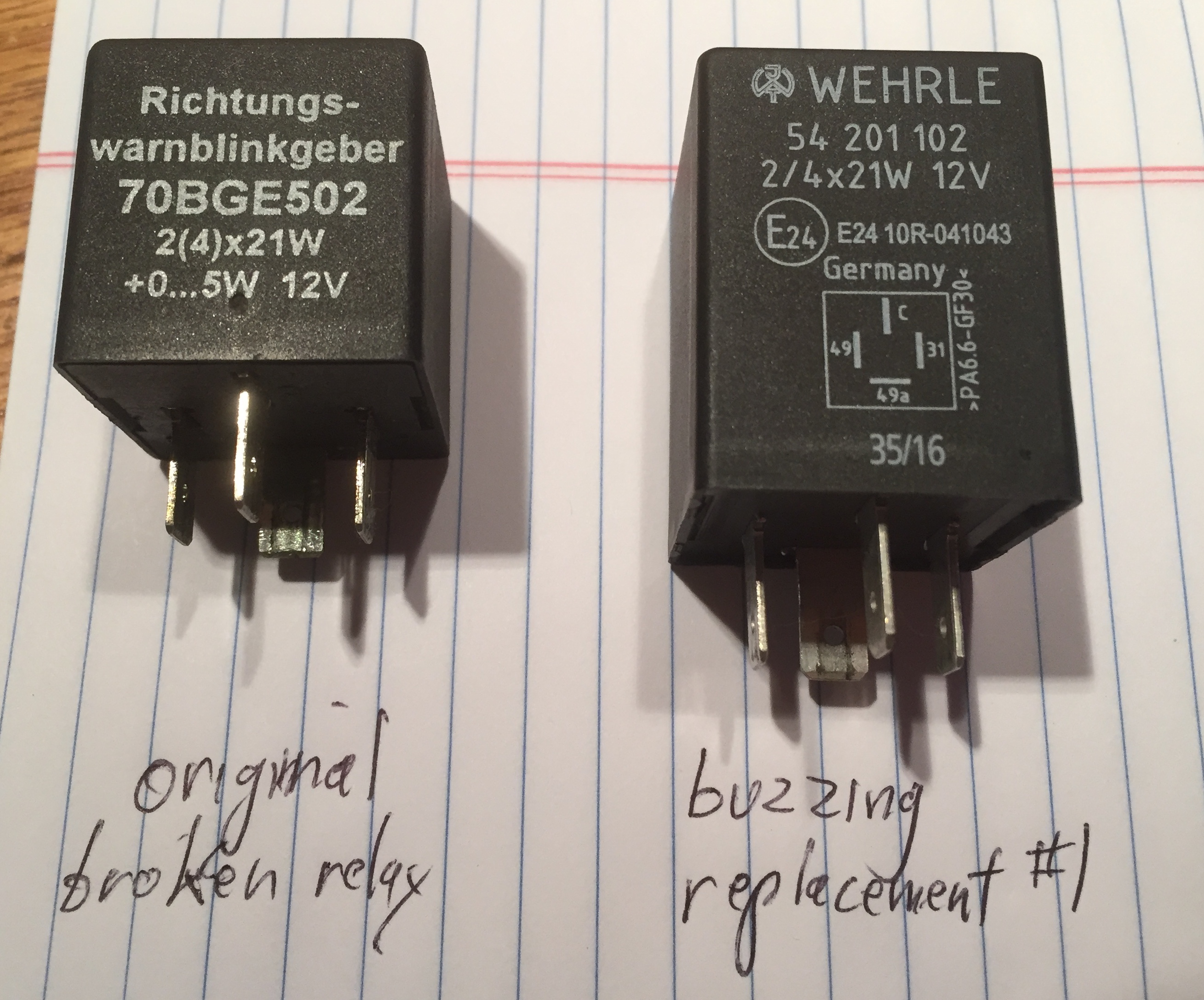

76, 2.0, I know, if you don't get the right turn signal relay, the brake light causes a buzz. The broken relay I removed is square, made by Richtungs. Almost all the replacements I see online are rectangular in shape. The company I just got a rectangular one from was sure it was the correct one, but it buzzes. I know, it's caused by the hand brake light. Nobody seems to be able to tell me what the positively correct relay is and were to get it. Pelican Parts has a square one like mine, marked OESupplier, Part #: 914-618-303-11-INT, but even they could not guarantee me that it would not buzz, or why the other two rectangular relays on their website would or would not buzz in the 914 application. Help!
