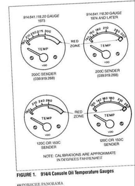

Different senders give different readings. The 200C sender was what came stock. You can calibrate your gauge to a known point on the scale by submersing the sender in boiling water (212 degrees). Gauge and sender (with the taco plate) out of the car, hook up everything to the car battery. Positive (+) to the gauge, ground the gauge at the taco plate to negative (-) and the G terminal to the sender. Touch the red zone with temp. Gauge 914.641.118.20 (1973) and 200C sender is 300 degrees.

See attached.
