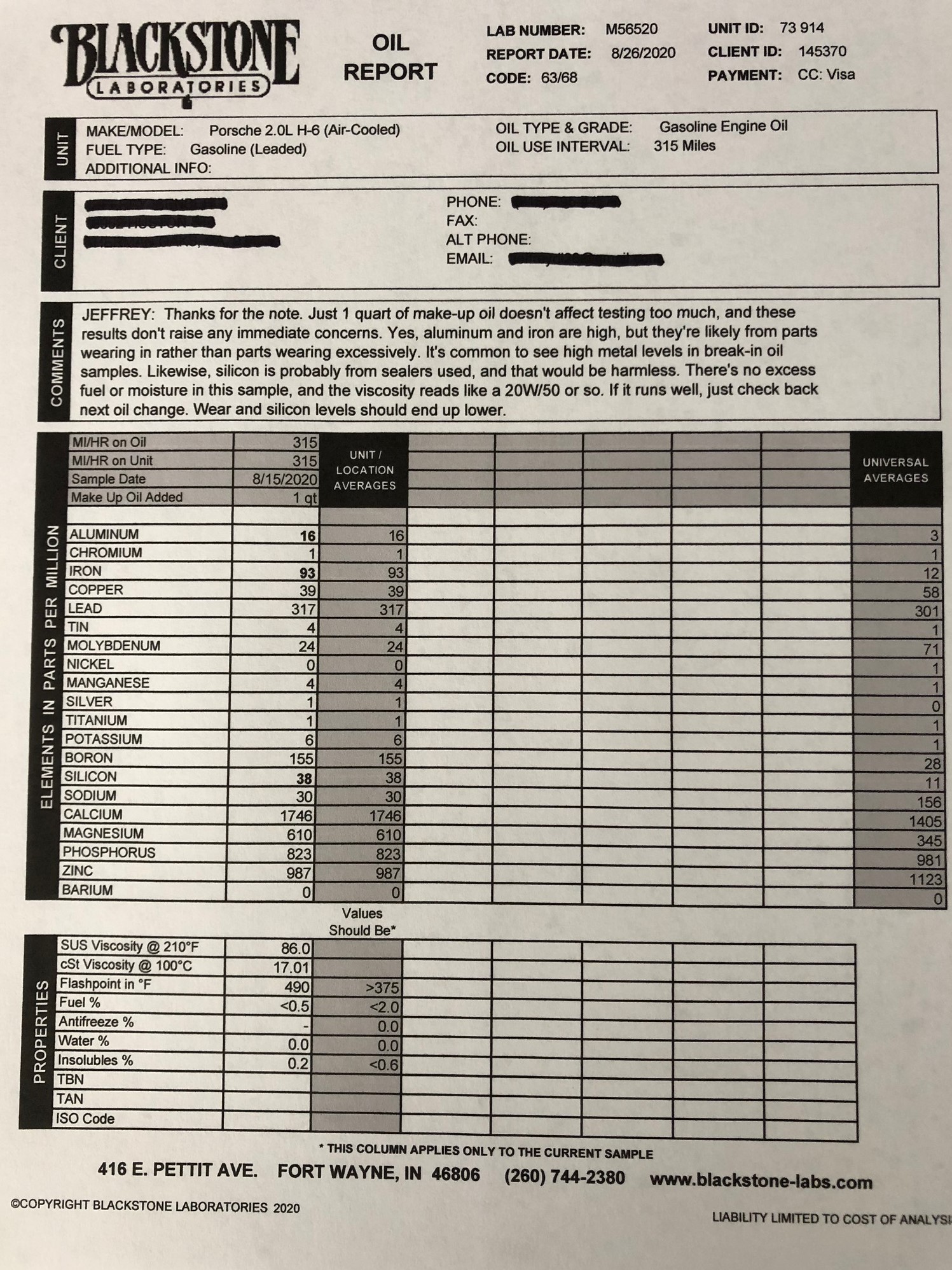

Just got back the oil analysis on the break in oil and wanted to share for those that have not seen the format from Blackstone Labs. Added a quart of 20W50 at 270 miles as the oil filter was not correctly tightened and was leaking.

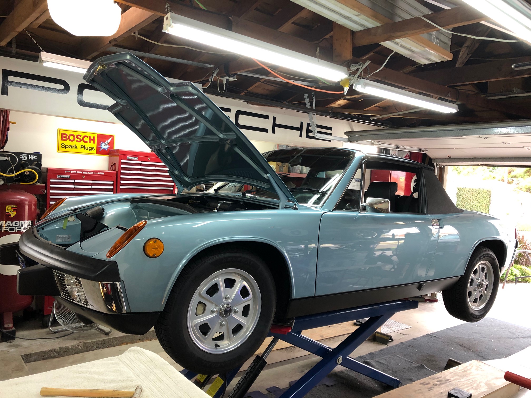

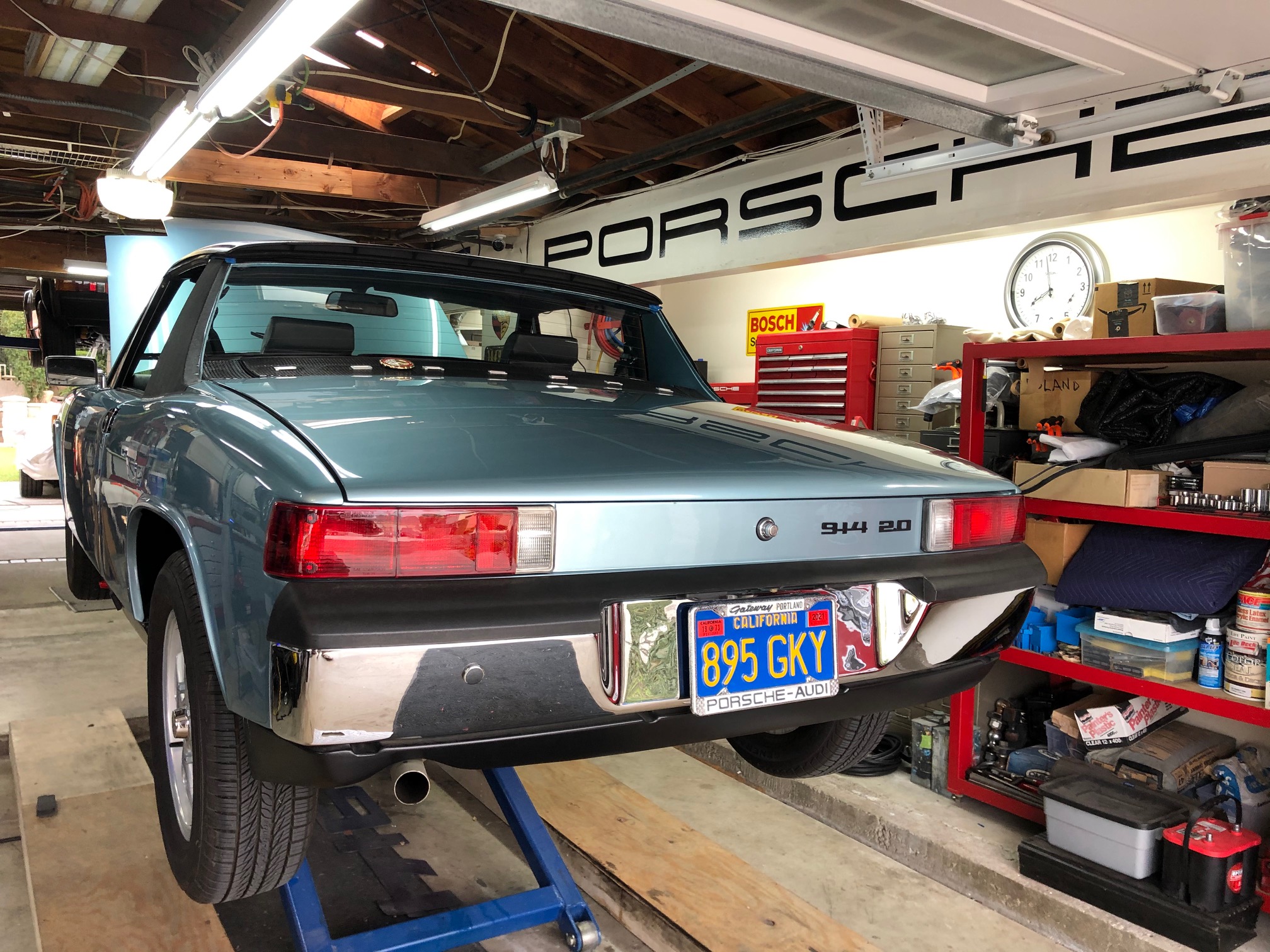

Random Photos from last weekend's brake bleed with @ndfrigi & @ValcoOscar

Finally I was able to test drove this beautiful car! yehey!
Jefferey also replaced his front hood seal.

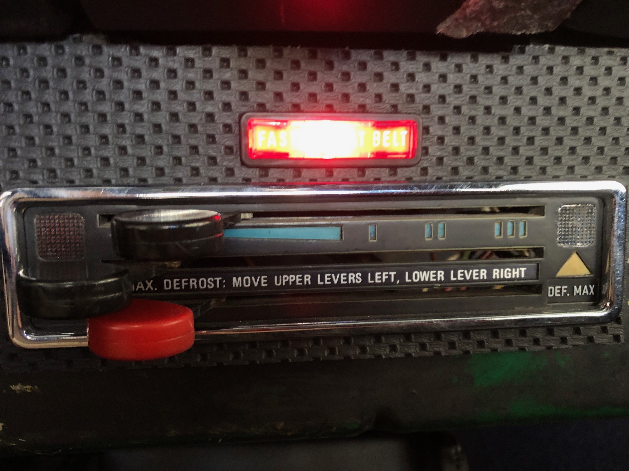

More excited than I should be, but the thing never worked from day one. Just got around to swapping out the housing. Started her up and nothing happened ‘til the E-brake was lowered. (IMG:style_emoticons/default/laugh.gif)

QUOTE(914_7T3 @ Aug 26 2020, 11:25 PM) *
@914_7T3 What kind/brand lift your using? Do you like it? What's the lifting height?

QUOTE(kroelofsen @ Aug 31 2020, 08:36 AM) *
PS Your car looks fantastic
@kroelofsen
It’s a Bend Pak, but I don’t have specs on it as it is @ValcoOscar ‘s. Sadly, there is no budget left for me to Remodel the garage with a good lift solution for a while!

QUOTE(914_7T3 @ Aug 31 2020, 03:04 PM) *
@kroelofsen
______________________________________________
Here you go... @kroelofsen
https://www.youtube.com/watch?v=DaqoJEkJN2Y

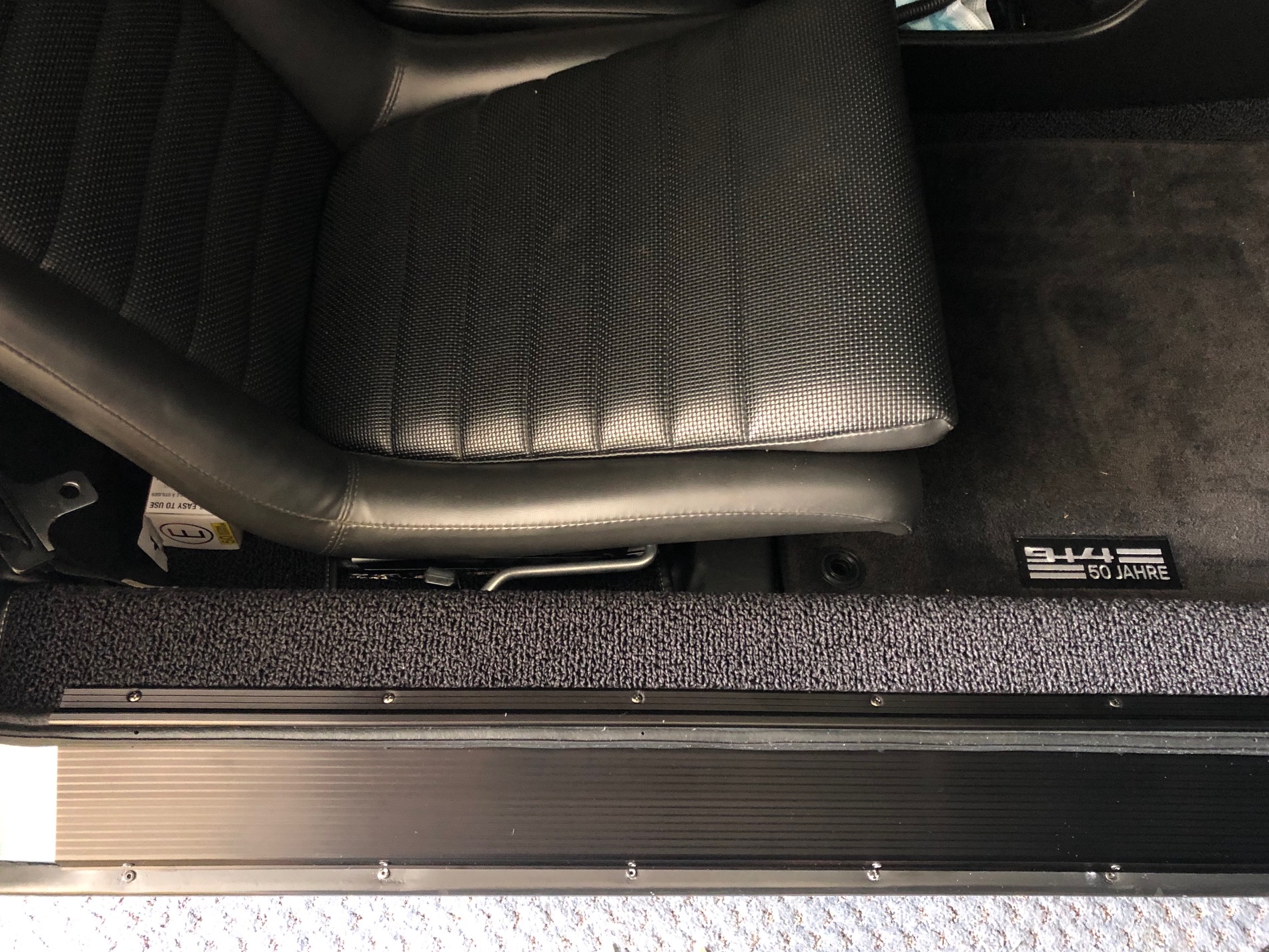

Oscar also had the correct size rivets & rivet gun and so we were finally able to get the threshold plates on correctly.

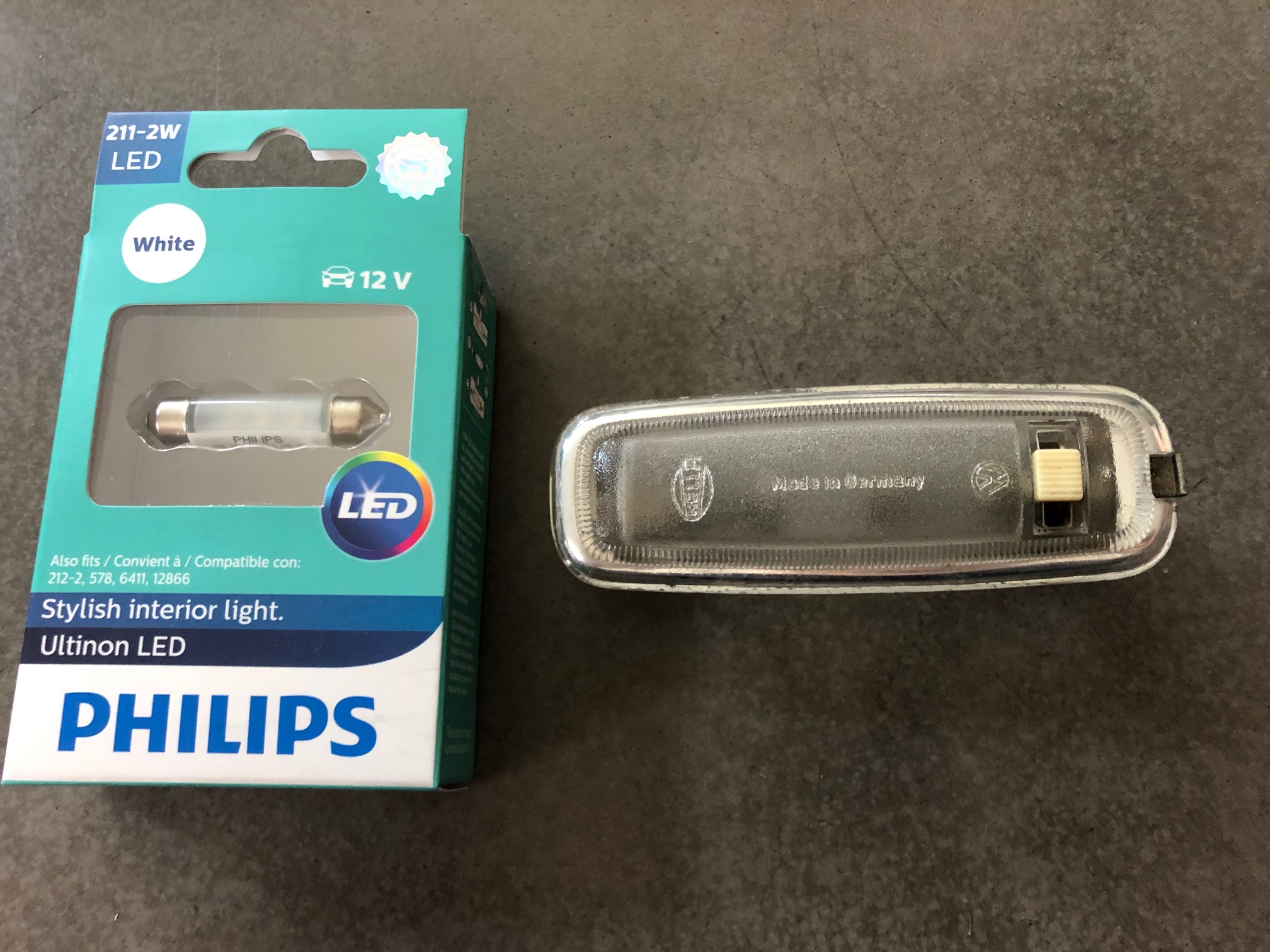

Cleaned up a replacement original dome light. @bdstone914 suggested an LED bulb to prevent heat build up and avoid cracking the lens.
