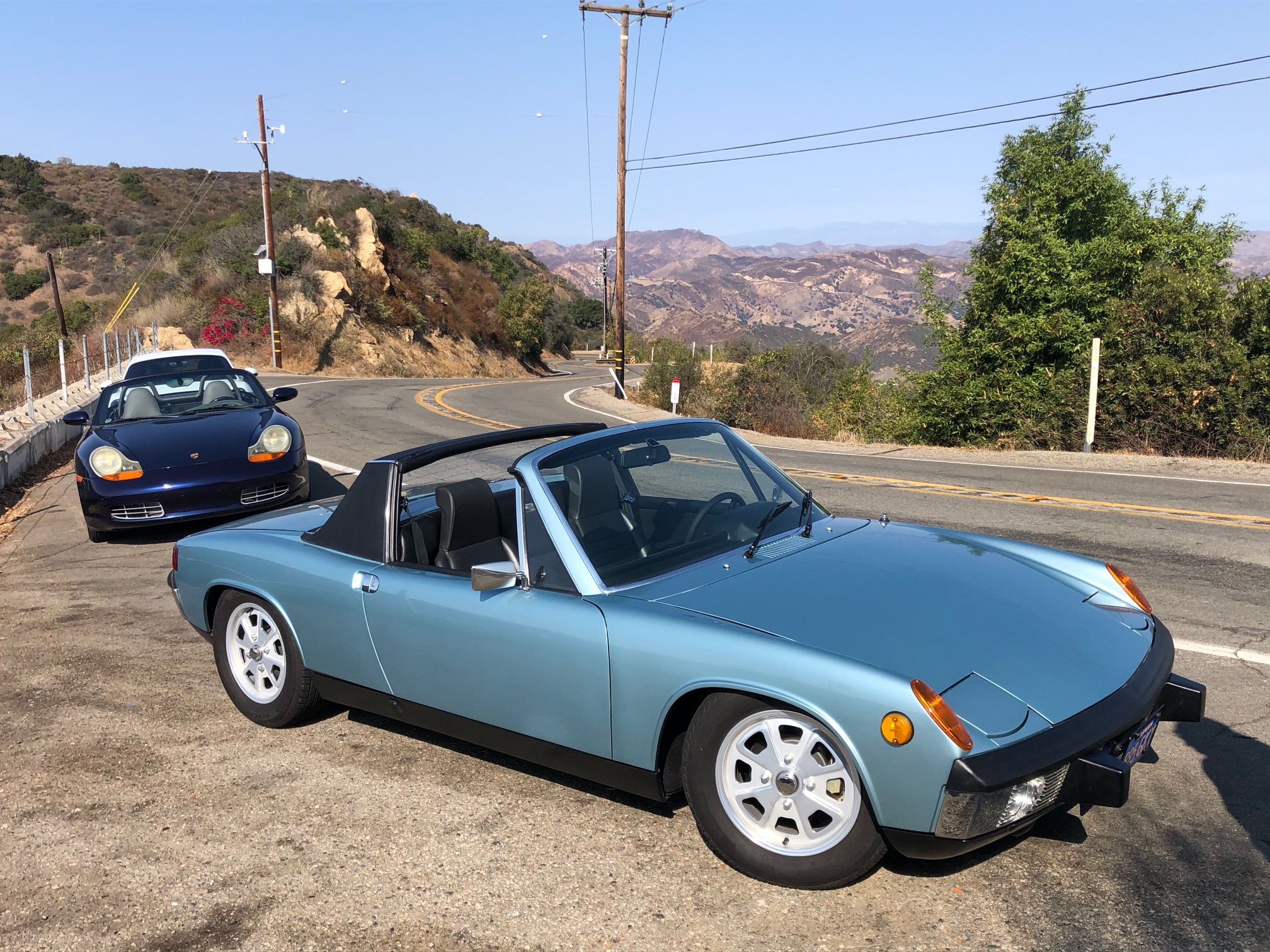

Thanks, drove with my son and @robarabian (mid-engine mafia). It was epic down Tuna Canyon (IMG:style_emoticons/default/driving.gif)

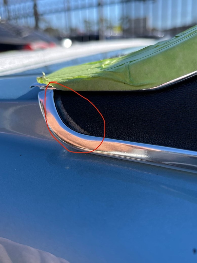

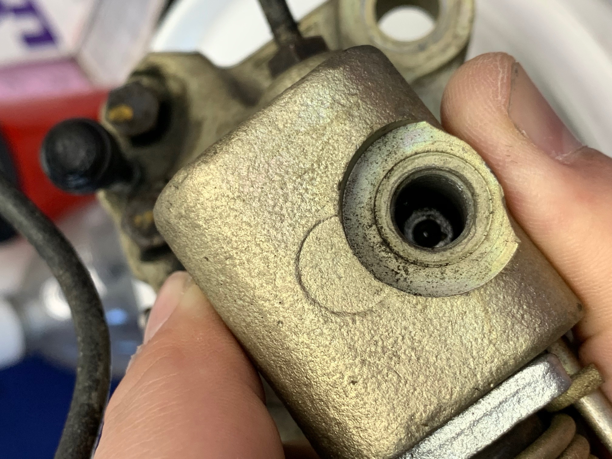

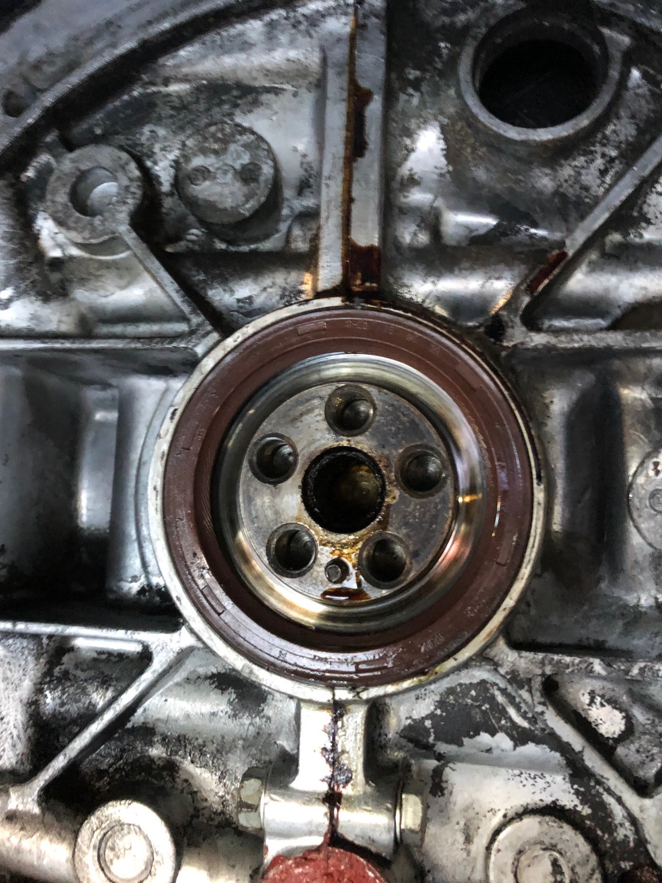

Three things that I learned from the last few items on punch list in no particular order:
1-Settting the venting clearance on the calipers is a thing!
Not sure how, but this got overlooked during the reassembly. After several brake bleeds, I continued to progressively lose pedal firmness. Assumed it was a defective MC and got that swapped out, but made no difference. Turns out the restored calipers had no inner adjustment screws. Thanks to @Eric_Shea for working through this with me and getting them overnighted.
2-Installing the RMS properly is a thing!

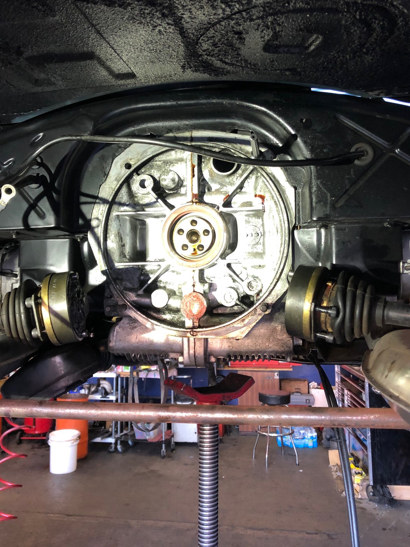

Had a small seep of Black Gold (20 W50 to be exact) coming out of the rear of the case. After the 350 mile round trip to Julian, had three drops hanging on underneath the car and some travel along the trans. At this point, it was necesary to drop the trans and put in a new RMS and now she is dry as a bone.

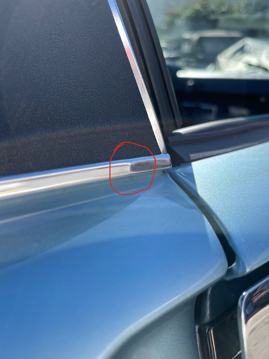

3-The Targa Trim gods hate me! Yes Virginia there is a Santa Claus and Targa Trim Gods too. Was unsuccessful in restoring not one but two horizontal targa trims. One was anodized black by mistake and the other came out looking worse after clear anodize. Sourced a really clean one for number three, but arrived bent in several places. Once I get that straightened out (literally), all of the targa trim can be installed.

Targa trim gods still hate me.....

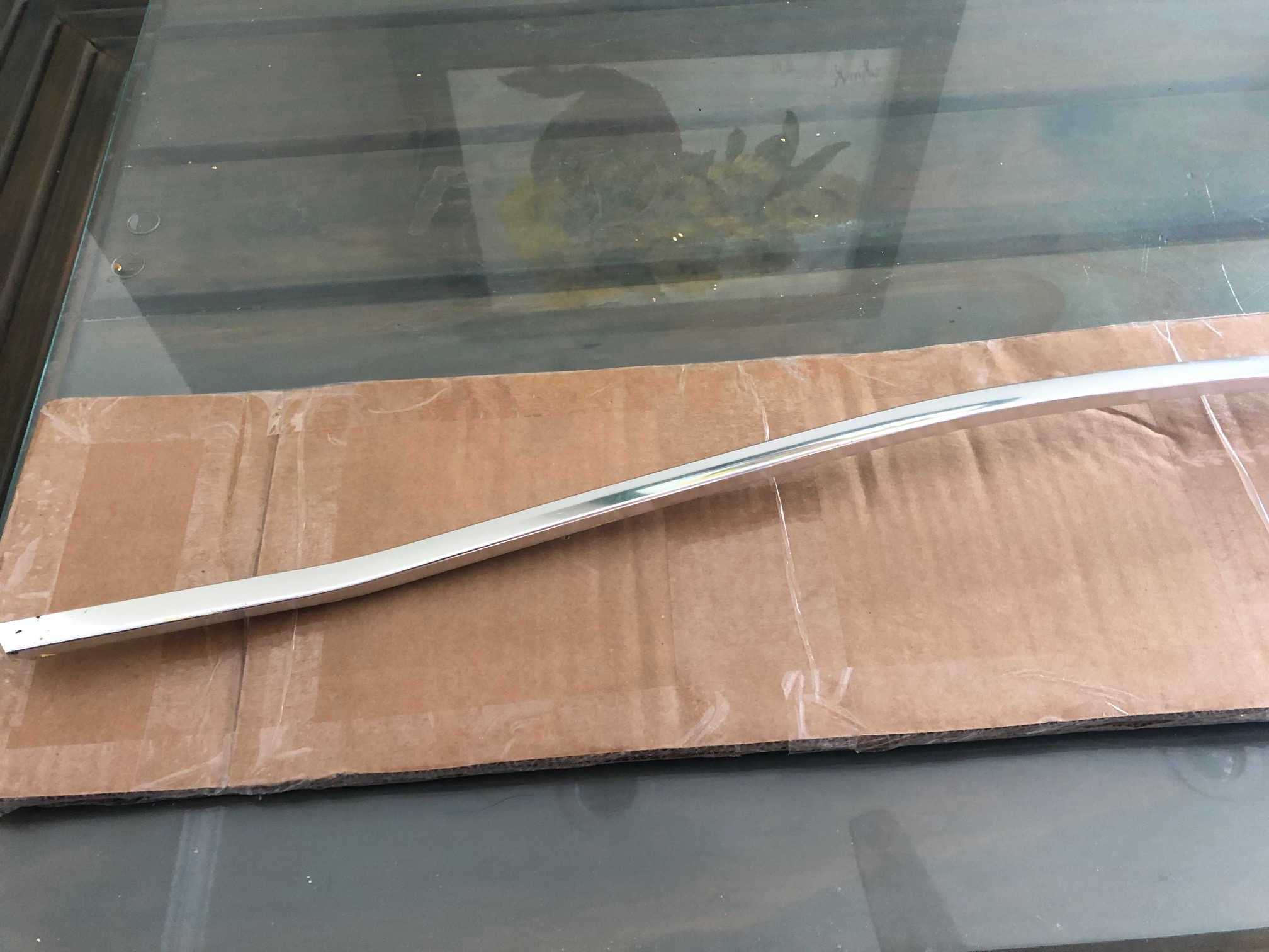

Shout out to @Mikey914 Just talked to Scott at 914 Rubber and he is overnighting me some replacement trim and vinyl. These guys are the best.

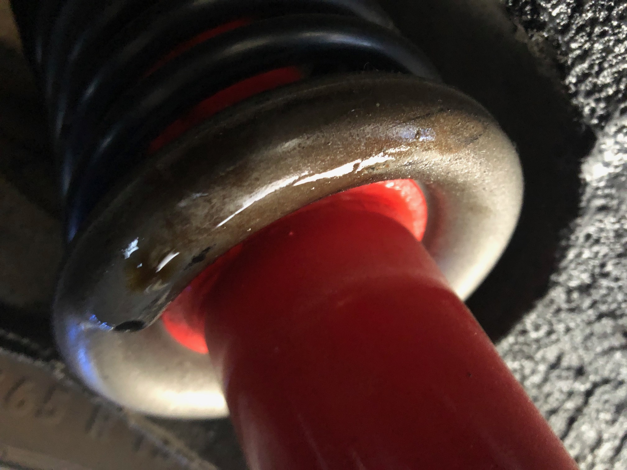

Not only do the Targa Trim gods hate me, but so do the shock absorber gods.
The rebuilt set of Koni reds of unknown origin have leaking seals. This is a blow to my quest for originality, but I'm over it and have a new set of adjustable Koni Sport yellows going in.

QUOTE(ClayPerrine @ Jan 14 2021, 01:52 PM) *
You do know that you can have Koni shocks rebuilt?
Clay
Yes, but the cost is $650 plus return shipping while the car is disabled throughout the process. Was able to get the new set for $400 all in and can do a direct swap.
The plan is to keep the reds and perhaps rebuild at a later date.

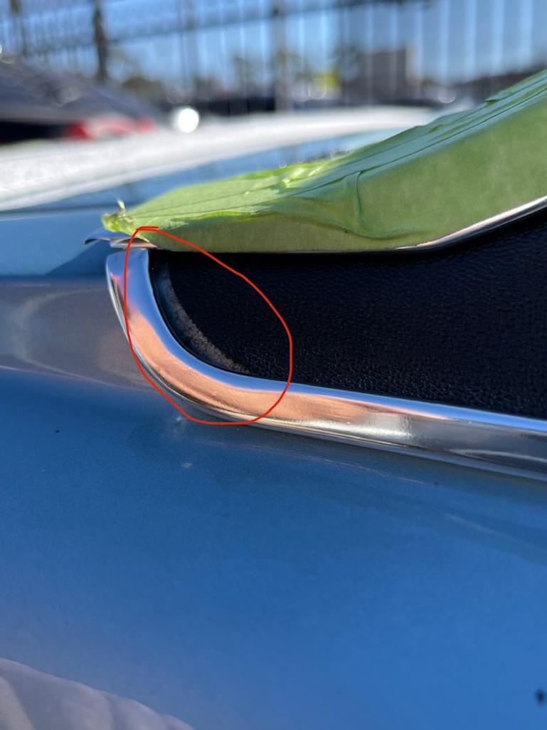

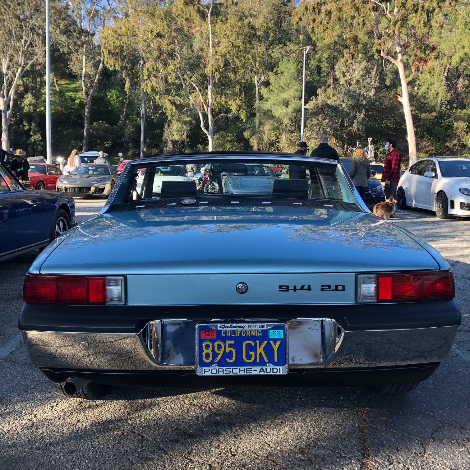

Its been a while since my last post and am updating as the rear shocks have been replaced with Koni adjustable Sport yellows. They are on the medium setting and are super firm which I don’t mind at all. The car feels great.

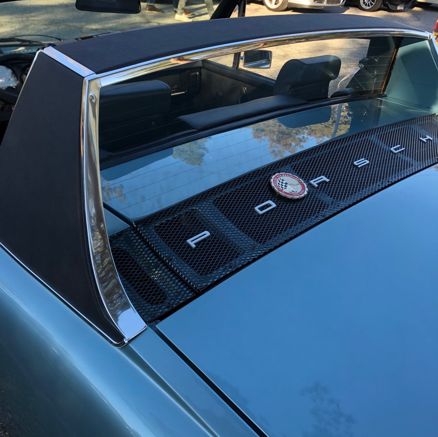

The targa trim from Porsche Classic is finally installed. It looks good enough, but I am not entirely satisfied with the fitment nor the quality. I managed to source some clean original replacements in good condition and would like to get them re-anodized from an automotive restorer and not industrial anodizer. Now that the car is together and dialed in there is no rush on that.

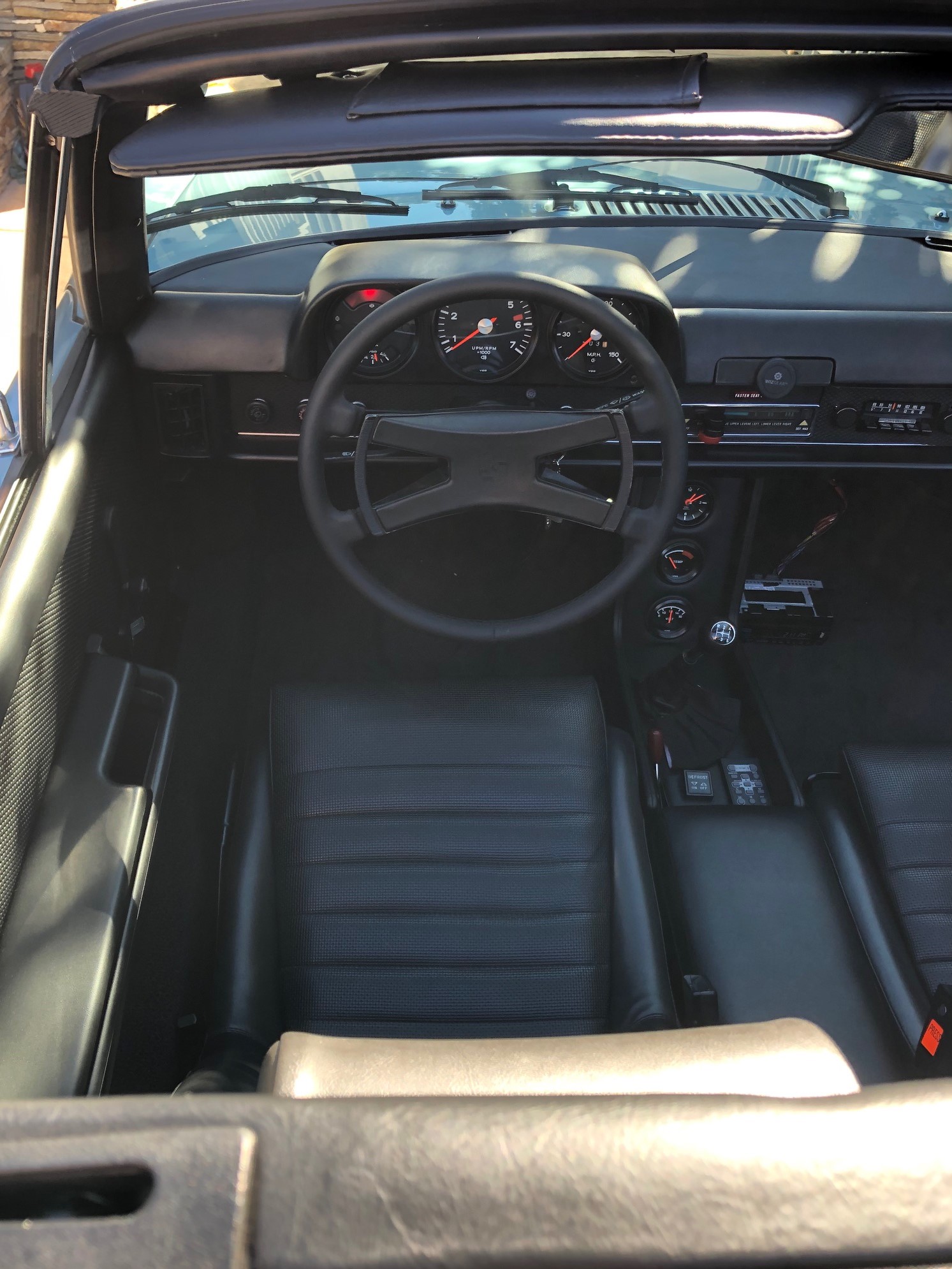

Had the car out today at Cars and Coffee Los Angeles and here are some pics

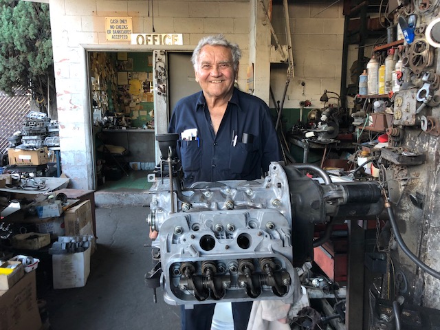

Bela Szekely of Bela’s Foreign Auto Repair in Burbank, CA for the awesome build of my Type IV. An incredible talent and one Helluva great guy!
