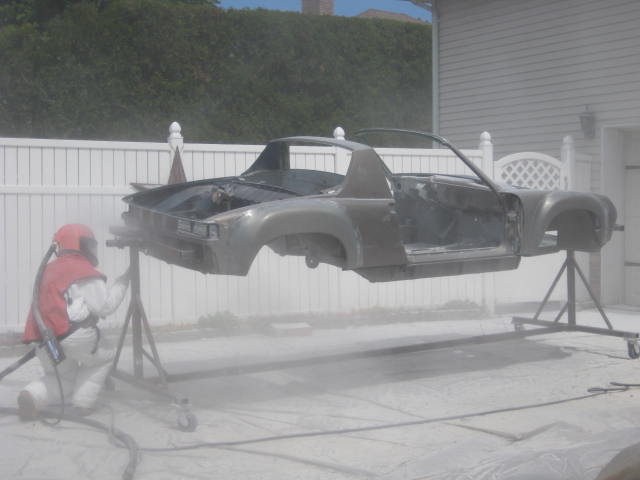

Big day for my GT project.
Getting a combination soda blast and garnet blast on my bare chassis and all the
removable panels.
The baking soda is used to remove paint and is suitable for the body panels.
The garnet is much more course and removes surface rust on the undersides.
I hope I did enough to keep it out of the longs and all the other cavities.
Fingers crossed.

QUOTE(rgalla9146 @ May 15 2017, 01:23 PM) *
removable panels.
Fingers crossed.

Is that you doing the blasting? You might not be able to keep out every bit of dust, but with a bit of effort you can get most of it. The sound of the engine will drown out anything that is rattling around in the longs anyways

QUOTE(PanelBilly @ May 15 2017, 05:59 PM) *
Not me, I took the pic.
Two guys doing one hour stints each. All day.
Soda on the outside bodywork and garnet on the bottom.
The noise was friggin' LOUD
I specified a weekday so most of my neighbors were out.
I would have dipped and E coated but the longs were already reinforced.
I used duct tape, dum dum, butyl and hardware to fill every hole along the longs
the rollbar, the windshield frame and all crossmembers.
I'v only done preliminary blow and vacuum cleaning so far.
The ability to roll the car over easily is key to removal of contamination.
I added a picture of removal of the Karmann tag.
I levered the rivets out from behind.

QUOTE(Luke M @ May 16 2017, 08:16 AM) *
Looking good there Rory.
How did the chassis look after the blasting ?
I know there wasn't too much rust when I had it.
Hey Luke
No big surprises.
I had to replace the drivers door.... it was already painted and buttered up twice.
I decided not to replace the rear of the floor. The issues it had were
cosmetic.....dents and some welding.
I put the jack receivers back on and replaced the pass. rear ear. along with some additional reinforcements on the both rear ears.
The chassis is solid.
Next it goes to get primed and initial body work.

Great job....nice that you are taking proper safety precautions with that hood. Looks like an Apollo 600 set up.
I am lucky enough to have a sandblast room here at work. I can help any SoCal MEMBERS with blast projects, if anyone is interested. I will donate room and media....operator labor is minimal.
