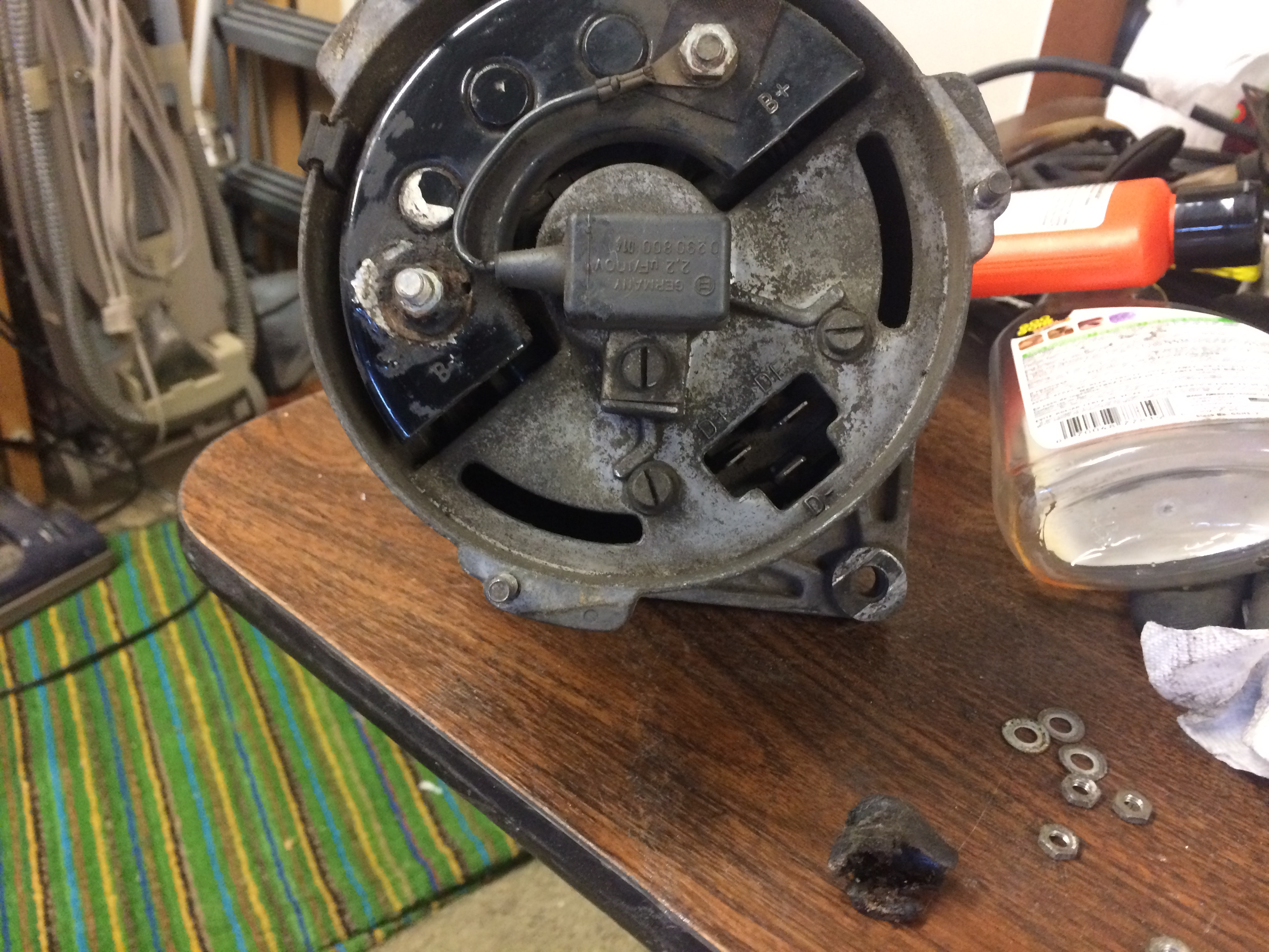

Here's the one I pulled. Looks like the boot melted. Is this normal? Or a sign of failure?

Are there arching marks on the inside face of the rear cover?

QUOTE(Edward Blume @ Jun 22 2017, 06:18 PM) *
A melted boot, thus heat, may be a sign of increased resistance from a bad connection. It's possible the large wire connection there was rusty or not very good. I'd clean all that up, ensure a nice clean connection, ensure a good solid wire ring end, use some dieletric grease and see how well it works.
