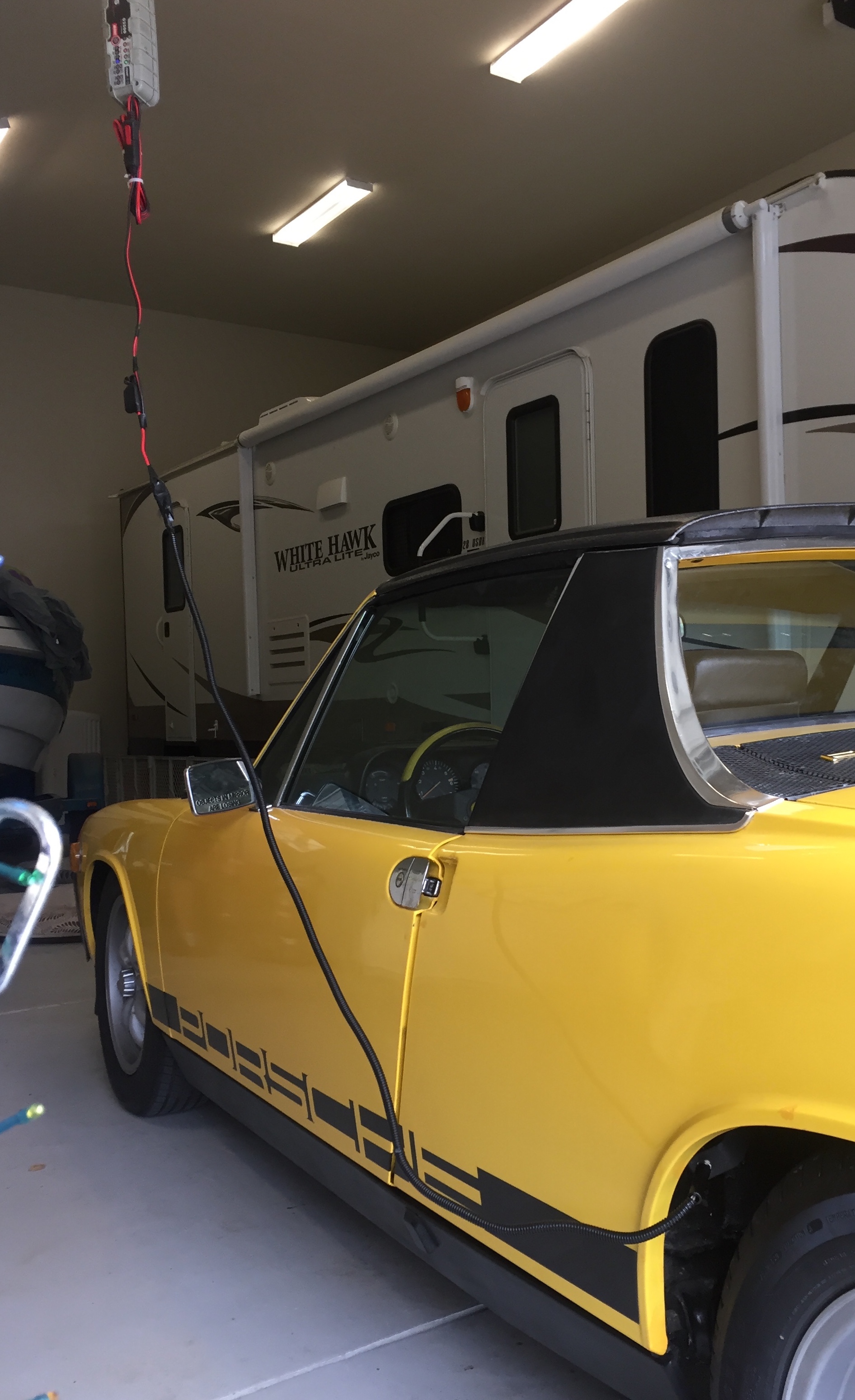

I have had thisOptima Red Top for a long time. I always put it on a trickle charge when at home using a jack port I installed under the rear fender.

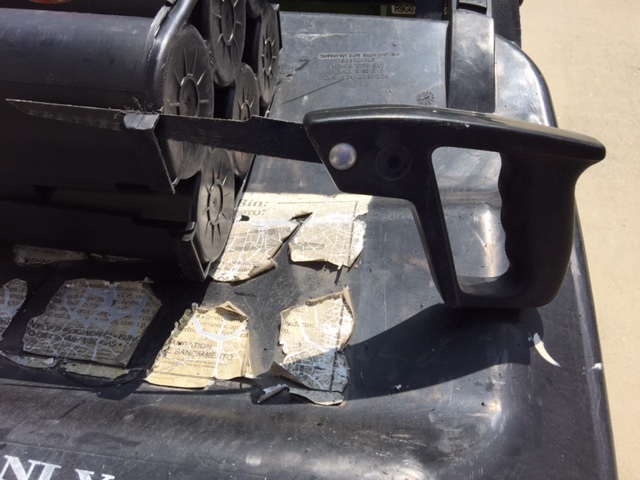

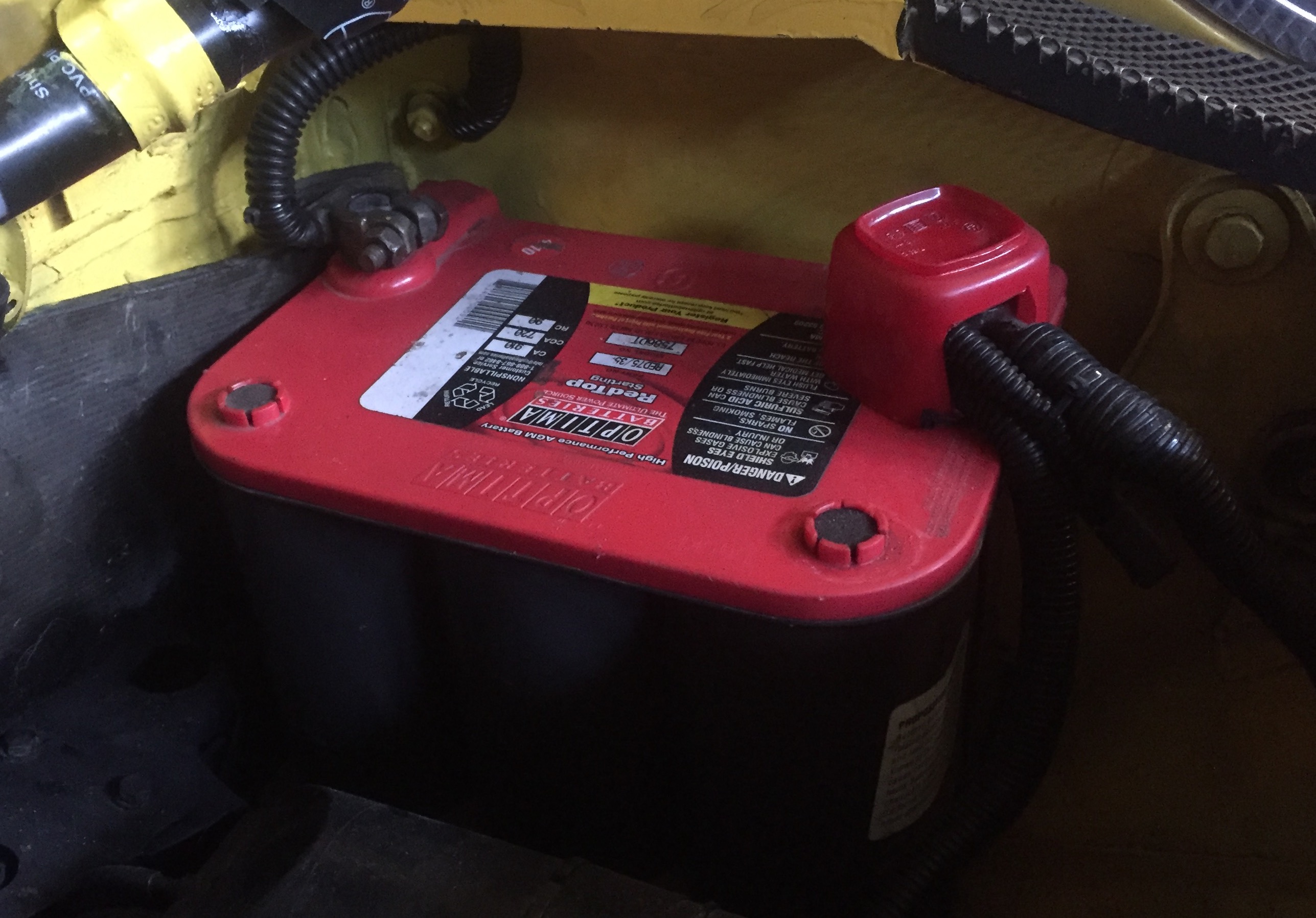

The Optima battery needs to be cut just a little. The newest ones are a little too long. I did this last month. I used a keyhole saw and it made fast work of it. If you do not do this it sticks out of the tray, as you would have to put it in an angle to get it to fit.
Bob B

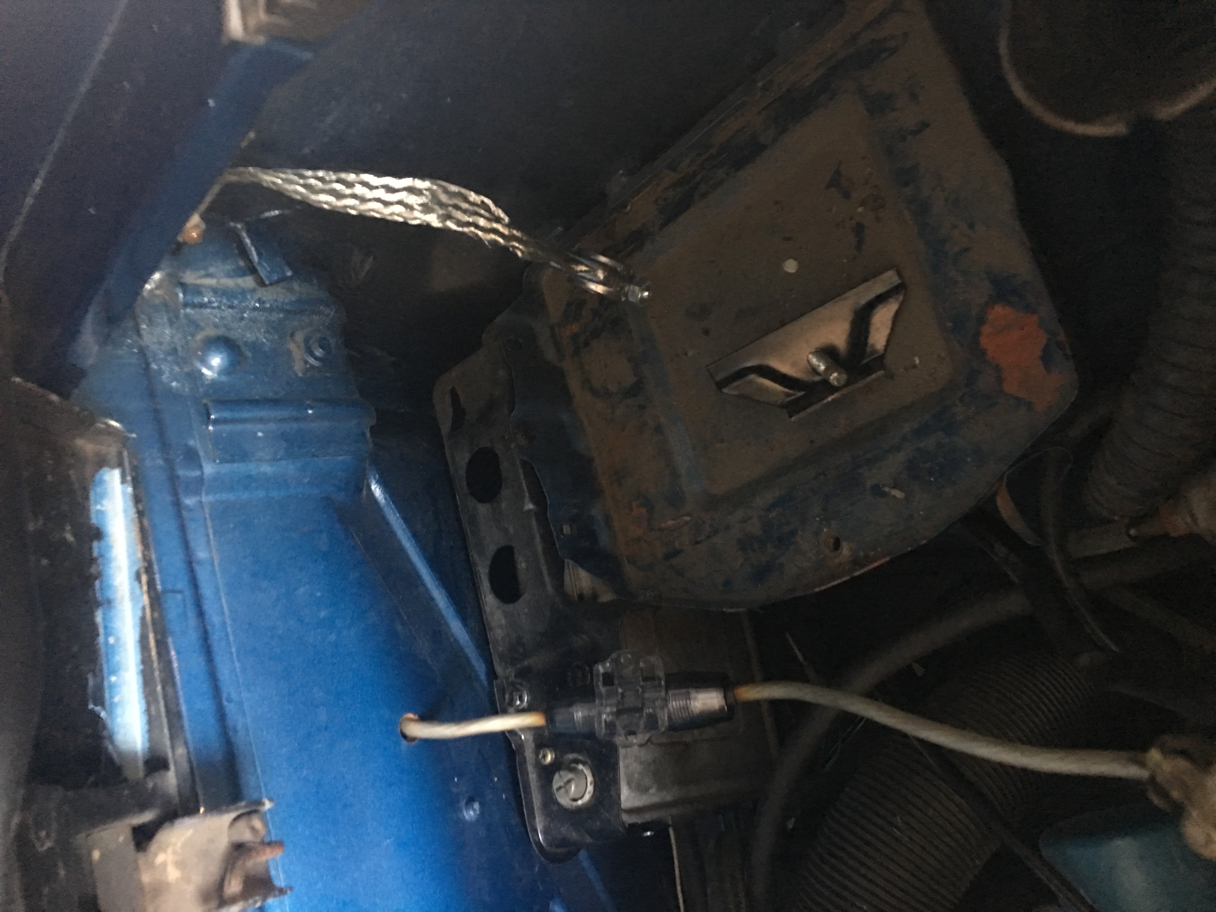

Thanks for the help everyone, but stupid question coming up.... This ground attaches to the negative terminal on the battery correct? im good at driving my 914 but not the most tech savvy and Ann still learning (IMG:style_emoticons/default/driving.gif)
iankarr
post May 22 2017, 10:27 PM
Posts: 2,613
Joined: 22-May 15
From: Heber City, UT
Member No.: 18,749
Yep. Ground = negative -. That webbed metal thing!
