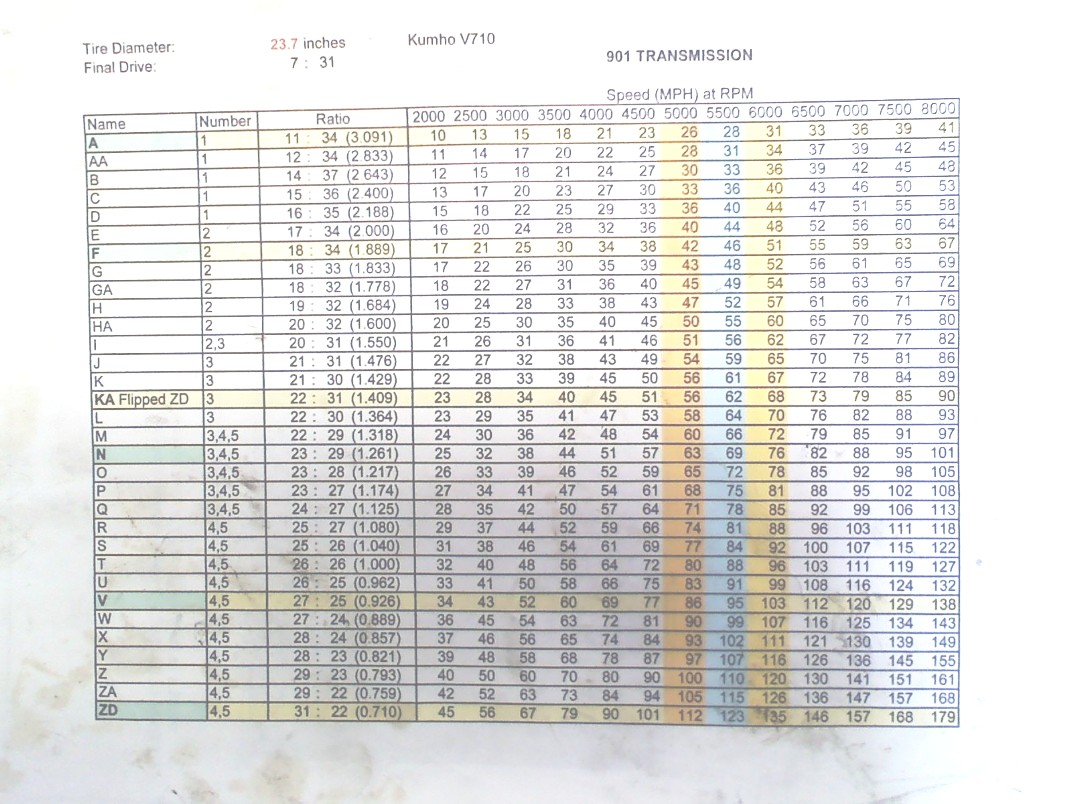

AFAIK the 901 gear box only supports a 7:31 ring and pinion. 2nd gear is fixed to the mainshaft, unless you swap it out for a 904 mainshaft, which is overly priced on ebay all the time. With the 904 mainshaft you could change all the gears to get where you want to be. There are tons of gear charts out there. If your worried about breaking first, I have seen some rare 911 4 speeds, that only use 2nd -5, but the gears are more optimized for a four speed. The v8 and 3.6 guys just start out in 2nd and run a flipped H for 5th.
When it comes to the overpriced and harder to shift 915 gear box, from 72-73? It has a 7:31 ring and pinion. From 74-86 it has a 8:31 ring and pinion. I'm running an 86 915 gear box with my 3.2. I only changed 5th to the highest 29:21 for over drive on the freeway.
With a 29:21 5th. I can do 80 mph at 3k RPM's.
Here is a link to a 901 gear calculator. If there is a virus in it and it blows up your computer or innocent animals suffer, you've been warned.
https://cisco.box.com/s/9iw994c3qanzdmij21evrr1bghd9uuhd

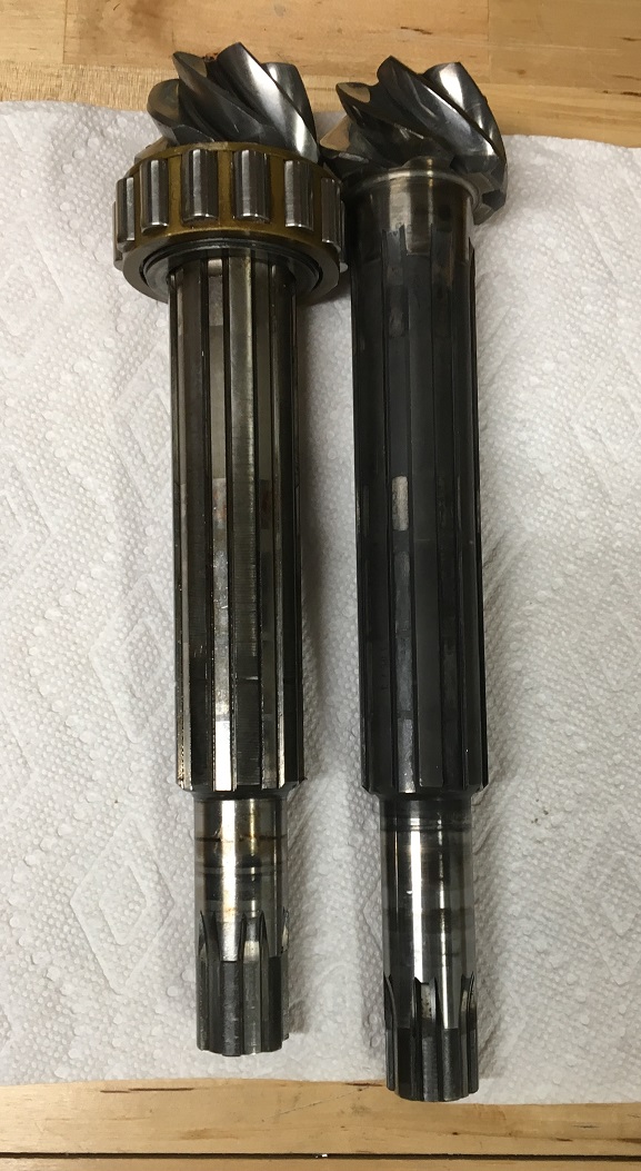

What about the 7:27 R&P from the Sportomatic?
I believe there are the early and late Sporto. The early shaft is too short and the late is a little too long. Once cut, I think it might work. (IMG:style_emoticons/default/confused24.gif)
Here is a standard 914-901 pinion shaft (left) next to a late Sporto pinion shaft (right). I obviously have the matching ring.
Looking further into this is one of the many 914 projects I have lined up (I don't know when though... (IMG:style_emoticons/default/rolleyes.gif) )

The goal with a bigger engine (more HP) is lower RPM's for the same MPH.
Example a 29:21 5th gear in a 7:31 Ring and Pinion 915 gear box is 70mph at 3k RPM's. The same 29:21 5th gear in a 8:31 Ring and Pinion 915 gear box is 80mph at 3k RPM's.
If we could increase the ring and pinion from 7:31 to 8:31 in a 914 gear box, we could lower the RPM's in each gear and make all 5 gears taller.
A 3.0 six with webers produces enough HP and Torque to make 1st gear pretty much worthless. It winds out way to quick.
Starting out in second, makes for a tall 1st gear.
Play with the gear calculator link. Change the ring and pinion from 7:31 to 8:31 and watch 5th gear increase by 10mph in 5th at 3k rpms.

Yep, exactly what I was trying to express while replying to the OP. He was asking about a taller ring and pinion option.
The Sporto ring and pinion that I'm hoping to fit into a 901-914 box is 7:27 (0.259) vs 7:31 stock (0.225) (IMG:style_emoticons/default/stirthepot.gif). I have heard it has been done before (IMG:style_emoticons/default/confused24.gif)
Your 8:31 option on the 915 happens to be 0.258, pretty dam close to the Sporto 0.259!
This could render both first and second on the 901-914 box better suited for torquey engines, the rest of the gears are open as usual.
Other option, redo the whole 901 box box with a 904 shaft, as previously mentioned, and select 1-5.
