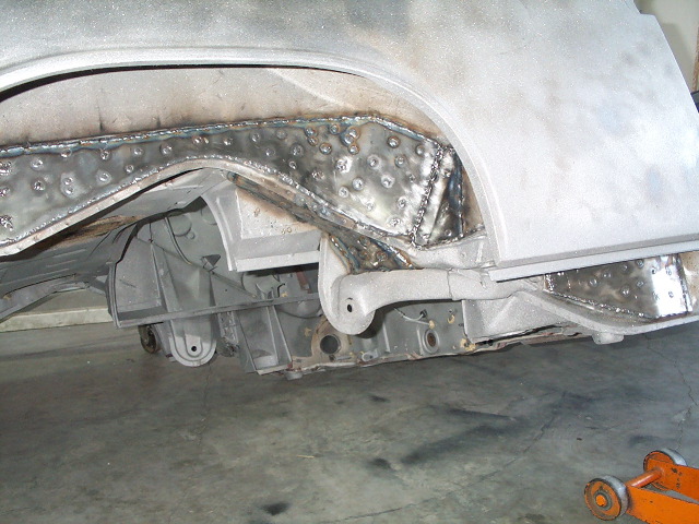

Welded in the passenger side of the stiffening kit today. The MIG is getting a real work out:

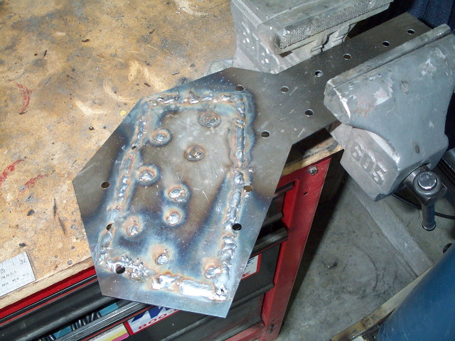

And Liz's first beads. We'll have her welding on the car soon:

Joe, looking good as usual. Are you using all parts from the stiffening kit? When you get a chance, can you take some underside shots of that lower piece?
Liz, you are going to be a better welder than most of us here shortly

QUOTE (Travis Neff @ Jun 22 2005, 08:29 PM)
No, there are two pieces that will only go in an original six due to the differences in motor mount locations.
I cut down the piece on the bottom, so there's not much more than you can see.
