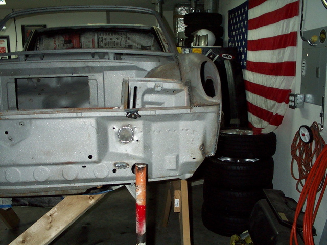

Dzus receptacles (sound dirty, doesn't it) for the FG bumpers:
Is this just for easy install or for easy removal or both
Series9
post Oct 20 2005, 04:07 PM
Post #403
Lesbians taste like chicken.
Posts: 5,446
Joined: 22-August 04
From: DeLand, FL
Member No.: 2,602
QUOTE (736conver @ Oct 20 2005, 10:22 AM)
By far the easiest way to mount FG bumpers.
I wish I had done it this way on the RS, but it didn't occur to me until later.

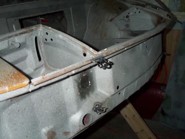

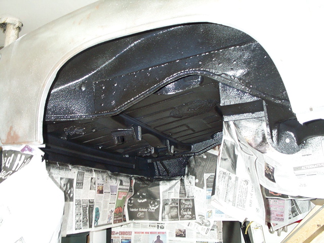

More undercoating:
Series9
post Oct 20 2005, 04:08 PM
Post #404
Posts: 5,446
From: DeLand, FL
Member No.: 2,602

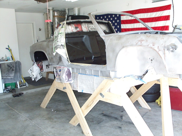

Still drying:

The undercoating was pretty much determined by the sandblasting. This was the best alternative to about a 100 hours of labor to smooth things out enough to paint in the normal fashion.
We decided to leave the entire underside and fender wells in raw undercoat. It'll save paint and time and have the added benefit of being very easy to touch up/maintain.
We're going through the SKS (it's the shiznit) like crazy, though. $25 per bottle x 12 (estimate when finished). That's more than the paint!

Are you going to leave the interior the undercoating finish? or are you planning to paint over it with the finish color? Is the whole interior finished this way?
It sure looks great (IMG:http://www.914world.com/bbs2/html/emoticons/smilie_pokal.gif)
Series9
post Oct 20 2005, 05:07 PM
Post #409
Posts: 5,446
From: DeLand, FL
Member No.: 2,602
QUOTE (Lou W @ Oct 20 2005, 03:59 PM)
Everything but the actual exterior will be shot in SKS. The front and rear trunks, the fuel compartment, the ends (under bumpers) and the upper portion of the engine bay will have color over the SKS.
There will be a semi-traditional interior over the SKS in the cockpit.
SKS is a super high quality Wurth product that's worth every penny. It hurts to see $25 leave the gun in about 8 minutes, but that's how it goes. Pay for quality, get quality.

did you spray that Wurth over bare metal?
any prime or base?
whats the deal with it?
looks nice. I am trying to decide what to use under mine right now.
thread is great by the way.
Series9
post Oct 21 2005, 10:54 AM
Post #413
Posts: 5,446
From: DeLand, FL
Member No.: 2,602
QUOTE (brer @ Oct 21 2005, 08:28 AM)
any prime or base?
It goes over anything. In this case, bare metal.

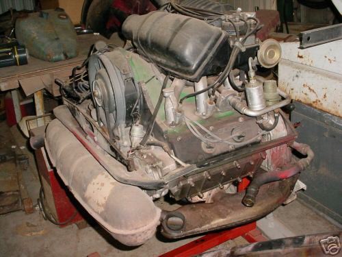

It's official. The TurtleGirl project will have a 2.7:

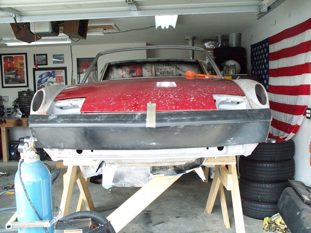

Fitting the fender back on the car:
Series9
post Oct 21 2005, 07:03 PM
Post #417
Posts: 5,446
From: DeLand, FL
Member No.: 2,602
next:
Series9
post Oct 21 2005, 07:04 PM
Post #418
Posts: 5,446
From: DeLand, FL
Member No.: 2,602

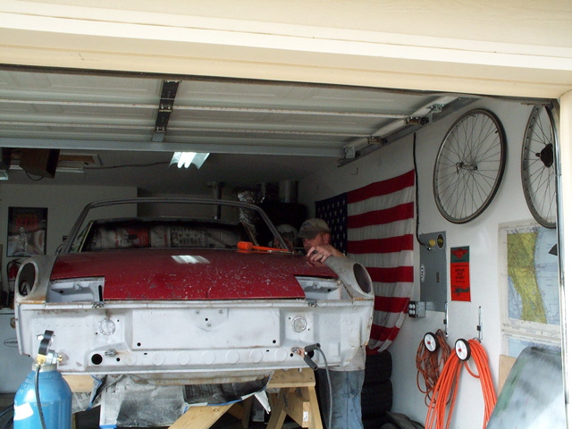

All welded on. The car is one piece again:

OK, 10 comments about the undercoat and none about the engine.... (IMG:http://www.914world.com/bbs2/html/emoticons/huh.gif)
fuch toy
post Oct 21 2005, 08:50 PM
Post #420
Unregistered
Post nekkid ladies wrapped around the motor.
