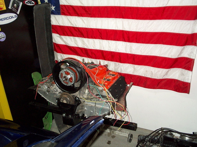

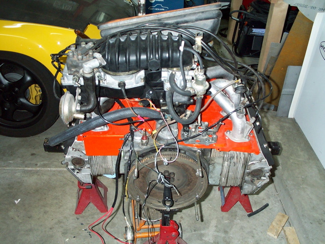

Rough engine wiring has begun.
Today we adjusted the valves, installed the alternator and I showed Liz the procedure for setting cam timing. She was a little wide-eyed, but understands the basic idea.

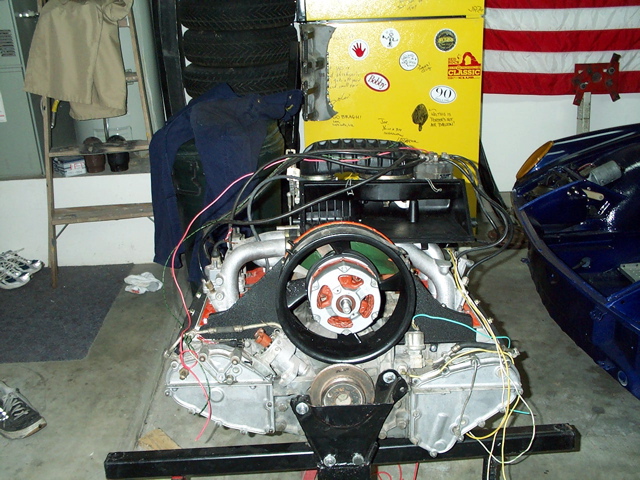

CIS is on board. I still have to finish the wiring.
I plan to install the engine/tranny this week:

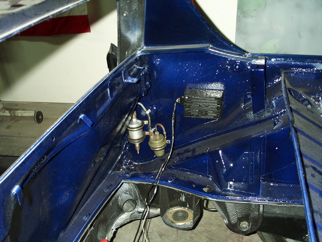

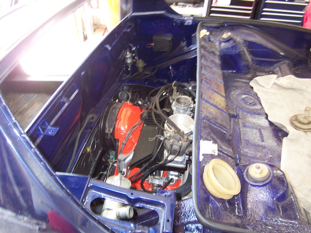

Here's a short update. We should get a bunch finished tomorrow.
Here are the filter, accumulator and CD box mounted in the engine bay.
And the engine wiring, vacuum hosing and fuel plumbing will be finished tomorrow.

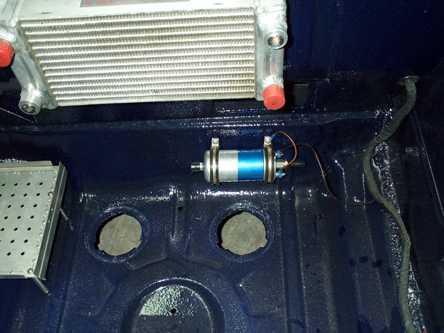

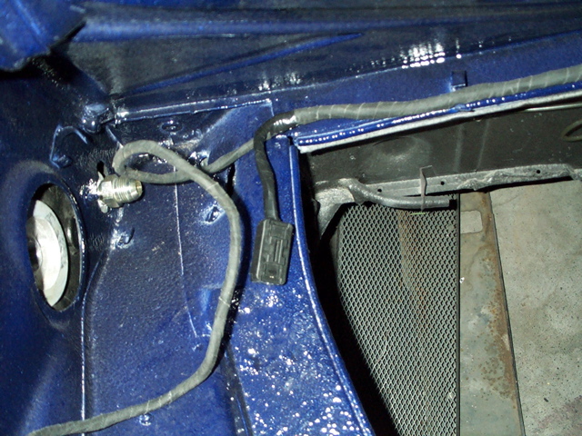

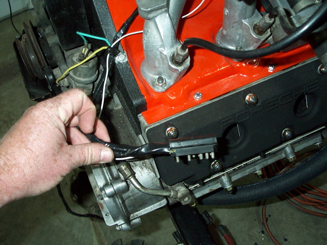

New fuel pump in place.
Wiring is basically finished with new Porsche connectors.
New plug in the engine bay.

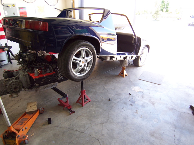

The engine installation:
Series9
post May 16 2006, 10:20 PM
Post #672
Lesbians taste like chicken.
Posts: 5,446
Joined: 22-August 04
From: DeLand, FL
Member No.: 2,602
Last:
Series9
post May 16 2006, 10:22 PM
Post #673
Posts: 5,446
From: DeLand, FL
Member No.: 2,602
.....and for those of you who were skeptical, the 7x16 w/225's in the rear ARE going to fit.

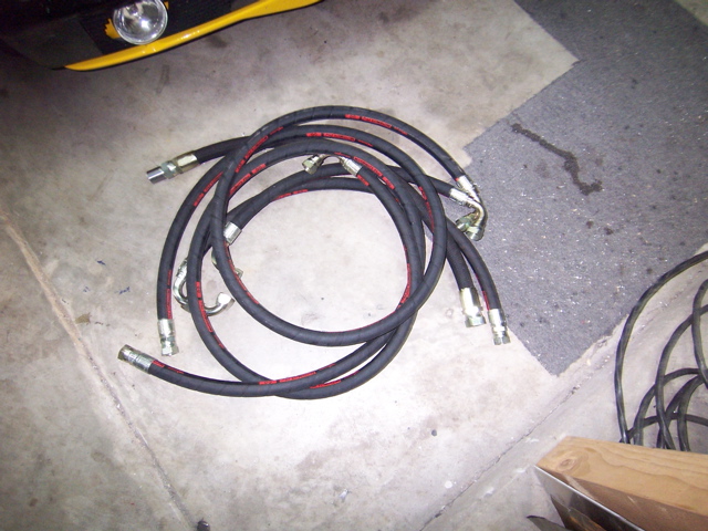

Oil lines. $395 @ the local hydraulic shop.

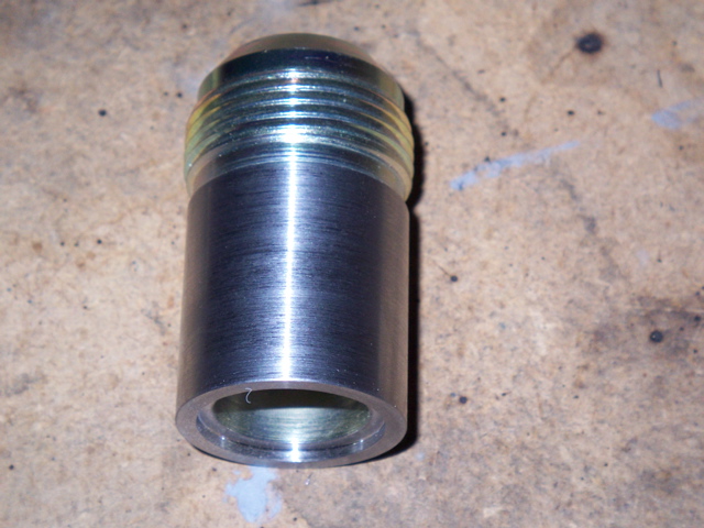

Here's the latest progress.

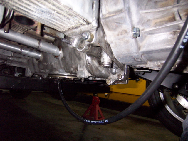

The oil supply adaptor has been an ongoing project. I haven't said anything about it yet in case it failed. But I'm feeling pretty good about it righ now.
Here's a steel -16 fitting I had turned down and recessed at a machine shop.
