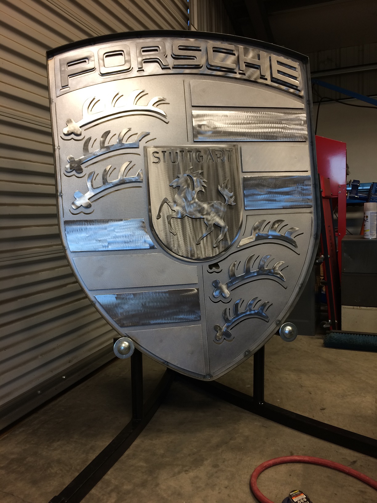

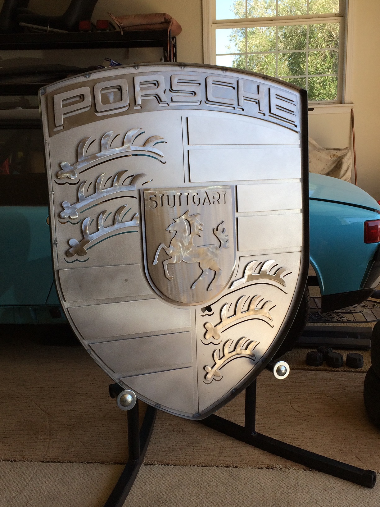

V2 assembled. I'm playing with different patterns on the various parts to see what I think looks good, etc. I think the lighting makes it look more extreme than it does in real life.
I definitely like it with the added panels as it really balances it out and makes it look more complete. (Tony will have to send his V1 back to the factory for an update!)

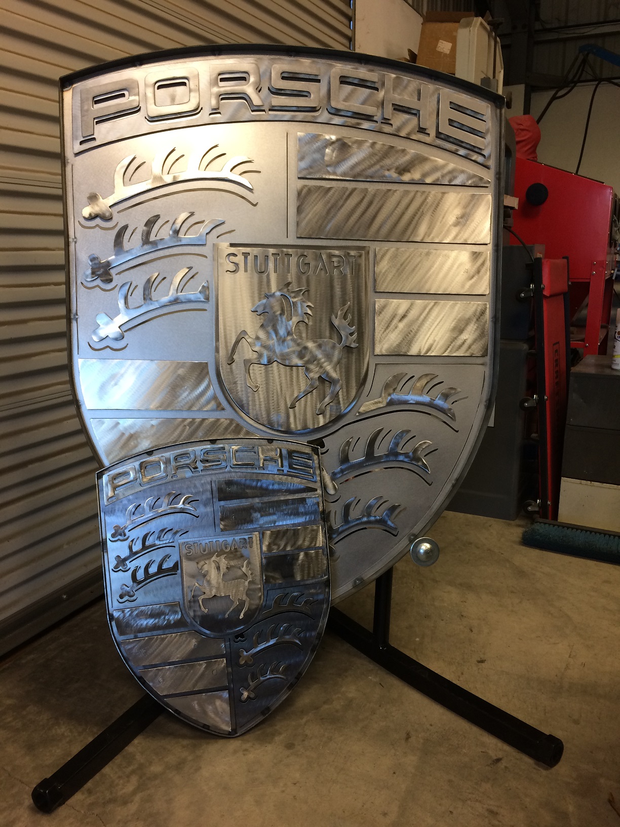

The convenient part is that all the pieces unbolt so style adjustments are easy.
Here it is with the baby 2' version.

Well, after looking at for a couple hours, I decided I'm going to "refinish" the panels. It looks too busy to me. I used a 40 grit flap wheel to do what's there now. Next, I'm going to try a 120 grit and a more uniform look on each panel. If I don't like that, I'll go to 80 grit on a DA. That's the finish on the main background.

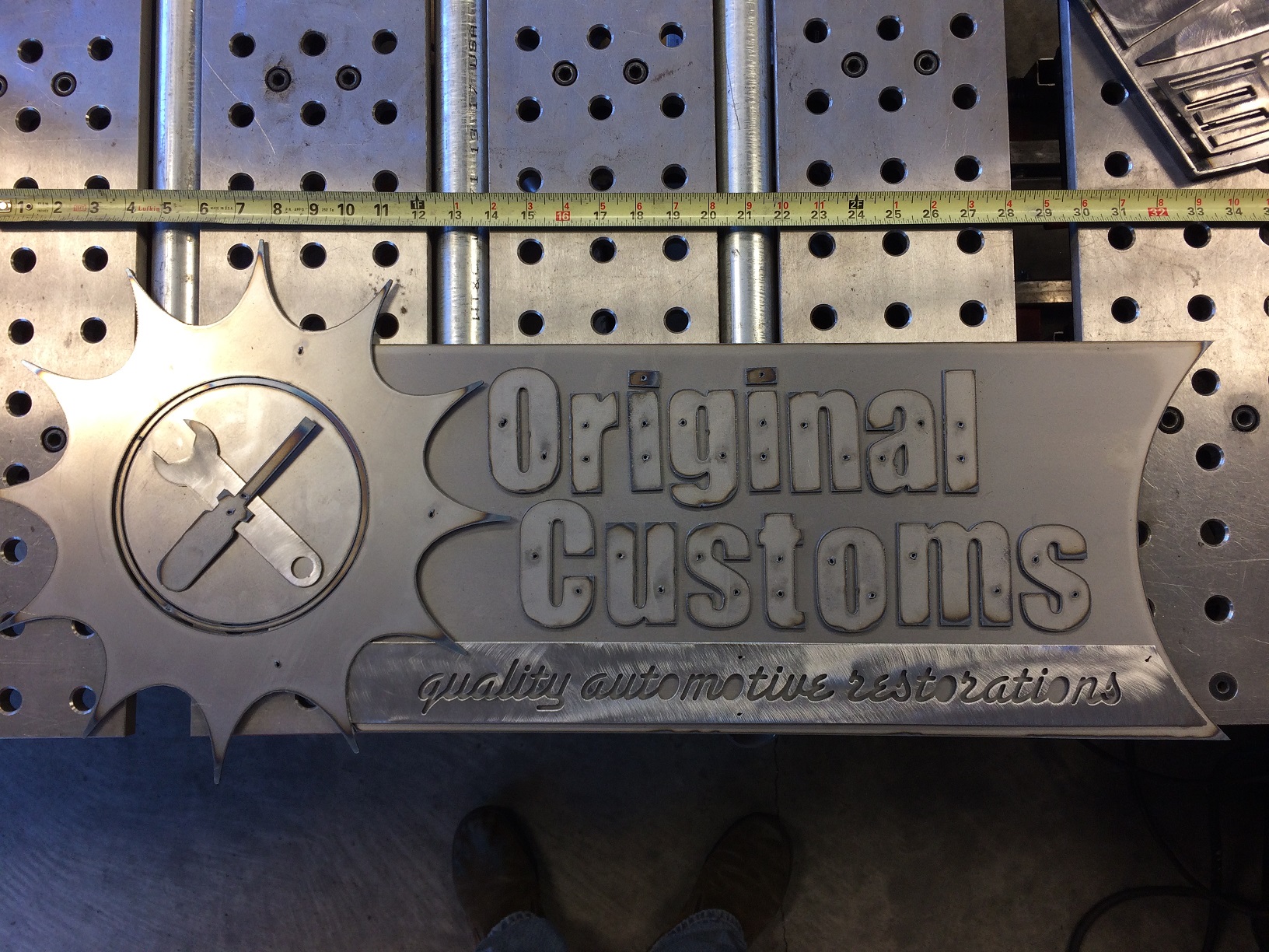

McMark's shop sign mocked up. How'd I do? (IMG:style_emoticons/default/shades.gif)
(yes, I know things aren't lined up. Everything is just sitting there. It'll be fine, trust me...)

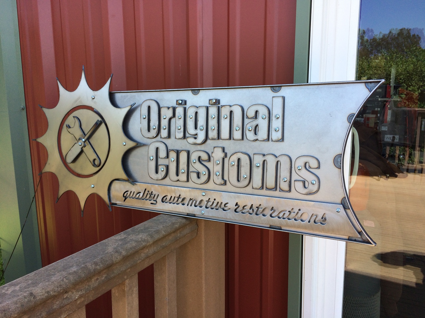

Some very cool cars... Got home and finished up McMark's sign. He wants to powder coat it so this is as far as I needed to take it. Now it's disassemble and ship time.

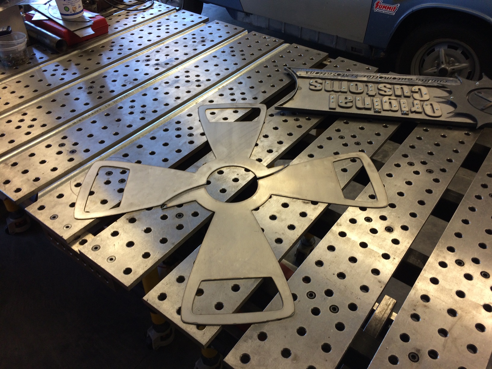

Then this fell off the plasma table... What could it be? (IMG:style_emoticons/default/happy11.gif)

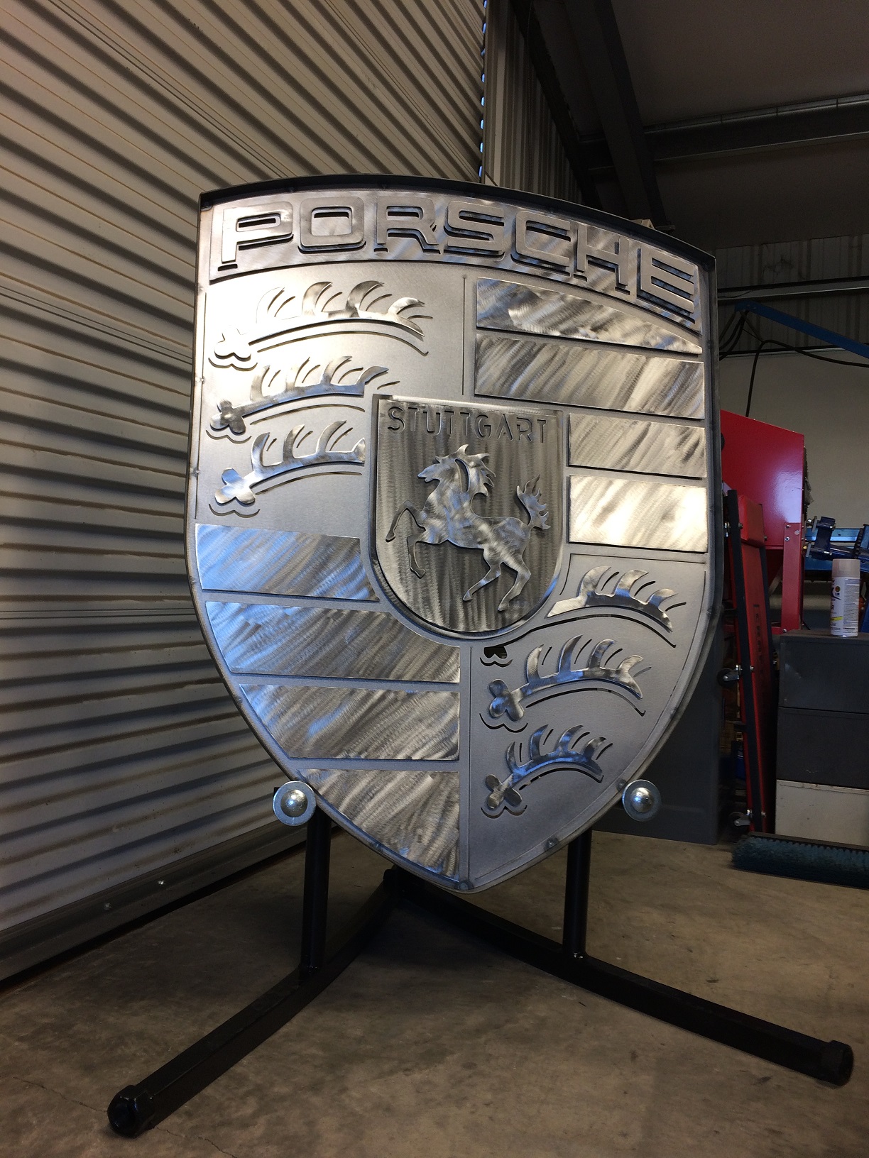

And, duh, I suppose I should include a couple pics of the finished crest! I didn't like the way the panels were looking so I cut new ones and attached the fasteners from the back, vs. plug welding through the locating holes as I did on the first set.
They turned out far nicer.
And with the raw finish, the way light reflects causes it to look a little different from every angle. I like it!
