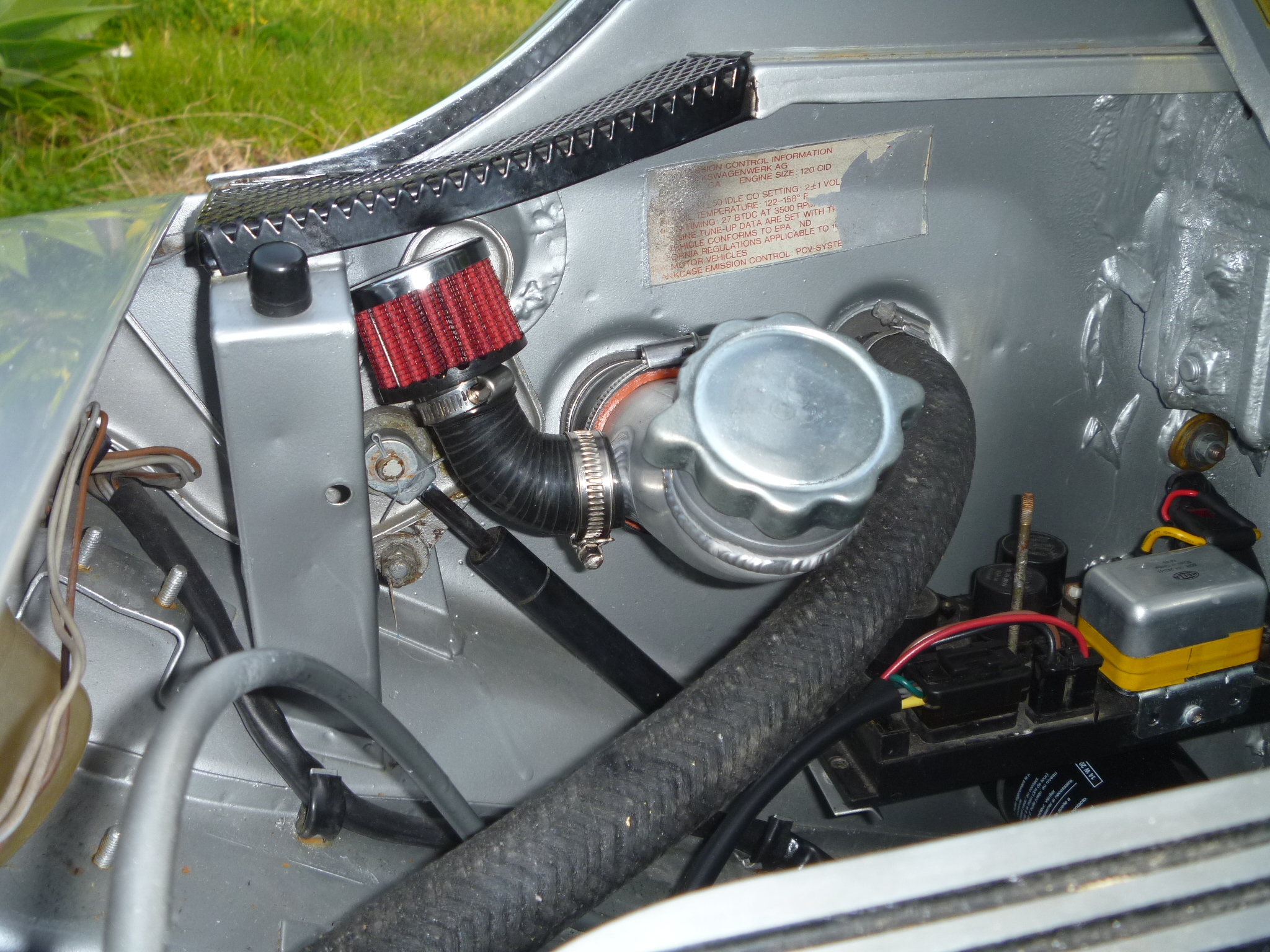

Some may have other idea's but I really like the design and think this would be great for a wet sump 4 that's see's some AX,racing or fast twisty corners action.

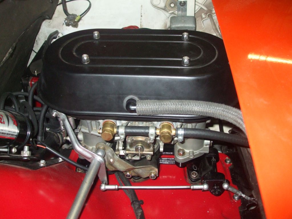

At least you know that the prototype design will be based on an actual install. (IMG:style_emoticons/default/smile.gif)

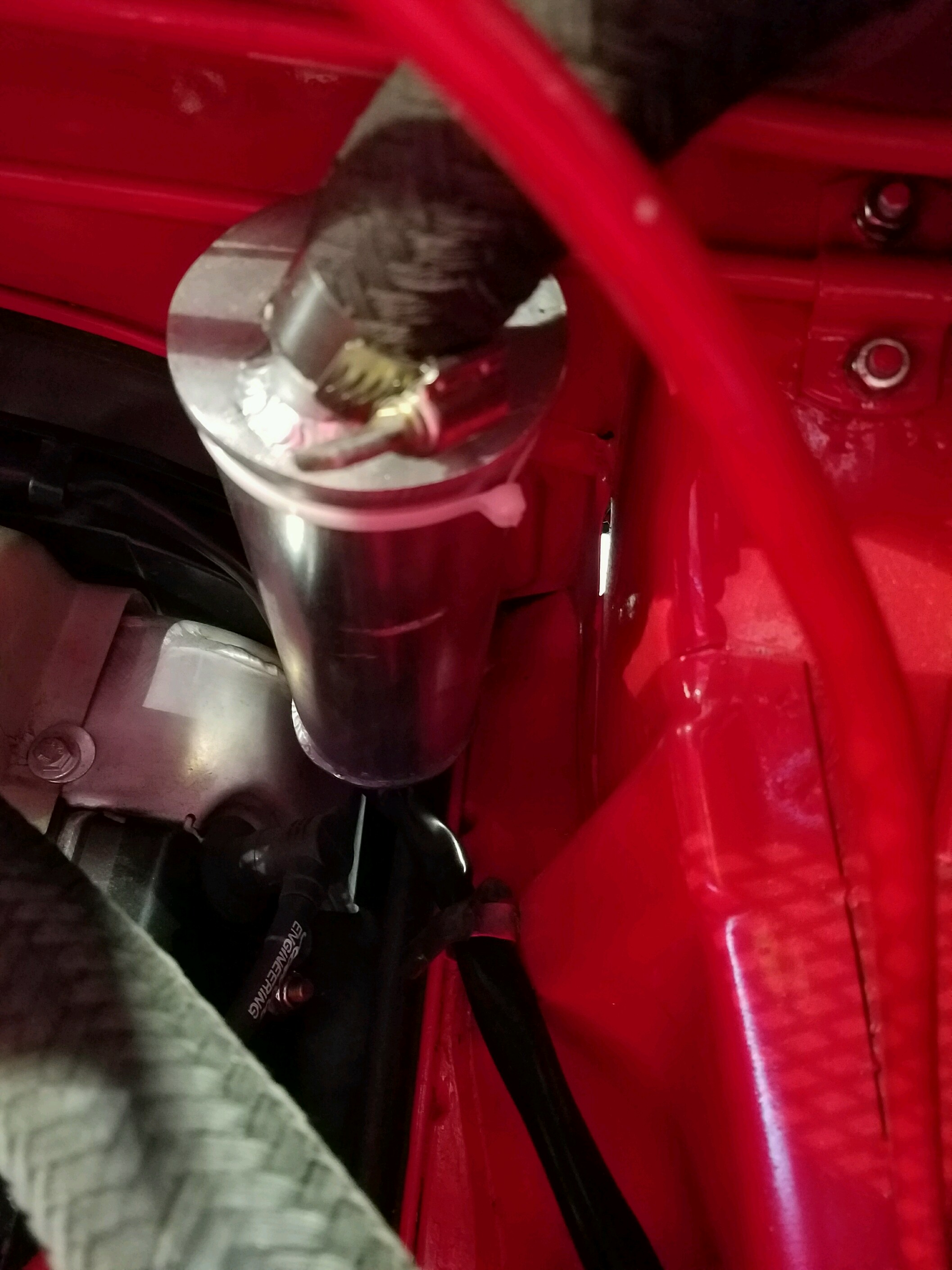

This is the one I made ! works perfect, in the picture I see a possible spot to mount a bracket

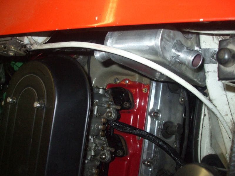

Same area I mounted mine. (IMG:style_emoticons/default/smile.gif)
I still have to cut and re-weld the bungs, but I think I have the hose to weber rain hats figured out for a nice super clean install.
For weber rain hats I'm going to offer it as a complete kit, puke tank, all hose, fittings, grommets and hardware.
I'll try to post prototype pic's later today.
The weber kit would also work for a dual carb /4, but you would have to drill a hole in your air cleaner top.
I can easily make a version to use on stock FI /4's.
I still need to know what size hose from the puke tank to stock /6 intakes.
