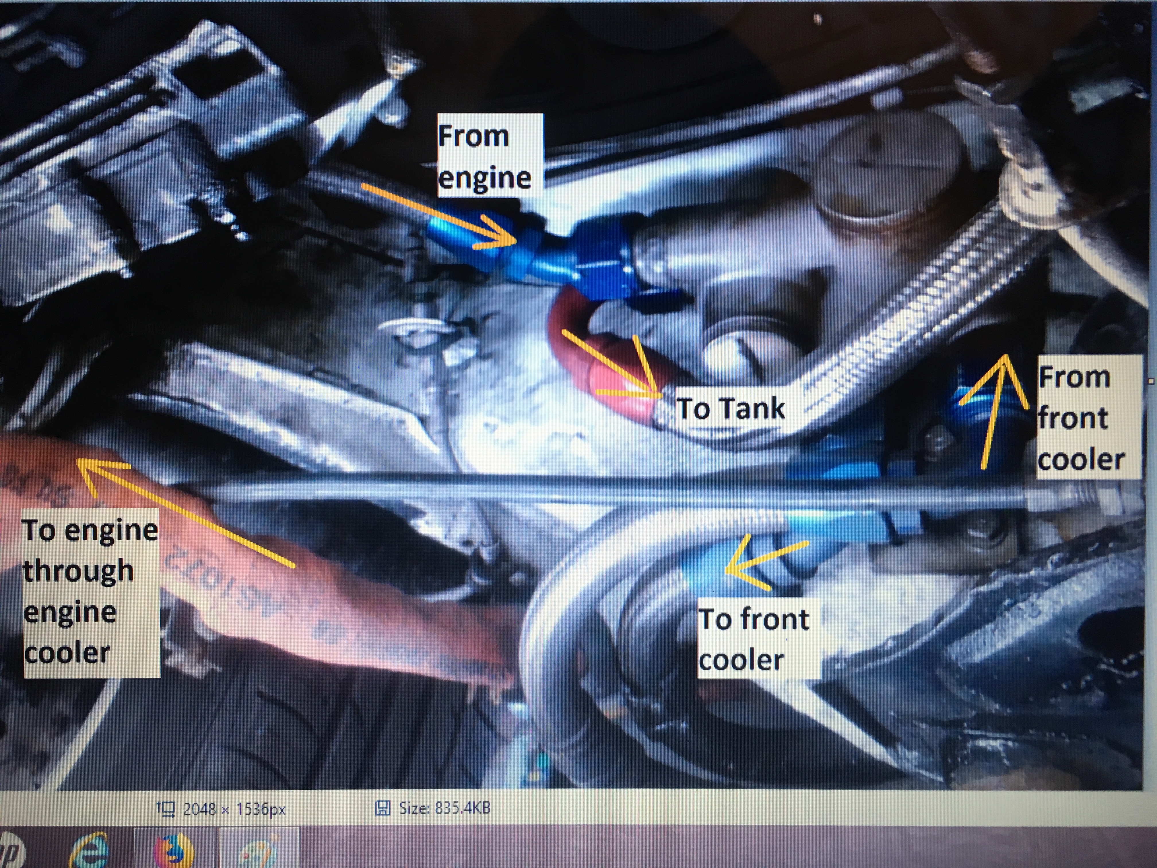

what's the internal diameter on the oil line to the engine cooler on a 3.2 ?
Just getting around to doing this job and selecting the right Fumoto drain valve prior to taking everything apart.
Also, can someone advise me if I have the oil flow right? Not sure I do (always learning!)
cheers.
