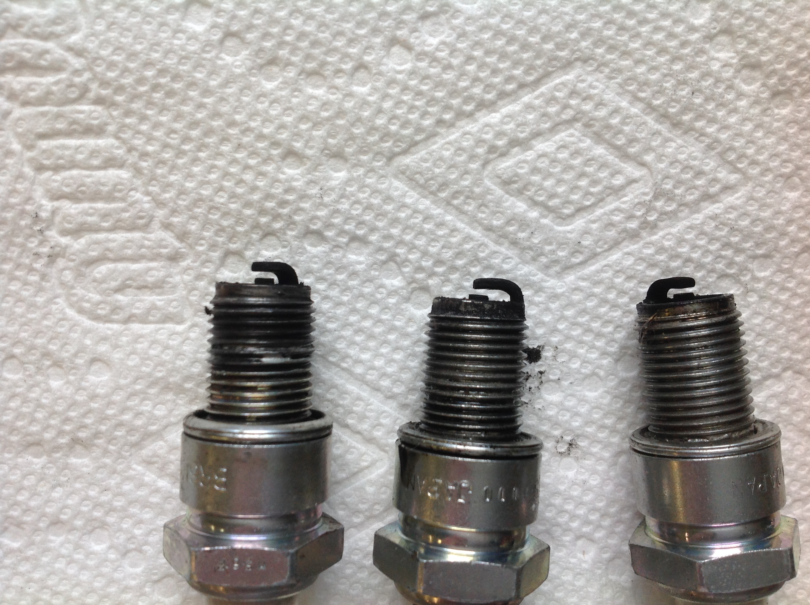

Here are some pictures of the spark plugs, probably less than 50 miles. Thanks everyone for your help.Attached Image
Root_Werks
post Jun 27 2017, 03:15 PM
Village Idiot
Posts: 8,996
Joined: 25-May 04
From: About 15NM from Canada
Member No.: 2,105
As some have stated, could be CHT, my money is on a vaccuum leak. Buy a tester and start checking each part.
