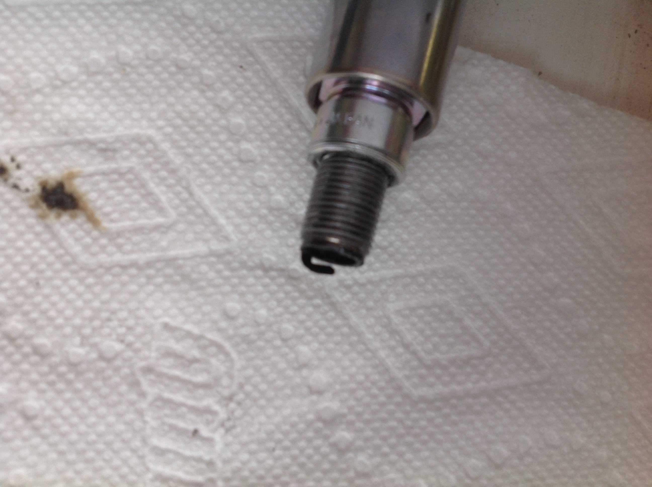

Here is a couple of pictures of the plug from cylinder 3. New plug only in the car long enough to do the testing suggested. Looks pretty black... appreciate any suggestions.

So who has more ideas about running rich? All 4 cylinders, right Rick?
Rick and I have been trying things.
* CHT ohms test was correct at room temp and 300*
* spare '75 ECU found no benefit.
* fuel pressure is normal
* Cold Start Valve is unplugged and replaced with a fuel pressure gauge.
* fresh plugs were fouled very quickly as pictured
At this point he is going by smell, but he is trying to borrow an A/F rig to pin-point how much rich.
I sent him the Itinerant posting about "asking the car what it wants", he may learn from that.
Mentioned that he might want to check (one cause they all should be checked, but also to eliminate some mechanical probs.)
*compression
*valve clearances
*and timing
But what makes the whole system rich?
