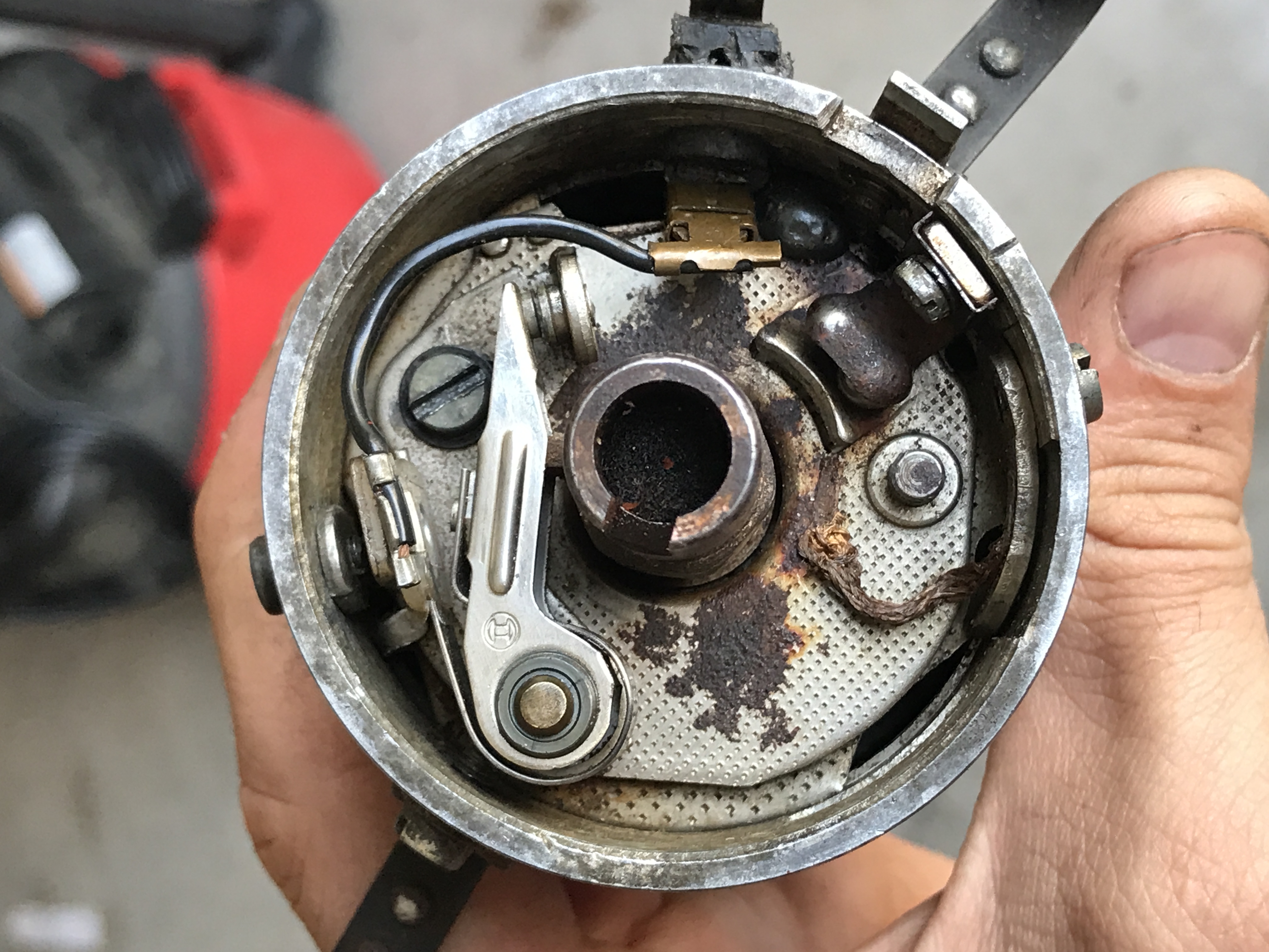

Little ground strap, right side in pic, still attached good?
Looks a little banged up, but attached in the pic.
It's still attached good and it's been like that since I got the car.

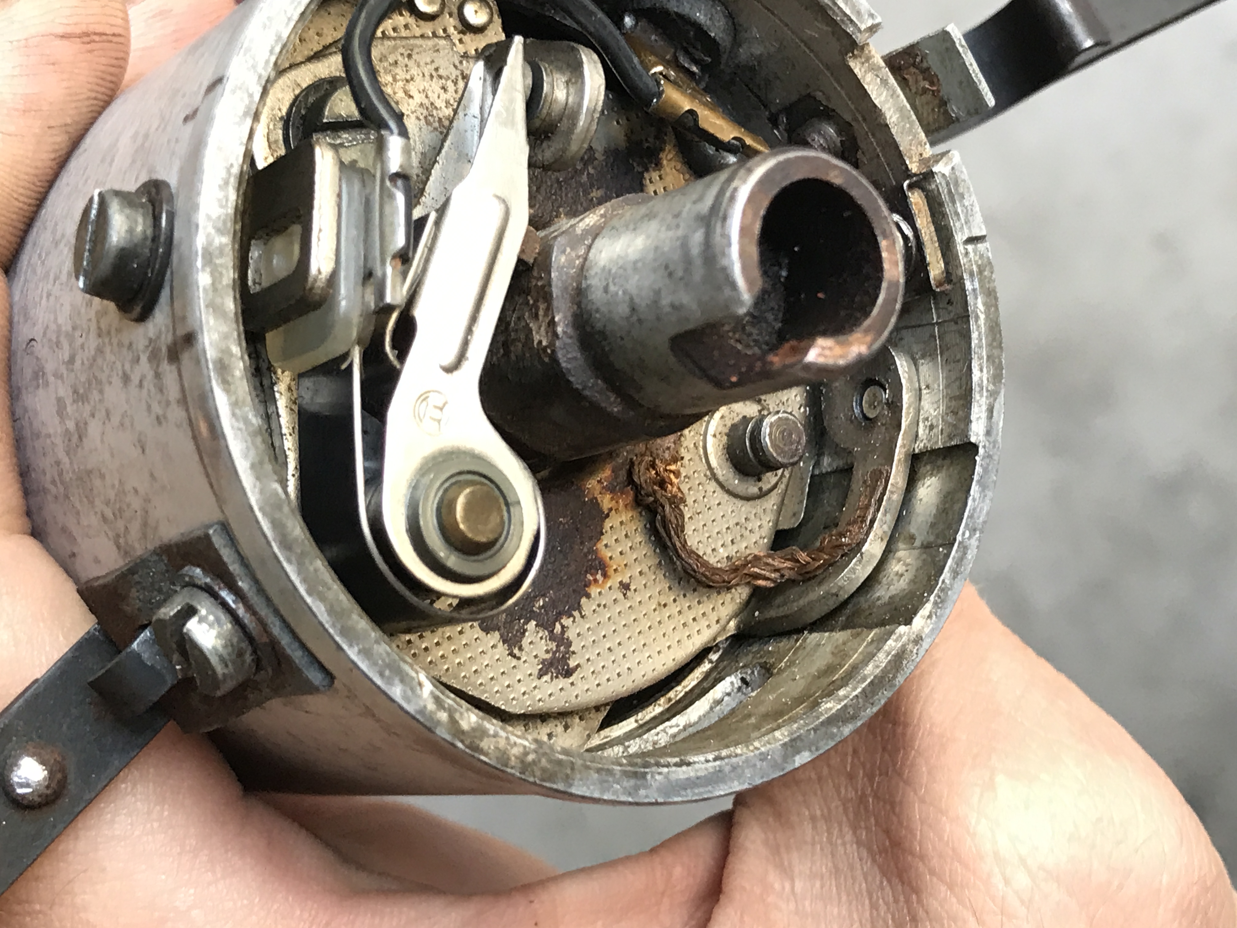

Looks like a lot of corrosion on the dizzy cam lobes. That would wear the points blocks PDQ.
Hows the shaft play, both side to side and up/down?

The shaft doesn't move side to side at all and goes up and down very slightly.
