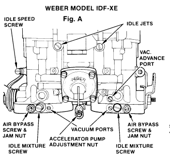

I am starting to play around with tuning and plan to start getting some small increments in jetting. Just to see if I can improve drivability for now. I have twin 44s
Simple question for now: I need 4 turns of idle mixture to now stumble off the line. Should I consider jetting richer?

Idle speed screws or mixture screws? There's no "idle mixture screws".s
If it's the mixture screws, 4 turns would indicate you need to go up a size.

I am initially working for initial throttle tip in power delivery and performance. Runs well with 4 complete turns but not very linear.
The root of my question is based on a concern I have seeing the flow diagrams> it seems that excessive idle mixture would be a less consistent charge to changing idle jets.

4 sounds like a lot just to get it stumbling off the line, the default starting point recommended by weber is 1.5 turns I think. Like McMark said though, there's a ton of other variables that would be good to know.
