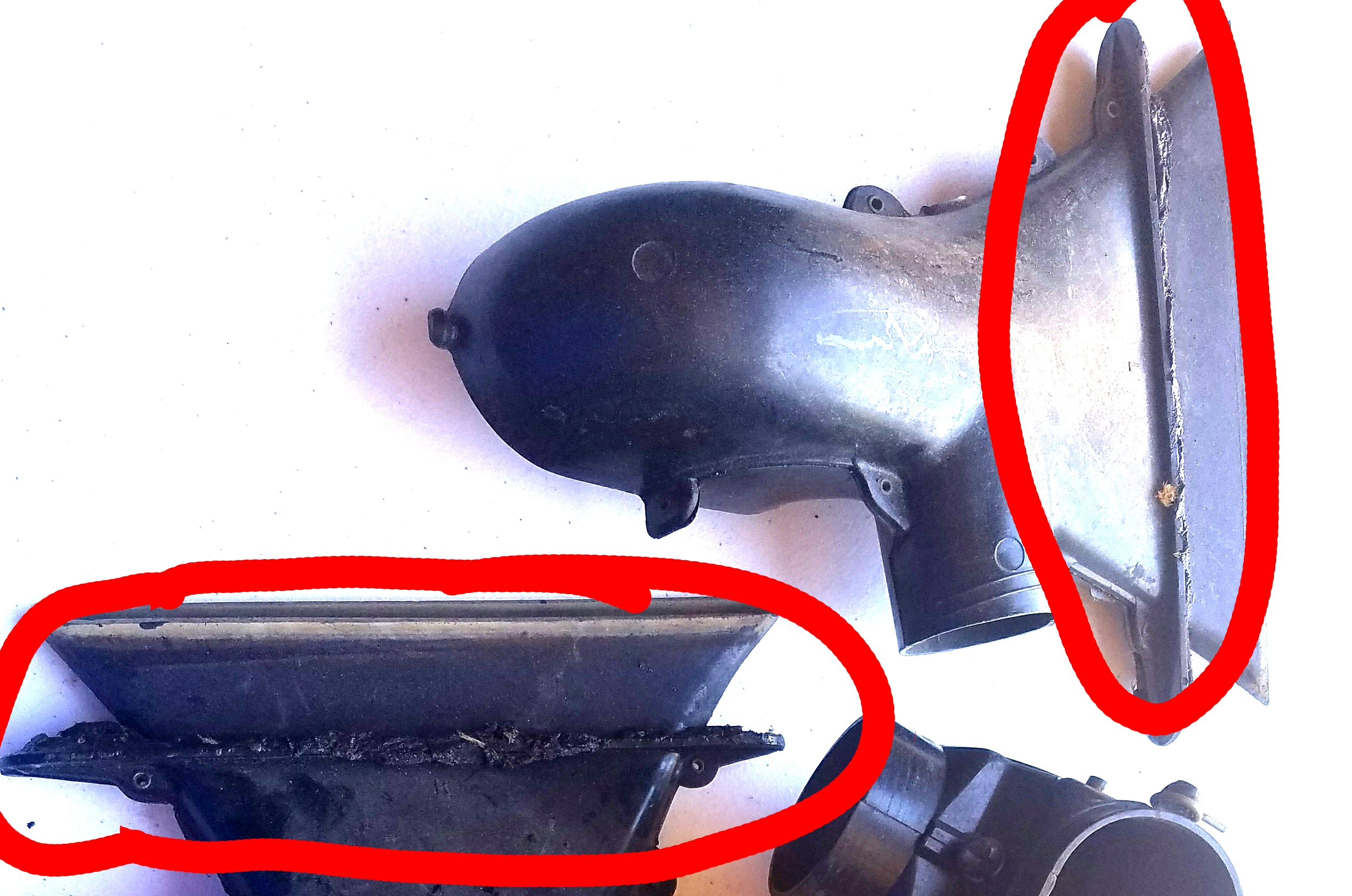

So much sticky goo on the defroster vents. Is that whats left of the original seals or was there an adhesive used too?

IIRC, the 914rubber.com seals come with glue on one side. Just remove the tape-like backing. I slid mine on then trimmed the backing and pulled it off. Did it that way so they would not stick in the wrong place going over the wide horn.
Scrape off what you can, get some GOO-gone and keep scraping.

The sticky goo you see is basically what is left of some of the foam that has decomposed or degraded over the years.
Malcolm2 above has a great idea for sliding the new seals on.

Thank you. I got all of the goo off. I like the Idea of pulling the backing off after it is on. (IMG:style_emoticons/default/beerchug.gif)
