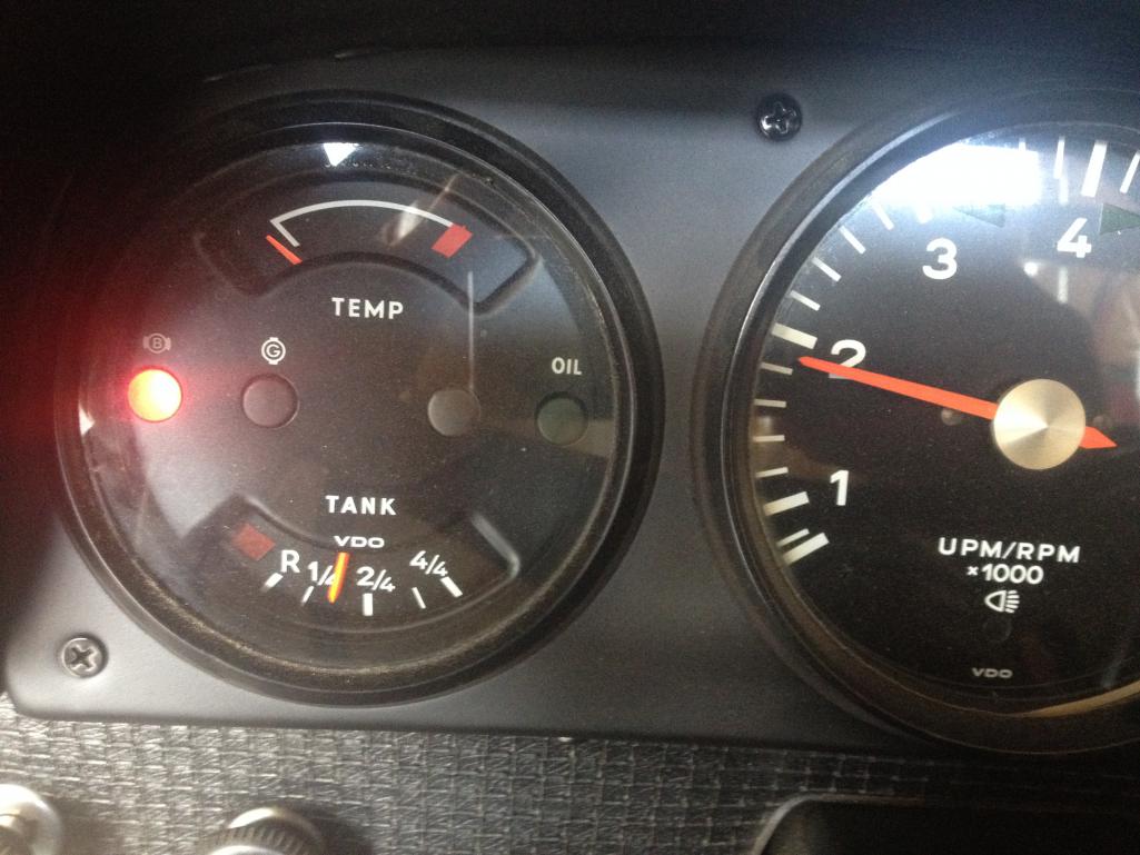

Took a trip downtown to get some Brad Penn. Then to a favorite brewery, Honky Tonk Brewery. On the way home I hear the stereo stop, then start again. I then see almost nothing on the dash works. No RPM, speedo is working but too high. no oil temp or fuel, no a/f, no oil pressure, no blinkers, you name it. The G light is on cht gauge too tho. Hazzards and dash illumination work. Head lights work, fog lights work. All the rear lights work at once. No brakes, just tail, etc…
Guess i have a weekend project. Thoughts?

Yep. Weird but i had my cell phone mph app running. The dash is usually 5 to 8 behind, depending on speed. Tonight the dash was 8 ahead. Car ran perfectly. Zoomed all the was home as expected.
Just checked the batt. 12.7v with everything off. 13.9v + idling.
G light is working kinda backwards. Usually it starts and stays red til i rev. Now it is off till i rev then on.

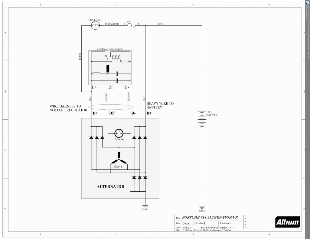

Fuse S9 powers most of those things you mentioned and is necessary to the operation of the GEN light.

Just curious ... if it was the fuse, wouldn't the gen light never come on? I know you'll have the answer, Jerry ...

The simplified schematic above omits the tach, fuel gauge and some other electrical items powered from the battery through S9. With S9 open, now the GEN light powers (or tries to power) these items and is on. The electrical items may or may not function properly because of the large voltage drop across the GEN bulb.

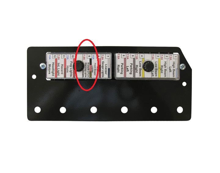

S9 or F9 as pictured?.... not that it really matters maybe S and F are the same in German? (IMG:style_emoticons/default/blink.gif)
2nd question is more important.... where is it?
And maybe I should be prepared with a replacement.... size?

Member No.: 13,139
OK, nevermind... I guess I never knew the fuses were numbered, but it make sense. What is the F or S for?
I see you are right. Lots of stuff listed there. One I did not mention, but I had my wife check was the BACK-UP lights. They are out too. Maybe I was just paranoid about the speedo. Hell it was really the only thing that did work.

QUOTE(Spoke @ Jul 7 2017, 12:17 AM) *
That explains why the tach would register a small amount. Some other gauges did the same, just momentary flickers or attempts to work.
