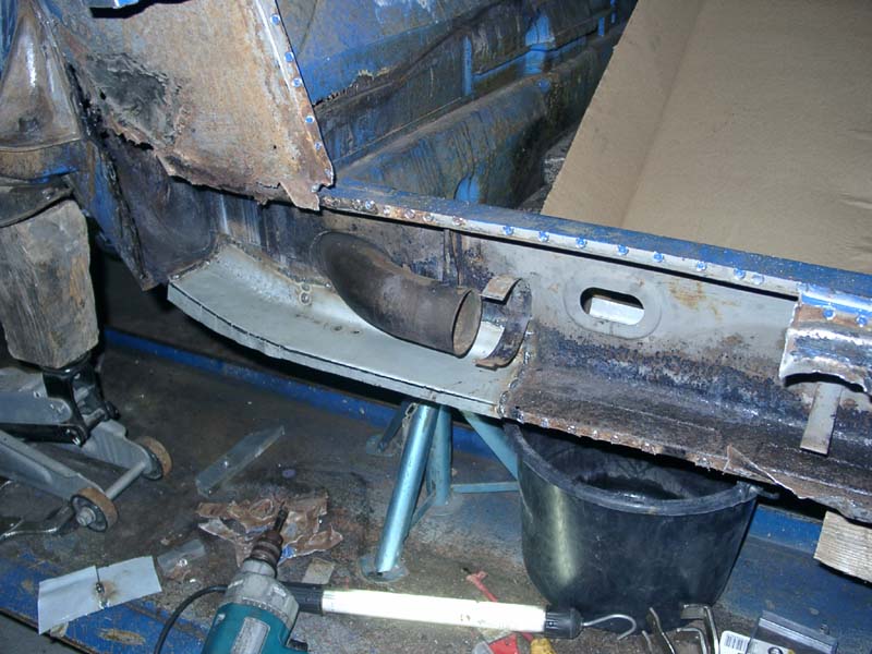

Hi to all,
After receiving my welding course from JoeSpark (thanks!!!). I'm going to start to tackle repairing the big holes in the car.
First though I need to make some replacement panels but have never really done any metal working.
If I want to make the exact same part as in this picture below, what would be the best way to proceed.
Should I make the flanges fisrt and then try and bend the whole thing or vice-versa? It's probaly very simple to do but I'm sure there are steps to follow.
Any help is appreciated.
Mihai

Make the flange, then clamp the narrow flange in the vice with part you want to curve sticking out off the edge. Carefully lift on the piece stretching the short flange just a little. Move the piece further into the vice and repeat. This will give you a slow curve in the flange. I have a home made tool for the shrinking required for the other side. I'll try to get out and take pictures later. easier to show than to tell.

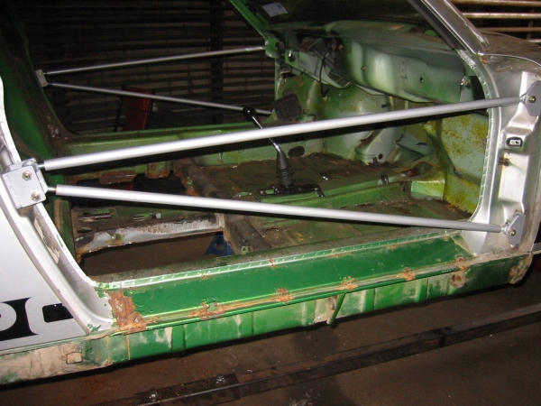

Looks like your on your way. As mentioned be carefull about your door gaps. At the top of the page is a tab "914 Info". In there you will find measurements for all your door gaps.

Hi,
the chassis was built originally without a engine or trans, so it dosen't reallly matter if it's in or out when your working on it. A solid car won't flex with the addition of the weight of the engine or trans.
More important is making your sure the door gaps don't shrink (or grow) while your welding in the replacement parts. There was a thread about a roll cage being inserted in a car where the body shrank 1 inch while it was being done. The easiest way to make sure, is to measure your gaps and compare them to the specs in the info area. If your out now you will have a hard time getting the doors/roof to fit later.
Make the car match the specs and cut and weld a bar in from the front door jam to the rear door jam. All you need is a 1 inch bar to hold it in spec.
There was a member who made a slick adjusting bar that fits in this spot. If he reads this he might post some pics of the bar with the screw ends on it for you.

If I was going to fabricate that replacement part as shown in the picture (never mind what else is in the pic), I would start out with a piece of sheet metal and break over the flange (about 3/4"?).
I would then make the other flange with the large radius bend. To make that radius, I would get a piece of pipe that approximates the radius and roll the steel around the pipe.
The last step would be to now bend this Z shaped channel. This is the tough part. I would use a stretcher to "stretch" the first flange so that I could bend the part as shown. To allow the large radius flange to bend, I would cut it as he did to relieve the stress (you can see the slit he made and see the tack welds when he closed up that gap).
It takes a lot of practice to be able to make parts from scratch as this person did. This was not his first metal working project. His parts looked very good and more importantly fit nearly perfectly.
Take the time to work your parts so that they fit perfectly and you will like your results. If you rush the repair, it will look rushed.

QUOTE (GWN7 @ May 17 2005, 12:15 AM)
(IMG:http://www.914world.com/bbs2/html/emoticons/smile.gif)
GWN7
post May 17 2005, 06:14 AM
King of Road Trips
Posts: 6,280
Joined: 31-December 02
From: Winnipeg, MB, Canada
Member No.: 56
That's the picture (IMG:http://www.914world.com/bbs2/html/emoticons/beerchug.gif)
If I remember it bolts in to the door & lock bolting plates and the ends adjust so you can fine tune the specs.
