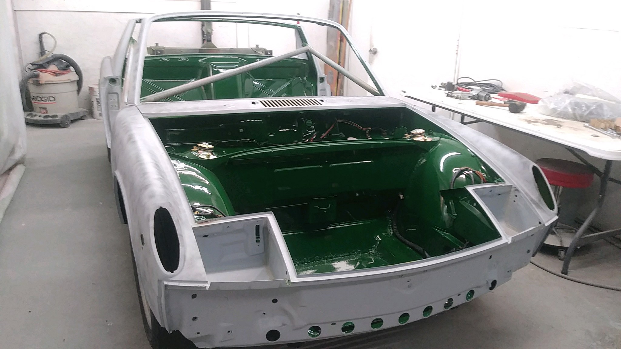

Yup. Elephant Racing modification as I want to lower the Six about 1-1.5" from stock ride height. I just think they look good a bit lower than stock. So we raised the spindle about 17mm to help offset the lowering and then did the gusset, etc. to control/prevent bump steer. Hopefully it all works as intended.
Before we raised the spindles I had Harvey Weidman ship one of my widened deep six wheels (7" total, widened 1" on the back side) back to the shop where my car was from May 2012 to July 2017, to check everything for fitment/clearance before we raised the spindle. I was told it was all good and 17mm would be perfect. The wheel was then shipped back to Weidman for finish work. Elephant Racing ultimately did the spindle raise as the other shop was unable to do it.

Seems odd to me that you would upgrade the front struts and not upgrade the rear with a more fine tunaeable coilover...??? Also not a fan of the black strut dust covers vs bilstein green.
I guess that’s about all I can critique, your car is looking awesome!

No worries and thank you. I have been thinking about the rear coilover upgrade and we may need to do that to get the rear to sit where I want it. But for now, we are just trying to get it to "roller" status so it can come off the rotisserie and get the rest of the body shot and then go to Jim's. (IMG:style_emoticons/default/beerchug.gif)

We have stock later model sway bars going on front and rear. The 914-6 never came with sway bars as far as I am aware. But I sourced a pair from a '73 if I recall correctly.

My car has finally landed on its wheels after 6 years without wheels. For me, this is a major milestone and I am excited to see it.
Since you are already going slightly non-stock on some things, I'd really recommend a stiffer front Tarrett sway bar. I like how their 22mm bars change the cars.
And just curious... are you going to put the "914-6 black goop" on top of the front struts?
-Steve
