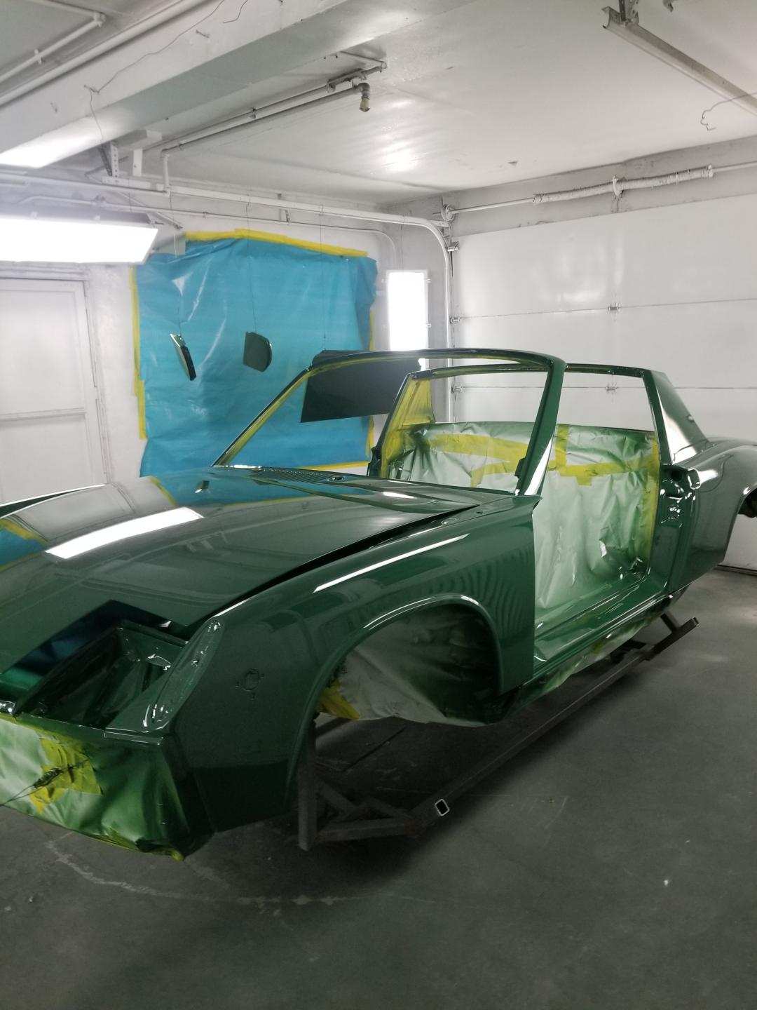

Cairo94507
post Dec 19 2018, 02:09 PM
Post #1112
Michael
Posts: 10,487
Joined: 1-November 08
From: Auburn, CA
Member No.: 9,712
Now that my Six is once again a "roller" it will now be back in the painting process for color on the body. No rush as we are all busy at this time of year. It's going to look beautiful. (IMG:style_emoticons/default/santa_smiley.gif)

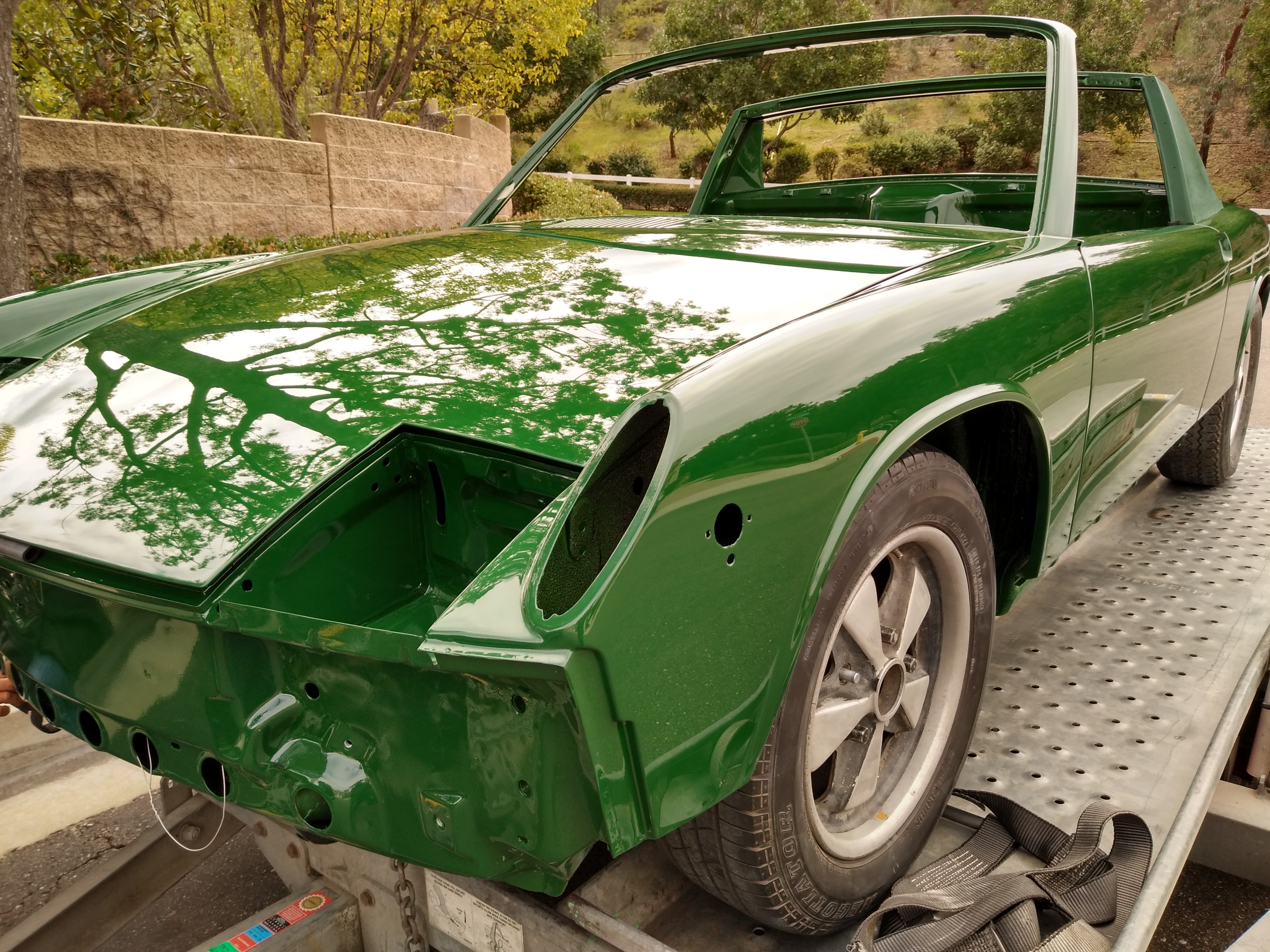

sixnotfour
post Dec 20 2018, 03:11 PM
Post #1113
Posts: 11,017
Joined: 12-September 04
Member No.: 2,744
Here"s a teaser
914-6 I sold a year ago..look at it now..in Canadia
Cairo94507
post Dec 20 2018, 04:56 PM
Post #1114
Michael
Posts: 10,487
From: Auburn, CA
Member No.: 9,712
Jesus....I had a minor heart palpitation when I opened this thread and saw a freshly painted Irish Green tub, then I looked closer and at the OP and realized it was not my car. (IMG:style_emoticons/default/beerchug.gif)

QUOTE(sixnotfour @ Dec 20 2018, 01:11 PM) *
Here"s a teaser
Ahhh,
Metal work completed by us here at Restoration Design. It was a pretty solid car that needed only a little bit of metal work to get it perfect.
Paint and body work done by our preferred guy Manny at Cambridge Collision
It will be headed back State side this week
Pete
Luke M
post Feb 17 2019, 11:22 AM
Post #1118
Posts: 1,437
Joined: 8-February 05
From: WNY
Member No.: 3,574
(IMG:style_emoticons/default/icon_bump.gif) (IMG:style_emoticons/default/unsure.gif)
burton73
post Feb 17 2019, 11:24 AM
Post #1119
Senior member, and old dude
Posts: 3,901
Joined: 2-January 07
From: Los Angeles
Member No.: 7,414
Now is the slow work. It takes a lot of hours to get her finished. Step by step
